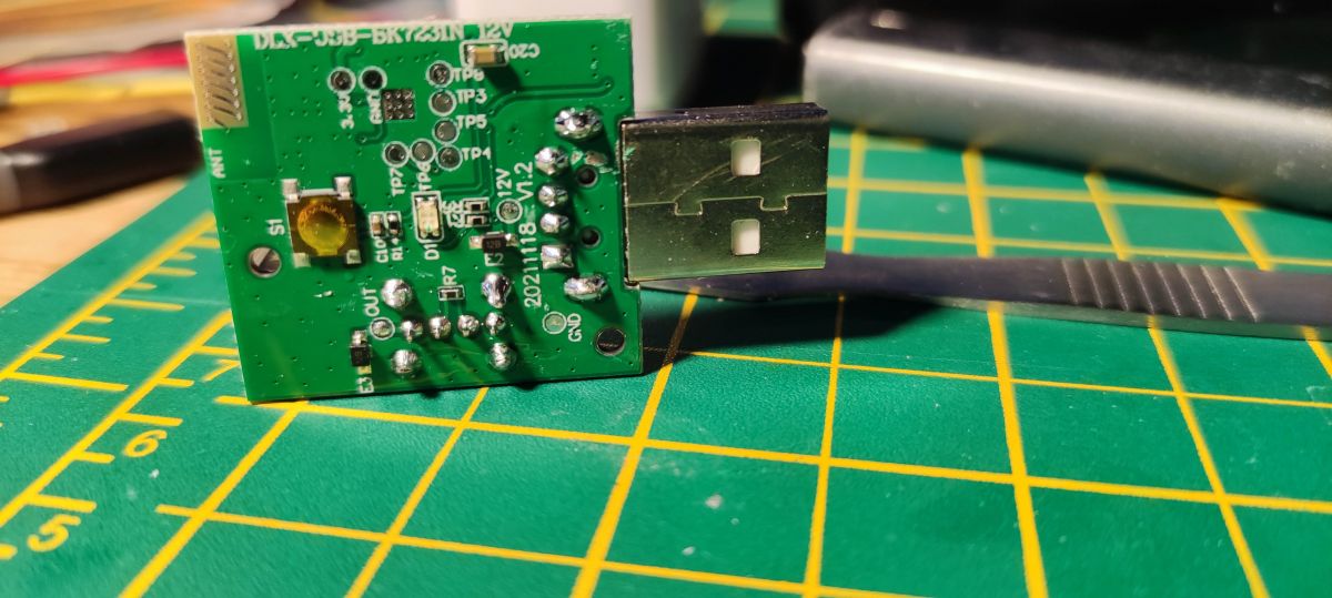

    I thought I'd present my own USB micro smart switch sold under the brand ONENUO with model ZHQ01. I see there's an identical device
    here but maybe this qualifies as a 'new' device that others may not find if searching for 'HC-S050-WIFI'.

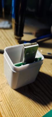

    Opening was easy using a thin prying tool along the top edge of the unit. There isn't much glue so lifting one edge, once loose, will crack the rest out of place and allow you to open it.

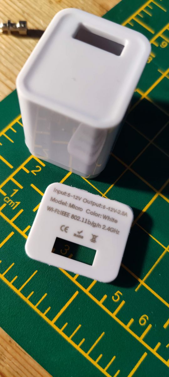

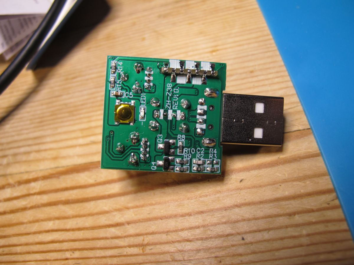

    Silkscreen PCB numbers:
    DLX-USB-BK7231N 12V
    FR-4 L2MM
    I managed to guess TP6/7 were the TX1/RX1 so have attached the boot log.
    TP3 - CEN
    TP4 - TX0
    TP5 - RX0
    TP6 - TX1
    TP7 - RX1
    - Button (channel 1) on P24
    - Pair/Toggle All Button on P8
    - WiFi LED on P6
    - Relay (channel 1) on P7
    Device seems to be using CB2S module, which is using BK7231N.

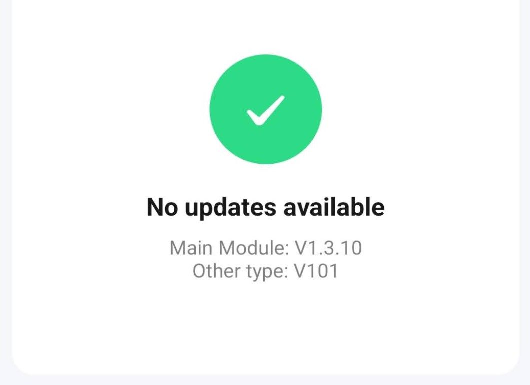

    Product page of ONENUO 5V micro smart USB switch on AliExpress. Close-up of a circuit board with USB port and markings. Circuit board of the ONENUO ZHQ01 micro smart USB switch on a green measuring mat. Micro smart USB switch ONENUO ZHQ01 with detailed technical label. Close-up of a blue packaging for the USB Smart Adapter with technical specifications. Box with label of Tuya Smart Micro USB Adapter/Switch product. Blue box with the white text Micro on top. Close-up of the internal structure of a micro smart USB switch showing electronic components. Close-up of a PCB with visible electronic components and a BK7231N microcontroller. PCB with DLX-USB-BK7231N 12V markings and test points. Close-up of a printed circuit board with labels and connectors. Close-up of an open USB device with printed circuit board markings on a green mat. Opened micro smart USB switch with visible circuit board and components. Circuit board of a micro smart USB switch in a plastic casing. Screenshot of an app showing software update information: no updates available. Main module version is V1.3.10.

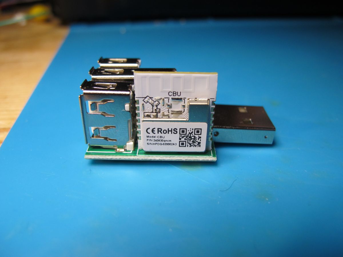

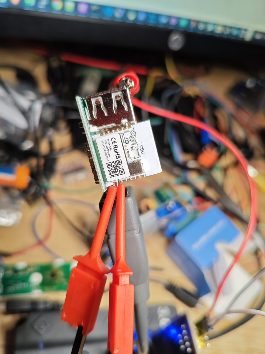

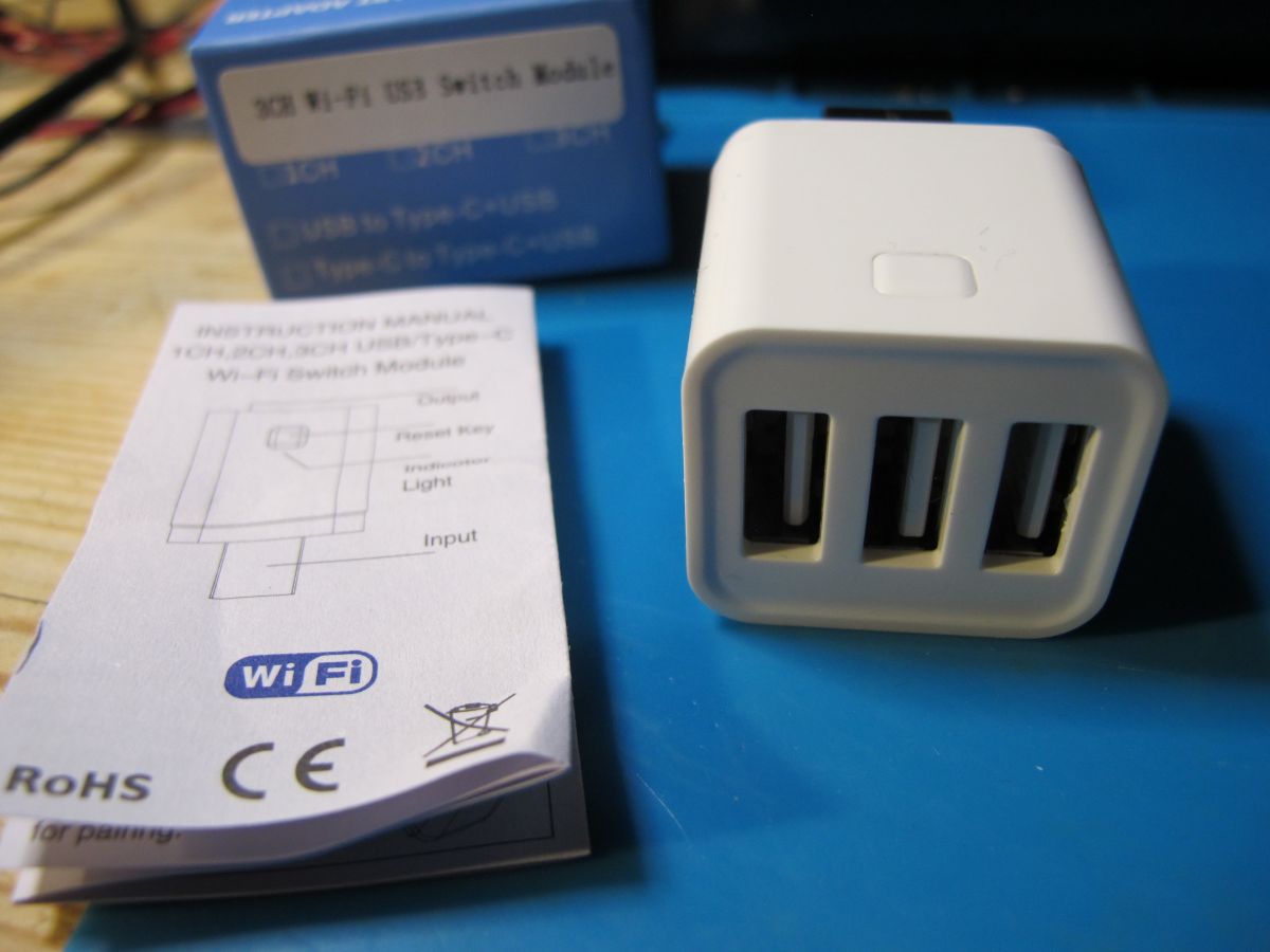

  • 3-channel version uses a CBU module instead of BK7231N

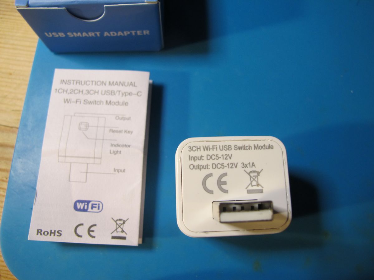

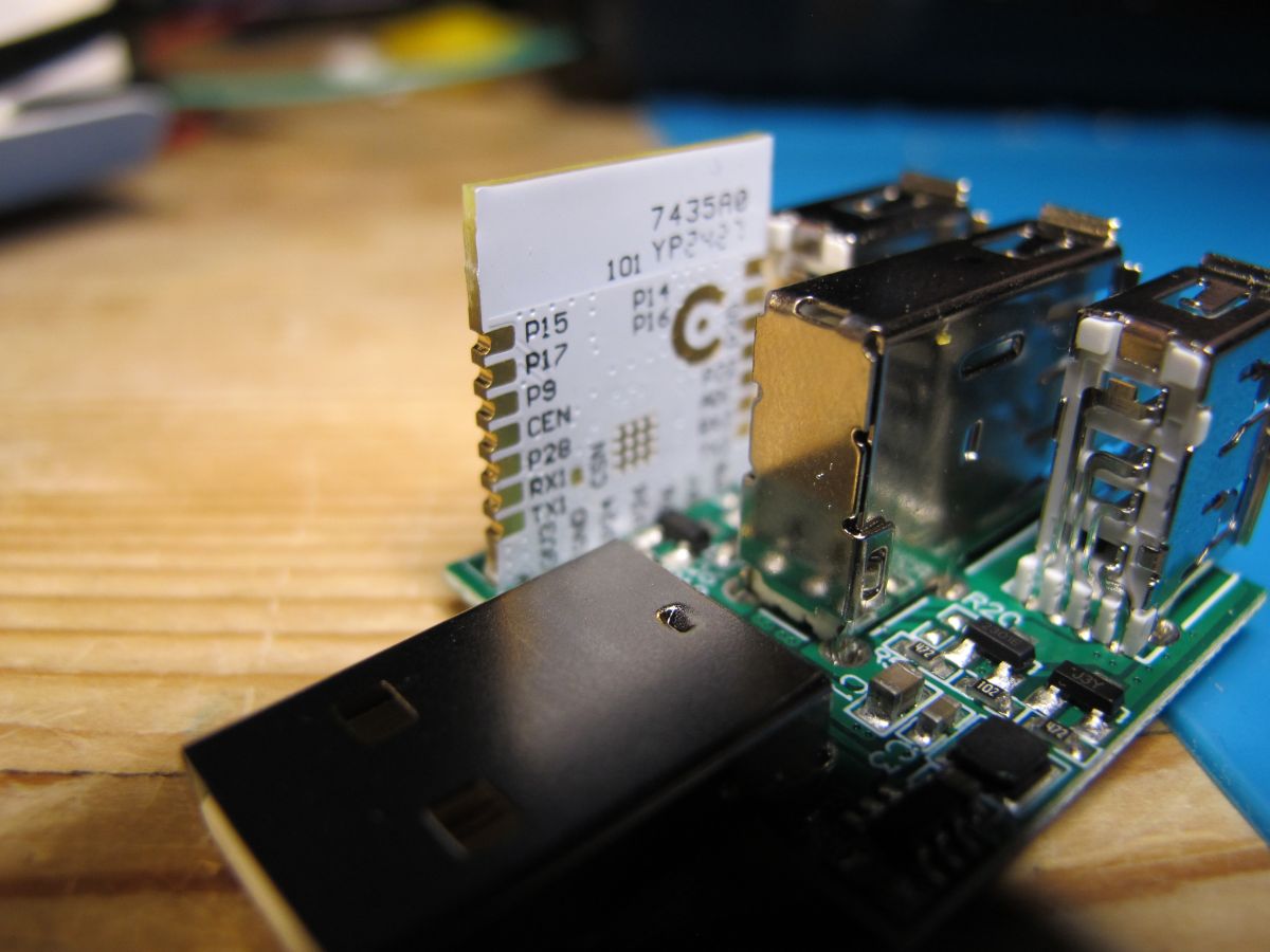

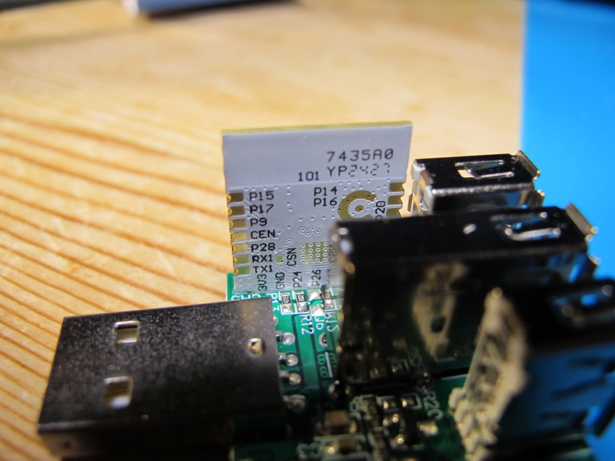

    #4 21284444
    Posts: 5220
    Help: 449
    Rate: 918
    The 3 channel version uses a CBU instead of the BK7231N on the main PCB, perhaps for reasons of space.

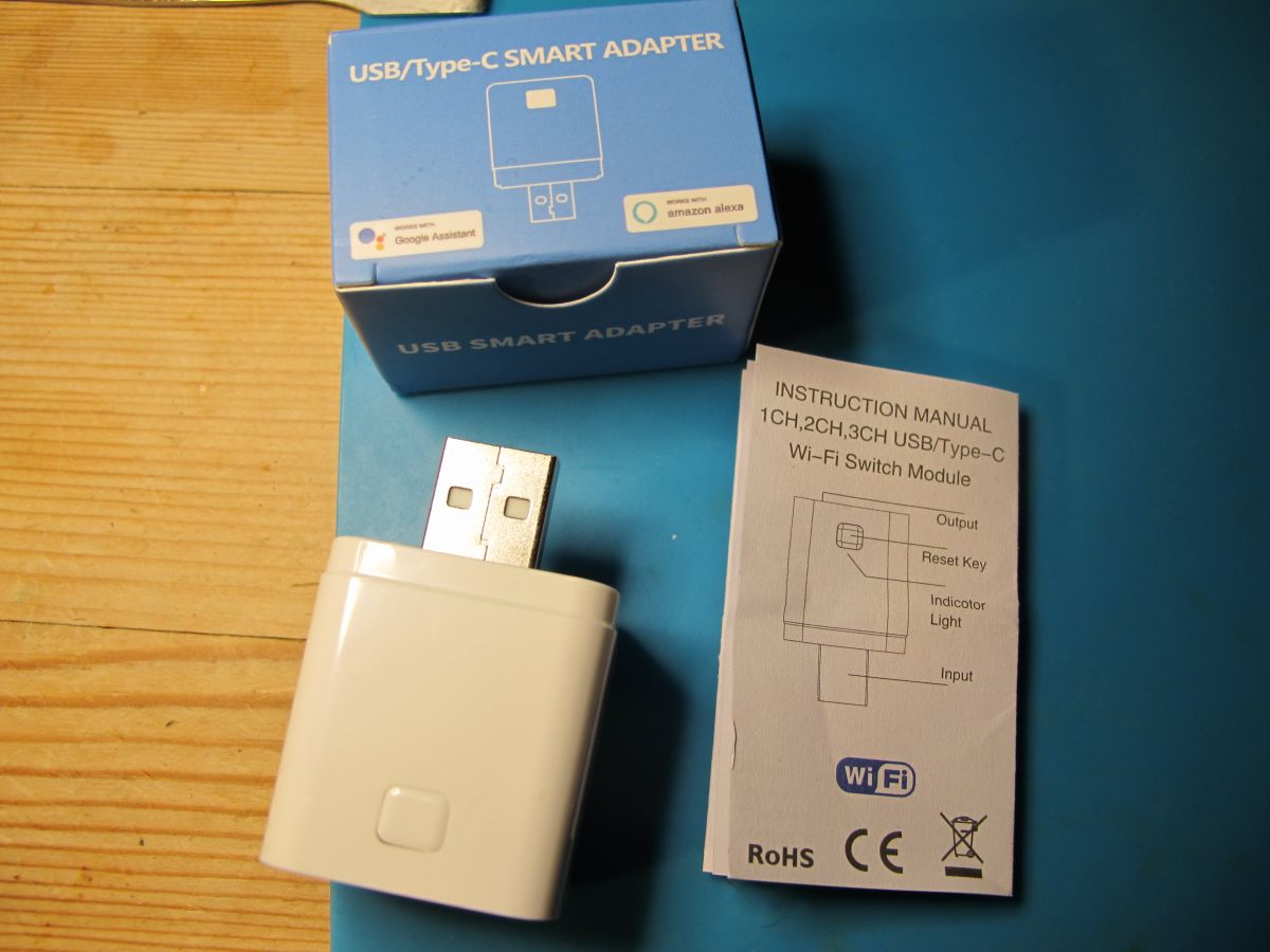

    White Wi-Fi USB module with three ports on a blue background, next to a user manual. Wi-Fi USB switch module with manual and packaging. USB Smart adapter with instruction manual. Electronic module with USB components on a wooden table. Circuit board with three USB ports and a wireless module, side view. CBU module with three USB ports on a blue background. Green circuit board with a USB module and electronic components. Close-up of a circuit board with a CBU module and USB ports.
    a solderless release from Tuya
    Close-up of an electronic module with a CBU chip, connected by red test leads with crocodile clips.
    boot from TX2
    firmware 1.3.18 - not cloudcutter exploitable
