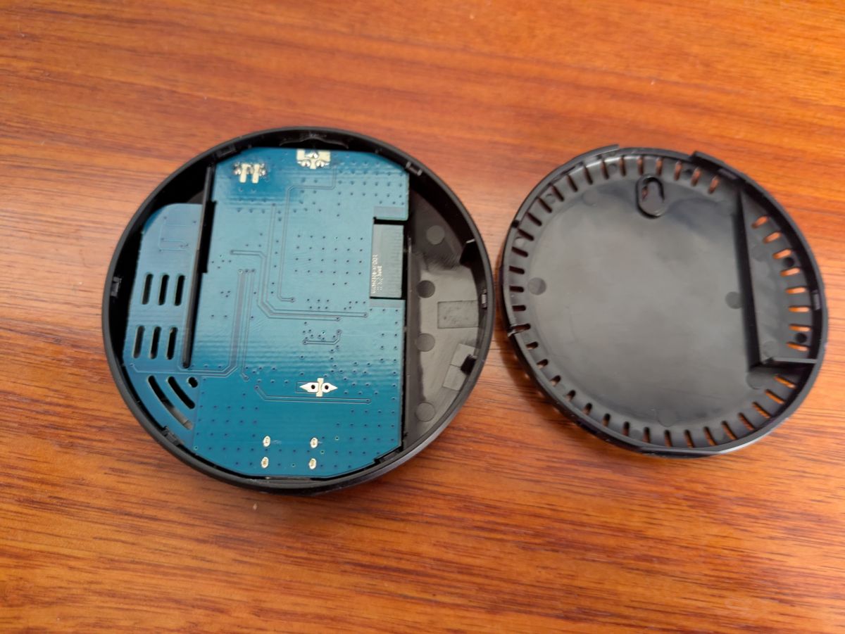

    With this S01 Pro I liked how it has usb-c, temp & humidity and a programmable button when using ESPHome or OpenBeken.
    This was very easy to open and flash. There are no screws so I simply pried it open with my two thumbs fingernails starting from near the button and moving them left and right. Open S01 Pro device on a wooden table with visible PCB.

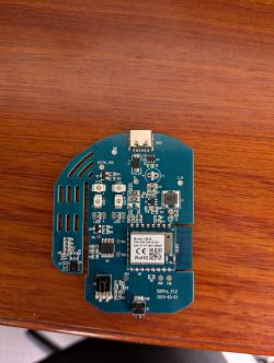

    Once inside simply remove the PCB.
    Close-up of the S01 Pro device PCB with visible electronic components, including a USB-C port and a CB3S chip.

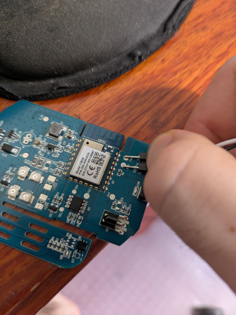

    It has a CB3S chip with firmware V2.1.17 which is patched. Fortunately serial flashing was incredibly easy. On the board there are RX and TX pads that can be used for flashing. So I plugged the S01 Pro into power via its USB port, then put RX to TX on serial flasher and TX to RX. Then in BK7231Flasher or ltchiptool select to start flashing. Then remove and plug in again the USB port to the S01 Pro and it'll start flashing! Super easy with no soldering required. Just hold the RX and TX steady.
    Close-up of S01 Pro PCB during flashing procedure.
