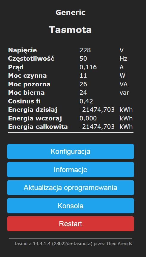

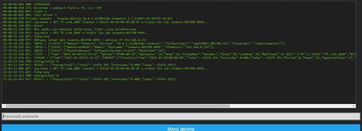

    For me, these commands do not reset the module

  • #6 21432737
    Tasmota energy reset and tariff commands
    #7 21432744

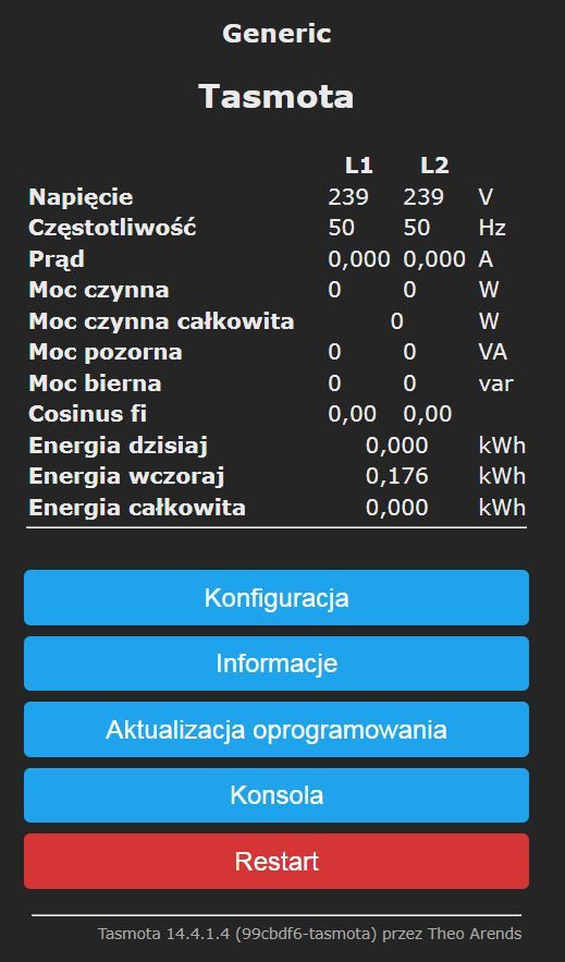

    #11 21432837
    sznickers
    Posts: 196
    Rate: 8
    Reset my energy today and total- I have a 2 phase because I couldn't make more than 3 PZEMs on one board, so I have 3 boards with 2 PZEMs on each.
    Tasmota interface screen showing voltage, frequency, current, and energy data for two phases L1 and L2. .
    And he did so:
    (two phase recall)
    EnergyTotal1 0 enter
    EnergyTotal2 0 enter
    1.He switched off the 230V supply to the PZEM (I don't know if it matters, but there was voltage on the coils),
    2.switched off the 5V boards on the ESP,
    3.switched 230V on,
    4.switched on the 5v boards - ESP
    And note, I had two boards connected and it zeroed me on both different boards- onalaaaa :)

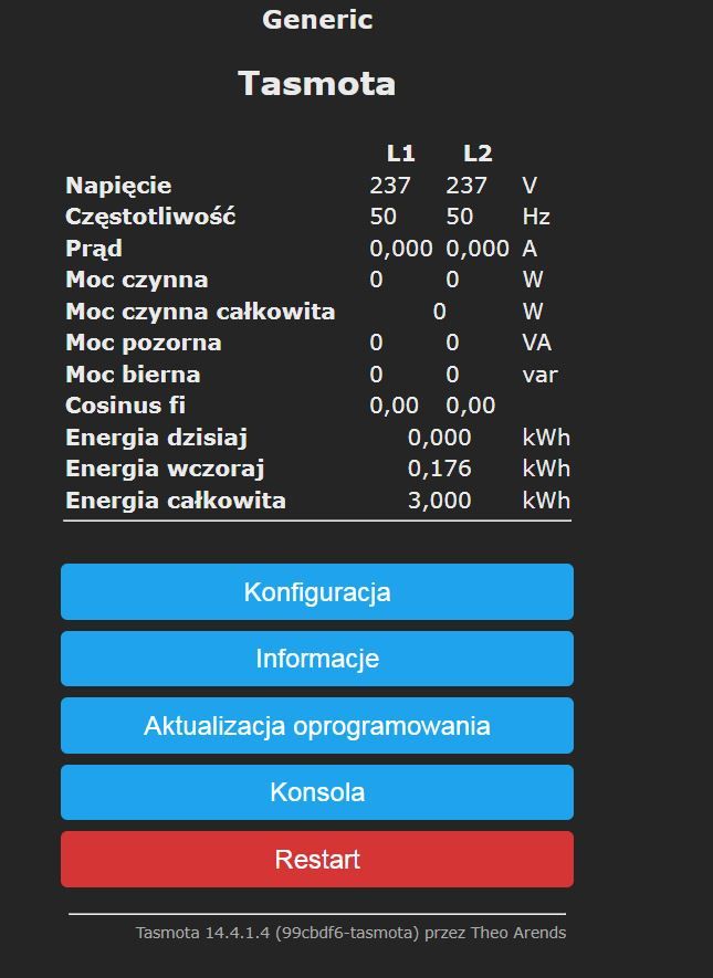

    Added after 11 [minutes]:
    And I've entered EnergyTotal1 1000, EnergyTotal2 2000 (i.e. adds up for both phases) and it starts from 3 kwh-no bomb- finally I've got something working :)
