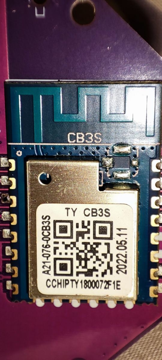

  • BK7231N CB3S pinout and OBK template for HW400B-W

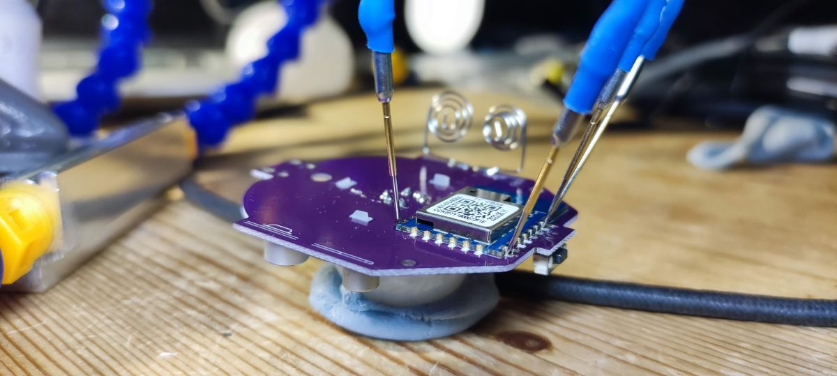

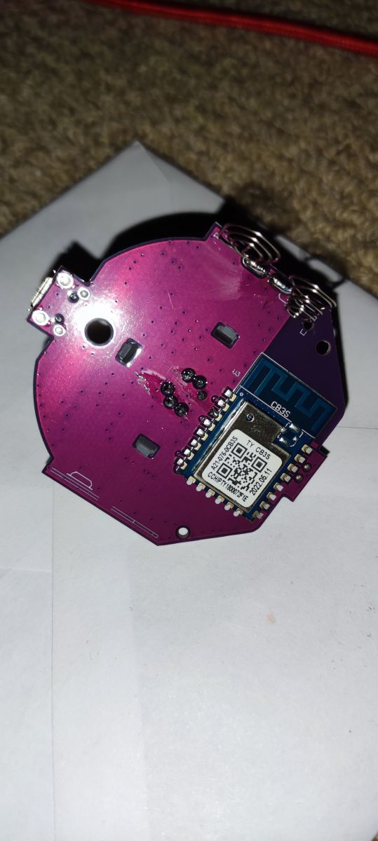

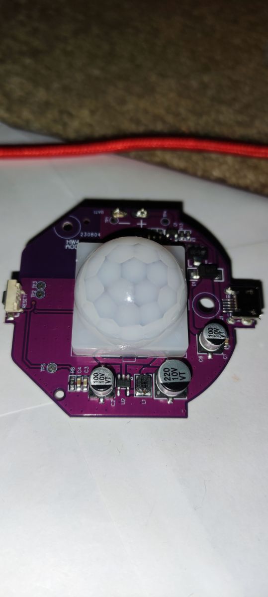

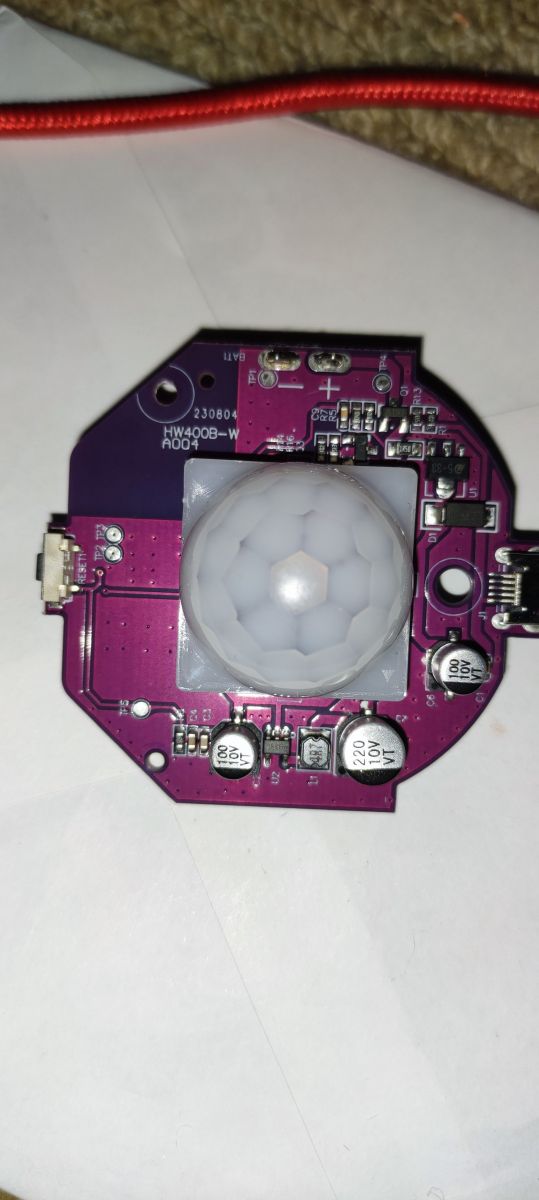

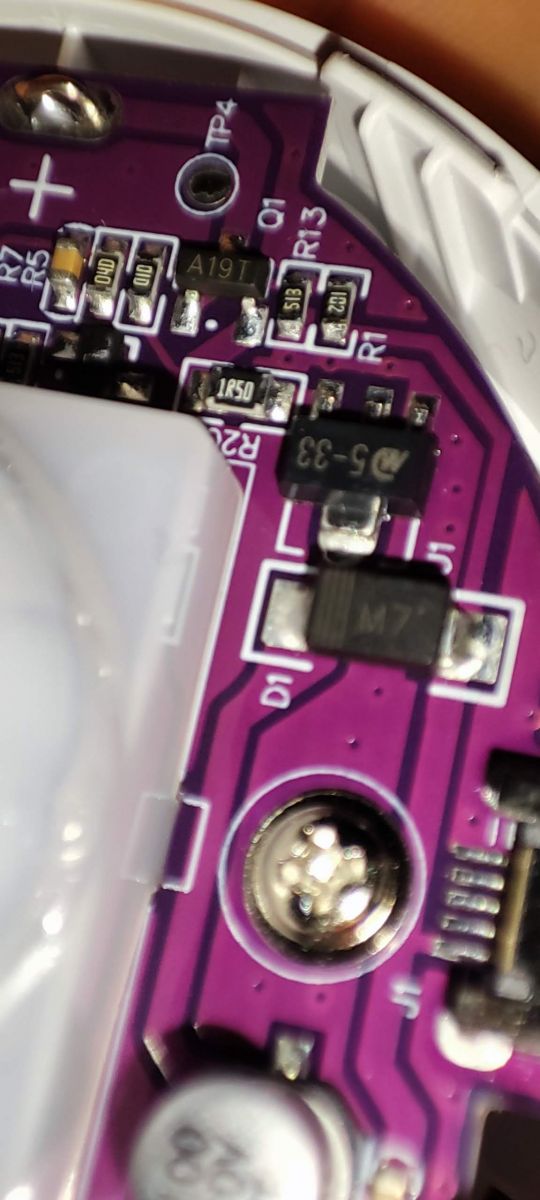

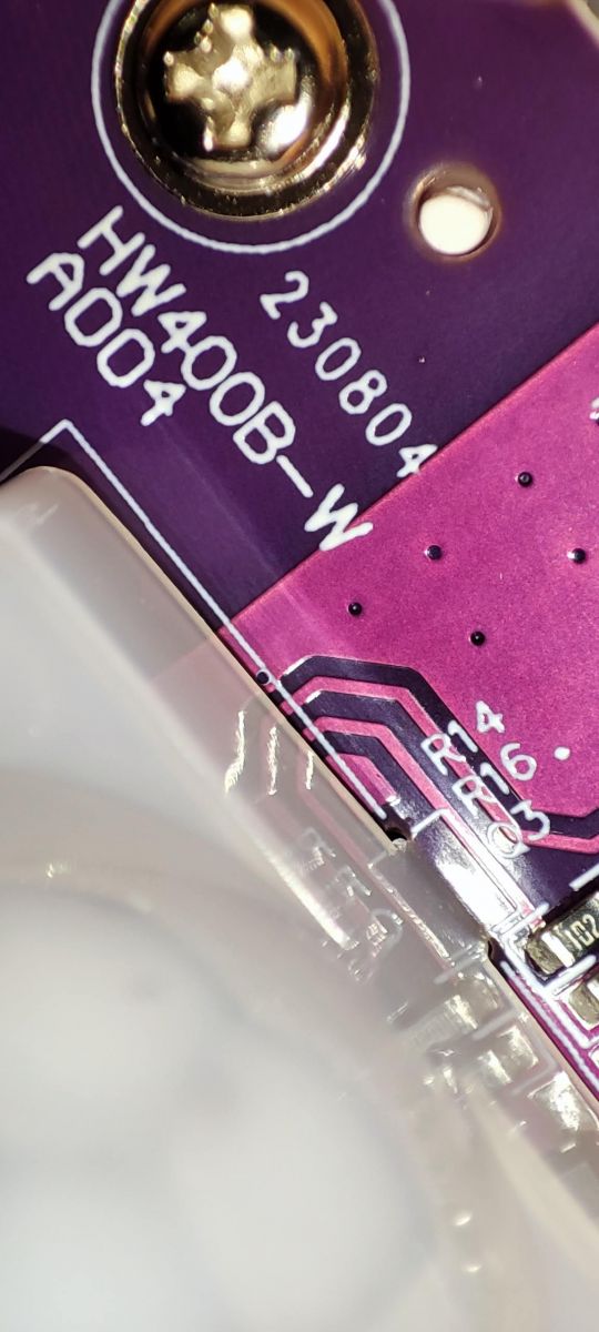

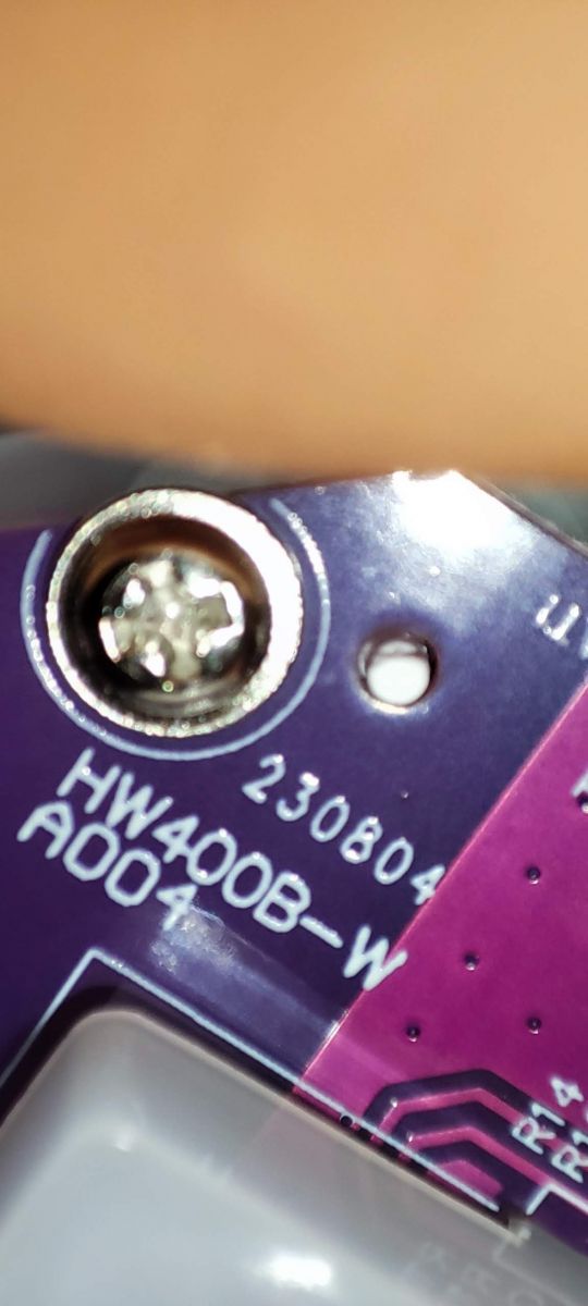

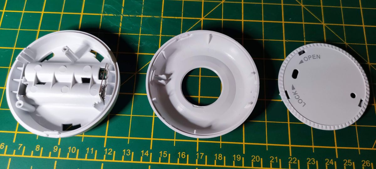

    Not terribly interesting and very easy to flash. Almost identical to this unit here but with A004 revision board. Both devices have the same PCB reference - HW400B-W, not HW4008-W.
    Bought from Cutesliving AliExpress store

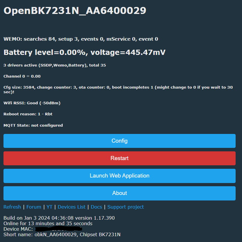

    Screenshot of the OpenBK7231N interface showing device information.

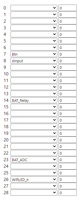

    Screenshot of Tuya device pin configuration.

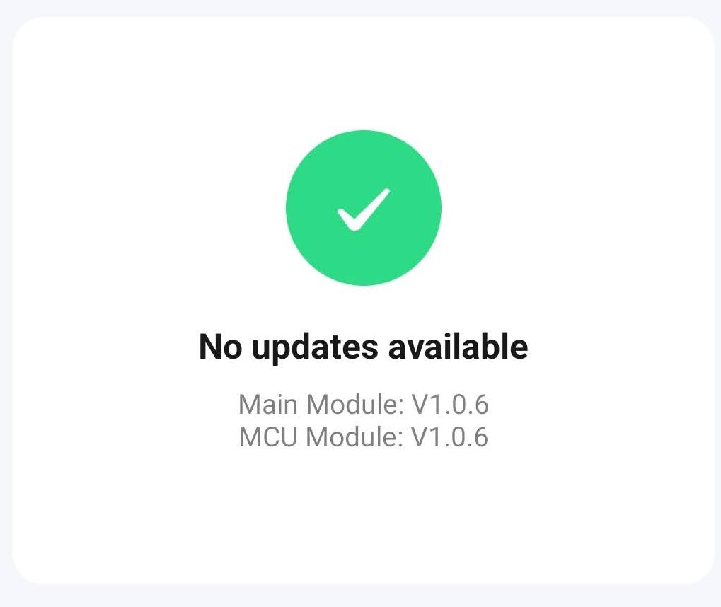

    Looks like Cloudcutter could be an option with this firmware version, but I didn't try
    Message indicating no updates available for modules V1.0.6.

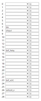

    - Button (channel 0) on P7
    - Status LED on P26
    - PIR sensor on P8
    - Battery Relay on P14
    - Battery Max Voltage: 3000
    - Battery Min Voltage: 2400
    - Battery ADC on P23
    dump attached and uart2 boot log, if of interest.
    and OBK template, if it's worthy of another entry
    I changed pin 8 from "8": "dInput;0", to "8": "DoorSnsrWSleep;0", because that seems to be what it should be?
