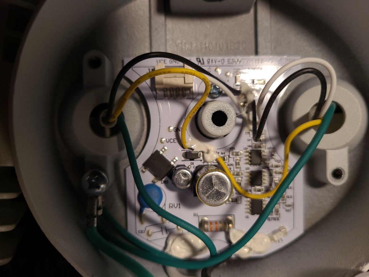

    This is a motion-activated outdoor LED floodlight.
    LED floodlight with two light panels and a motion sensor.
    It features a W3BS module, two CW LED lights, a PIR motion sensor, and an ambient light sensor.

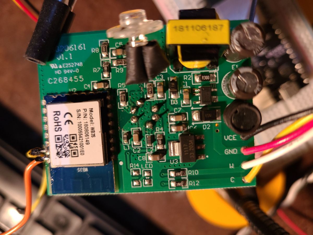

    Close-up view of W3BS electronic module with wires soldered to pins. Close-up of an internal module with wires inside an LED floodlight.
    I was able to solder wires to the RX1 and TX1 pins on the module (as in the photo). The four wires in the lower right (VCE, GND, W, C) lead to a JST connector on the other board. I unplugged this and connected VCE and GND (9V worked, this goes to the AMS1117 regulator). The GND pin of the USB serial adapter was connected to the common ground with the power supply, and the 3.3V pin on the USB adapter was not used.
    I didn't succeed in flashing with the GUI flasher (got stuck immediately on reading 0x00), but was able to flash using "uartprogram" from hid_download.
    The SoC pins are connected as follows:
    P6Motion sensor
    P8LED (cool)
    P9LED (warm)
    P23/ADC3Ambient light sensor
    The motion sensor goes HIGH when motion is detected. The ambient light sensor readings range from 0 (brightest) to 3000 (darkest).

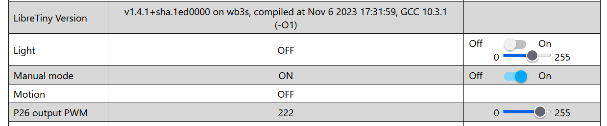

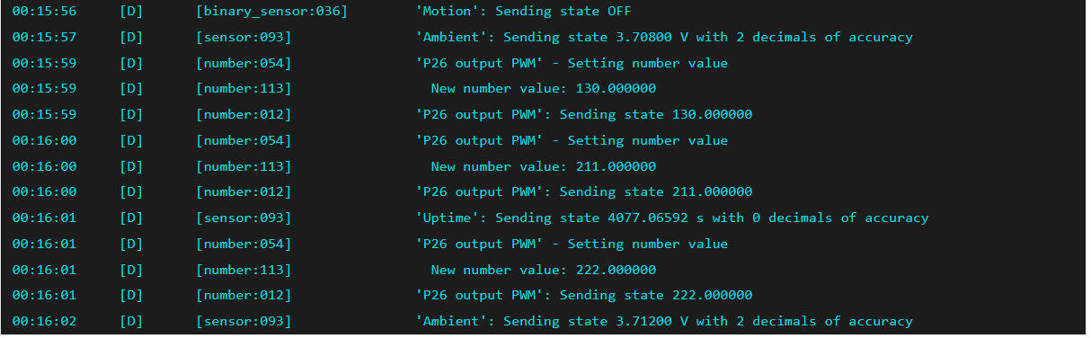

  • ESPHome PWM slider for PIR sensitivity on P26
    #13 20803268
    piotrszulc1
    Posts: 37
    Rate: 8
    I was able to set this up using esphome - I have now a slider that controls exact values to be sent via this PWM.
    Control panel with sliders for device settings using esphome.
    Screenshot of system logs for PIR sensor configuration using ESPHome.
    The esphome yaml contains this:

    At me i have a problem with that lux because is show me max value when is light and zero when is night and on Volts don't go much more then 0.8
    Added after 1 [hours] 21 [minutes]:
    >>20866799
    I don't understand why at me is this and don't go up then 1.88
    [16:17:58][D][sensor:093]: 'Ambient': Sending state 1.57200 V with 2 decimals of accuracy
    [16:18:03][D][sensor:093]: 'Ambient': Sending state 1.87300 V with 2 decimals of accuracy
    [16:18:08][D][sensor:093]: 'Ambient': Sending state 1.88100 V with 2 decimals of accuracy
    [16:18:13][D][sensor:093]: 'Ambient': Sending state 1.88300 V with 2 decimals of accuracy
