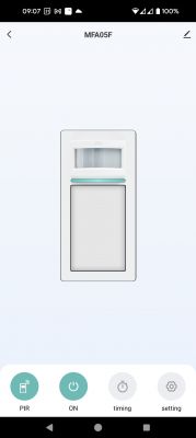

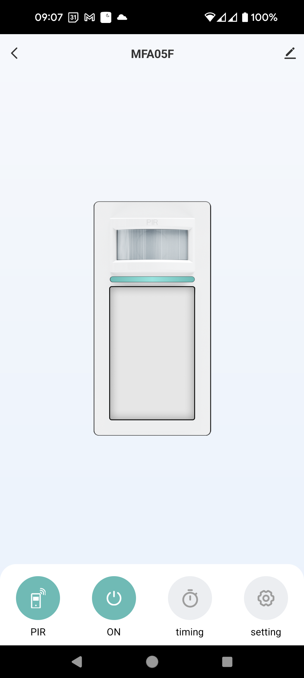

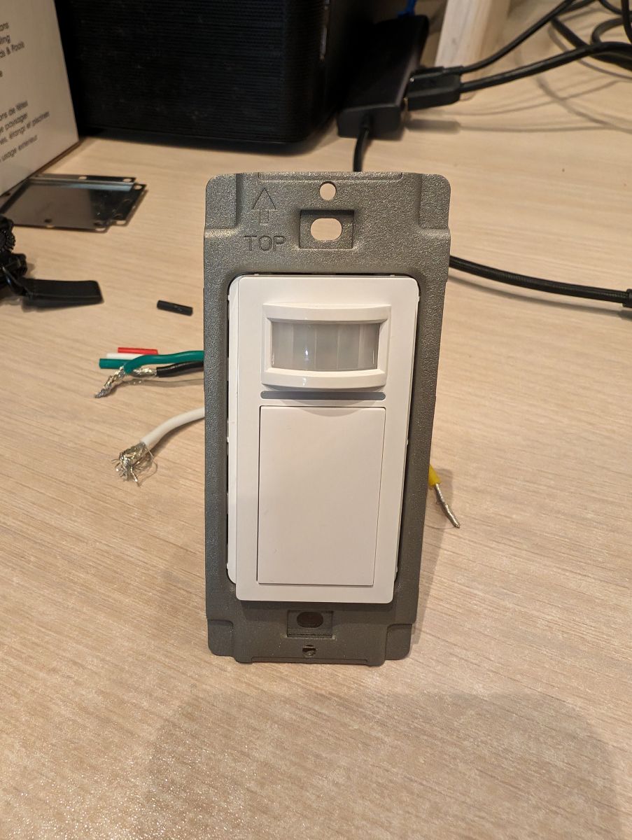

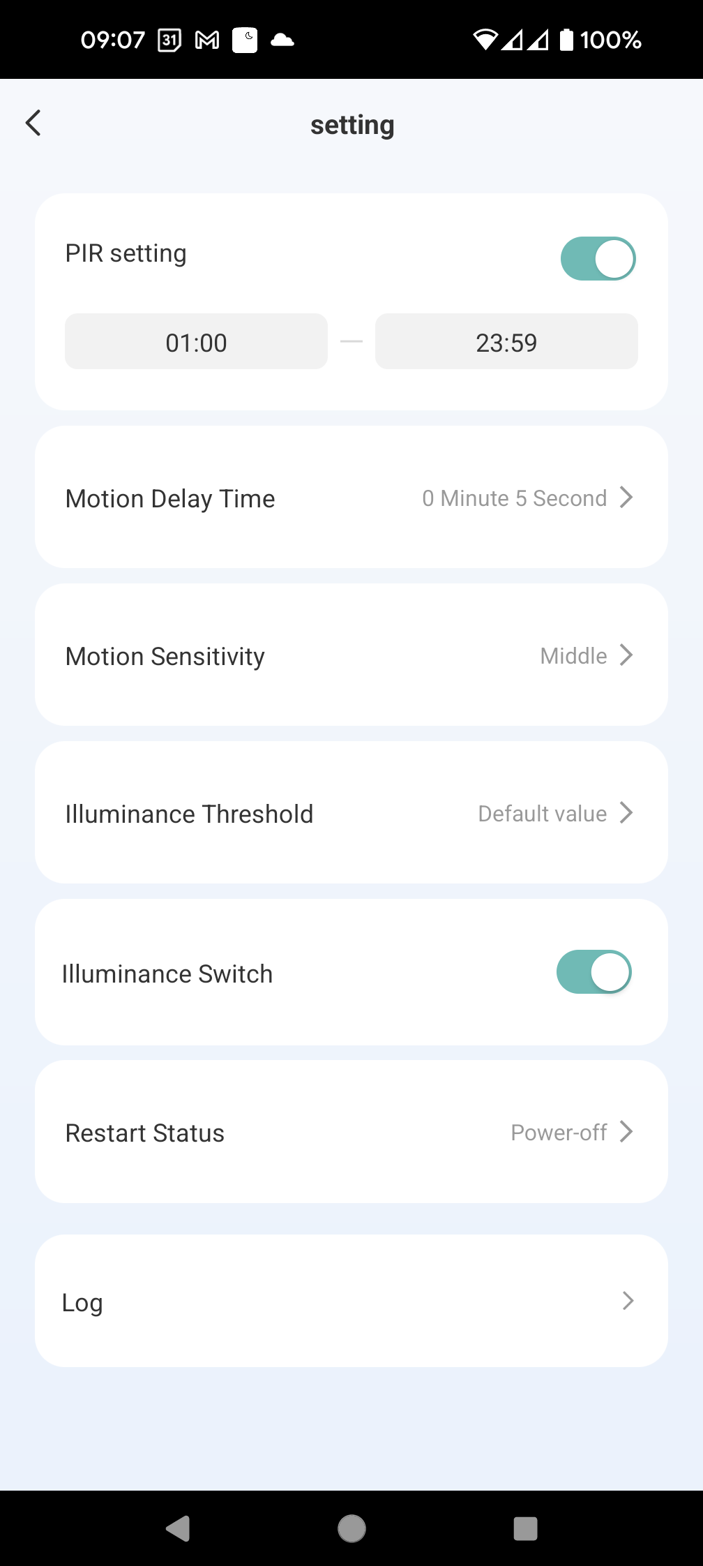

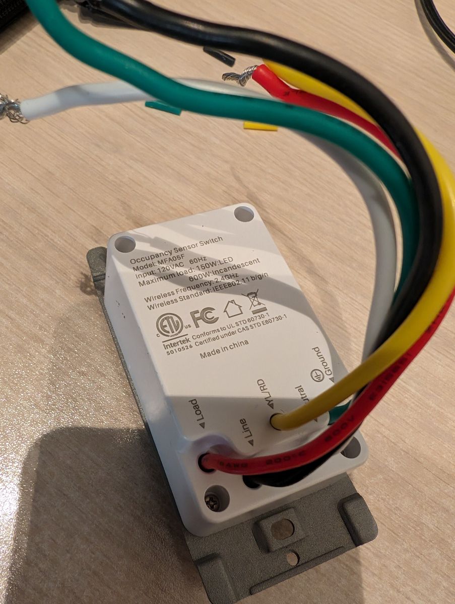

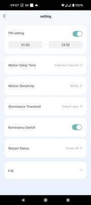

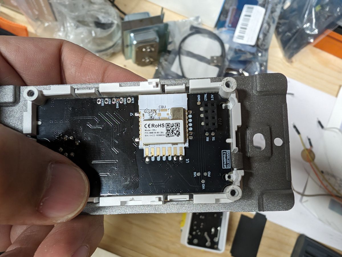

    I recently purchased a few milfra mfa05f motion sensor light switches, they use CBU board with tuya mcu.
    All issued fixed now! Here are some photos, screenshots, dpids and autoexect.bat
    MILfra MFA05F motion sensor light switch. Motion sensor light switch model MFA05F with connected wires. Close-up image of the inside of a light switch enclosure. PCB board with electronic components and connected wires Close-up of an electronic board above a motion sensor light switch. Circuit board with mounted electronic components and a button. Smart switch packaging with Google Assistant and Amazon Alexa logos. Photo of MFA05F light switch box with Wi-Fi option checked. MFA05F motion sensor light switch interface on a phone screen with PIR, ON, timing, and setting icons. Screenshot of motion sensor light switch settings in a mobile app.

  • PIR sensor requires local time to operate
    #5 21062811
    gokeeper
    Level 4  
    Posts: 9
    It isn't randomly work or not, it suddenly stopped working. I just found out it's because I didn't set local time, since the pir sensor will only work at centain time of the day (dpId 102 and 101). All good after I add tuyaMcu_sendCurTime.

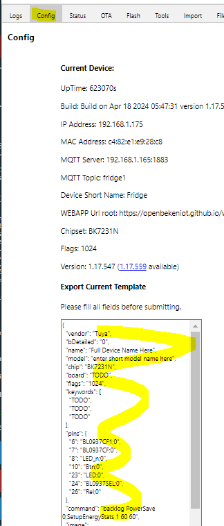

  • #8 21063862
    Posts: 5236
    Help: 450
    Rate: 920
    gokeeper wrote:
    Yes, feel free to add the data to the device database.
    please post your device template from web app
    Screenshot from a web application showing device configuration.
  • #9 21063865
    gokeeper
    Level 4  
    Posts: 9
    divadiow wrote:
    This is a mcu device, I have included autoexec.bat in OP.
  • #10 21063870
    Posts: 5236
    Help: 450
    Rate: 920
    indeed but the template makes adding the device to device list easier
    #11 21063907
    gokeeper
    Level 4  
    Posts: 9
    Got it, here it is
      "vendor": "Tuya",
      "bDetailed": "0",
      "name": "Milfra MFA05F Motion Sensor Light Switch",
      "model": "MFA05F",
      "chip": "BK7231N",
      "board": "CBU",
      "flags": "1024",
      "keywords": [
        "Milfra",
        "MFA05F",
        "Switch",
        "Motion Sensor",
        "BK7231N",
        "CBU",
        "MCU"
      "pins": {},
      "command": "",
      "image": "https://obrazki.elektroda.pl/9024105700_1714244652.jpg",
      "wiki": "https://www.elektroda.com/rtvforum/viewtopic.php?p=21063870#21063870"

    Has anyone been able to flash this via serial without removing the chip? I received one that has firmware 2.1.17 so unfortunately I can't flash with cloudcutter. I have been trying to use ltchiptool, but it never connects to the chip. Connecting CEN to GND for 1/2 second seems to reset it since the light blinks, but no matter how many times I do it, ltchiptool never connects.
  • #18 21153171
    Posts: 14797
    Rate: 12954
    This is TuyaMCU device. You can't really flash it as it is. You need to either remove the WiFi module, or remove the MCU, or cut the connection to MCU.
    Alternatively, if you can, and know how, you can put MCU in the RESET state for the time of the flashing.

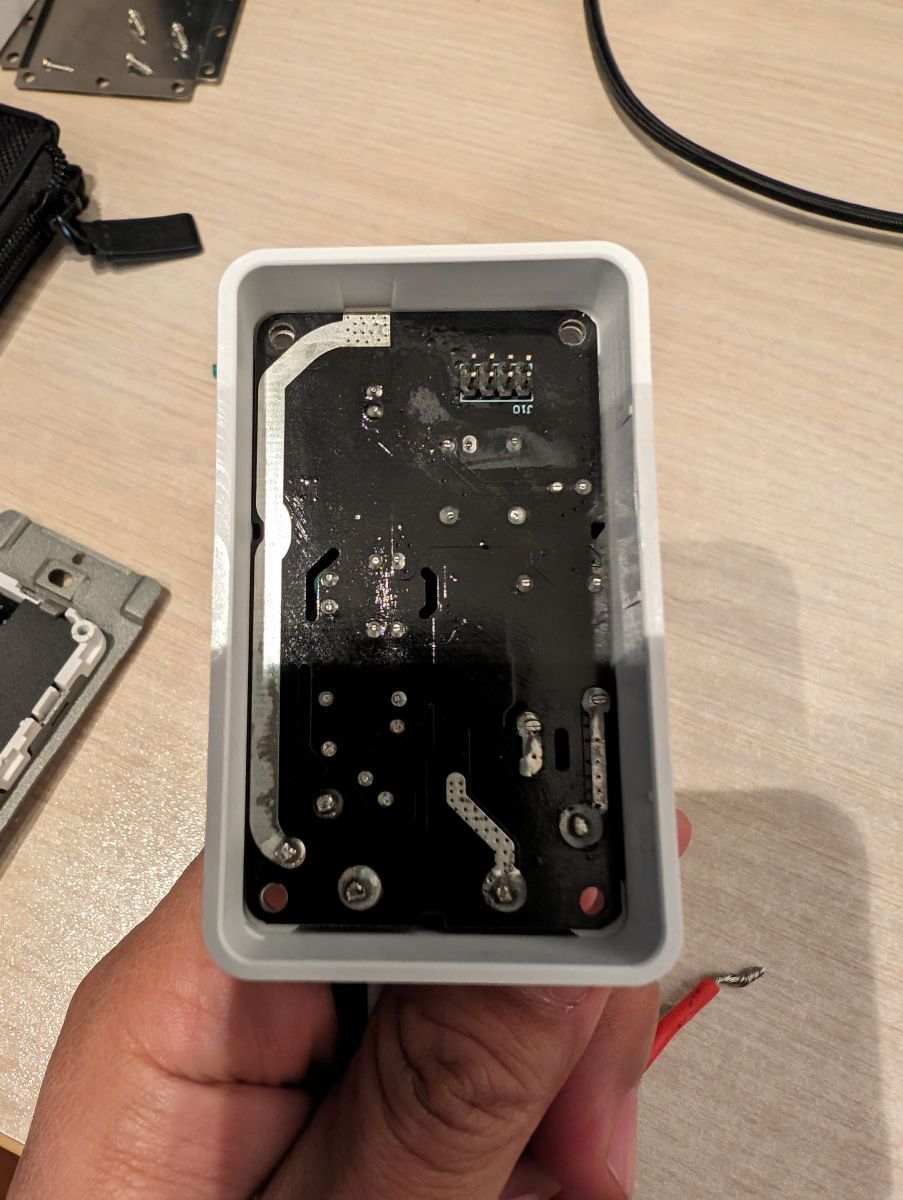

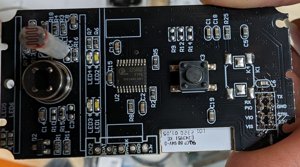

  • RST-to-GND boot mode enabled flashing
    #21 21154883
    DexEdson
    Level 4  
    >>21153264 It worked! There is a spot labeled 'RST' on the board. I kept it connected to GND during power on. Then I tapped CEN to GND a few times and eventually ltchiptool started flashing.
    I was hoping to be able to read the motion sensor data without triggering the relay, so I could use this switch on a circuit with smart bulbs. Unfortunately everything seems to be hard coded into the MCU. I installed ESPHome and set logging to verbose, but no datapoint is logged for motion detection. I'm still glad I was able to cut the cloud, I'll just have to find a different use for this thing.

  • PIR sensitivity is MCU-controlled on this version
    #23 21156163
    DexEdson
    Level 4  
    >>21155031 There is a PIR sensitivity setting through the MCU. I wouldn't even need to move the relay... as long as the PIR is disconnected from the MCU and directly accessible from GPIO, the relay can be controlled by automation. But this is getting too complex for me, too bad this version is not as simple as the original MFA05. If anyone knows where to get the original MFA05 with the ESP board, please let me know!!

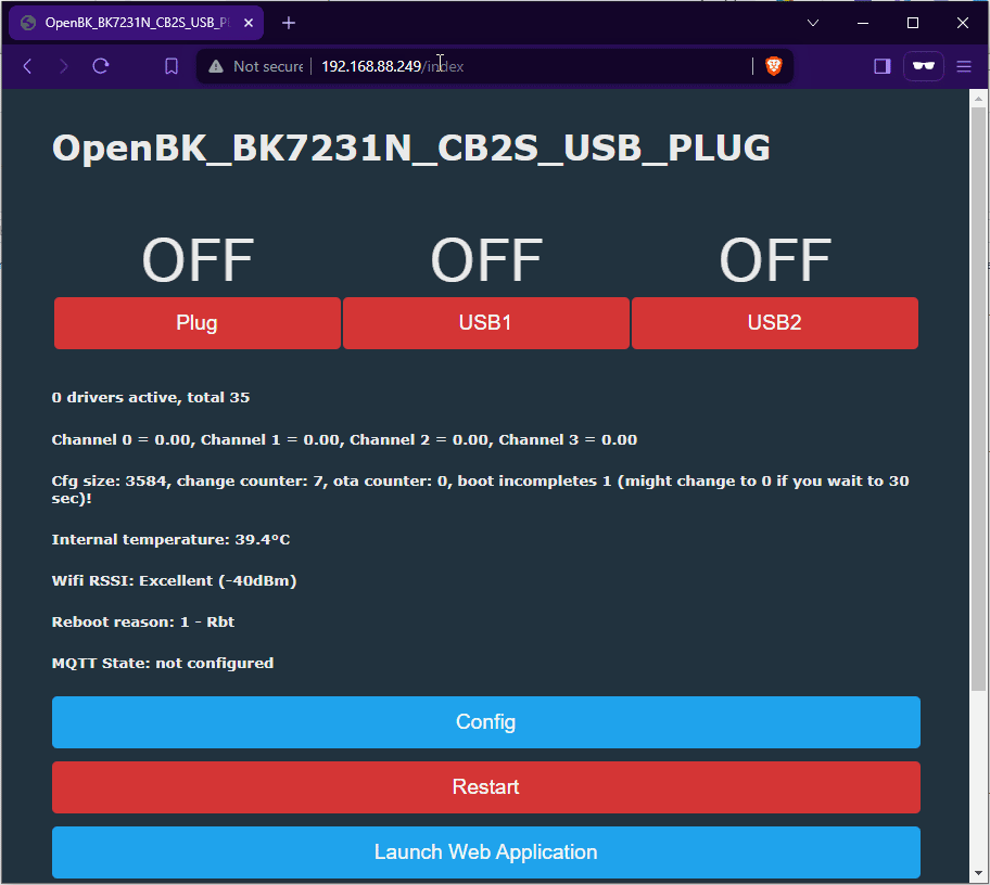

    Posts: 5236
    Help: 450
    Rate: 920
    I can try to confirm existing info/get missing with full firmware backup or config extract.

  • Serial flashing attempts used the connector with TX/RX, GND, and 3.3 V, but one user only succeeded after grounding the board RST point and pulsing CEN. [#21154883]

Why does the PIR sensor on the Milfra MFA05F stop working until tuyaMcu_sendCurTime and the DP 101/102 time window are set correctly?
The PIR stops because the MCU enforces an internal time schedule. The fix was not MQTT itself; it was sending local time with tuyaMcu_sendCurTime and keeping dpID 102 start time plus dpID 101 end time valid. The user confirmed the switch “suddenly stopped working” because local time was missing, and motion resumed after time sync was added. A full-day schedule was sent as start 1 min and end 1440 min. [#21062811]

What is the CBU module in a BK7231N switch, and why does it matter for flashing and configuration?
The CBU is the Wi‑Fi module fitted in this switch, and it matters because you flash that module, not the whole motion-control design. "CBU" is a BK7231N-based Wi‑Fi module that runs the network firmware, while a separate MCU still controls relay and sensor behavior through serial communication. That split explains why flashing OpenBeken alone does not automatically expose PIR as a direct sensor. The posted template names the board CBU and chip BK7231N. [#21063907]

How can I troubleshoot a flashed MFA05F where the relay works from the browser but the PIR and brightness sensor do not respond?
First, verify time sync and the PIR schedule. 1. Add startDriver NTP, set an NTP server, and call tuyaMcu_sendCurTime. 2. Send valid dpID 101/102 active hours. 3. Explicitly set PIR sensitivity and delay at least once. The failure pattern in the thread was clear: relay control worked from the browser, but PIR and light-sensor behavior failed until time and schedule were corrected. Another user later said PIR sometimes still needed dpID 101/102 adjustments or a reset. [#21243160]
