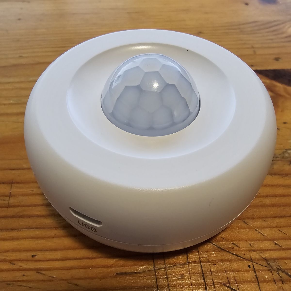

  • Hello,
    I would like to present teardown and my user experience of this module:
    Tuya Light + PIR Motion Sensor (FH_PIR_400A) --> AliExpress-Link

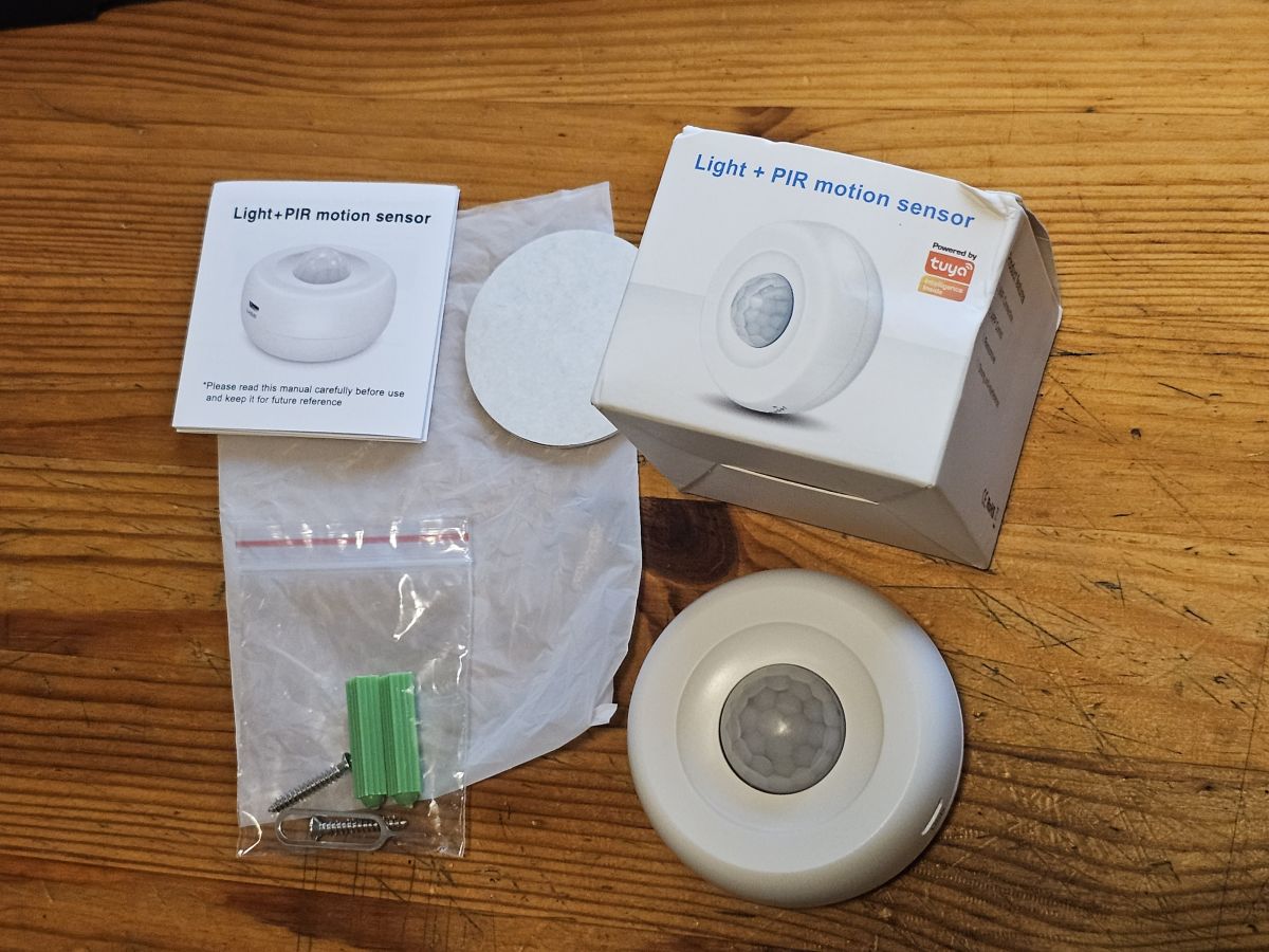

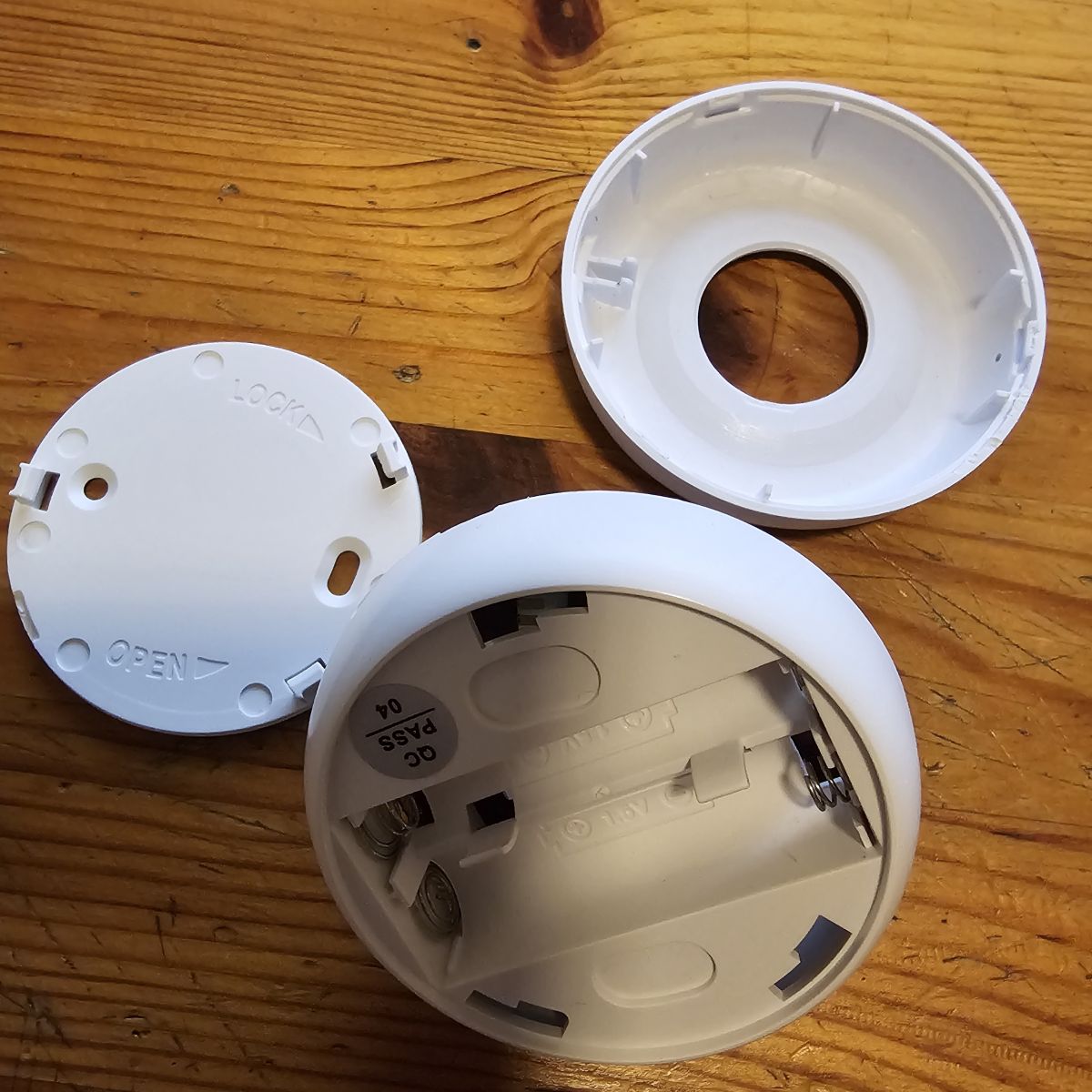

    First, some photos of package and content:

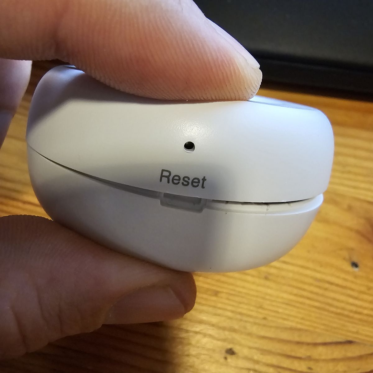

    White, round PIR motion sensor with USB port, placed on a wooden surface. Tuya product box with a barcode and Tuya logo. Technical parameters from Tuya motion sensor packaging Packaging and contents of the Tuya PIR motion sensor kit
    Pry to open carefully under reset button, then insert some flat tool to separate the two halves of housing by stretching the gap:
    Close-up of a hand holding a small white device with a reset button on the casing.

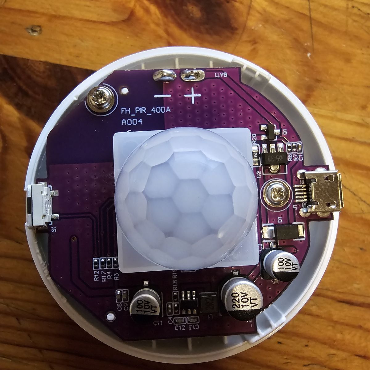

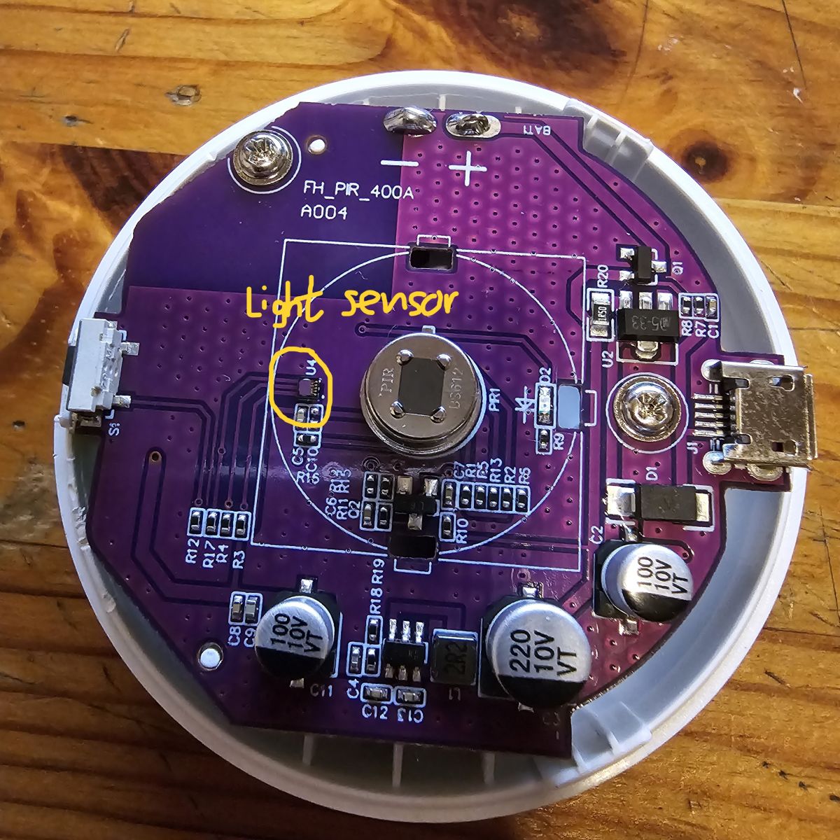

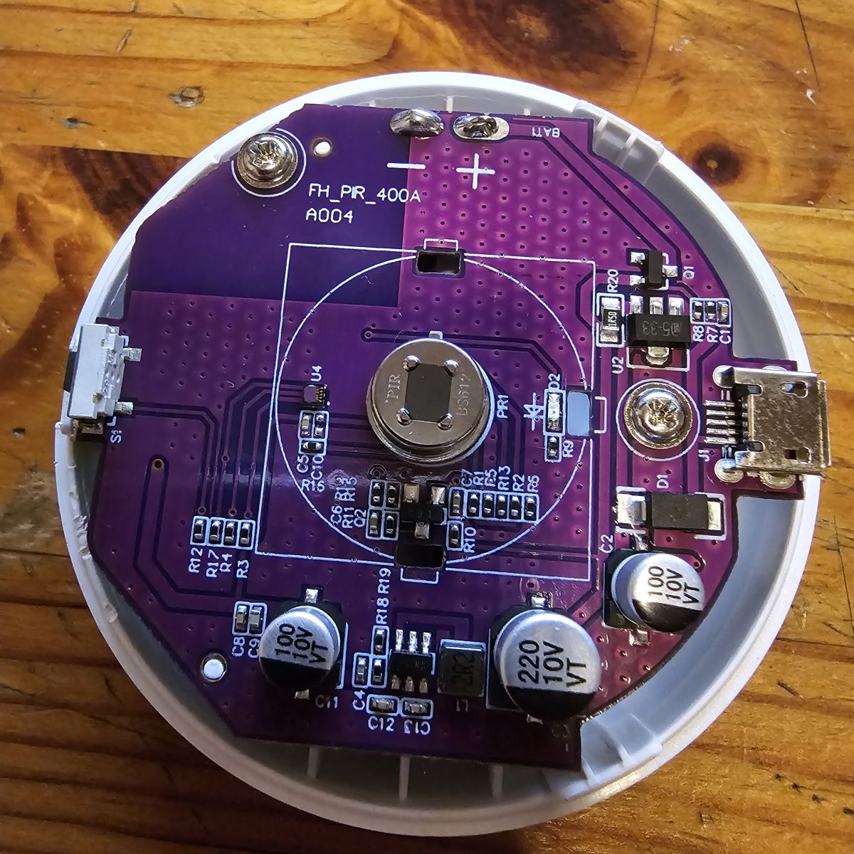

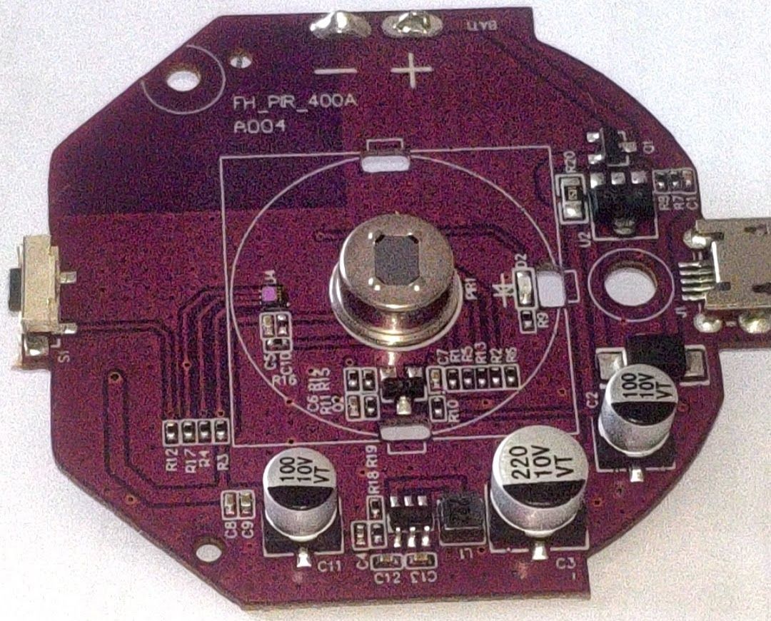

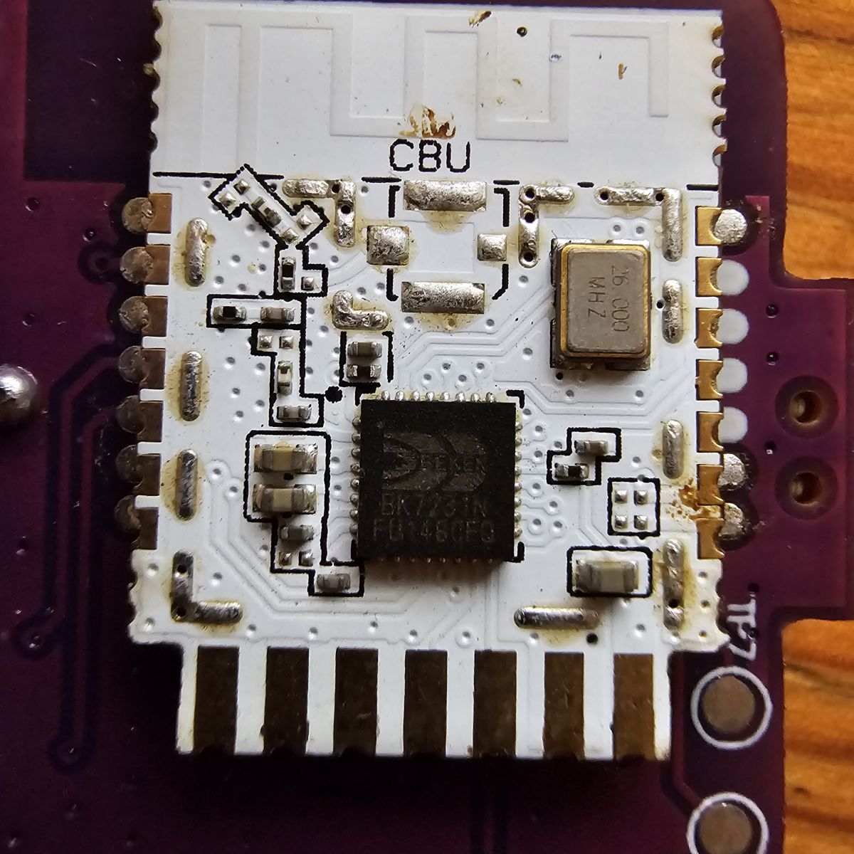

    Now have a look at parts and module:
    Disassembled housing of a motion and light sensor. PIR sensor module in an open casing, showing electronic components. Tuya module PCB with microphone and MicroUSB port Electronic module on a purple PCB with a CBU component. Close-up of a circuit board with a CBU module and BK7231 chip.
    We have a very similar module in this post: https://www.elektroda.com/rtvforum/topic3982613.html
    But here we have a CBU module and an additional light sensor which can measure light intensity by Lux at a range between 0 ~ 6500, give or take:
    Interior of the module with a labeled light sensor on the circuit board.

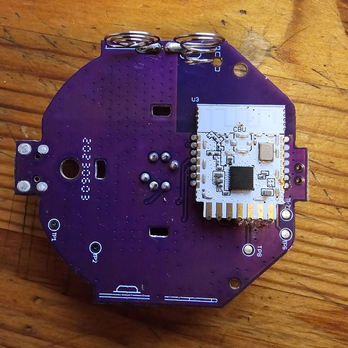

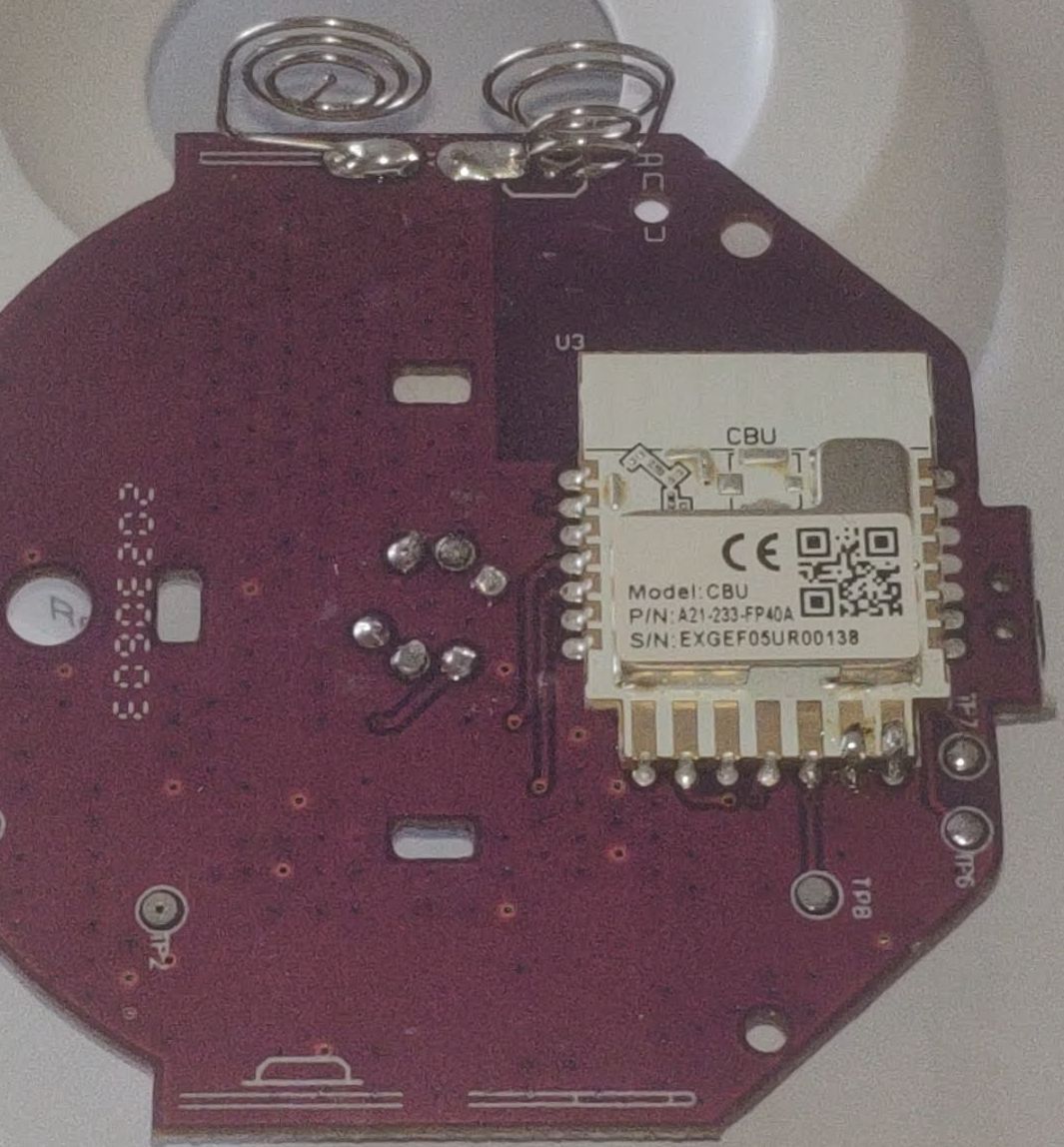

    A few things about device and flashing:
    - it is not a TuyaMCU device
    - there is no need to cut connections or desolder CBU module
    - flashing works flawlessly with bk7231flasher Windows tool
    - the device can be powered with 2xAAA batteries, which makes sense with deep sleep driver (Door Sensor function)
    - it can also be powered with 5V via MicroUSB
    - the reaction time until Wifi is connected and status reported with OpenBK deep sleep is about ~5 seconds
    - without deep sleep the Wifi connection is kept stable and it reacts instantly on motion
    - After detecting motion, it changes to "Clear" within ~5 seconds when no further motion is detected
    --> edit: I have bought several of those devices, and actually only the first one I bought has this fast clearing of motion interval, all the others take 30 seconds to change the status to "Clear" when no further motion is detected.
    I was able to assign following functions to pins:
    P8: motion detector --> dInput(_n) / DoorSnsrWSleep (whichever suits better)
    P16: LED --> LED(_n) / WifiLED
    P23: Battery --> BAT_ADC (choose different channel here)
    P24: Reset Button --> btn
    bkflasher was unable to extract information from original firmware read.
    Here is the file: Tuya_Motio...Sensor.bin (2 MB)You must be logged in to download this attachment.

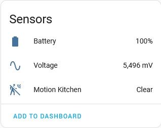

    Home Assistant discovery works on the spot:
    Sensor widget displaying battery status, voltage, and motion sensor status.

  • #2 20722881
    Posts: 14754
    Rate: 12875
    So U4 is a light sensor? Are you able to check with multimeter to which GPIO it connects to? It looks like it might have two data lines, is it possible it's something like a I2C sensor?
  • Three PWM pins connected to the light sensor
    #3 20723965
    auntlydia
    Posts: 70
    Rate: 15
    Hi, thanks for your reply!

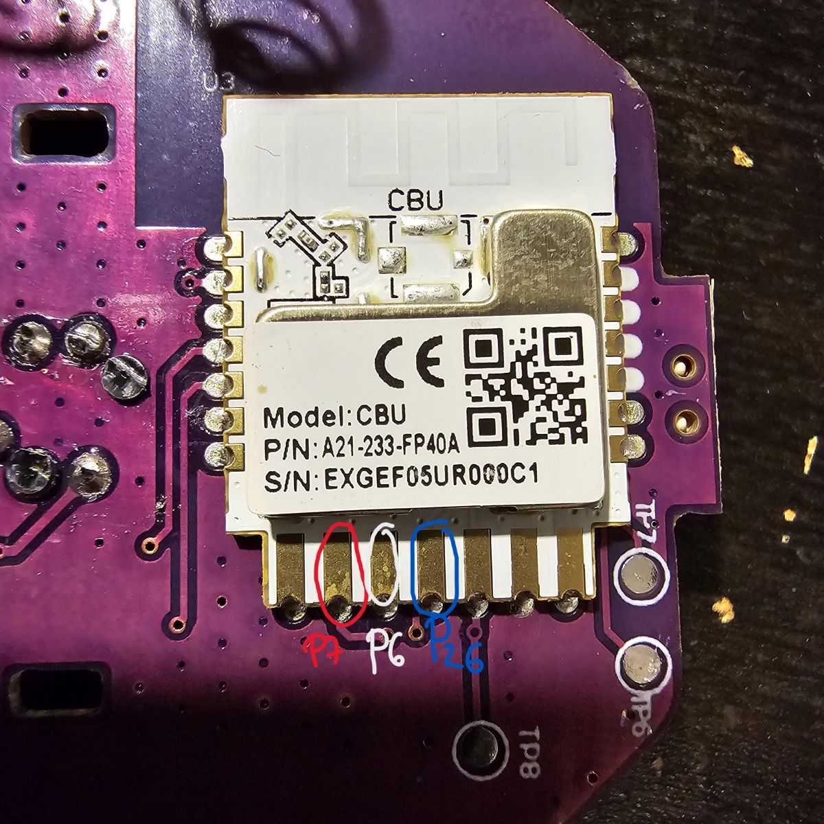

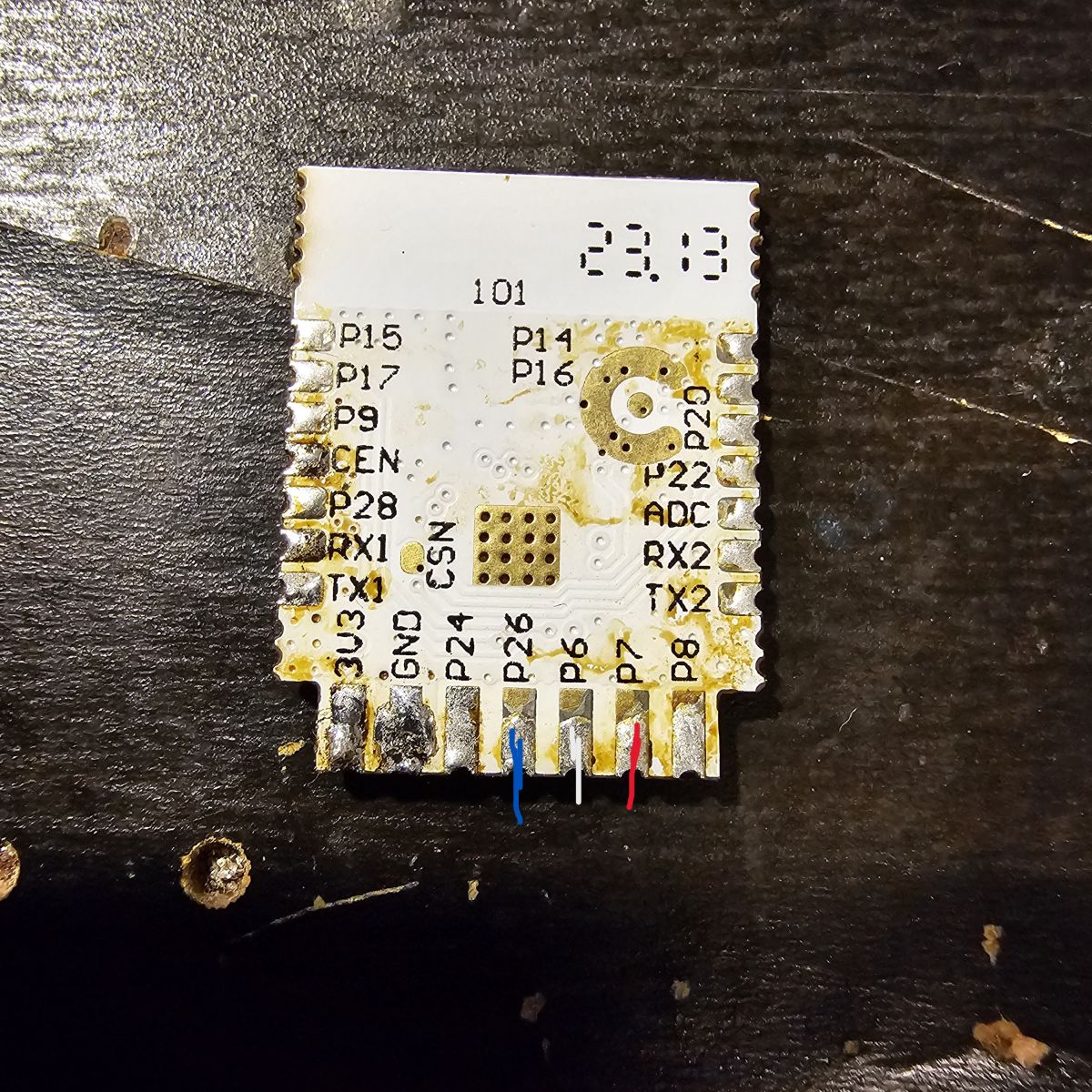

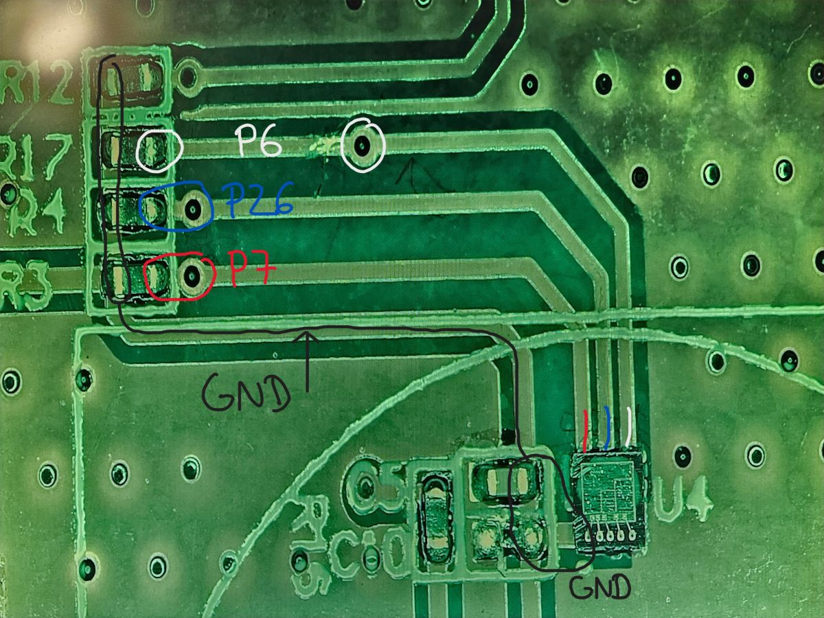

    I was able to trace back the connections, there are 3 connections directly to CBU pins! That is very interesting!!
    Let's have a look:
    Image of a PCB with marked pins P6, P7, P26, and GND. Electronic module with marked pins P6, P7, and P26. Close-up of a PCB with pins labeled with various symbols and colored wires.
    The connections arrive at P6, P7, and P26 of CBU, which are all PWM pins. The other side of the light sensor is connected to GND.
    I am not sure about I2C... until today I had no knowledge about it but read a bit and understand that there are two data lines (SDA and SCL), between the host (main device) and slave (sensor). We seem to have three lines here, all of which are data lines.
    Can you make something of this information? Thank you.

    Maybe we can search for I2C light sensors online and see if there are any similar to the one you have on the board.

    i have ordered this PiR Sensor:
    [BK7231N] [CBU] Tuya Light + PIR Motion Sensor (FH_PIR_400A)
    Inside it contain LED, BUTTON, PiR sensor, Battery monitor and Light sensor (U4 on the board):
    Electronic module with PiR sensor and various components on a purple PCB CBU module on red printed circuit board with visible test points.
    The device build on TUYA CBU module and contain testpoints TP6 and TP7 (Tx and Rx) from the module. I cannot re-flash it with tuyacloud, only with BK7321 Flash tool. Also, non Flash tool, not tuya cloudcutter cannot extract tyua template (the Tyua firmware attached)
    From my investigation i found connection for this device:
    P8 - PiR sensor
    P16 - LED /WiFi LED
    P24 - Button
    P23 - Batt ADC (coefficient 1.97 work fine for me)
    P22 - Batt Relay
    P6 - I2C clock
    P7 - I2C data
    P26 - programmable interrupt from light sensor, when the light strong(over the range), the signal fall down

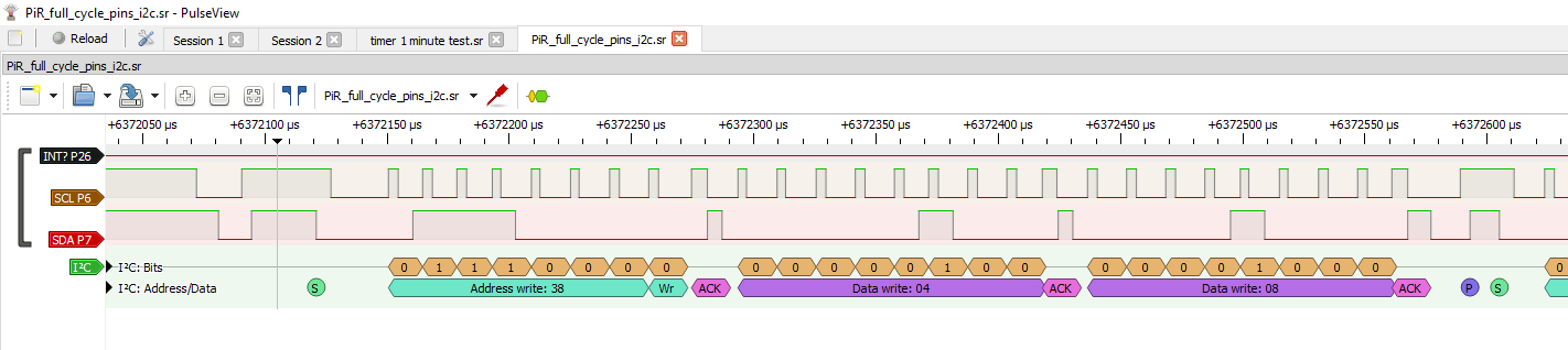

    It seems that I2C address is 38:
    Screenshot from a logic analyzer showing I2C signals with addressing and data writing.
    I've read on the other thread that it may be LTR303, but it doesn't seem to match:
    https://github.com/automote/LTR303/blob/master/LTR303.h
    Also the addresses they write to seem different, but maybe I am wrong?
    Do you still have logic analyzer hooked up? I could write some basic code with LTR303_PART_ID request so we can tell whether it's LTR303

    Yes, the slave address doesn't match. But pinout exactly fits. I also looked for all LiteOn sensors and cannot find 0x38.
    Maybe something is wrong with my analyzer, it's a simple $5 board. I have a Keysight at work, but it will be next week.
    Is it possible to scan addresses in OBK?
  • #13 20725244

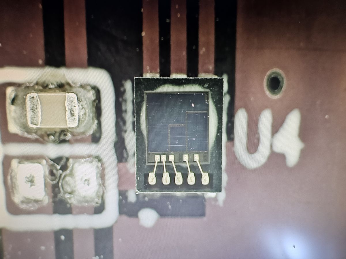

  • 5-pin sensor package likely matches a 6-pin SMD part
    #15 20725894
    auntlydia
    Posts: 70
    Rate: 15
    Wow! This is a really cool idea, to add weather sensors and extend the function of this sensor board. Could you share your project here in this thread and explain how you do it? I would be interested to follow the progress...
    @p.kaczmarek2 , thanks for combining our topics! :)
    Added after 3 [hours] 5 [minutes]:
    I was trying to find the sensor again with google search, found some similar ones but that one seems hard do get. I will try to ask a Chinese friend if they can find it in Chinese internet.
    I want to share another photo I took under the microsope. We have 5 internal pins inside the sensor, and it looks like the SMD package has 6 pins, 3 on each side, similar to the LITEON one.. in my photo it looks slightly rectangular, but actually it is square shaped! (display problem)
    Close-up of a sensor on a PCB under a microscope.
    maybe wil fill find it still!

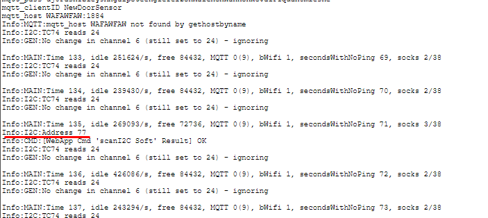

    I2C scanner works:
    Screenshot of a system log showing information about I2C scanning with device identification.
    Usage:
    1. set SoftSDA and SoftSCL pins
    2. use:
    startDriver I2C
    scanI2C Soft

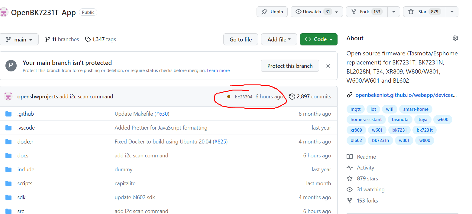

    I just realized something...
    Can you update OBK now and try again?
    I am sure you had incomplete version of the scanner:
    Screenshot of a GitHub repository page showing the OpenBK7231T_App branch.
    I committed it 6 hours ago but the push didn't go trough.

    this is what I get now:
    Info:I2C:Address 0x38 (dec 56)
    Info:CMD:[WebApp Cmd 'scanI2C Soft' Result] OK
    is that helping in order to make the sensor working?
  • I2C scan confirms 0x38 and 0x76 devices

    I'm also get 0x38.
    I have tried find device by datasheets with this address, and cannot.
    We need wait, or do some reverse engineering with logic analyzer, to find some commands, we can operate.
    @p.kaczmarek2 : I have add another I2C device on the bus (BMP280), and i cannot get results. Is scan support only one device?
    In electronics are no miracles, just bad contacts :)
    I can see 2 devices on the bus:
    Info:I2C:Address 0x76 (dec 118)
    Thanks,

    This tells us it that it's really an I2C device.
    The next question is - which I2C device is it?
    Which I2C sensor looks like it and has 0x38 address?
    Added after 7 [minutes]:
    Maybe I should implement basic read for LTR303 and we will see how it goes?

    dgel27
    Posts: 19
    It possibly to try, but registers addresses not fit.
    More closer registers adresses in LTR-390, LTR-381RGB, LTR-308, LTR-216, but also not fit that i see in logic analyzer.
    VISHAY have different pinout and different command sysytem - it uses 2 different addresses for read and write (0x38 and 0x39)
    But anyway, i think we have progress, if not in this device, but in full firmware.
    If we can detect device, it possible add many different drivers, and automatically add detected devices to the bus.
    This concept brings OBK to all development possibilities, not just devices present on the market currently.
    OK, we cannot find currently what is device with 0x38 address, ok, it possible order breakout board with known sensor, solder 4 wires... and WOW... we have additional light sensor, that works, and non-works wait for future use....
    Thanks!
