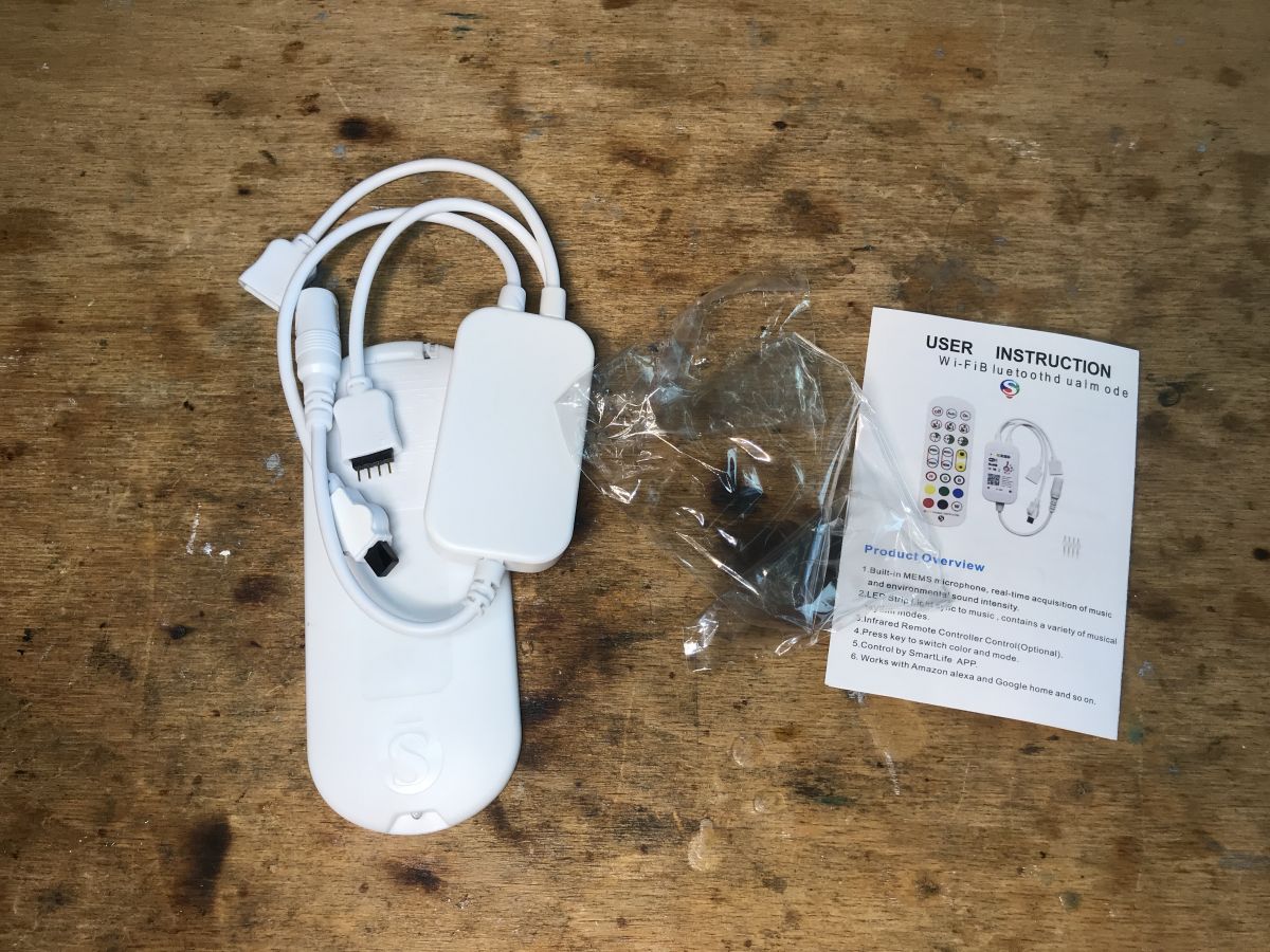

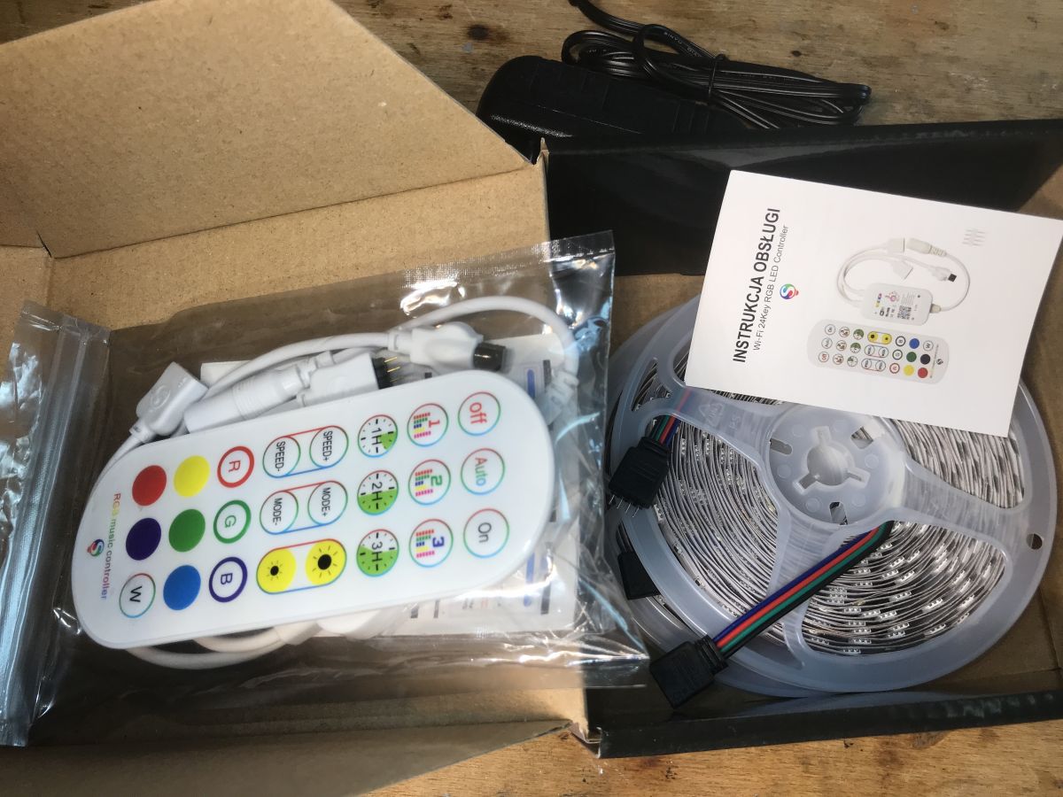

    Now let`s see what we get in practice. Packaging and markings:
    Packaging of Appio Strip 7331 RGB LED with WiFi and Bluetooth controller. Appio Strip 7331 LED strip packaging Packaging of the Appio Strip 7331 LED strip set with visible labels and specifications.

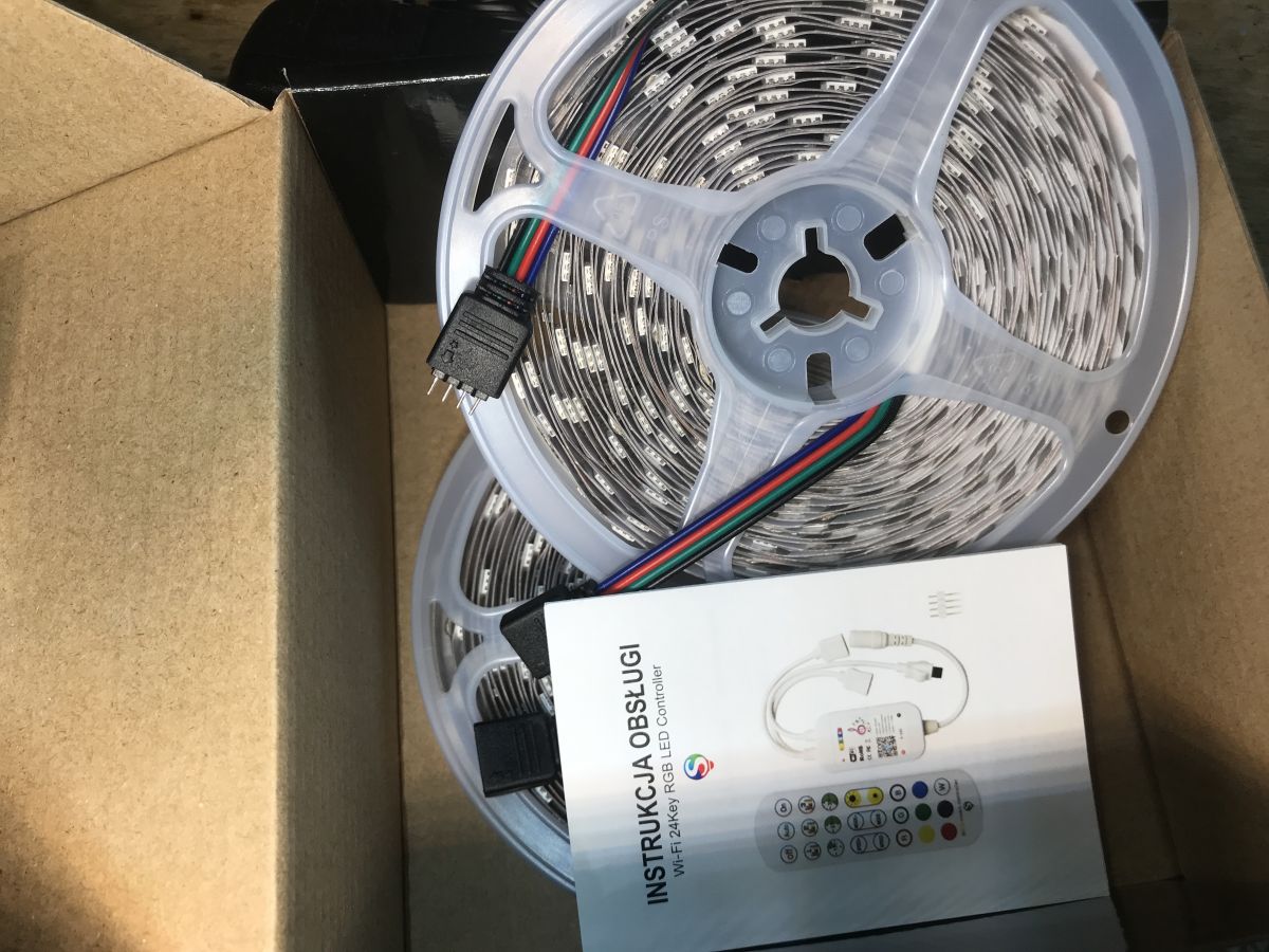

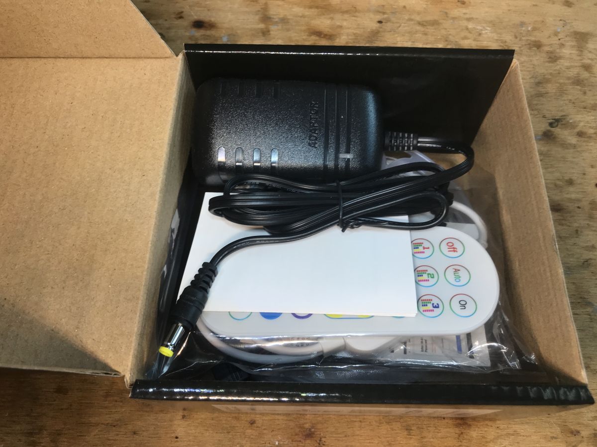

    The contents of the set... not bad, there`s even a power supply:
    Contents of the RGB LED strip box, including user manual and remote control. Appio Strip 7331 kit includes a power adapter and remote control. Contents of the box with LED strip and remote control
    Appio Strip 7331 RGB LED Controller with manual and cables

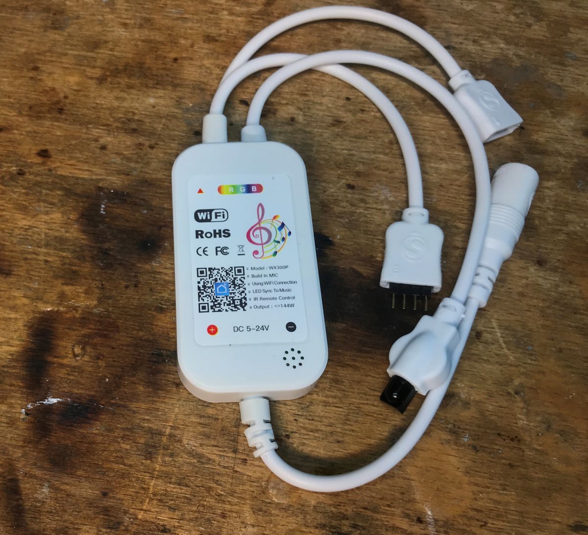

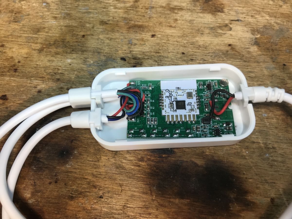

    The interior of Appio Strip 7331
    And here is our controller:
    RGB LED strip controller with informational sticker and attached cables.
    We remove the cover (just pry it off):
    Interior of Appio Strip 7331 controller with visible wires and module

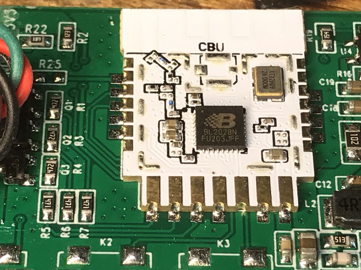

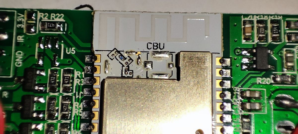

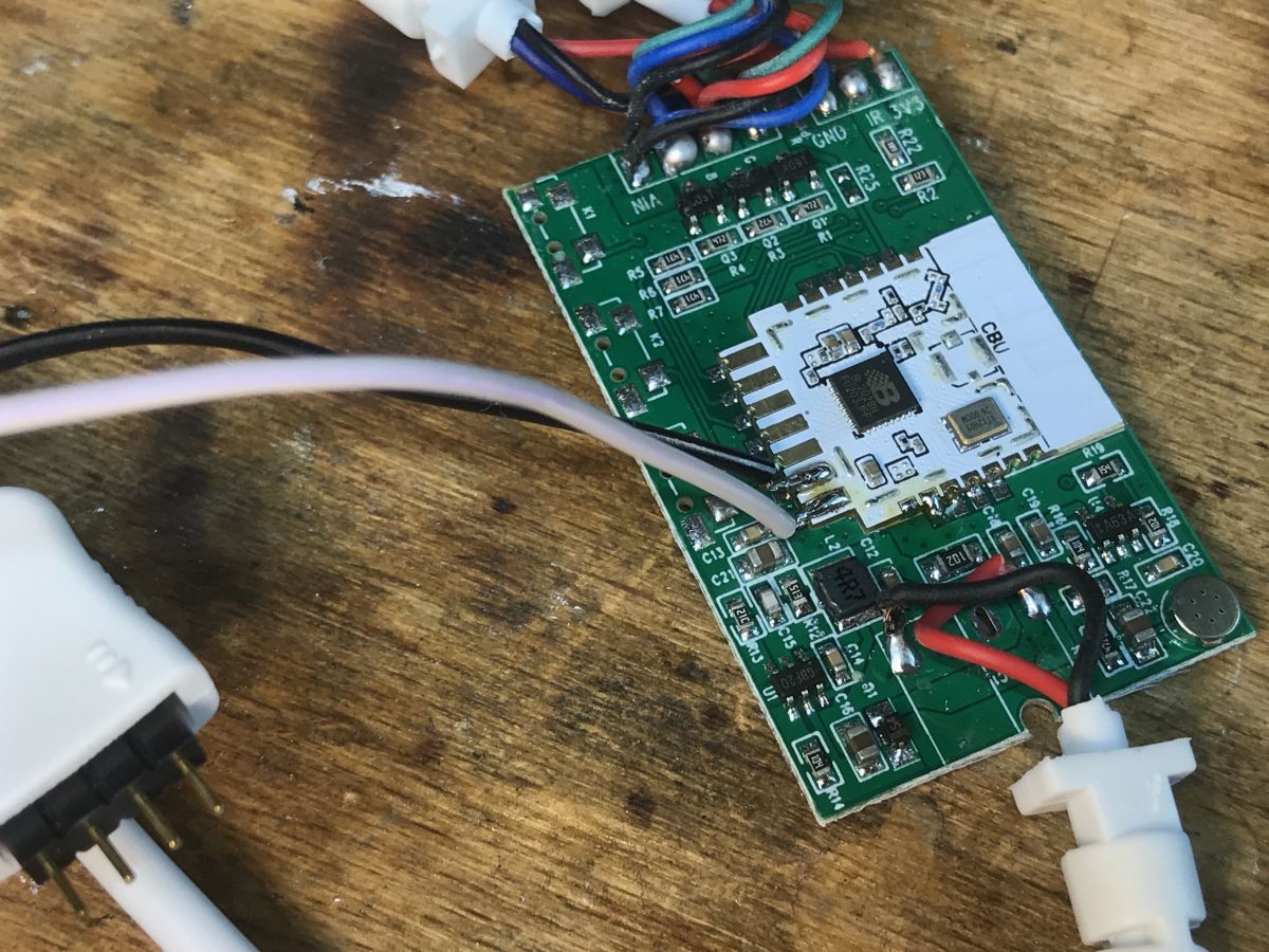

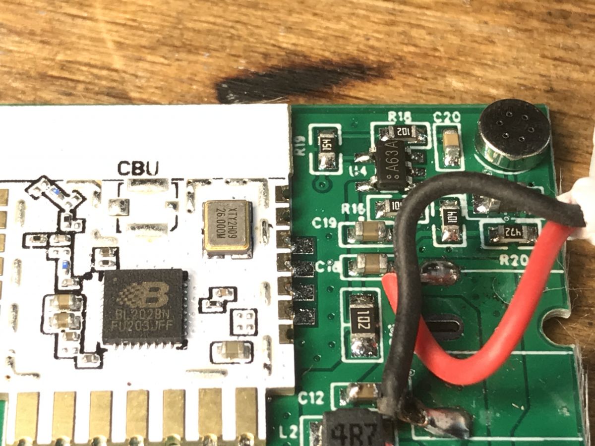

    Inside there is a CBU module, known for having the BK7231N on board, but here it is in the BL2028N version:
    Close-up of the interior of a control panel showing the CBU module and BL2028N chip.

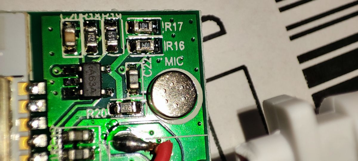

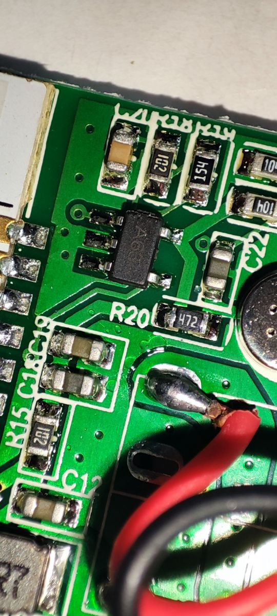

    Here you can see a microphone, probably connected to P23 from BK, i.e. ADC:
    Close-up of a controller module with BL2028N and CBU chips on a PCB.

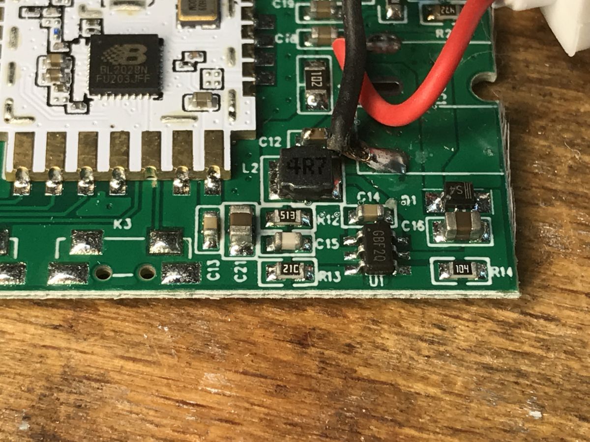

    Below you can see the step down converter, can anyone decipher the GBF20 marking? It converts 12V from the belt into 3.3V for the WiFi module:
    Close-up of the LED strip controller PCB with the BL2028N module.

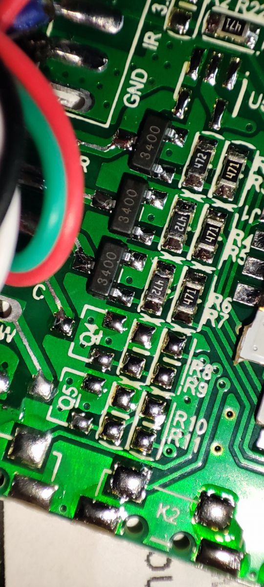

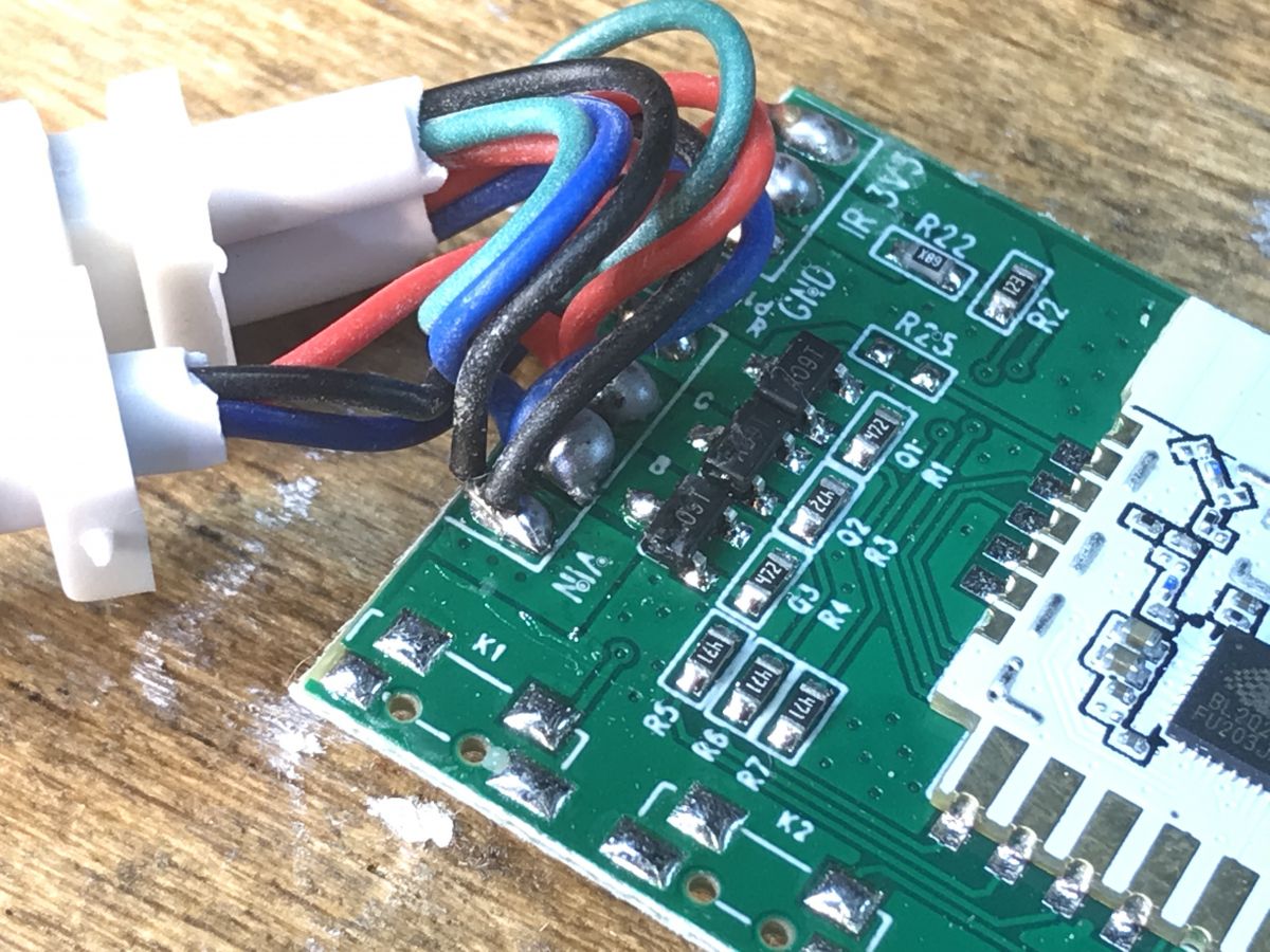

    And here we have transistors, this is the RGB strip, i.e. three colors:
    Close-up of a PCB with RGB wires.

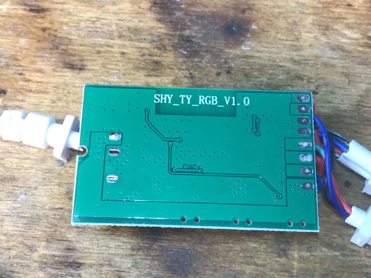

    The bottom of the PCB is quite poor:
    Bottom of the Appio Strip 7331 LED controller PCB
    Designation: SHY_TY_RGB_V1.0.

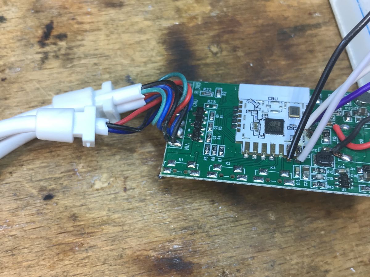

    Appio Strip 7331 firmware change
    According to CBU documentation:
    https://developer.tuya.com/en/docs/iot/cbu-module-datasheet?id=Ka07pykl5dk4u
    and flasher instructions:

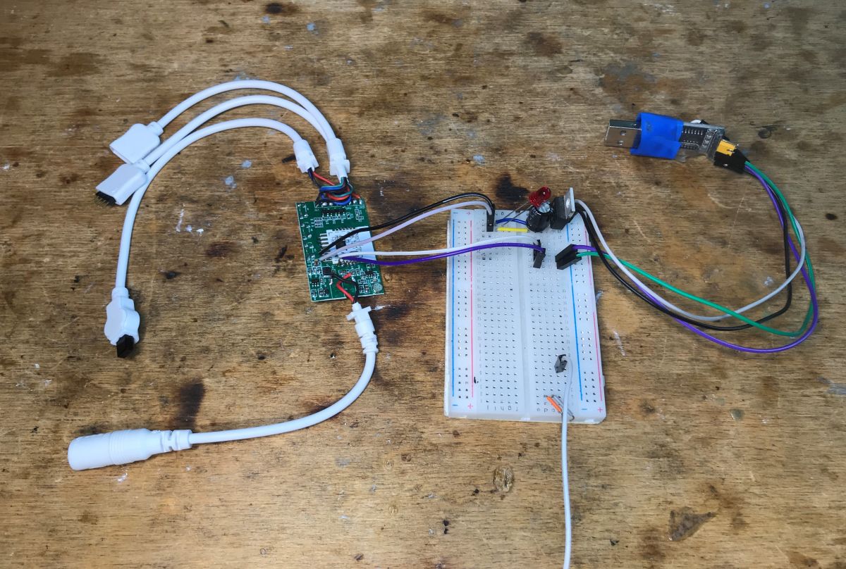

    We solder four wires, ground, 3.3V, RX and TX. We copy a 2MB copy of the batch and then upload the OBK with flasher:
    Close-up of the interior of the Appio Strip 7331 controller with exposed circuit board. LED controller setup on a workbench

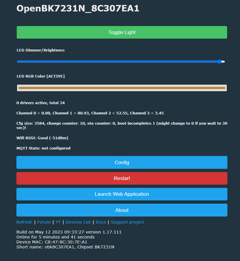

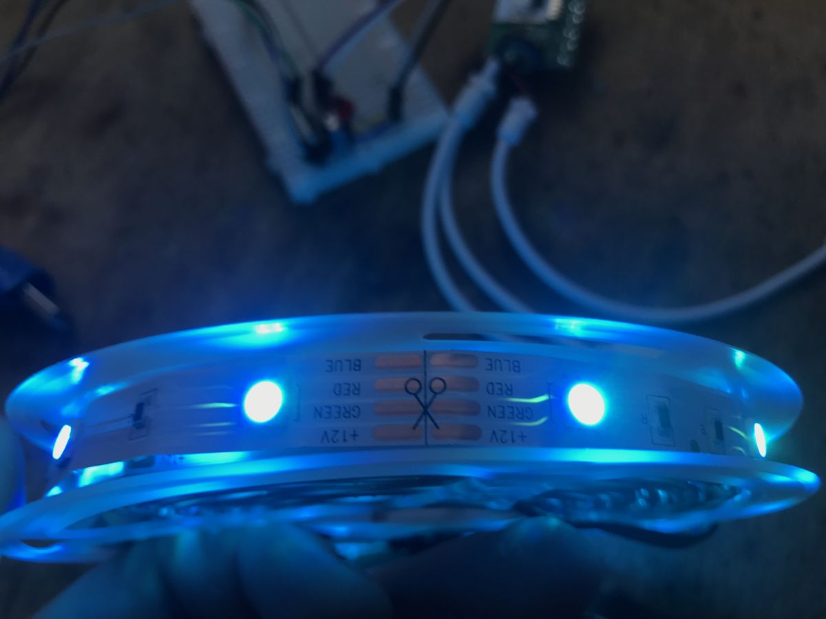

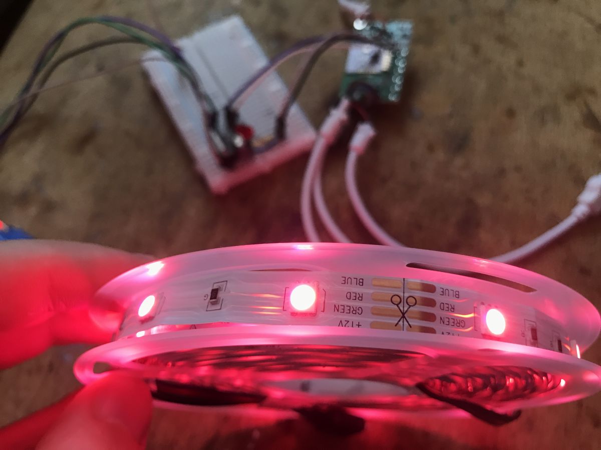

    Short test of OBK operation:
    OpenBK7231N interface with LED controller settings.
    Close-up of a glowing pink LED strip with color labels visible on the strip. Illuminated blue LED strip Close-up of a connected LED strip controller on a breadboard
    Everything works. You can also script the buttons, for example according to this tutorial:

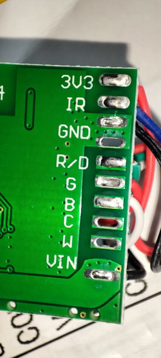

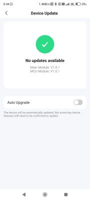

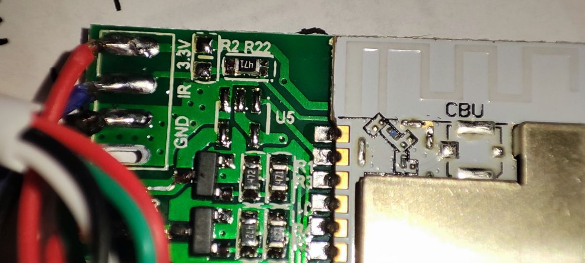

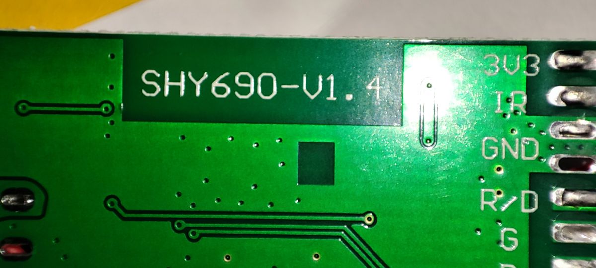

    Very interesting indeed. It looks very similar to something that I had delivered today from Ali. I took some pictures but not many. I'm not home so haven't investigated further. The tantalising pics I did take:
    Image of a printed circuit board with connector labels: 3V3, IR, GND, R/D, G, B, C, W, VIN. Close-up of a green circuit board labeled SHY690-V1.4 with visible solder points. Close-up of a circuit board with visible electronic components and traces. Close-up of a circuit board with visible electronic components. Close-up of a circuit board with integrated circuits and markings. Close-up of a circuit board with visible traces and electronic components. Close-up of a circuit board with a microphone and SMD components visible.
    Device update screen showing no updates available and auto-upgrade option turned off.
    This was the device, the case looks similar: https://www.aliexpress.com/item/1005006007958562.html
    What can be done with the mic?

    I can see that your board has place for Q4 and Q5 transistors. You can easily solder those two transistors and get two more channels controlled via your strips. Of course, also resistors will be required in this case.
    How would you like to use mic?

    I have no idea to be honest. I don't imagine it's very good compared to whatever mic is in my Alexas. Maybe I lack imagination.
    Added after 22 [minutes]:
    Do you have ideas for its use?
  • #5 20895772
    Posts: 14791
    Rate: 12937
    Original firmware used it to make some kind of music-based effects but they were very crude. We could try to do the same, but that would require some work and not many users are interested in that.

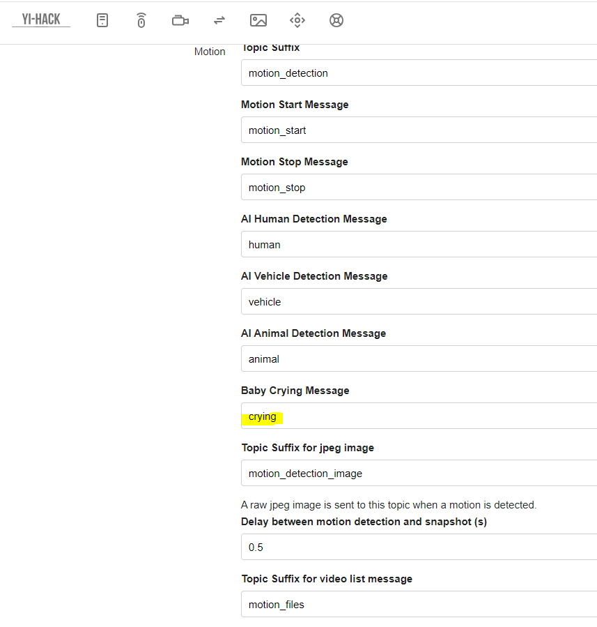

    No. I personally have no interest in anything audio with it I don't think.
    I have Yi Home cameras flashed with the AllWinner Yihack and I note that there are MQTT audio options for things like baby crying.
    God knows how you build something to always be listening and detect baby crying/ dog barking etc etc. Sounds like a lot of work.

    Can you maybe write a few words about this AllWinner hack on our device teardowns forum? Maybe some kind of guide? This sounds interesting.
