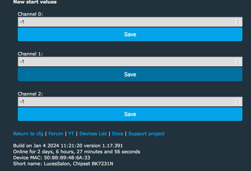

    What about OBK up time?
  • #5 20897656
    4139ggn
    Posts: 36
    is at -1. May it maintain its status
  • #6 20897704
    Posts: 14795
    Rate: 12947
    What is -1? It seems that you have misunderstood me.
    I have asked about OBK uptime, the one that can be read here:
    Screenshot of a user interface showing device information.

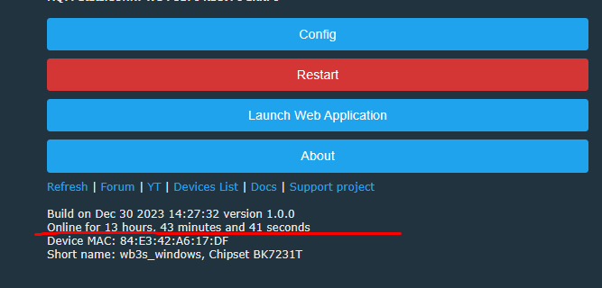

  • #9 20899305
    4139ggn
    Posts: 36
    Today, again.
    Now I have looked at the connection time:
    "Online for 16 hours, 38 minutes, and 8 seconds"
    From what I understand, there has been no reboot....

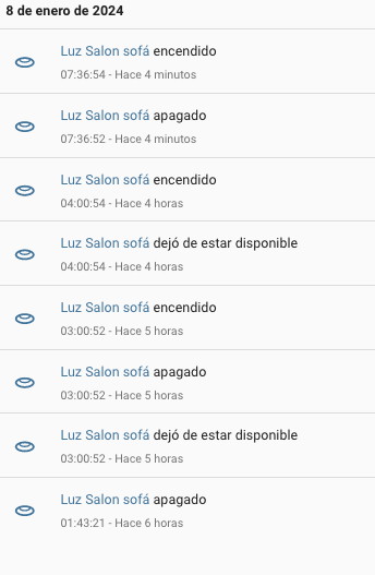

  • #10 20901913
    4139ggn
    Posts: 36
    Hello! I've been reviewing the history of Home Assistant. And from what I see, every day around 03:01:00 it does this cycle:
    "It became Unavailable"
    "It is turned off"
    "It's on"
    So it stays on all night...

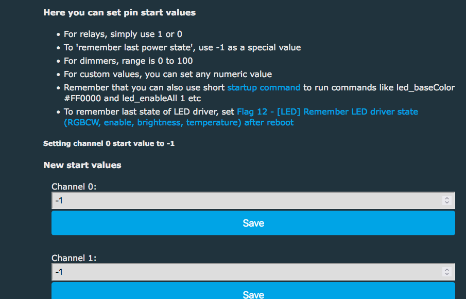

    You can set OBK device to remember it's last state. It's possible to configure it in the Configure Startup menu.
  • #14 20902458
    4139ggn
    Posts: 36
    This is how I have it configured...
    The same thing has happened to me with some other lamp with OpenBK. But every time I update it, it has disappeared...
    But this time no matter how much I update, nothing
    User interface for configuring device channels.

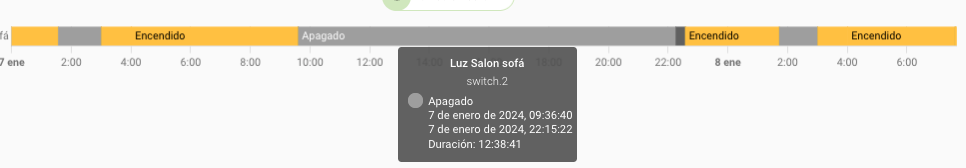

    #18 20922408
    4139ggn
    Posts: 36
    Hello, good!
    Well, I updated to version 1.17.405 and that power-up disappeared at 03:00.
    But... This morning when I woke up, I had another switch on!
    I have reviewed it, and I want to remember that it was at version 1.0.0, so I have updated it to the latest (1.17.442).
    What happened? It is true that this one had already done it once. But since the last time I updated it, it stopped doing that.
    Why did it do it again today? Why at 03:00?
    In the image, it looks like three different lights (03:00, 04:00, and 05:00). We were all asleep at home.
    Chart showing switch activity from 18:00 to 10:00 with highlighted periods of being on between 3:00 and 8:00.

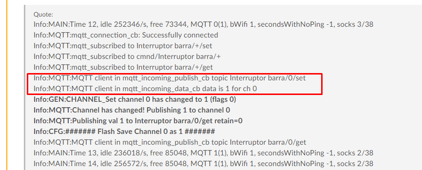

    #22 20939156
    4139ggn
    Posts: 36
    Today without any update two switches have turned on.
    I have updated them again to the latest version. And when it reboots with the update, they turn on again.
    I have looked at the OpenBK registry and what catches my attention is what is marked in bold. I don't know why the state changes when it restarts.
    Info:MAIN:Time 12, idle 252346/s, free 73344, MQTT 0(1), bWifi 1, secondsWithNoPing -1, socks 3/38
    Info:MQTT:mqtt_connection_cb: Successfully connected
    Info:MQTT:mqtt_subscribed to Interruptor barra/+/set
    Info:MQTT:mqtt_subscribed to cmnd/Interruptor barra/+
    Info:MQTT:mqtt_subscribed to Interruptor barra/+/get
    Info:MQTT:MQTT client in mqtt_incoming_publish_cb topic Interruptor barra/0/set
    Info:MQTT:MQTT client in mqtt_incoming_data_cb data is 1 for ch 0
    Info:GEN:CHANNEL_Set channel 0 has changed to 1 (flags 0)
    Info:MQTT:Channel has changed! Publishing 1 to channel 0
    Info:MQTT:Publishing val 1 to Interruptor barra/0/get retain=0
    Info:CFG:####### Flash Save Channel 0 as 1 #######
    Info:MQTT:MQTT client in mqtt_incoming_publish_cb topic Interruptor barra/0/get
    Info:MAIN:Time 13, idle 236018/s, free 85048, MQTT 1(1), bWifi 1, secondsWithNoPing -1, socks 2/38
    Info:MAIN:Time 14, idle 256572/s, free 85048, MQTT 1(1), bWifi 1, secondsWithNoPing -1, socks 2/38
    Info:MAIN:Time 15, idle 252747/s, free 85048, MQTT 1(1), bWifi 1, secondsWithNoPing -1, socks 2/38
    Info:MAIN:Time 16, idle 258704/s, free 85048, MQTT 1(1), bWifi 1, secondsWithNoPing -1, socks 2/38
    Info:MQTT:Channel has changed! Publishing 0 to channel 0
    Info:MQTT:Publishing val 0 to Interruptor barra/0/get retain=0
    Info:CFG:####### Flash Save Channel 0 as 0 #######
  • HA sends value 1 on OBK connection
    #23 20939162
    Posts: 14795
    Rate: 12947
    This is a very big progress, @4139ggn ! But you haven't marked enough on your log dump.
    Here, look:
    Screenshot of a log with a highlighted section in a red box.
    The fragment in red frame indicates that your HA sends value 1 to OBK just when OBK connects to it.
    Now, the question is, why HA sends it?
    I am not sure if I have asked about it already, but have you tried to enable "retain" on a device, in flags settings? Maybe it can help as a work around.

  • In the decisive log dump, OpenBK received MQTT payload 1 on topic Interruptor barra/0/set, changed channel 0 to 1, then later published 0 again; that shows an external command path, not a local spontaneous toggle. [#20939156]
  • A later resolution reported that enabling Home Assistant auto-discovery and removing manual configuration.yaml entries fixed the unwanted activations. [#21112094]
