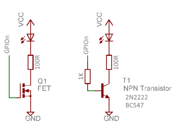

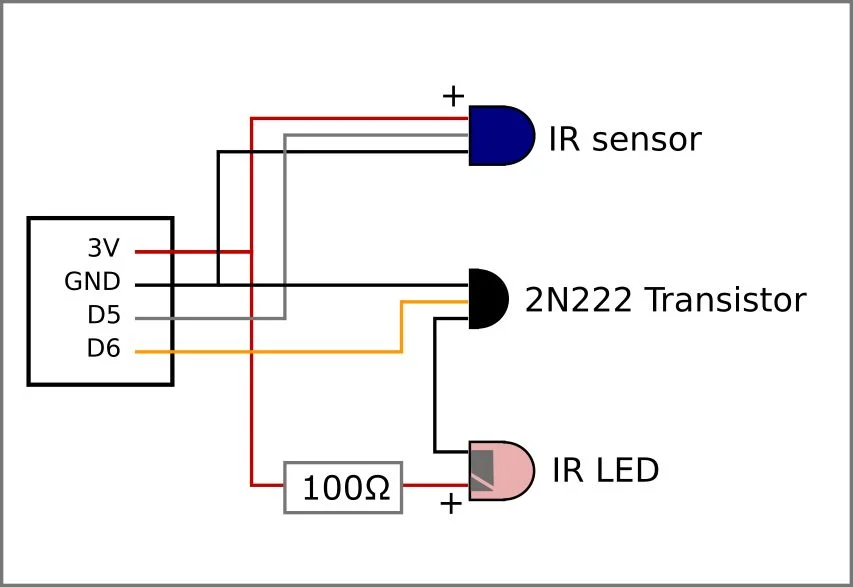

    - A Midea AC (Midea Oasis Plus MOP3-12-SP) is plugged in this socket. I do not want to just cut the power after the AC consumed eg. 3kW a day, I want it to turn off, by sending the "turn off" IR signal to it. So ultimately, the socket is just a power meter, I do not operate the relay of it. To send the IR signal, I figured out 2 ways:
    a) have OpenBeken manage it, and I know there are IREnable & IRSend commands, however, I do not know what to send (don't know what protocol the Midea uses, what is the command, etc.). If you can help me with this, it will be appreciated. Do I have to connect the IR led to a PWM output, or a simple GPIO will do? If PWM is required I have to modify the socket's circuit, but that's fine, I can do it.
    b) I have a spare remote control for the AC, and I'm willing to dismantle it. I can build a circuit to simulate the press of the "power" button on the remote (basically a transistor switch, which is operated by the socket) This is a more bulky approach, because I have to wire the remote to the socket, but if this is the only way, I will do it.
    So in overall:
    - how can I execute commands after the $energy has reached a value?
    - If I want to use the IR functions, do I have to connect the IR LED to a PWM output? Do I need to drive the LED with a transistor, or just wire the IR LED to a pin of the uC?

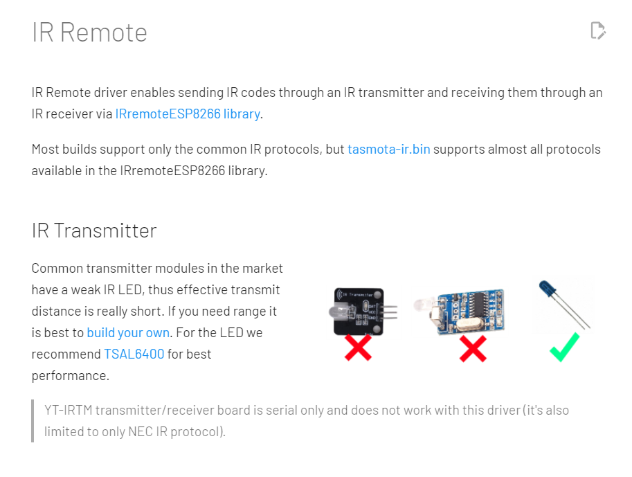

    For IR, you should follow the same approach as you'd with Tasmota:
    https://tasmota.github.io/docs/IR-Remote/
    Information about IR Remote control and IR transmitter.
    Connection diagram with IR sensor, 2N222 transistor, and IR LED.
    Circuit diagrams with FET and NPN transistors
