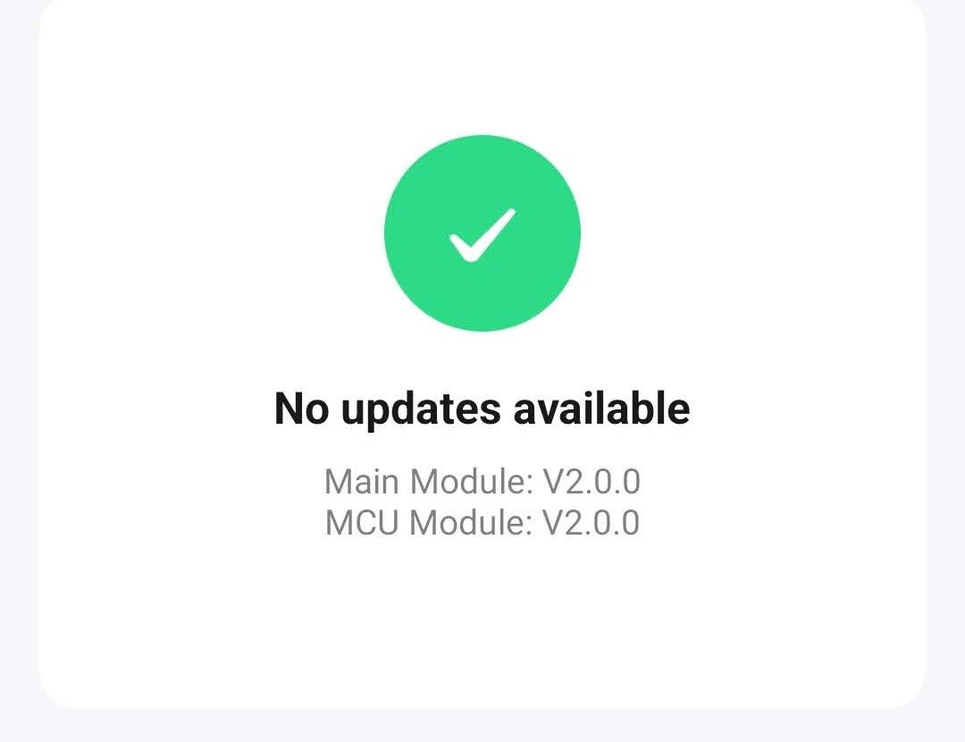

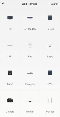

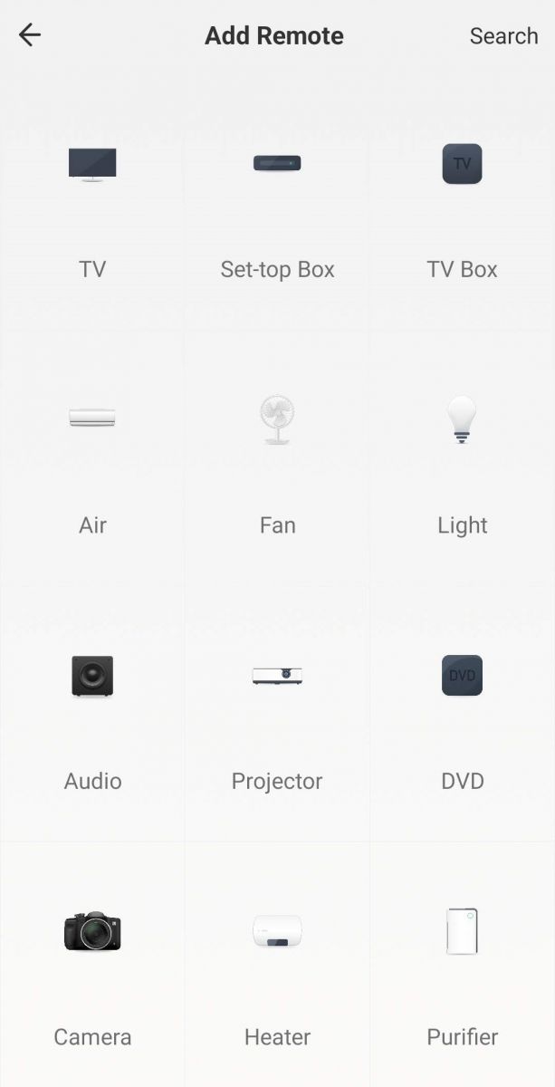

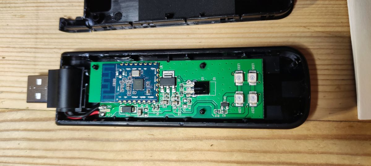

    To begin, I plugged it into a standard USB port and paired it with the Tuya app just to see what firmware version it had and to see what remote control options were available.
    Information screen with the message No updates available and module versions. App interface for adding remote control to various devices.

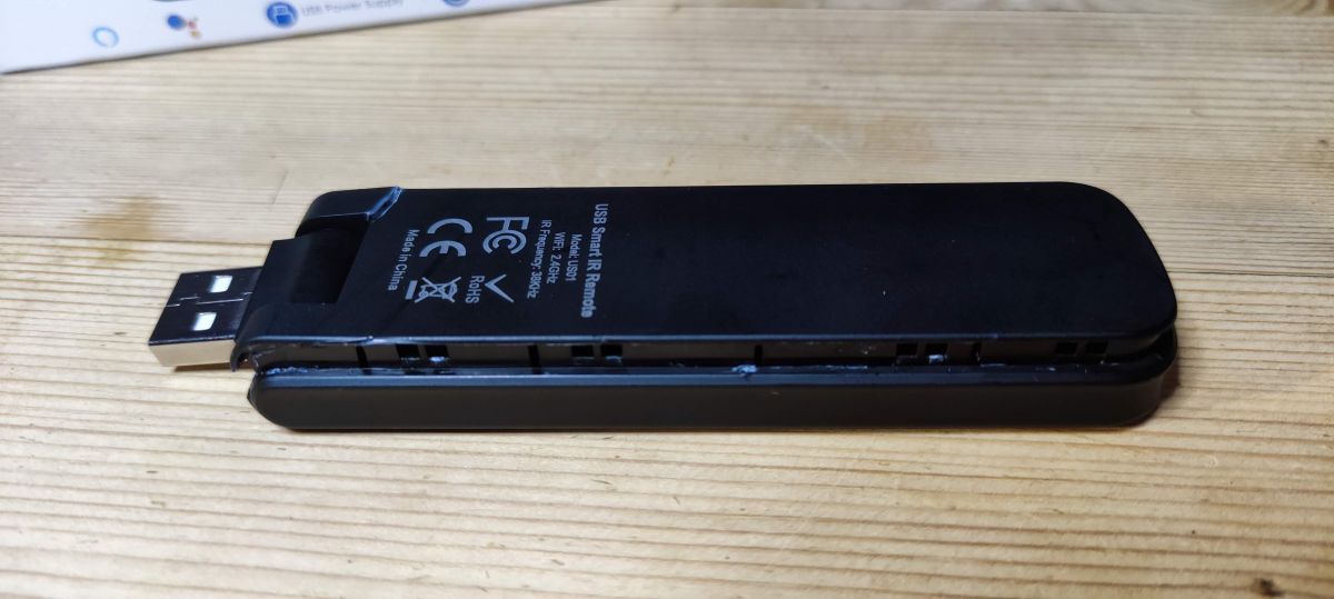

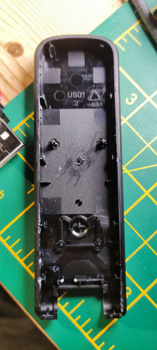

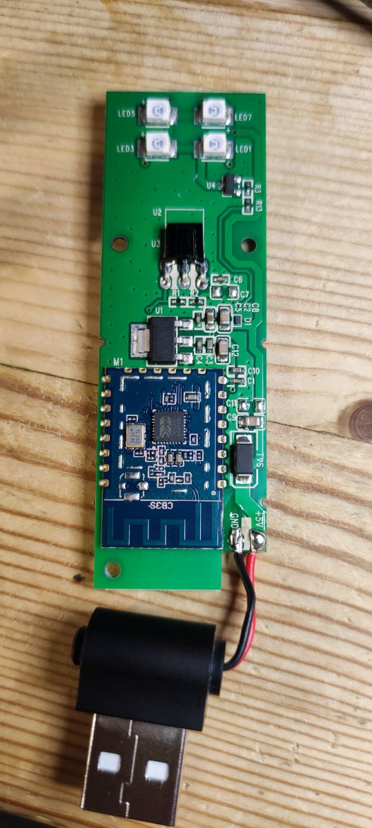

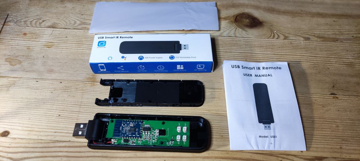

    Using my metal spudger I pried open the case from the USB hinge and slowly around the edge. There is a small amount of glue as well as some clips along the entire edge. I was a little rough at the beginning and broke one of the shoulders off. No matter. Slow and steady is the key.

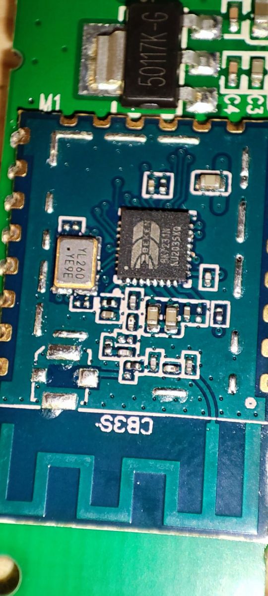

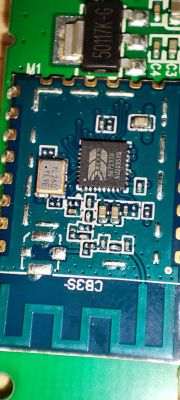

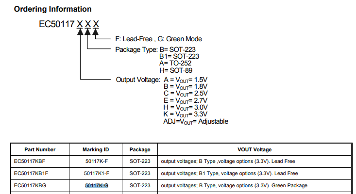

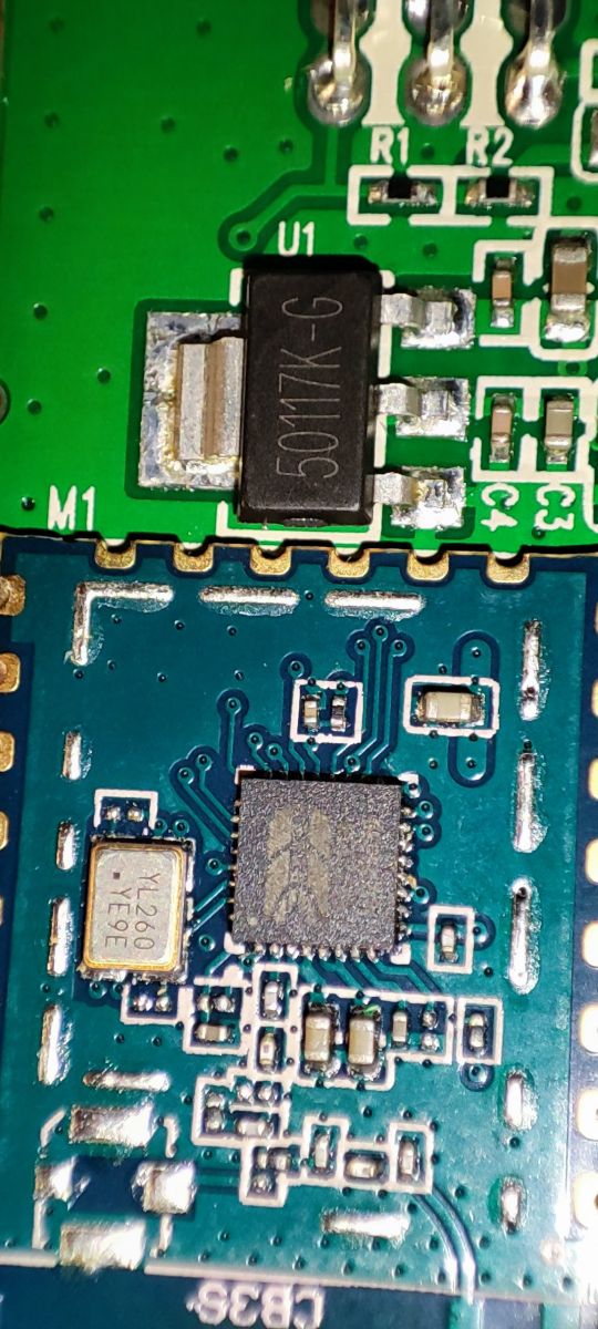

    As soon as the chassis is open, a shiny CB3S greets you. Below that is the 50117K-G E-CMOS 5V-3.3V voltage regulator, presumably to drop the 5V of USB down to 3.3 for the BK7231N on the CB3S.
    Order information table for EC50117 with various output voltage options.

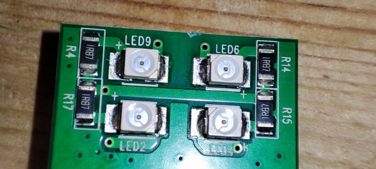

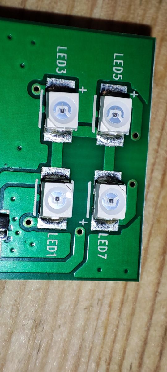

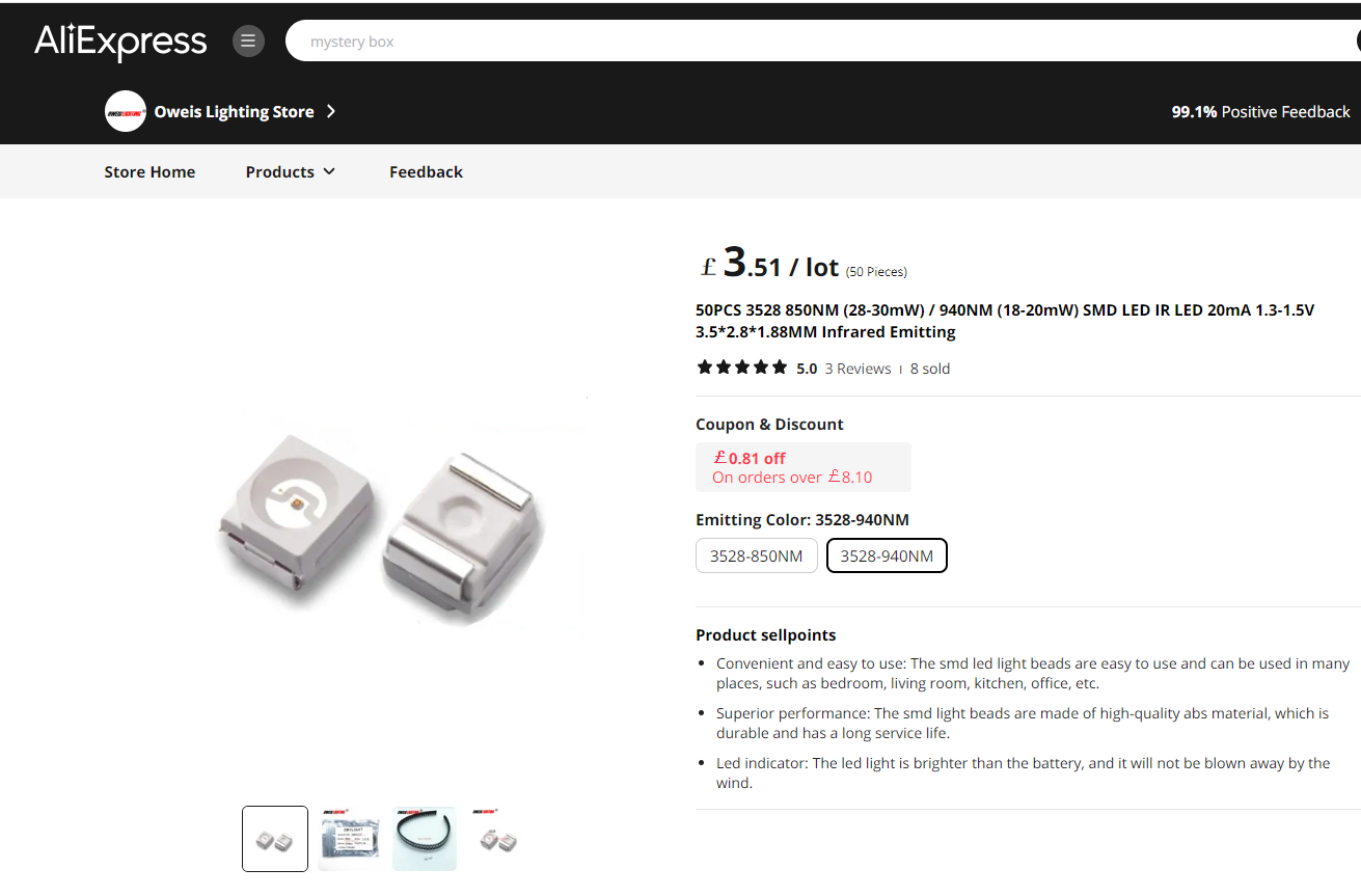

    I assumed the central IR component, as there is only one of them, was for programming remote control commands the Tuya app may not cater for. I guess the expectation is that this would be used less often and the user would expect to point their remote directly at the unit. In opposition to the receive, the IR send LEDs are a family of 8, 4 on both sides of the PCB. I guess this is because the user expects this device to work almost omnidirectionally, not having to worry too much where the unit is placed
    Printed circuit board with electronic components and a USB module. Close-up of the CB3S module on a circuit board with visible electronic components. Close-up of CB3S module on a PCB with visible voltage regulator. Close-up of a circuit board with four white LEDs labeled LED1, LED3, LED5, and LED7. Close-up of a circuit board with four LEDs labeled LED9, LED6, LED2, LED4 and resistors marked R4, R17, R14, R15. Close-up of a circuit board labeled US01 CB3S_V1.4 with the date 2023-05-08. Interior of the plastic casing of a device marked US01. Back of a black USB Smart IR remote. Disassembled USB Smart IR remote with PCB and packaging. Open USB device case with visible PCB. Box of USB Smart IR Remote lying on a wooden table. View of USB Smart IR Remote with specifications visible on the casing.

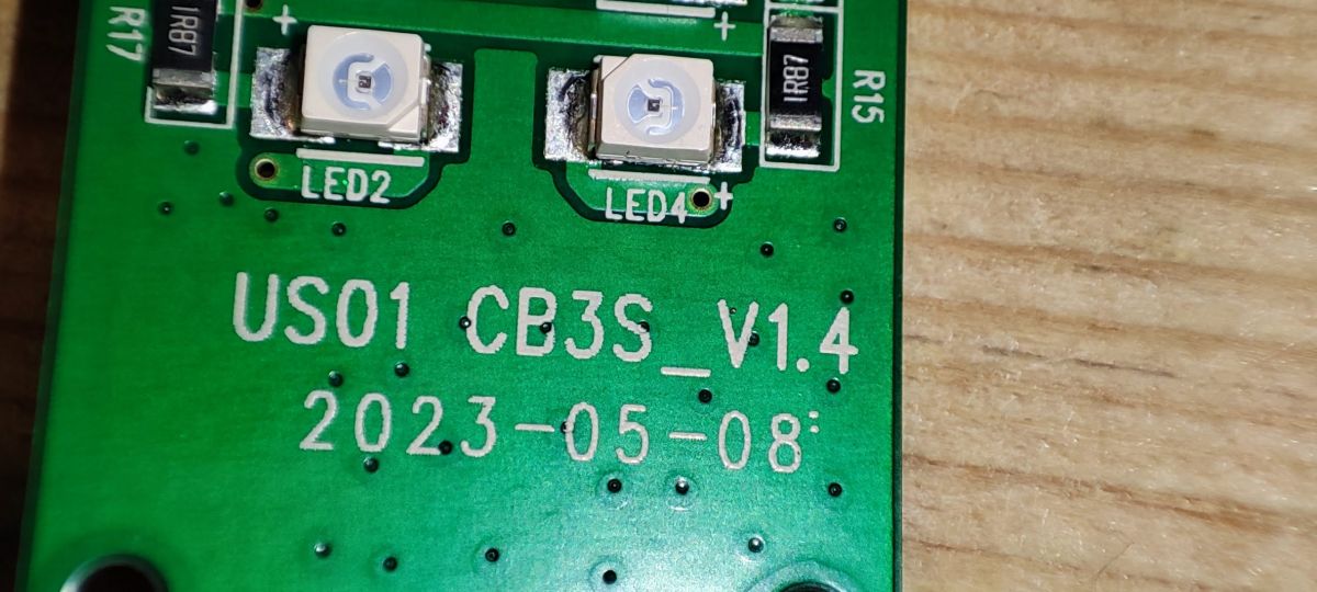

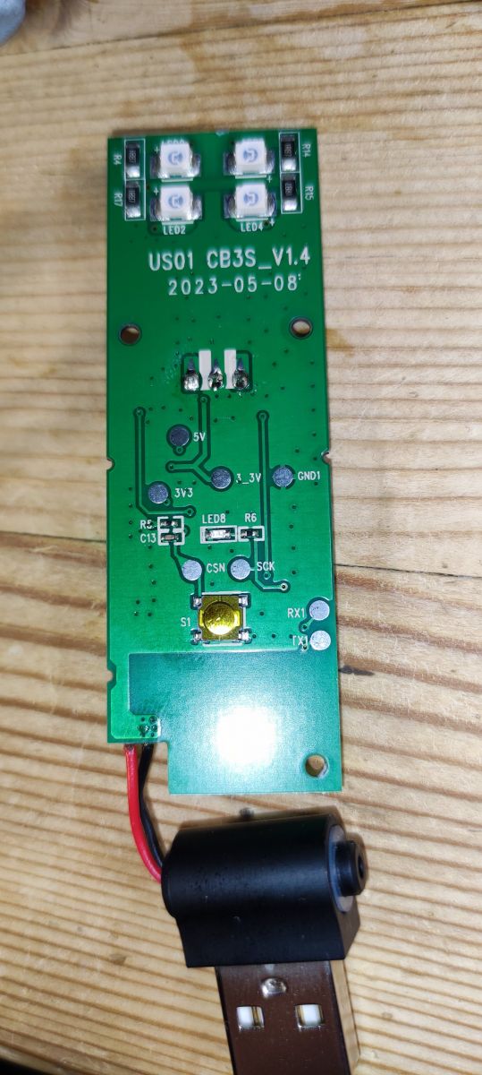

    The rear of the PCB has some very helpful GND, 3V3, RX1 and TX1 pads, from which I was able to flash OpenBK firmware using the Easy BK Flasher GUI.
    silkscreen text for forum searchers: US01 CB3S_V1.4 2023-05-08
    Close-up of US01 CB3S V1.4 circuit board with USB port.
    I did not unsolder any parts nor cut any traces to be able to flash. I used pogo pins, USB-TTL adaptor and an external 3.3v power supply, though the 5V from a USB would have worked too.

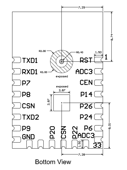

    Before flashing I used the TXD2, GND and 3V3 pins on the front of the CB3S to pull the UART boot log, attached.
    Diagram of the bottom view of a circuit board with pin labels and dimensions.
    Unfortunately BK flasher could not determine the GPIO assignments so I used trial and error to find the btn and the LED. I used a multimeter to find that the ir_rec data leg went to p7.
    Sorry, no meaningful pins data found. This device may be TuyaMCU or a custom one with no Tuya config data.
    No module information found.
    p8 led (or wifi led?)
    p6 btn
    p7 ir_rec
