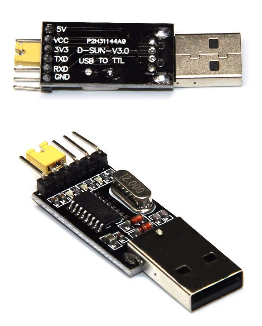

    For programming, a USB to UART converter with 3.3V logic levels is enough, I personally use the cheapest versions where the voltage is selected with a jumper:

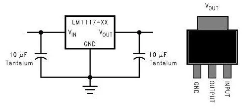

    In addition, you need a solid 3.3V source with good current efficiency, because this 3.3V pin from this converter is not suitable for this application. You can use e.g. 5V from USB and power the 3.3V LDO regulator, I sometimes use TC1264, but the AMS1117-3.3V is more popular:
    Easy Tasmota instalation - guide for online installer tasmota.github.io/install
    (okay, if the board has AMS1117-3.3V or another LDO or step down converter, you can connect 5V to its input, so that its output is 3.3V for the WiFi system, it will come out the same ...)

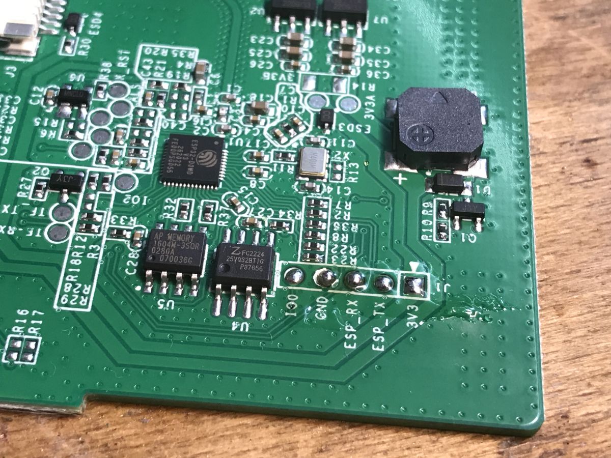

    In addition, you need to short IO0 to ground, it must be at ground level during ESP boot to start bootloader mode. RST I don't even solder. Here is an example of a board with signals for programming (already whitened):
    Close-up of a circuit board with an integrated circuit and connectors.
    Not every device has these signals output, sometimes you have to search and combine.
    Connect the RX from the converter to the TX of the device, and the TX from the converter to the RX of the device.

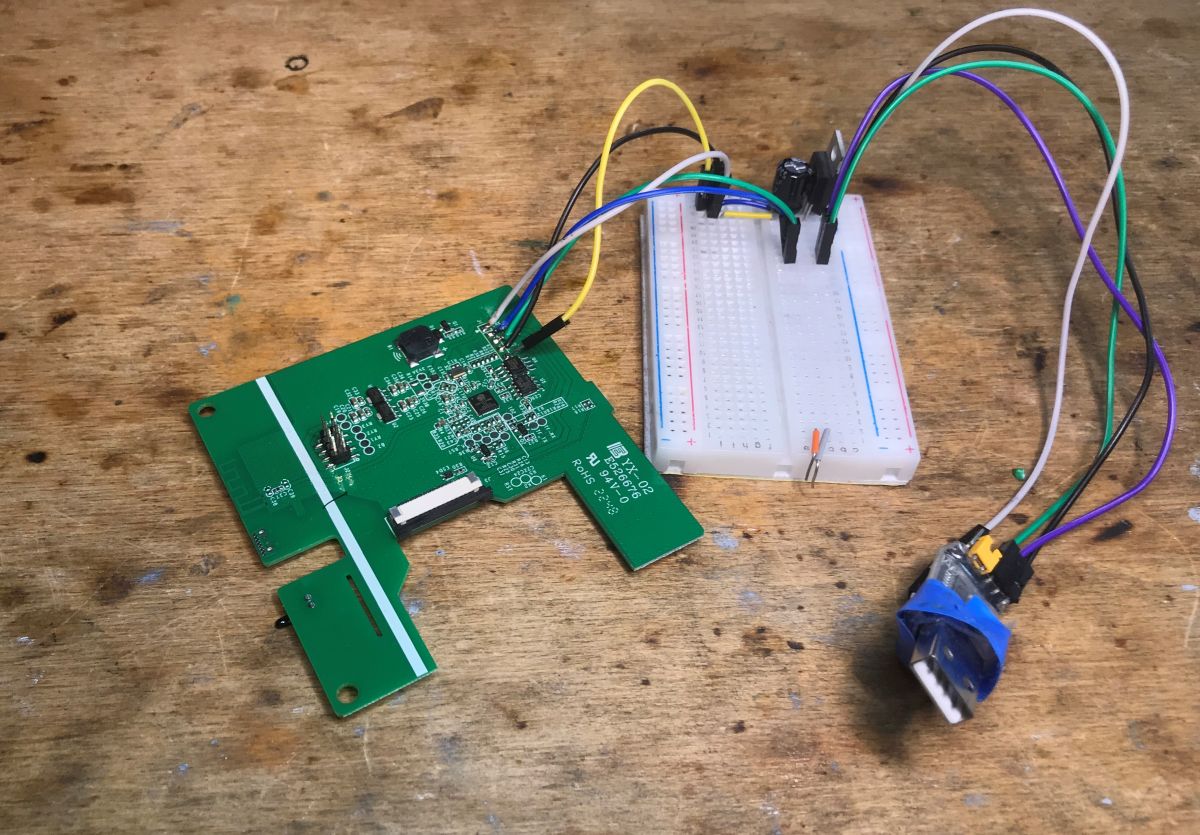

    And this is my whole programming layout:
    PCB connected to a breadboard with wires.
    During programming, I do not operate RESET, just to enter the bootloader mode, I first short GPIO 0 to ground and then disconnect the power supply for a moment. To boot normally, I disconnect the power, open the GPIO 0 and reconnect the power.

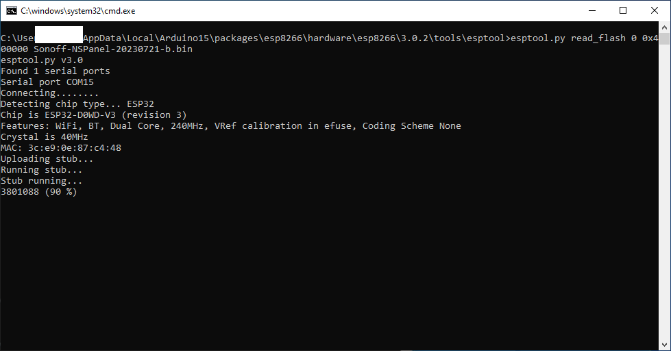

    Important - backup - esptool.py
    I haven't seen this online tool able to make a backup, so for the record, for security's sake, this is how you can dump the ESP via esptool.py:
    esptool.py read_flash 0 0x400000 Sonoff-NSPanel-20230721-b.bin
    Esptool.py requires Python, although it can also be bundled together with the Arduino ESP package.
    This is the command for the batch size of 4MB, depending on the device you may need to change this size:
    Backup is not mandatory, but I highly recommend you always do it! This will allow you to return to the manufacturer's software if necessary.

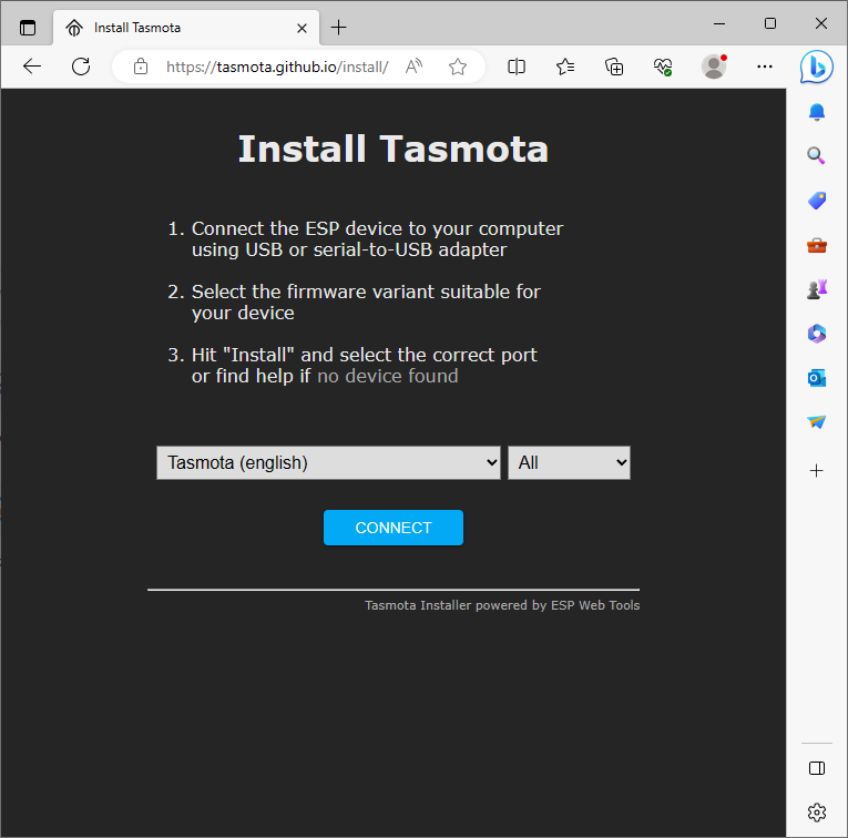

    We open the installation page:
    https://tasmota.github.io/install/
    We are greeted by this view:

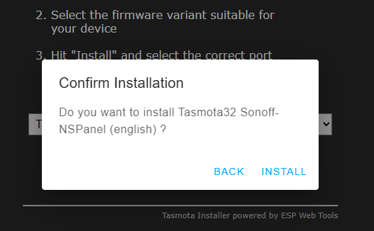

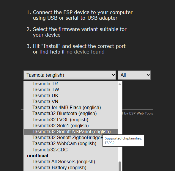

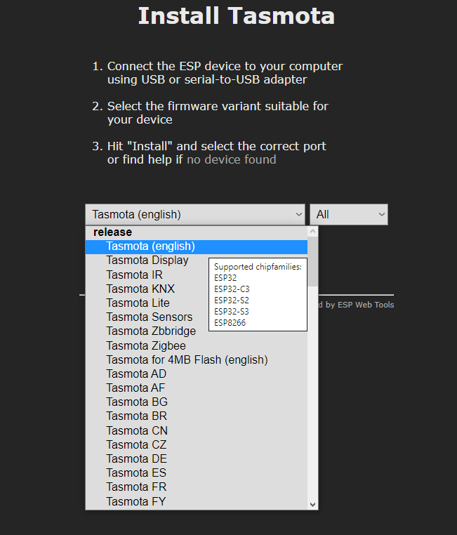

    Select the desired batch version from the list:
    Tasmota firmware selection screen for Sonoff NSPanel with a dropdown list.
    Here I chose the version for Sonoff NSPanel because I just flashed it, but you should choose what interests you.

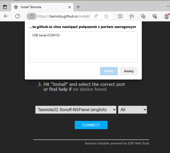

    Next, a COM port selection window will appear, must select a virtual COM port from our USB to UART converter. As a rule, there is only one, no problem.
    If the port does not appear, it is worth e.g. checking if something has taken it, e.g. the Cura program, popular among 3D printer users at one time, automatically occupied the COM port for some incomprehensible reason.
    We confirm:

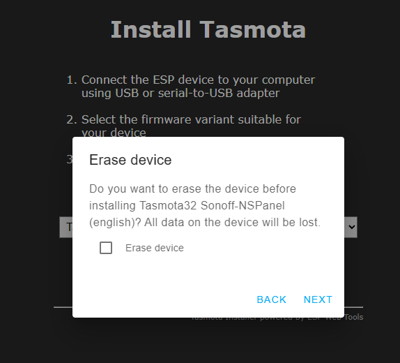

    The erase option can erase all memory before uploading a new batch:
    We confirm:

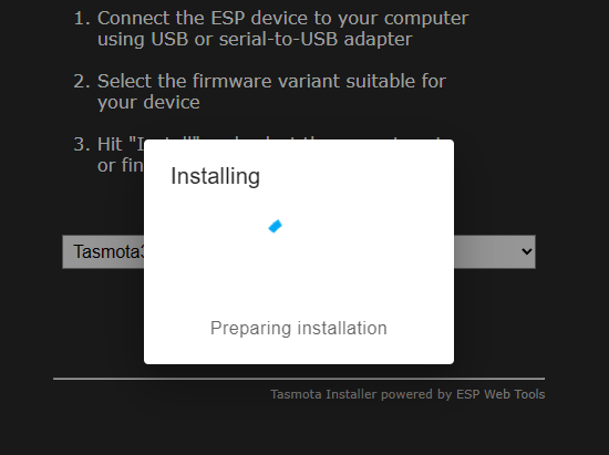

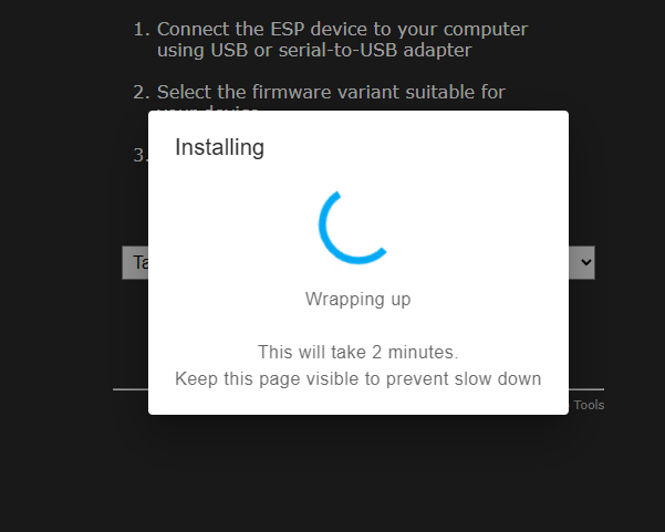

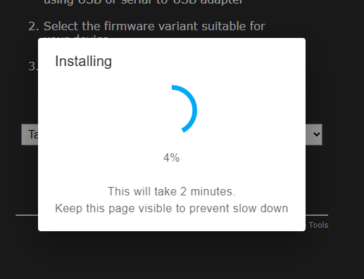

    Now the installation will start. The USB to UART converter is working, it cannot be disconnected now. We wait patiently.
    Now the main installation process is underway, it will take up to a few minutes:

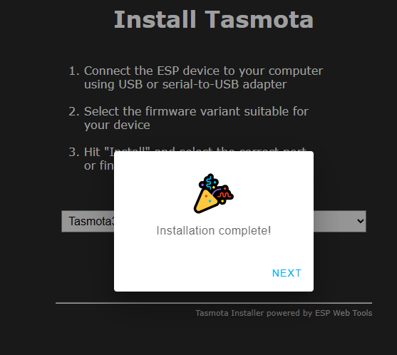

    Then we are still waiting for the finalization of the process:
    Ready! Success!

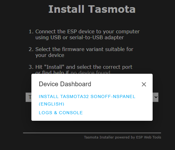

    In case of need, we can quickly upload the batch again to another device.
    Dialog box of Sonoff NSPanel touchscreen with options for installing Tasmota32 and logs.

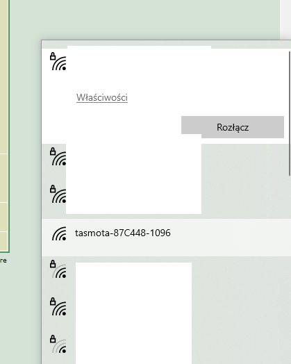

    Now you need to disconnect IO0 from ground and reboot! Then Tasmota's WiFi network will appear:
    List of available WiFi networks with a visible network named tasmota-87C448-1096.

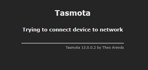

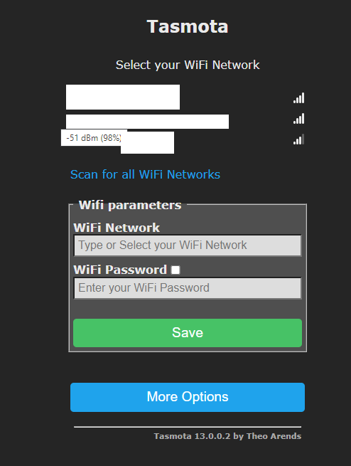

    This has basically already been discussed, but briefly: first we connect to Tasmota's WiFi network, then we set information about our WiFi (SSID, password) on the IP address 192.168.4.1 and then Tasmota connects to it and we can get to know its IP, e.g. from our DHCP server on the router:
    After approval:

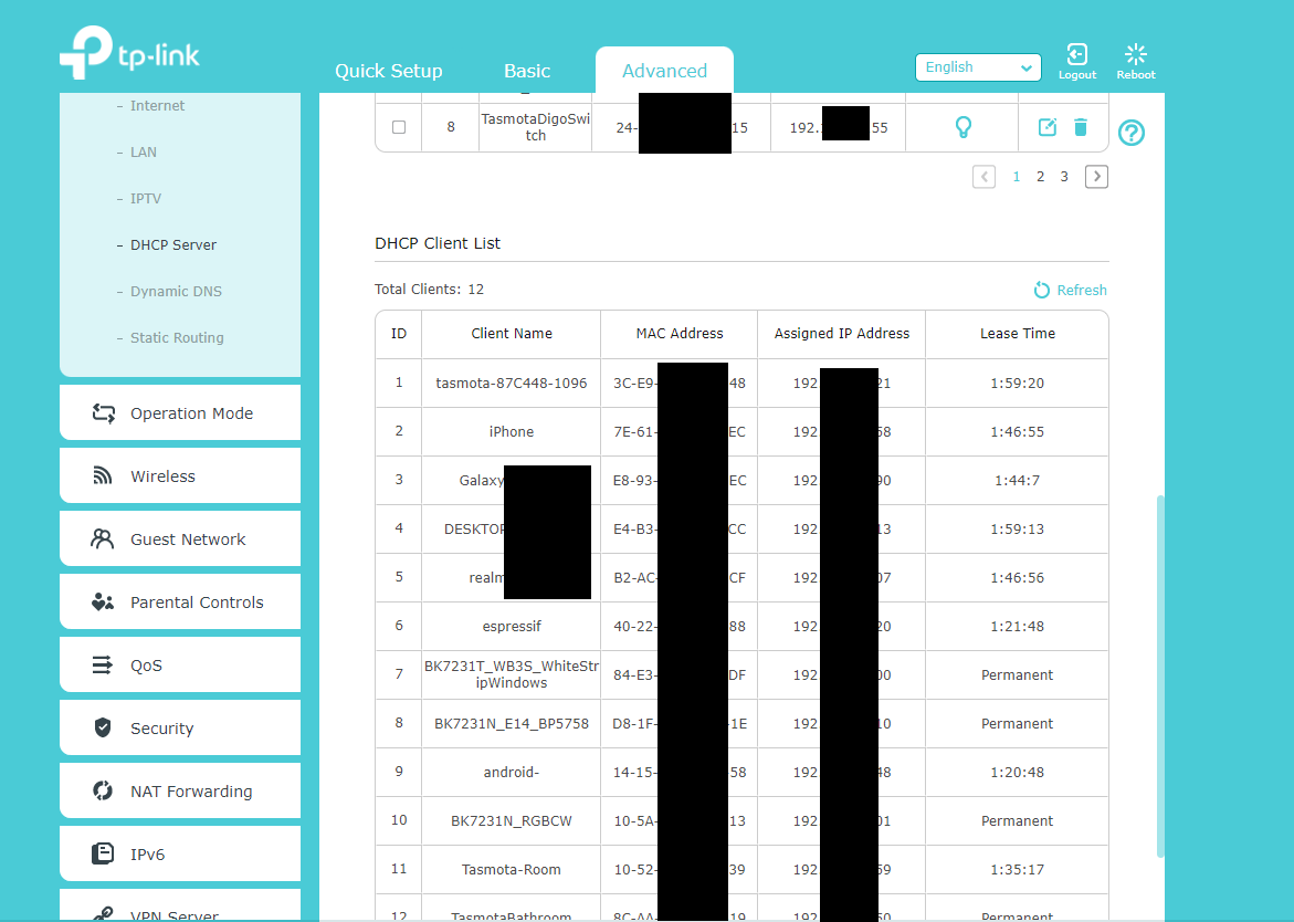

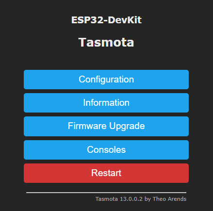

    On our router:
    Ready:

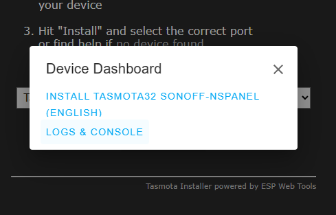

    As for the topic - a small update - it is worth adding that after hovering the mouse over the list entry, we see the supported platforms:
    Tasmota installer window with dropdown list of firmware variants and visible supported platforms tooltip.

  • ESP flashing in the thread uses 3.3V logic and a separate 3.3V supply; the cheap converter’s onboard 3.3V pin is described as unsuitable for powering the target during flashing. [#20663029]
  • The backup example reads 0x400000 bytes, which is a 4 MB flash dump: esptool.py read_flash 0 0x400000 .... [#20663029]
  • First-time Tasmota setup happens on 192.168.4.1, after connecting to the temporary Tasmota Wi‑Fi network broadcast by the device after reboot. [#20663029]
  • A CH340 board sold as a programmer for ESP8266 ESP-01 costs only about 30–40 groszy more and already includes a 3.3V LDO on the board. [#20675888]

How do I install Tasmota on an ESP8266, ESP8285, or ESP32 using the web installer at tasmota.github.io/install?
Use the browser installer with the device already wired for serial flashing. 1. Open the install page in Chrome, Opera, or Edge and choose the correct image. 2. Select the USB-UART COM port and confirm erase if needed. 3. Wait for flashing to finish, remove GPIO0 from ground, reboot, then join Tasmota Wi‑Fi and configure it at 192.168.4.1. [#20663029]
What hardware connections are needed to flash Tasmota over USB-UART, including RX/TX, GPIO0, and power wiring?
You need crossed serial lines, boot pin control, and stable 3.3V power. Connect adapter RX to device TX, and adapter TX to device RX. Hold GPIO0, also called IO0, at ground during bootloader start. Power the ESP from a solid 3.3V source, not directly from the cheap converter’s 3.3V pin. The thread also warns to perform all work with the device disconnected from mains power. [#20663029]
Why is the 3.3V pin from a cheap USB to UART converter often not enough for ESP flashing, and what power supply setup should I use instead?
It is often not enough because the converter’s 3.3V output is not suitable as the main supply for the Wi‑Fi chip during flashing. Use a separate 3.3V source with good current capacity. The thread suggests feeding an LDO such as AMS1117-3.3V or TC1264 from 5V USB, or using the device’s onboard 3.3V regulator if available. [#20663029]
What is GPIO0 bootloader mode on ESP8266 or ESP32, and how do I use it to start flashing?
"GPIO0 bootloader mode" is a startup state that forces an ESP chip into its serial flashing loader, with the key characteristic that GPIO0 must stay at ground level during boot. In the thread’s method, you short GPIO0 to ground, briefly remove power, then power the board again. To boot normally after flashing, remove GPIO0 from ground and power-cycle the device. [#20663029]

How can I make a full backup of the original ESP firmware with esptool.py before installing Tasmota?
Run esptool.py read_flash 0 0x400000 your-backup.bin before flashing Tasmota. That example reads a full 4 MB image from address 0 and saves it to a file. The author calls backup optional but strongly recommends it, because it gives you a path back to the manufacturer firmware if later needed. [#20663029]
What's the difference between using the Tasmota web installer and flashing manually with esptool.py?
The web installer is easier, while esptool.py gives more control. The browser method avoids downloading a flasher, avoids installing Python, and automatically provides current binaries. Manual flashing still matters because the thread uses esptool.py for backup and restore, including read_flash and write_flash commands that the online tool does not expose. [#20663029]
How do I restore the original firmware backup after replacing it with Tasmota on a Sonoff NSPanel?
Write the saved backup back over UART with esptool.py. The thread’s restore example is esptool.py write_flash 0 Sqqqqqqq7.bin, which writes the backup starting at address 0. For NSPanel, restore is incomplete if you changed the display side too, because you may also need to put the original Nextion TFT file back. [#20788181]

Which USB to UART adapter is more convenient for ESP flashing: a basic converter plus external LDO, or a CH340 board sold as a programmer for ESP8266 ESP-01?
The CH340 ESP-01 programmer board is described as more convenient. It costs only about 30–40 groszy more and already includes a 3.3V LDO, so it reduces extra wiring. The basic converter still works, but in this thread it needs a separate regulator and more setup around stable 3.3V power. [#20675888]
Where can I check which ESP platforms and devices are supported by a given image in the Tasmota online installer list?
Check by hovering your mouse over the image entry in the installer list. The thread adds this as a later update and says the supported platforms appear on hover. That makes it easier to confirm whether a selected build matches your ESP8266, ESP8285, ESP32, or a device-specific target such as NSPanel. [#20680240]
