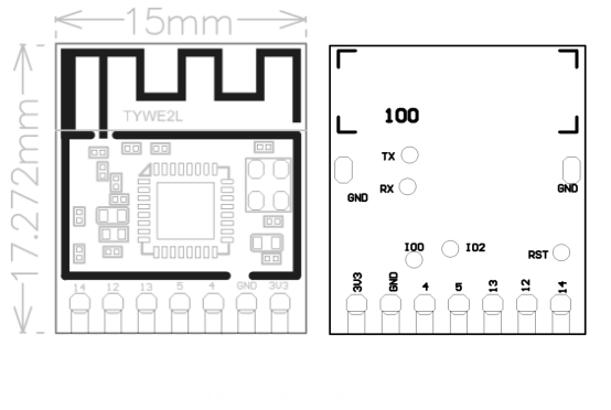

    Here is more information on your modules:
    TYWE2L is a low power-consumption built-in Wi-Fi module developed by Hangzhou. It consists of a highly integrated RF chip (ESP8285) and several peripherals, with a built-in Wi-Fi network protocol stack and rich library function
    Diagram of TYWE2L and TYLC5 modules with pins and symbols.
    Pin numberSymbolI/O typeFunction
    114I/OGPIO_14, correspond to MTMS of the IC (Pin 9)
    212I/OGPIO_12, correspond to MTDI of the IC (Pin 10)
    313I/OGPIO_13, correspond to MTCK of the IC (Pin 12)
    45I/OGPIO_05, correspond to GPIO 5 of the IC (Pin 24)
    54I/OGPIO_04, correspond to GPIO 4 of the IC (Pin 16)
    6GNDPPower supply reference ground
    73V3PPower supply pin (3.3 V)
    Test pins:
    -IO2I/OUART1_TXD (interface for displaying module information)
    -RSTI/OReset pin
    -IO0I/OIO0 is involved in module startup. If IO0 is disconnected, the module enters the normal running state.

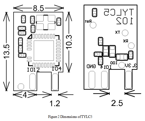

    TYLC5 is a low-power embedded Wi-Fi module developed by Hangzhou Tuya Information Technology Co., Ltd. It consists of a highly integrated wireless radio frequency chip, ESP8285, and a few peripheral devices. It also has a built-in Wi-Fi network protocol stack and abundant library functions.
    Diagram of dimensions of the TYLC5 module.
    Pin No.SymbolIO TypeFunction
    1ANT-RF antenna port, spot to solder external antennas
    2GNDPPower reference point
    3GPIO12I/OGPIO_12
    4GPIO14I/OGPIO_14
    5GPIO4I/OGPIO_04
    6VCCPPower pin of the module (3.3V)
    Test pins:
    -TP1RstHardware reset pin; Cannot clear the distribution network information of Wi-Fi.
    -TP 2I/OGPIO0;Testing the module production.
    -TP3U0TXDUser serial port; Information output from the serial port can be used for testing the module production.
    -TP4U0RXDUser serial port; Information output from the serial port can be used for testing the module production.
