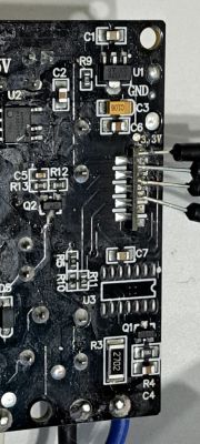

    This device has CB2S, for a single switch it does not have any Tuya MCU. This regular UART flash the on CB2S and the board is perpendicular to the main PCB, but it is ok to solder the pins for 3v3 GND, TX, RX.

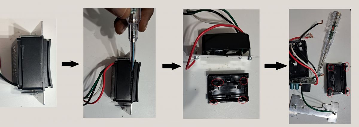

    To open it, use a flat head screw on the bottom of the switch near the metal plate. It will lift the back panel. It has four push mount points. Once you open the first point, everything will fall apart, as shown in the images below.
    Disassembly process of ELEGRP light switch.

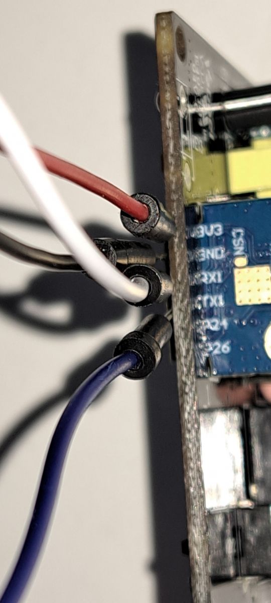

    Solder the 3v3, Gnd, TX, RX on the CB2S board as below connect it to the UART as below, flash the firmware using BK7231flasher (Start flashing / read dump by connecting ground the CEN pin)
    Close-up of a PCB with soldered wires.
    Close-up of wires connected to a CB2S circuit board.
    UART TX --> PCB RX
    UART RX --> PCB RX
    UART GND --> PCB GND
    UART 3.3V --> PCB 3.3V (preferably use another stable 3.3v power and connect the GND to PCB GND)
    Note: I faced issues with the UART 3v3, so I use another UART on 2A USB power adaptor and connected the GND to common ground as below,
    Connected UART programmer to PCB board with connection labels.
    Note:Make sure to select the option 'Automatically configure OBK configuration on flash write' to ensure to openBK WiFi access point
    BK7231 Easy UART Flasher interface with a write success message
    Once the flash is completed, Use the below config for Single switch, Note: No Tuya MCU is present in this switch, it just using gpio pins
    Single Pole 1 Way:
    Single Pole 3Way ( with blue wire version)

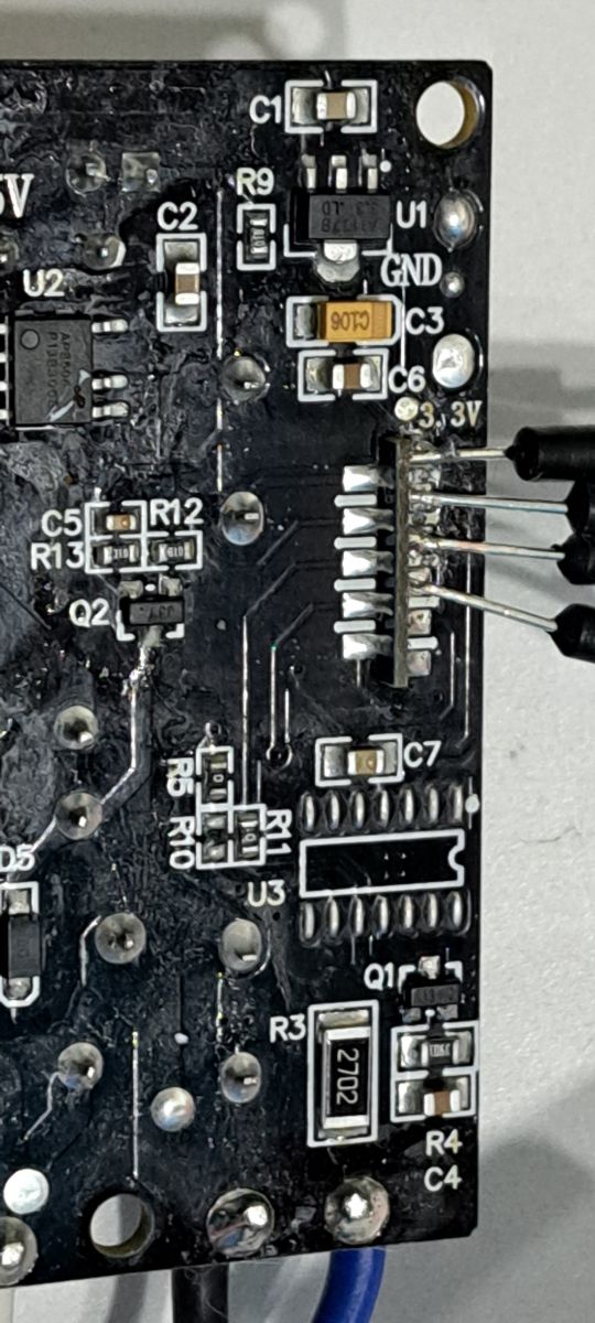

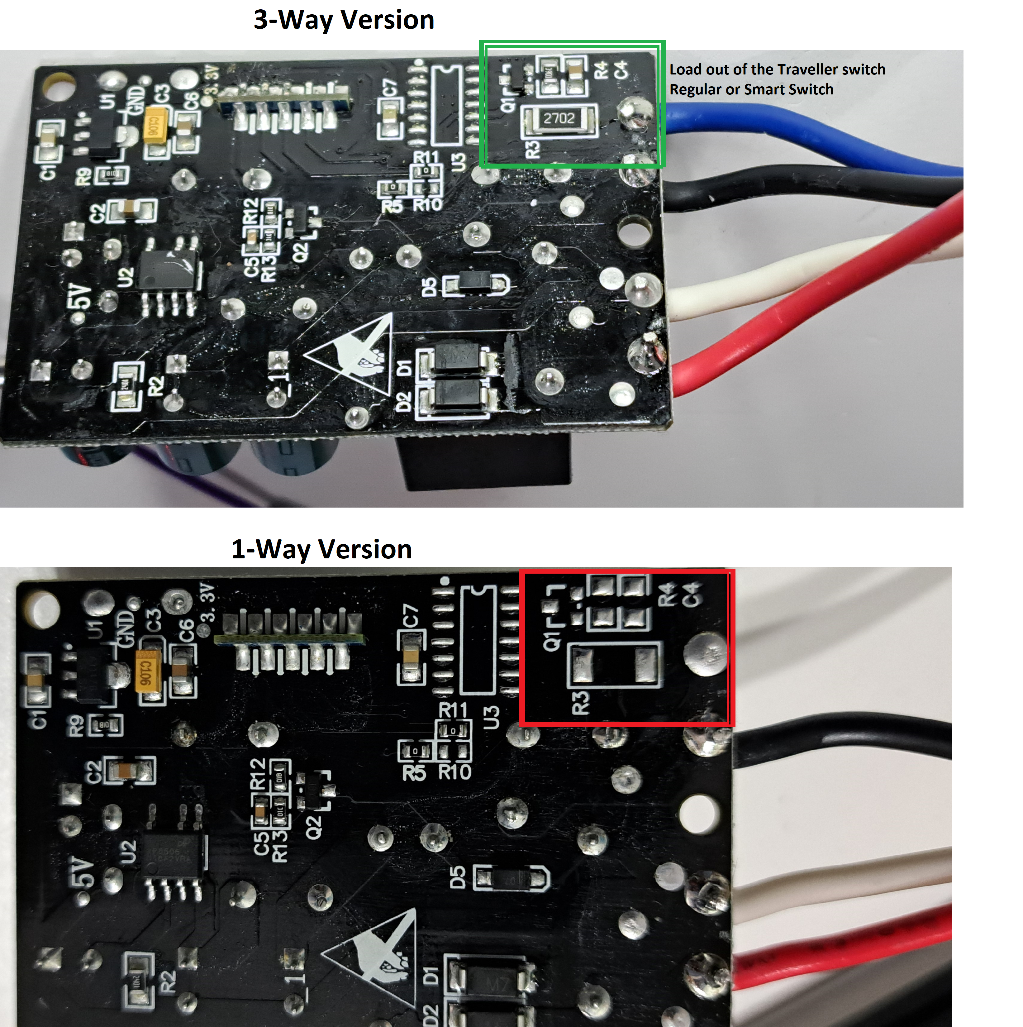

  • 3-way version adds traveler input on P8
    #3 20939069
    thirug010
    Thank you, I will check ADCSmoother option, but this switch comes in 2 versions: 1-way or 3-way.
    The 3-way switch has physical components (Not sure, maybe some high current transistor) to convert the AC load output from the Traveler switch to toggle this switch. Please refer to the image below. This input is connected to the P8. The non 3-Way version does not have the input.
    Circuits of 3-way and 1-way switch versions, with marked sections.
