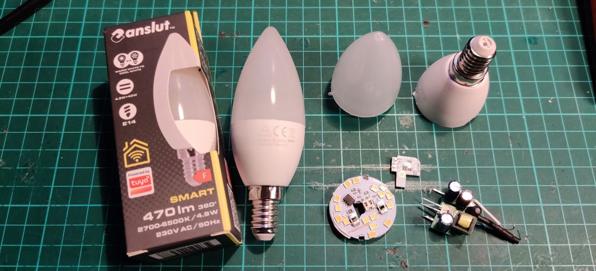

    BadFlamingo_666
    Disassembled smart LED bulb with visible components
    Full name in app:
    LED C37 E14 470lm 2700K-6500K
    Circuit board: WBLC9
    Chipset: BK7231T
    Version Number: V2.9.16
    Pins:
    P7: PWM; 5 (W)
    P8: PWM; 1 (R)
    P9: PWM; 2 (G)
    P24: PWM; 3 (B)
    P26: PWM; 4 (C)

    Thank you, but can you also post a template in JSON format from the Web App, so I can add this device to our list more easily?
