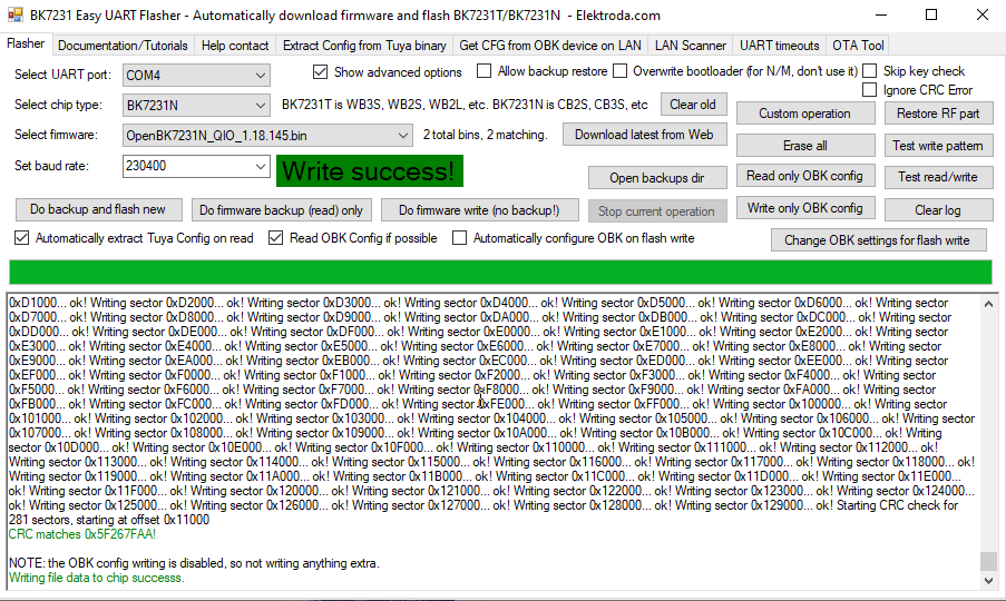

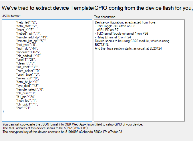

    After I made a backup I received the pinout. That's not the problem.
    In what file do I have to copy the pinout ?
    Explanation about OBK binary I don't understand.
    I'm sorry for my stupid questions but it's the first time I try to do this.
    Screenshot from flashing tool showing extracted GPIO config in JSON format
    Added after 11 [minutes]:
    print screen from the flasher.
    Screenshot of BK7231 Easy UART Flasher with Write success! message displayed

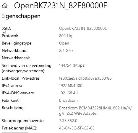

    The CB2S module create his own network :
    Wi-Fi properties of SSID OpenBK7231N_82E80000E with IPv4 address 192.168.4.100

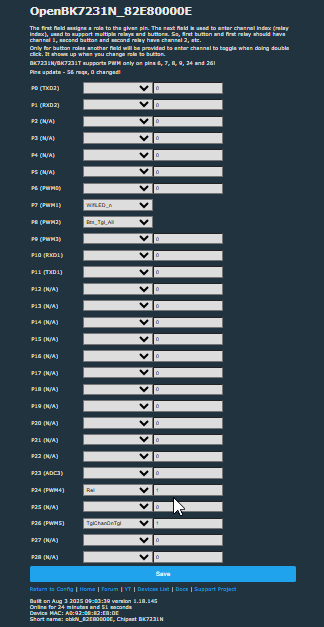

    When making connection with the module an the webbrowser (192.168.4.1) I receive the Tasmota screen.

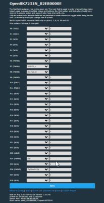

    Checking the I/O's, they are the same as the original.
    OpenBK7231N pin configuration for CB2S module in Tasmota interface
    Is this all correct ? If so I can install the CB2S module back in the module.
  • #34 21626183
    Posts: 14622
    Help: 655
    Rate: 12637
    I think it should be ok, you don't have to worry about this configuration now. It can be changed even after installling CB2S module back in the PCB.

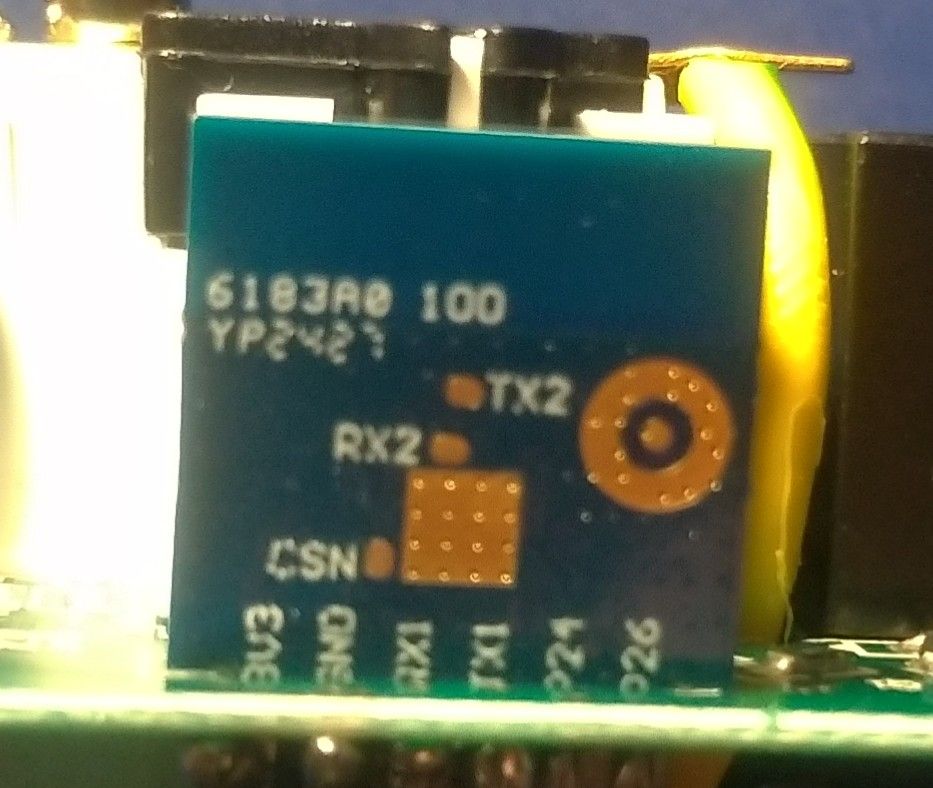

    Hi,
    I have a device plug 3202088.
    On WiFi PCB I don't know where the CEN pin is to begin flashing?
    And which baud rate do we choose?
    Thanks a lot for your help
    Close-up of a blue PCB labeled TX2, RX2 and GND, with a yellow wire on the right

Where is the CEN pin on the WiFi PCB of the Action LSC SmartPlug 3202088, and what baud rate should I use for flashing?
The thread identifies CEN from the WB2S documentation, not from a final annotated photo of the 3202088 PCB, and it does not state any baud rate. The WB2S pin table in the guide says CEN is pin 10 and labels it as the reset pin. For the 3202088 board, the practical advice is to locate CEN by matching the module to the official WB2S pinout, especially because some modules may have misleading silkscreen markings. [#21835018]
