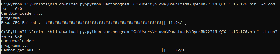

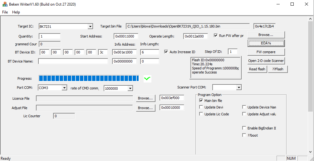

    Hi,
    I also bought the LSC Power Plug but with Art. nr 2578677.
    I flashed it succesfully with OpenBK7231N_QIO_1.15.180 using Beken Writer v1.60. But when powering on, there is no Wifi (2.4GHz)/no LED.
    Smart Power Plug LCS Action Shop 2578685 970766 firmware upload
    Also tried the old version OpenBK7231N_QIO_1.12.66.
    I could restore the original firmware.
    What can I do to get the power plug working?
    Tx
    Bart

    You have flashed the firmware to offset 0x11000, which is incorrect in case of BK7231N.
    You have used settings for BK7231T.
    For BK7231N, you should flash the QIO image to the offset 0, so use:
    The_Wrecker wrote:
    I used the Python script https://github.com/OpenBekenIOT/hid_download_py (under Ubuntu 22.04) to upload the firmware with a ftdi TTL 3v3 cable. Soldered some jumper wires to the TX, RX and GND. With a bit of timing, got the flashing started (this took a couple of tries to get the timing down), trick was to start the python command right before the plug got power.
    python uartprogram ./OpenBK7231N_QIO_1.15.140.bin --unprotect -d com15 -w --startaddr 0x0
    pause
    You could also TRY using bkWriter 1.60, but in BK7231N mode (not BK7231, which is used for BK7231T). And make sure that offset is 0x0, not 0x11000.

    Thank you for your quick reply.
    I used python now but I'm facing another problem now.. The FW was flashing but I received Read CRC Failed after flashing.
    Plug seems to be dead now. Retrying to flash results in 'cannot get bus'
    I'm using the 3.3V of the UART (CH340).
    Bart

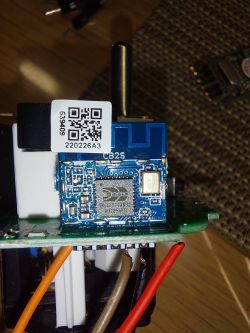

    Hi,
    I was able to desolder the board.
    I took a close pic
    ture of the board. To my suprise I see the chip is BK7231TQN32
    Bart Smart Power Plug LCS Action Shop 2578685 970766 firmware upload

    @blowagie , You're not alone :).
    I have 20 of these babies, now all updated. It seems that Tuya is shipping incorrectly labeled PCB's.
    https://github.com/tuya-cloudcutter/tuya-cloudcutter/issues/210
    You can safely use the tuya cloud cutter, and if you flash the latest firmware, you can directly configure the LEDs and relays by executing the following URL when in AP mode;
    http://192.168.4.1/cm?cmnd=backlog+SetPinRole...207,1;SetPinChannel%206,1;SetPinChannel%208,1

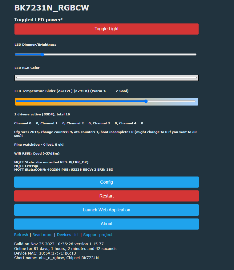

    @frankvanginkel are you 100% sure that doing "restore RF partition" does not fix the behaviour?
    That bulb, for example, is for 81 days online and still works for me...
