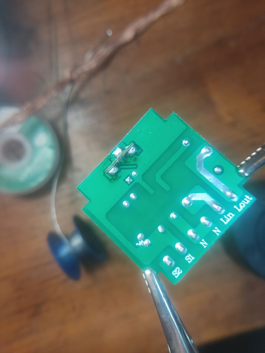

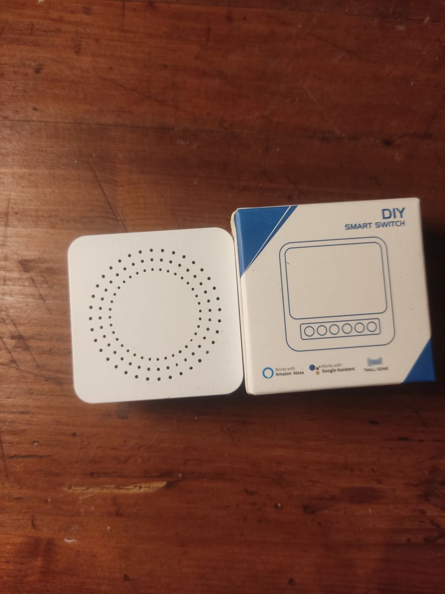

    I got this device from Aliexpress
    DIY smart switch device and its box on a wooden table. DIY smart switch device and box on a wooden surface. Image of a printed circuit board with wires and electronic components. Interior of a DIY smart switch from Aliexpress with visible module and electronic components. Close-up of an SM-028_V1.3 electronic module held in a servicing clip.

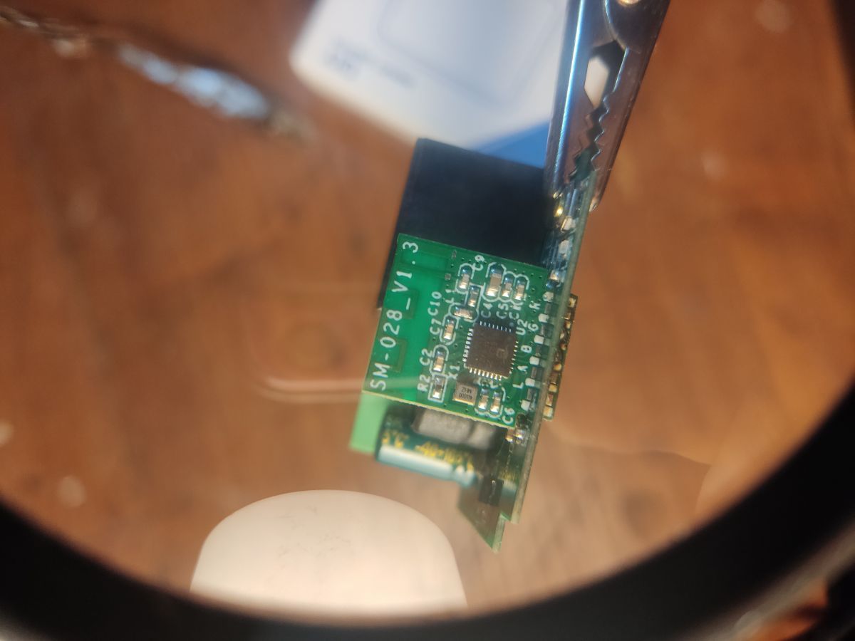

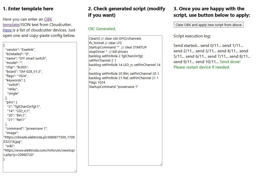

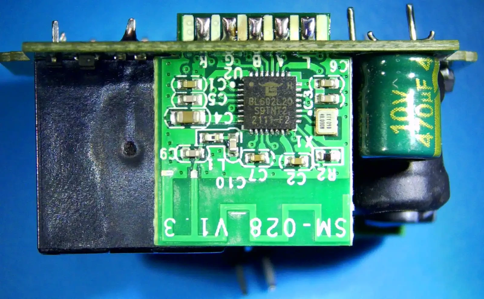

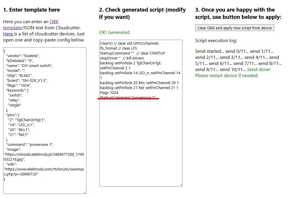

    I desoldered the module to flash it and i didn't see a config working for me so here it is
      "vendor": "Ewelink",
      "bDetailed": "0",
      "name": "DIY smart switch",
      "model": "DIY smart switch",
      "chip": "BL602",
      "board": "SM-028_V1.3",
      "flags": "1024",
      "keywords": [
        "switch",
        "relay",
        "TODO"
      "pins": {
        "2": "TglChanOnTgl;1",
        "14": "LED_n;1",
        "20": "Btn;1",
        "21": "Rel;1"
      "command": "powersave 1",
      "image": "https://obrazki.elektroda.pl/3889877500_1709032216.jpg",
      "wiki": "https://www.elektroda.com/rtvforum/viewtopic.php?p=20980720"

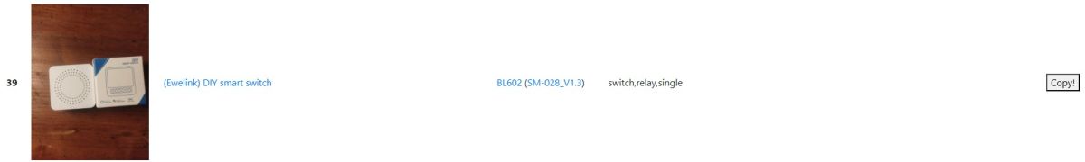

    Added, thank you:
    https://github.com/OpenBekenIOT/webapp/commit/296aedc5e8acb2041ed2bc969f52eb82de0a6bc8
    It's good to see another BL602 flashed.

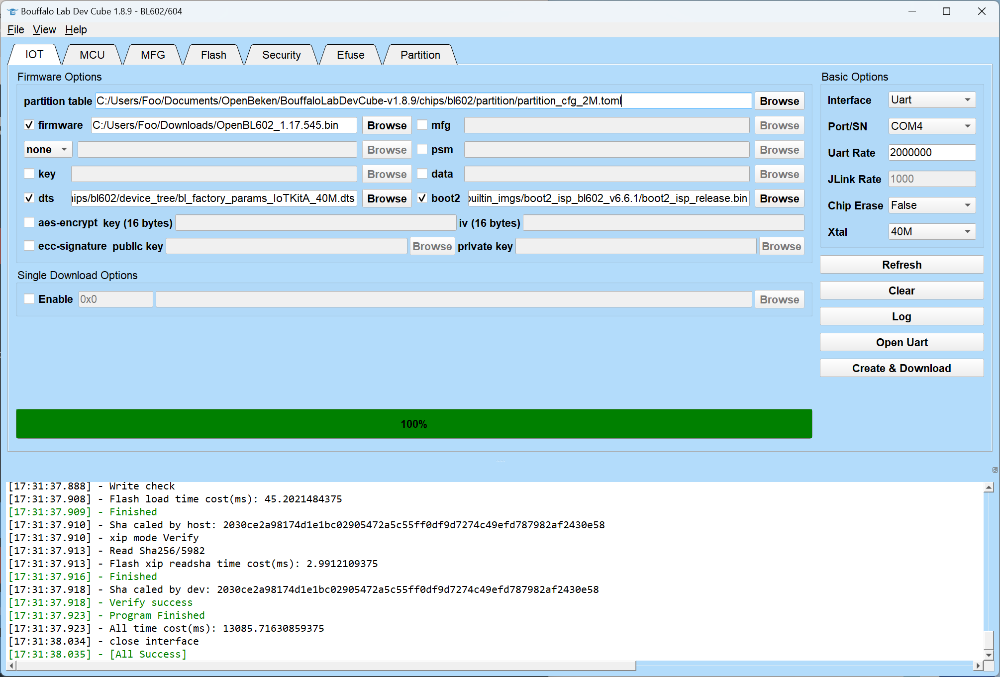

  • Incorrect BuffaloDevCube setup caused flashing issue

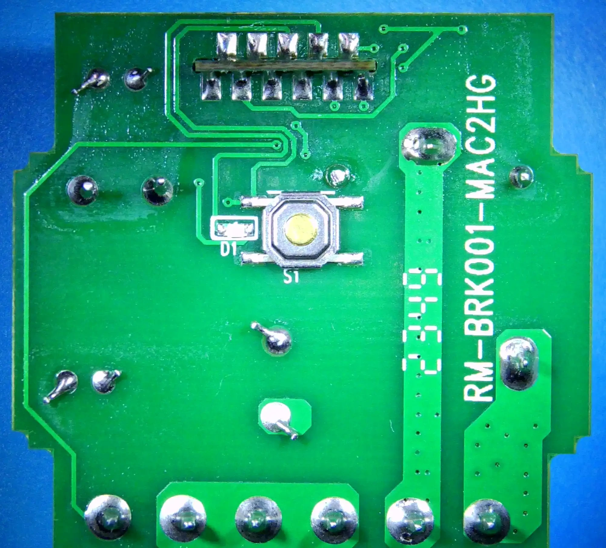

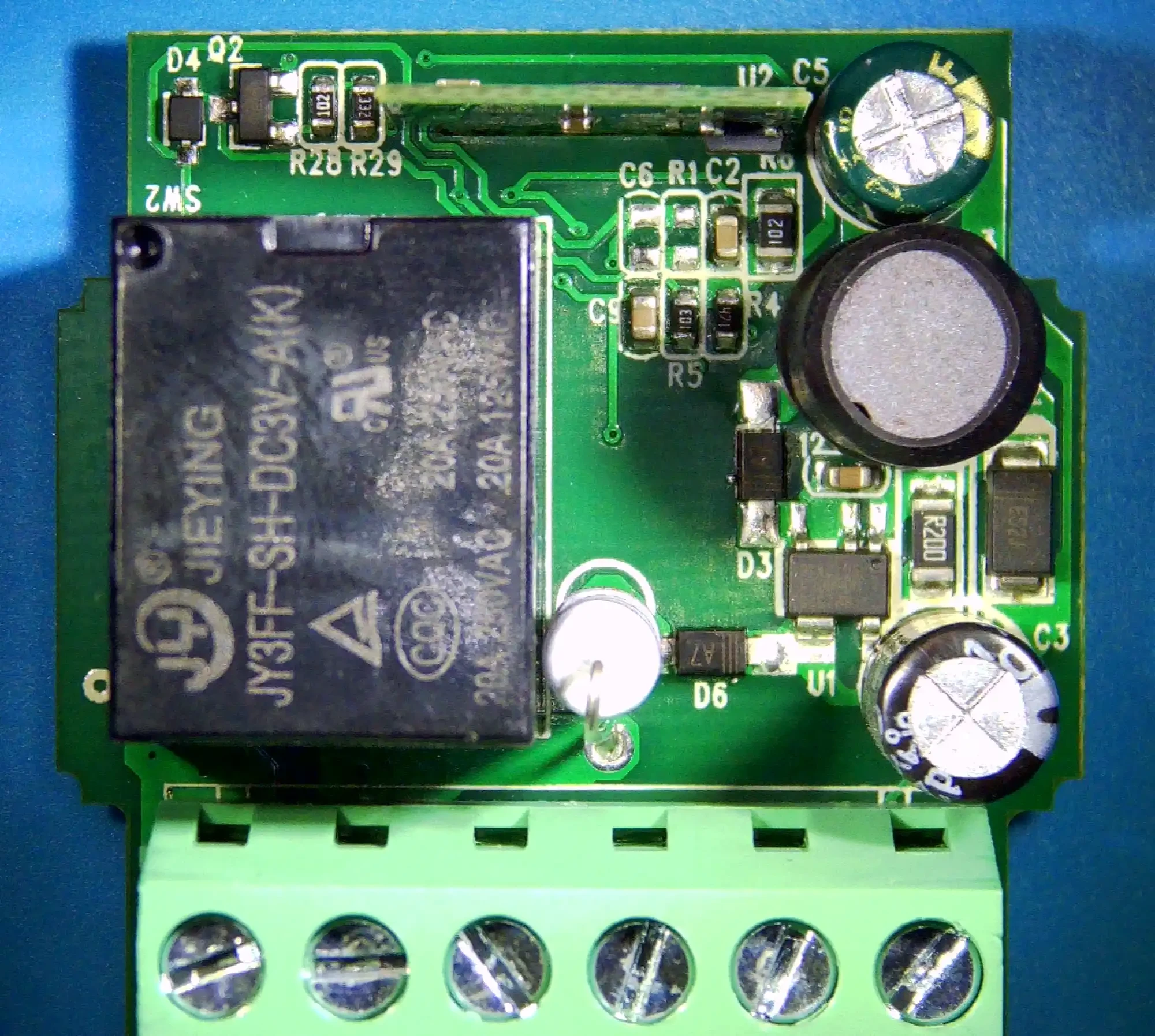

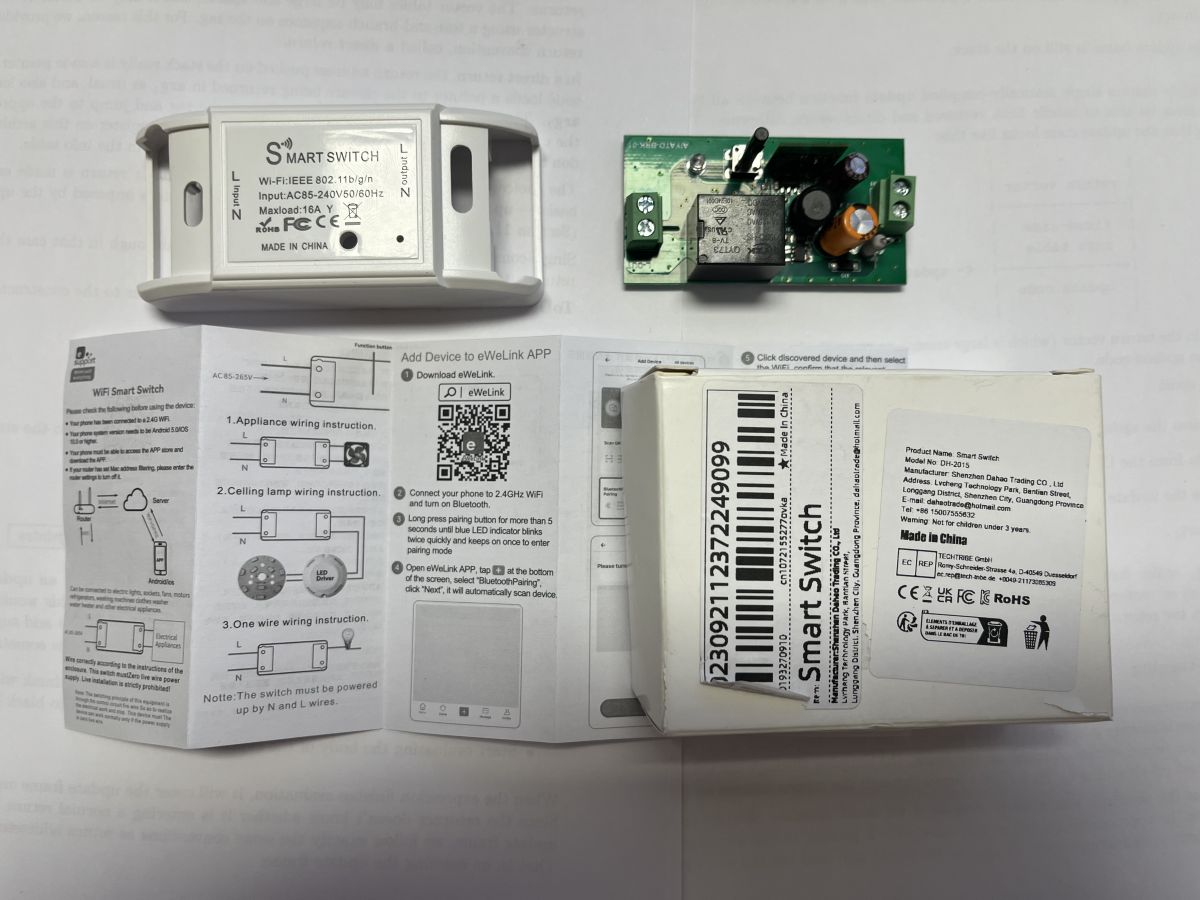

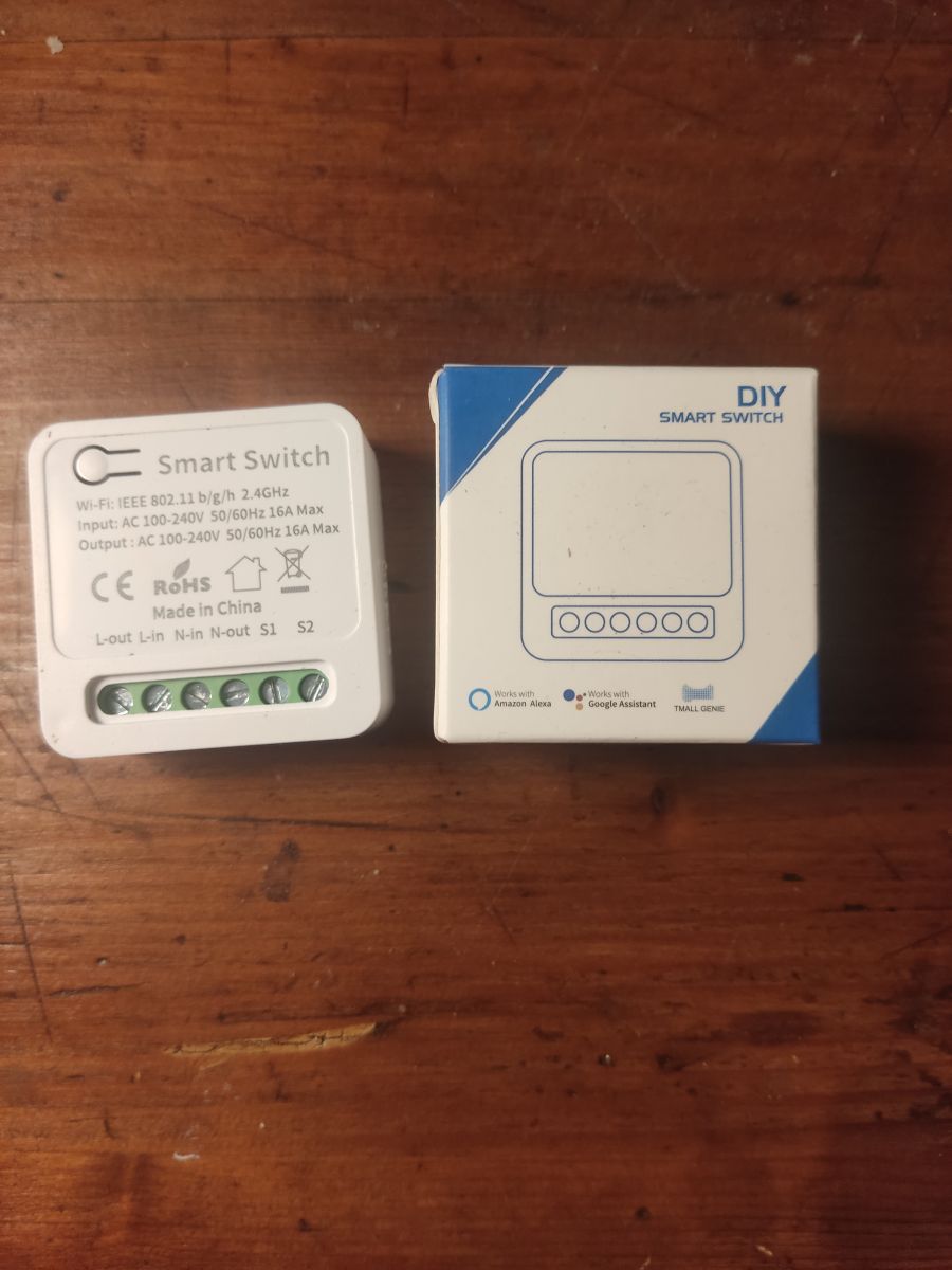

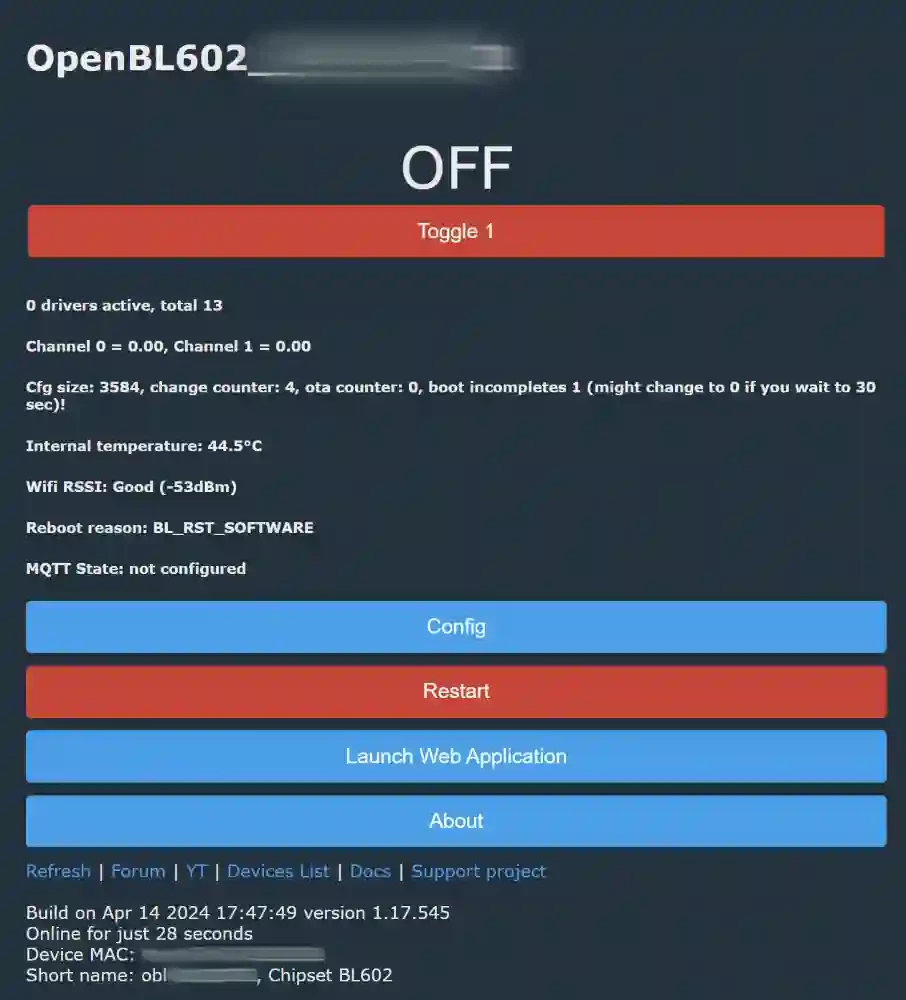

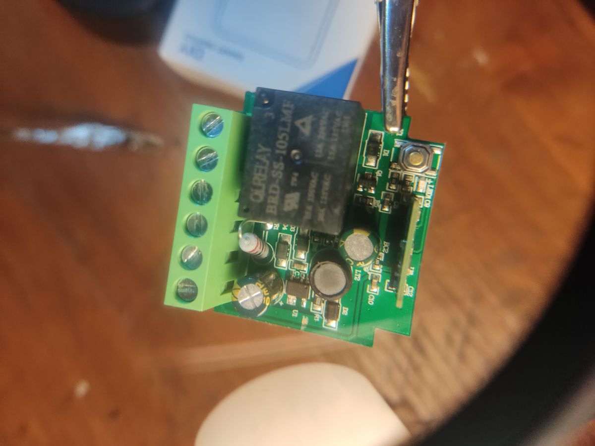

    I got a very similar switch from Aliexpress. (Looks different, but I could take the same config.)
    How to Flash BL602 Chip on Ewelink SM-028_V1.3 Smart Switch 16A from Aliexpress How to Flash BL602 Chip on Ewelink SM-028_V1.3 Smart Switch 16A from Aliexpress
    PCB is different.
    BL602 PCB in place and desoldered.
    Wiring and setup of BuffaloDevCube for flashing

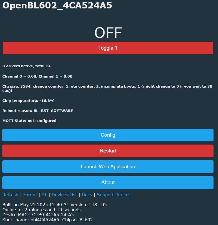

    How to Flash BL602 Chip on Ewelink SM-028_V1.3 Smart Switch 16A from Aliexpress Screenshot of Bouffalo Lab Dev Cube program with flashing settings.
    Button, LED and WebIF are working
    Edit:
    I used BuffaloDevCube incorrectly.

    You need to specify dts file in this flasher. If not specified, all devices will get the same MAC address.
    Added after 25 [minutes]:
    Your Mac is probably now C0:50:43:C9:00:01.

    I rewired everything and flashed again. At first, the MAC wouldn't change. Then I toggled "Chip Erase" to true. Now the MAC address is completely different. Hopefully the right one. Thanks again for pointing out my mistake.

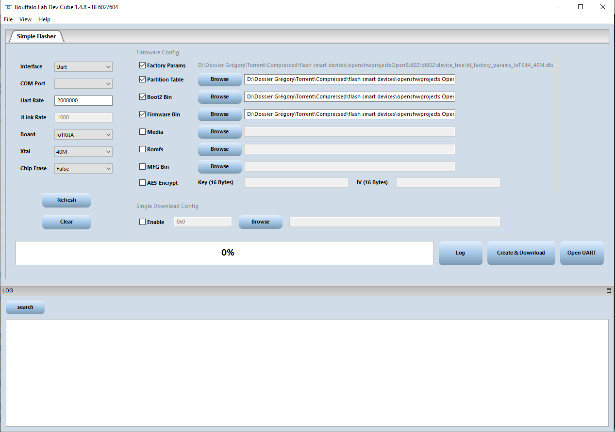

  • #8 21047780
    gregmarfaing
    Posts: 16
    It's nice to see that my config is useful,
    Anyway about the MAC address, I flashed mine with buffalo 1.4.8 and the MAC address is totally different from the "default" above without changing any setting and the UI is pretty different too
    : Screenshot of Bouffalo Lab Dev Cube 1.4.8 application with Simple Flasher mode open.
  • #9 21048027
    miegapele
    Posts: 173
    Help: 15
    Rate: 29
    Yes, because dts file is mandatory in this flasher

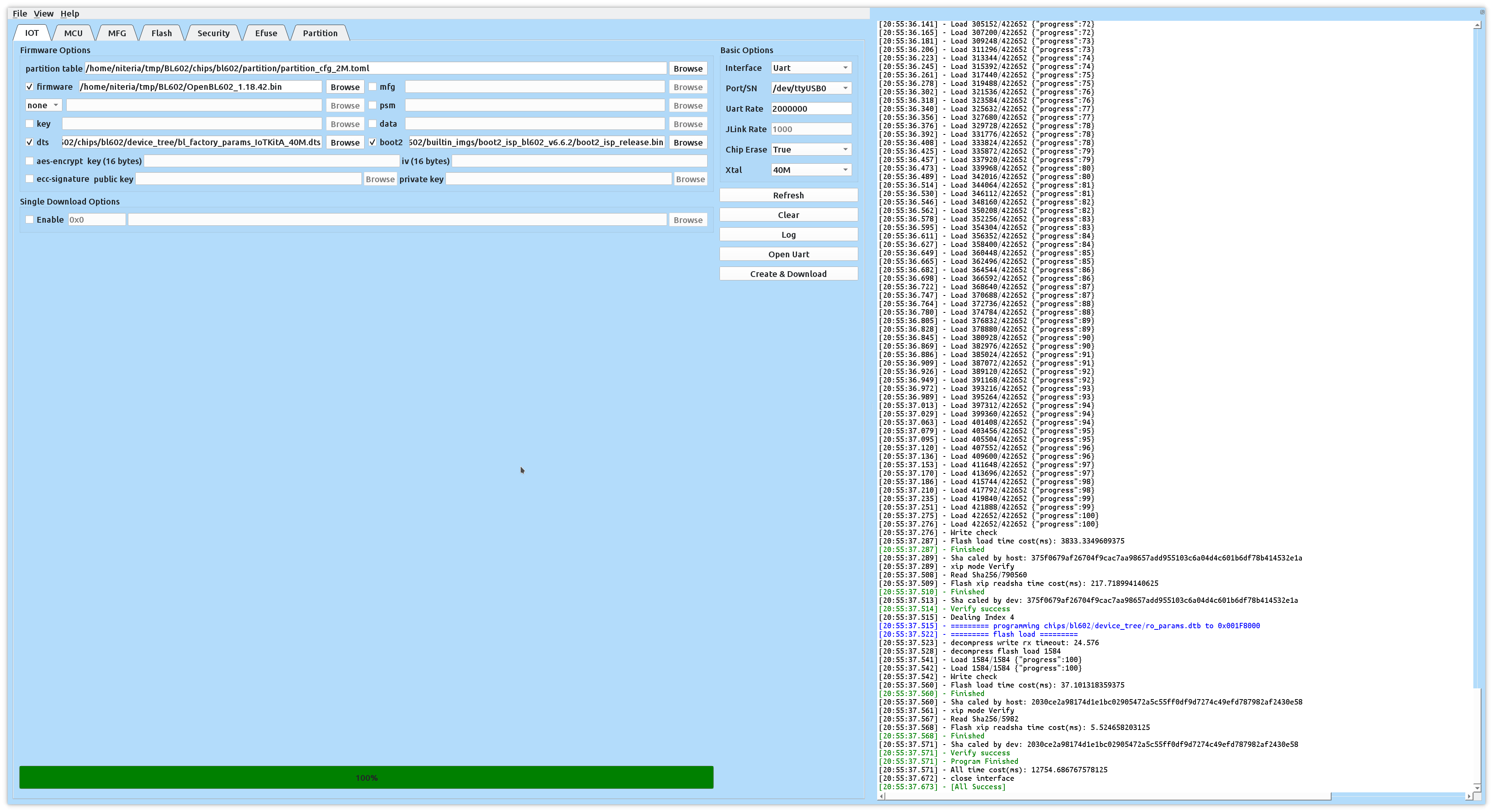

    #10 21447454
    niterian
    Posts: 12

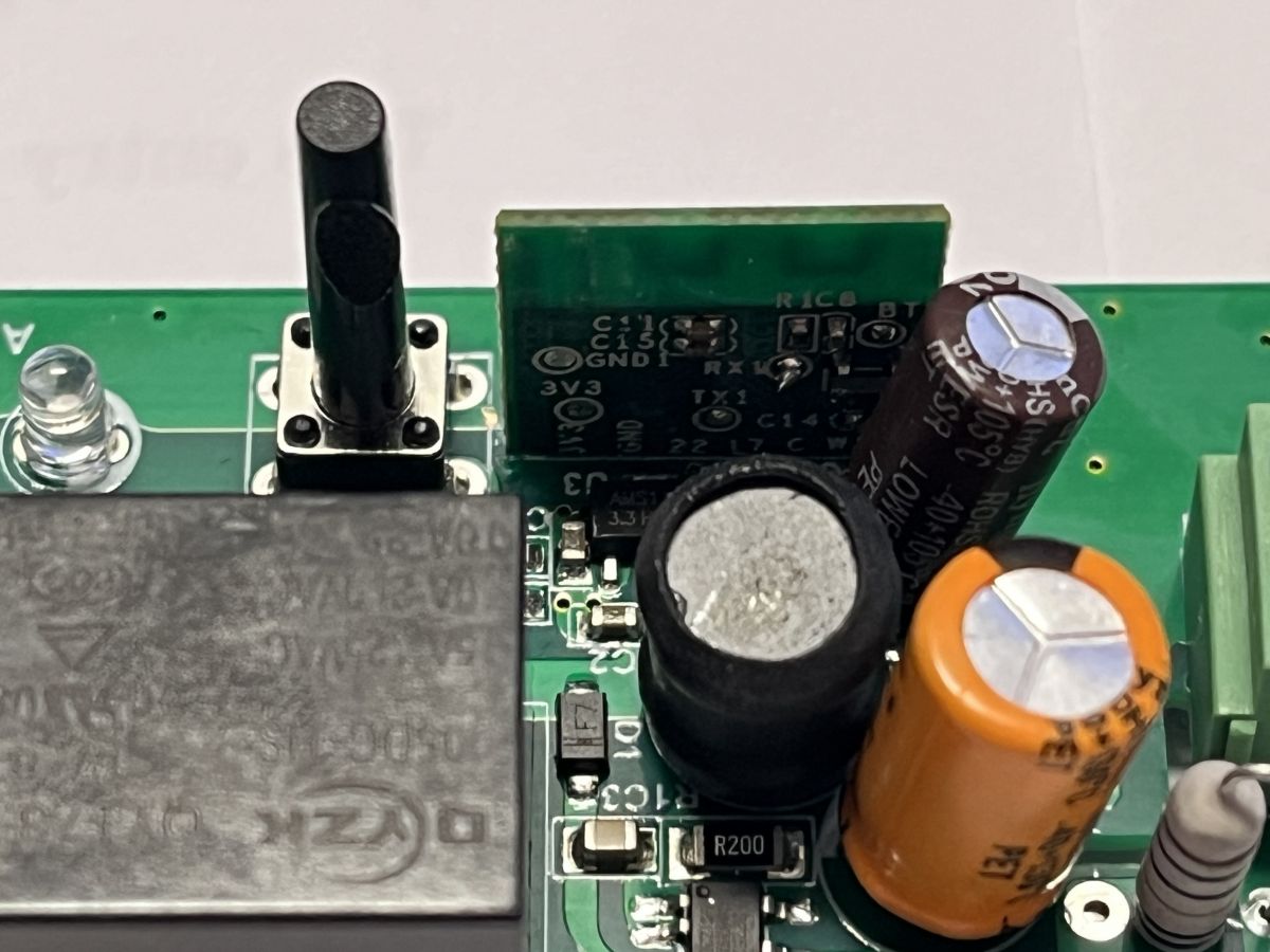

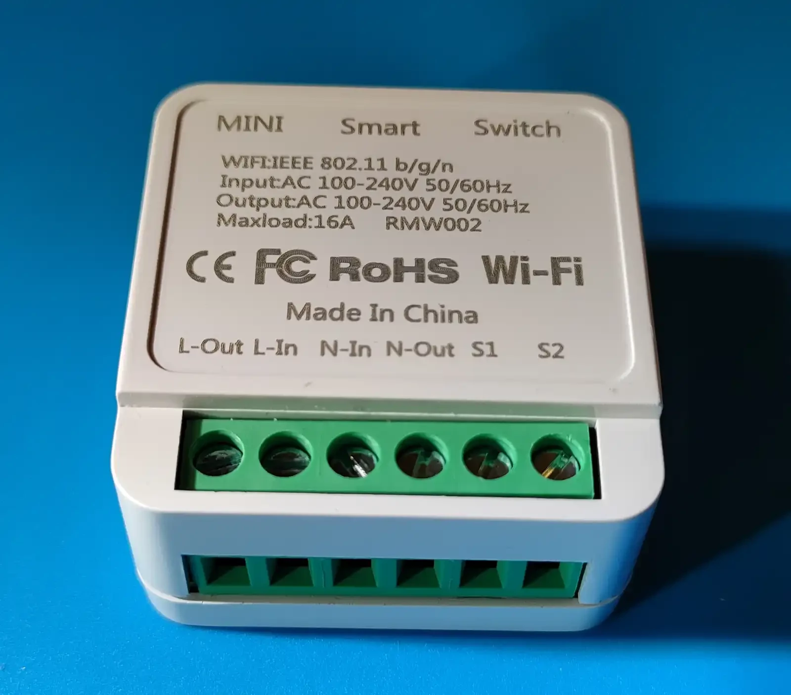

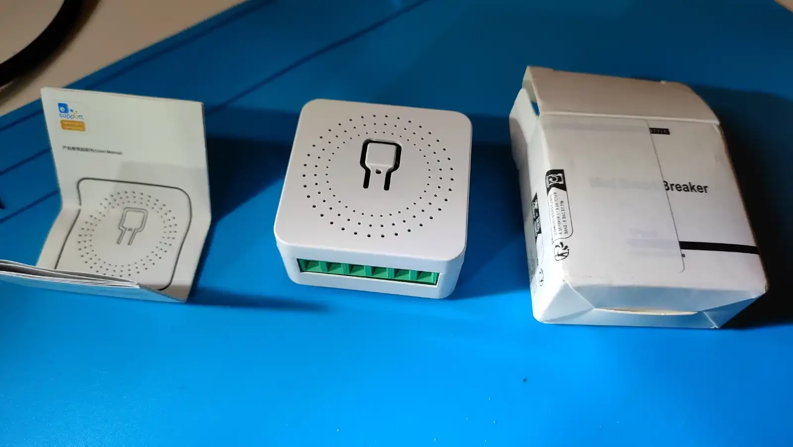

    There's another device that looks different, but the same config works.
    Aliexpress page: https://www.aliexpress.com/item/1005006157882766.html
    I got it for 9.53 PLN, ~2.38 USD
    White Smart Switch DH-2015 with WiFi support, 16A rating, compatible with Alexa, Google Assistant, and SmartThings.

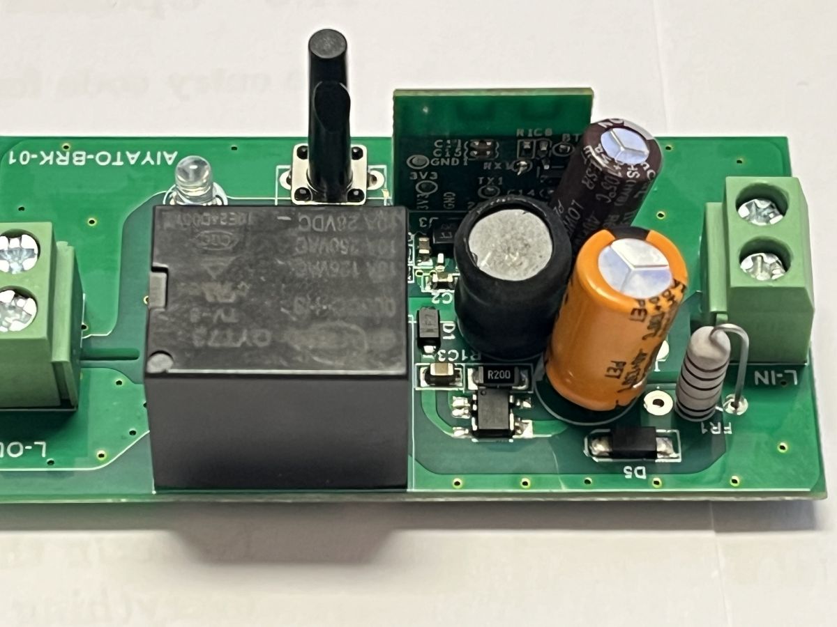

    Name on the package: Smart Switch DH-2015

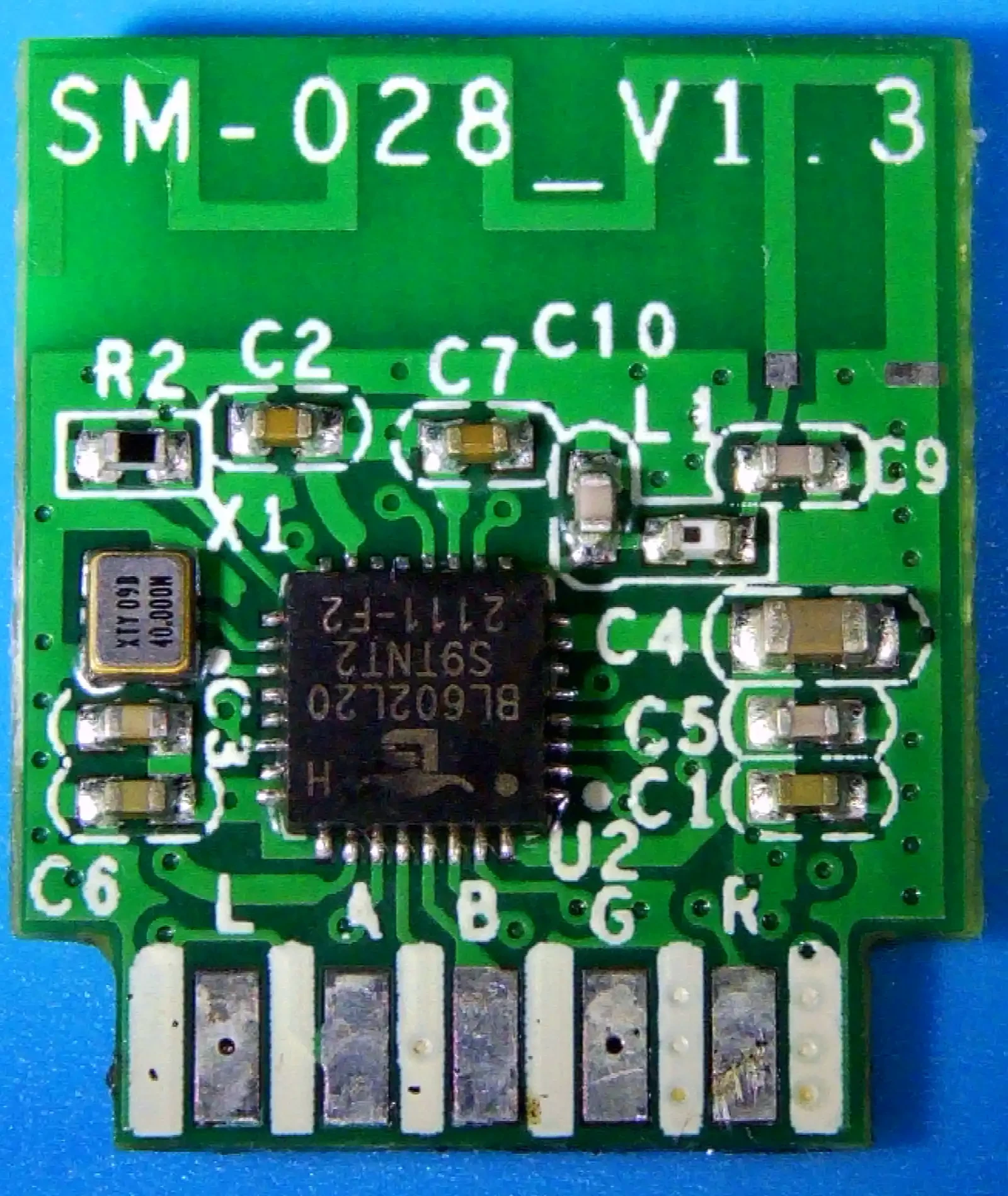

    Microcontroller module: SM-028_V1.3
    Name on the main board: AIYATO-BRK-01
    Smart Wi-Fi switch DH-2015 with instructions and packaging.
    Printed circuit board with SM-028_V1.3 microcontroller module mounted on it.
    Close-up of a device's mainboard with visible electronic components.
    It connects with eWeLink app.

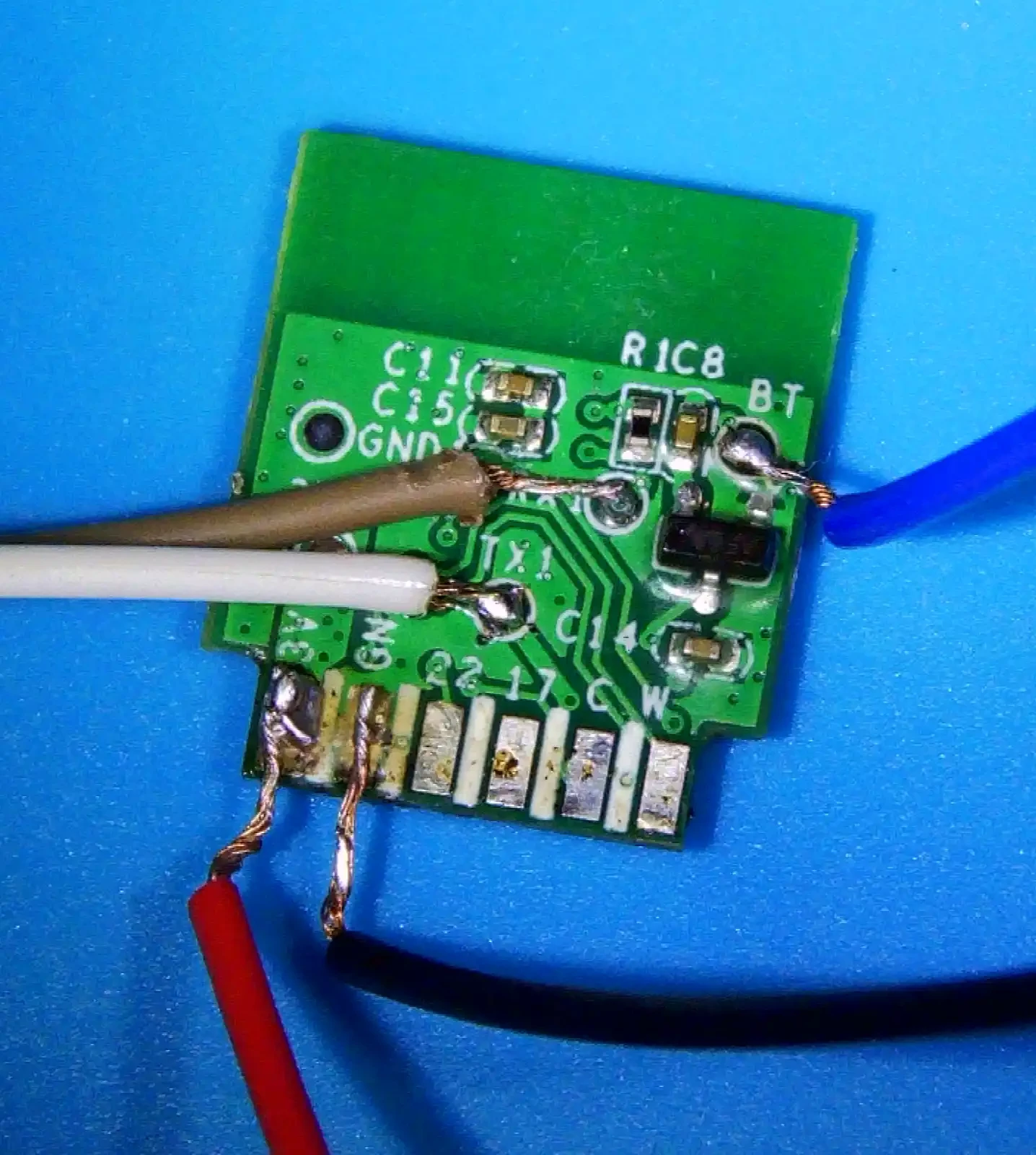

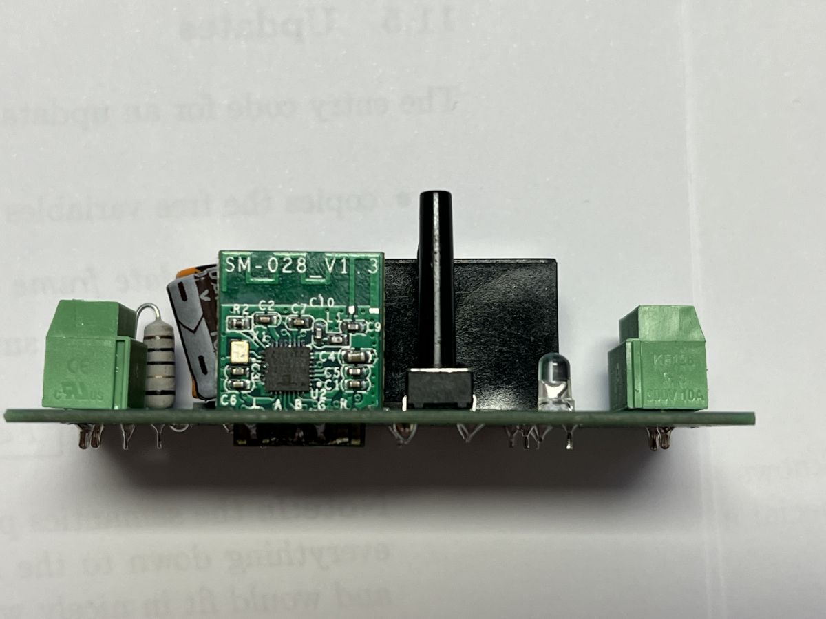

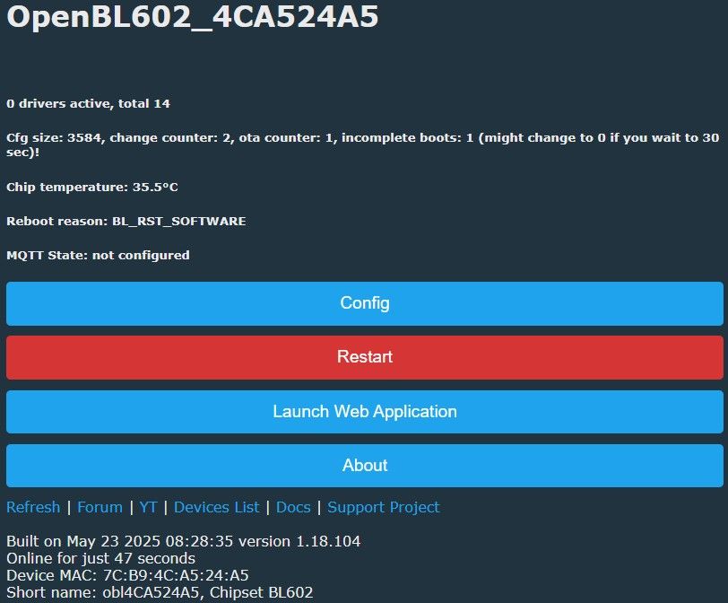

    TX and RX are inconvenient to reach with soldering iron, so I desoldered the microcontroller module.
    Close-up view of a circuit board with electronic components such as a relay, capacitors, and connectors.
    Electronic kit with breadboard, microcontroller, and wires.
    I've used BouffaloLabDevCube-v1.9.0.zip, it's convenient for me because it also has a Linux version.
    Bouffalo Lab Dev Cube software interface with flash log
    Flash log:
    Spoiler:

    [20:55:37.136] - Load 409600/422652 {"progress":96}
    [20:55:37.153] - Load 411648/422652 {"progress":97}
    [20:55:37.170] - Load 413696/422652 {"progress":97}
    [20:55:37.186] - Load 415744/422652 {"progress":98}
    [20:55:37.210] - Load 417792/422652 {"progress":98}
    [20:55:37.235] - Load 419840/422652 {"progress":99}
    [20:55:37.251] - Load 421888/422652 {"progress":99}
    [20:55:37.275] - Load 422652/422652 {"progress":100}
    [20:55:37.276] - Load 422652/422652 {"progress":100}
    [20:55:37.276] - Write check
    [20:55:37.287] - Flash load time cost(ms): 3833.3349609375
    [20:55:37.287] - Finished
    [20:55:37.289] - Sha caled by host: 375f0679af26704f9cac7aa98657add955103c6a04d4c601b6df78b414532e1a
    [20:55:37.289] - xip mode Verify
    [20:55:37.508] - Read Sha256/790560
    [20:55:37.509] - Flash xip readsha time cost(ms): 217.718994140625
    [20:55:37.510] - Finished
    [20:55:37.513] - Sha caled by dev: 375f0679af26704f9cac7aa98657add955103c6a04d4c601b6df78b414532e1a
    [20:55:37.514] - Verify success
    [20:55:37.515] - Dealing Index 4
    [20:55:37.515] - ========= programming chips/bl602/device_tree/ro_params.dtb to 0x001F8000
    [20:55:37.522] - ========= flash load =========
    [20:55:37.523] - decompress write rx timeout: 24.576
    [20:55:37.528] - decompress flash load 1584
    [20:55:37.541] - Load 1584/1584 {"progress":100}
    [20:55:37.542] - Load 1584/1584 {"progress":100}
    [20:55:37.542] - Write check
    [20:55:37.560] - Flash load time cost(ms): 37.101318359375
    [20:55:37.560] - Finished
    [20:55:37.560] - Sha caled by host: 2030ce2a98174d1e1bc02905472a5c55ff0df9d7274c49efd787982af2430e58
    [20:55:37.561] - xip mode Verify
    [20:55:37.567] - Read Sha256/5982
    [20:55:37.568] - Flash xip readsha time cost(ms): 5.524658203125
    [20:55:37.568] - Finished
    [20:55:37.571] - Sha caled by dev: 2030ce2a98174d1e1bc02905472a5c55ff0df9d7274c49efd787982af2430e58
    [20:55:37.571] - Verify success
    [20:55:37.571] - Program Finished
    [20:55:37.571] - All time cost(ms): 12754.686767578125
    [20:55:37.672] - close interface
    [20:55:37.673] - [All Success]
    First time I flashed I've made a mistake of not including the dts. I got the wrong MAC (C0:50:43:C9:00:01, same as others reported). It worked, but networking was flaky. After flashing with dts, it networking seems to work a lot better.
    I flashed OpenBL602_1.18.42.bin, but never got it to connect to my network.
    With this pull request https://github.com/openshwprojects/OpenBK7231...ions/runs/12794858548/job/35670919788?pr=1487, which I flashed with OTA, it connected to my network.

  • App-import template leaves AP unreachable after reboot
    #15 21560709
    AlexzeyK
    Hello!
    I have such a mini smart relay #21045630
    I successfully flashed it with OB. In "clean" (unconfigured) form I can connect to its access point, configure from the main web menu, reboot and it works.
    OpenBL602 control panel with configuration and restart buttons.
    I'm facing a problem using app-import...
    Here I am pasting a template from the devices page.
    (Ewelink) DIY smart switch in a white box on a wooden surface.
    Screenshot showing a configuration interface for generating and uploading scripts to DIY smart switch devices.
    I immediately see the changes on the homepage.
    Web interface of an OpenBL602 device with power off and technical information displayed.
    The device works until reboot (cold or hot).
    After rebooting I see the same access point, but I can't connect to it. From the WiFi monitor I can see that the access point is there. It works for some time 3-5 minutes and reboots. It is not possible to connect to it.
    Is there any advice for me? What am I doing wrong?
    Immediately after applying the template (without rebooting the device), I made a flash dump from the app flash menu.
    app_flash_...A524A5.bin (2 MB)You must be logged in to download this attachment.
    then I rebooted the device. I couldn't connect to the access point (it's impossible to connect to this network). I did a flash dump in the BuffaloDevCube program.
    bad_flash..dc.bin (2 MB)You must be logged in to download this attachment.
    It is possible to exit this mode only by reflashing the flash file (or a backup of the "clean" firmware, without settings).
    If you flash this backup to "clean firmware" - it is not possible to connect to the access point. The problem is probably somewhere here...
    Any ideas what the problem is?
    #16 21560785
    Posts: 5236
    Help: 450
    Rate: 920
    Powersave should be fixed, but to rule that out, remove powersave 1 - does it work after that?
  • #17 21561399
    AlexzeyK
    @divadiow Thank you very much, my friend!
    Your advice worked. Now the relay works as it should.
  • #18 21561424
    Posts: 5236
    Help: 450
    Rate: 920
    interesting. I notice earlier you said you rebooted and it was still broadcasting an AP, have you at any point had powersave 1 enabled and the device in STA mode connected to an AP itself?
    I have just flashed 1.18.106 to a dev board and imported the template in the first post. My device is in STA mode and it is happy with powersave 1 in startup command.
  • powersave1 prevents connecting to the access point
    #19 21561488
    AlexzeyK
    >>21561424 yes. I agree with you. The problem is in powersave 1.
    I just flashed 105 firmware and removed the powersave command from the generated script.
    Screenshot showing a configuration panel with three steps: pasting a template, generating a script, and applying the script for a DIY smart switch device.
    Rebooted the device. The device created an access point and I was able to connect to it. Previously (with powersave1) the device created an access point. But it was not possible to connect to it.
    Now I erased the chip. Flashed 106 firmware and did not remove the powersave1 command from the script (ashere ). That is, I repeated everything from my post >>21560709 , but with 106 firmware. The result is the same: the device creates an access point, but it is not possible to connect to it.
  • #20 21561491
    Posts: 5236
    Help: 450
    Rate: 920
    OK, but what if you join the device to your wifi/router? does powersave 1 work with device in STA mode?
  • #21 21561501
    AlexzeyK
    >>21561491 Not working)
    I used the script without the powersave1 command. I did all the settings (MQTT, etc.), connected to the wifi router, rebooted. Everything works fine. The device received an IP, connected to the MQTT. Now I entered the powersave1 command, rebooted, and the device no longer appeared on the wifi network. Rebooting several times did not change the situation.
