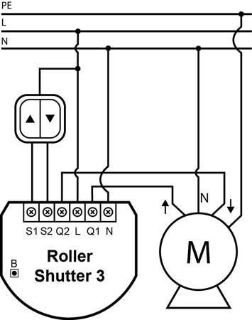

    I have several Fibaro devices installed. Now it's time to install Roller Shutter controllers but as I have two blinds installed on my patio windows on each I'm wondering if it's possible to control one controller for two blinds at the same time?
    Wiring diagram for connecting Fibaro Roller Shutter 3 to a blind. .
    • Fibaro Roller Shutter control of two roller shutters -Rolet-FIBARO-FGR223-221_6.jpg (22.76 KB) You must be logged in to download this attachment.

    All in all, there should be no problem. The question is whether the relay will hold. It depends on the power of the motors.

    Relays should withstand . Motor power per roller shutter approx. 150-200 W
    Excerpt from technical data:
    Power supply voltage: 100-240V~ 50/60 Hz
    Rating current: 4.2A for resistive load
    1.7A for power-compensated motors (inductive load)

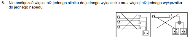

    But, in the manual of e.g. Inel motors it is written:
    Diagram showing incorrect connection of motors to switches.
    Somfy also has this information.
    Read also this: https://www.elektroda.pl/rtvforum/topic1028649.html
    There the problem with such a connection is described in detail.

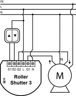

    To give can be given. Although this is a very unfortunate solution.

    A separate Roller Shutter for each roller shutter and this is the best solution .
