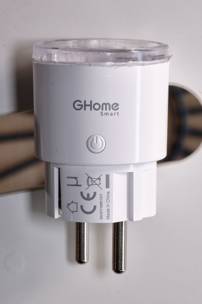

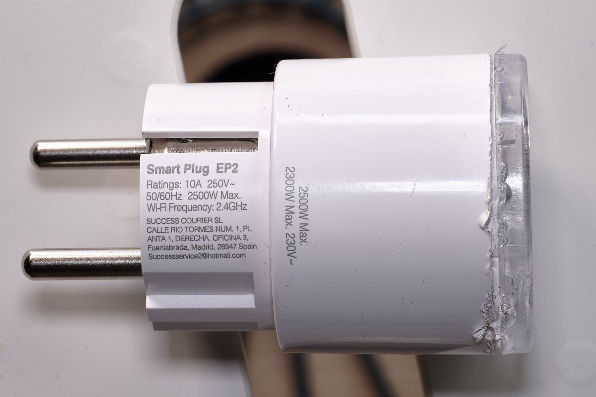

  • I bought a Smart Plug on Amazon before I even know things like OpenBeken even existed.
    I will post my teardown here in high hopes a clever mind can make the device supported :)
    The outside:
    (It is a little tricky to open this plug, that is why it looks so beaten up ...)
    White GHome Smart plug with a power button, placed against a white background. Close-up of the Smart Plug EP2 with visible technical specifications.

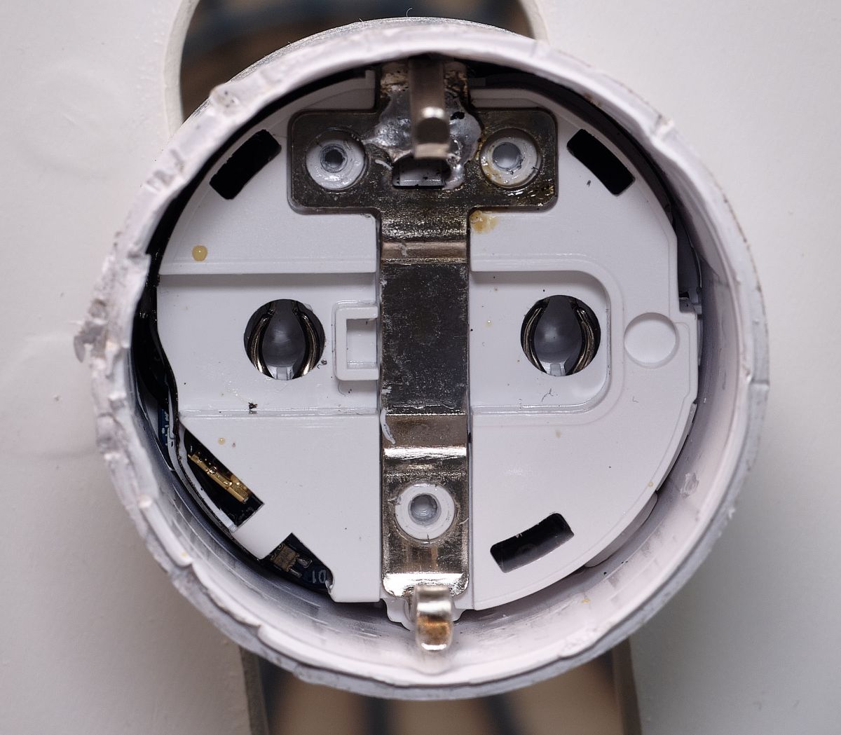

    After taking off the cover you have to unsolder the protective contact and unscrew some screws. (already done in the picture)
    View of the interior of a disassembled smart plug showing metal and plastic components.

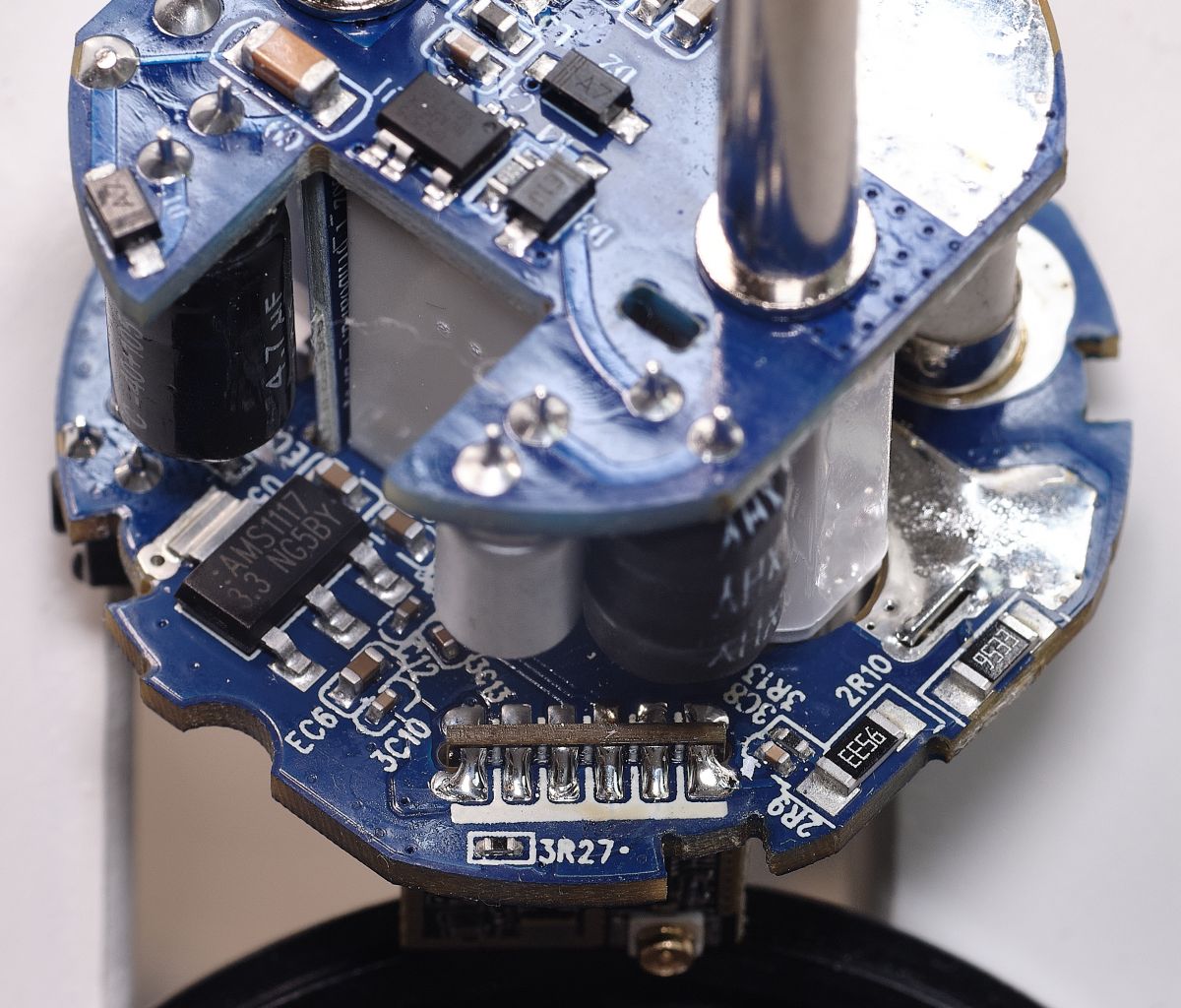

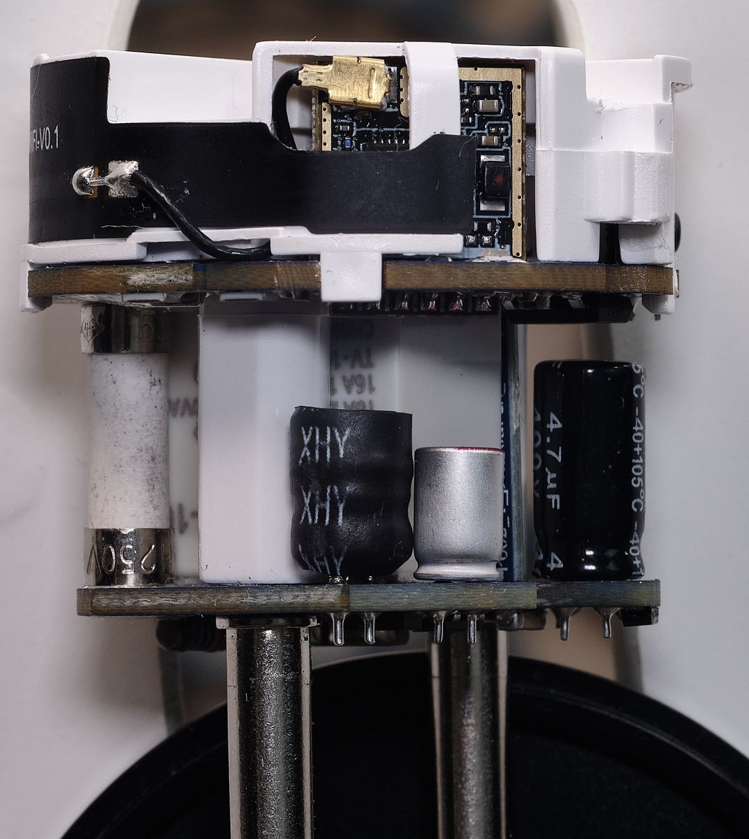

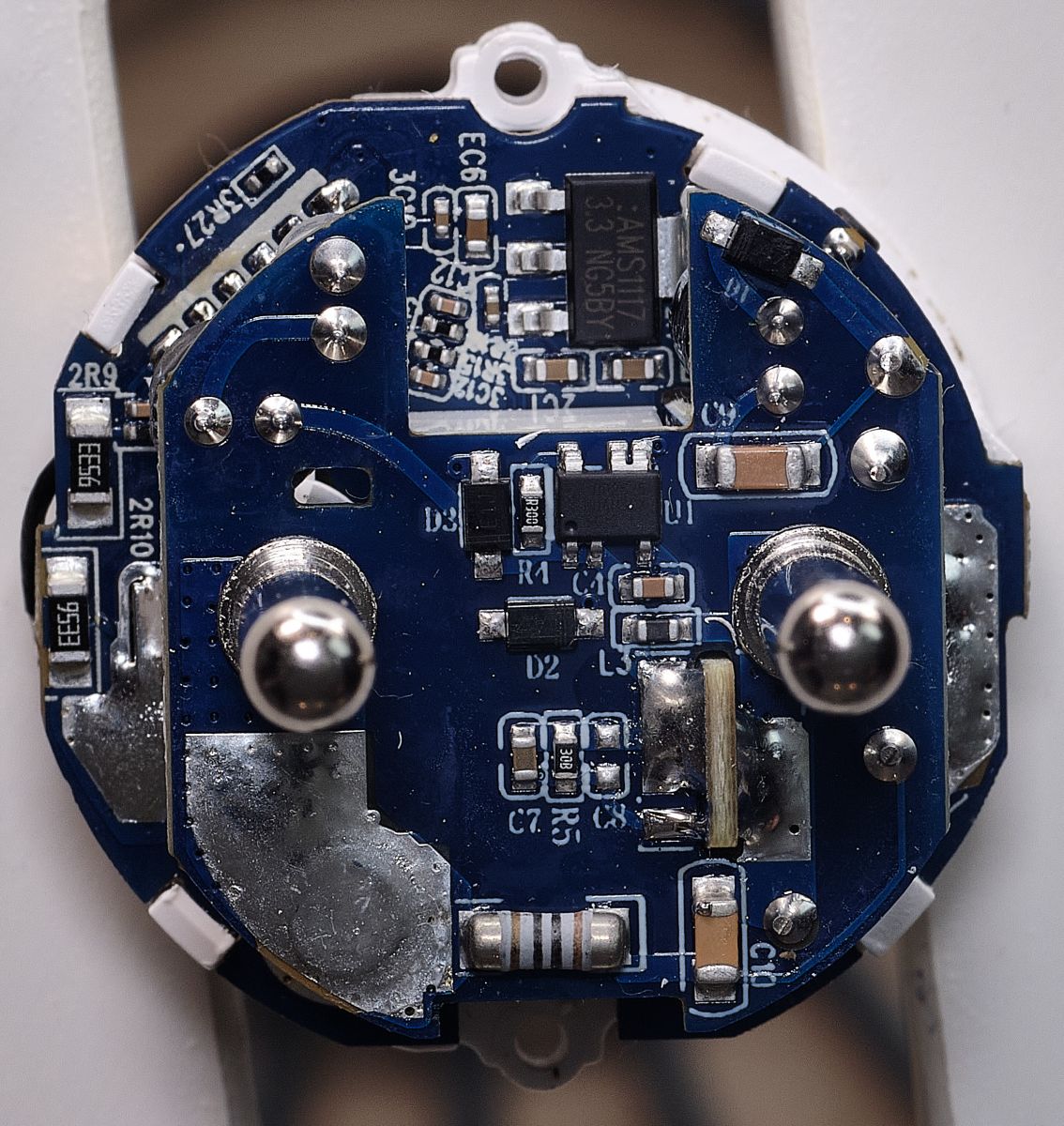

    Then you can take out the internals. Here is the probably uninteresting bottom:
    Close-up of the PCB with the communication chip in a Smart Plug device.
    To get to the communication PCB you have to unplug the antenna U.FL connector.
    Interior of a smart plug with visible electronic components and a communication board.

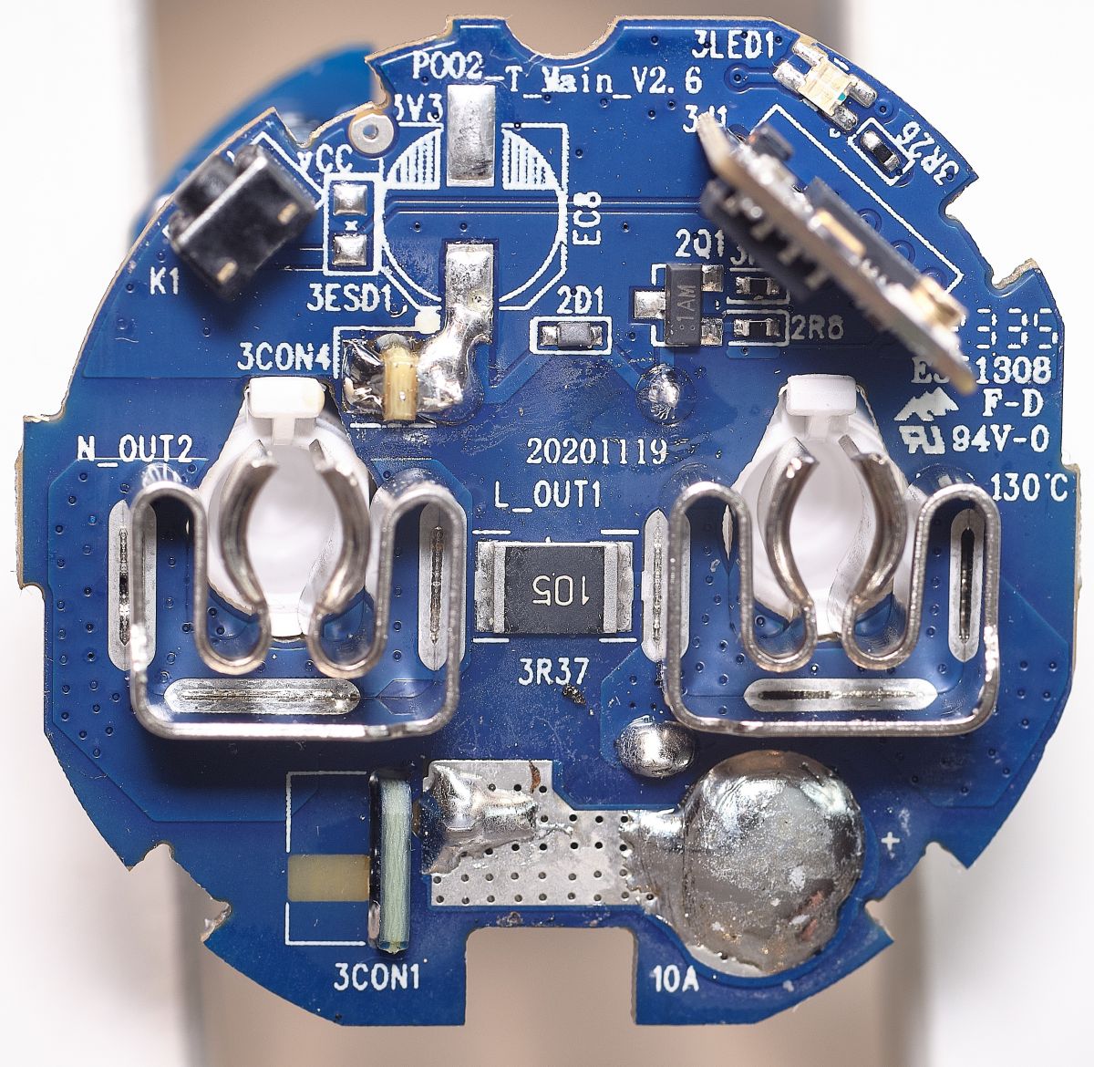

    The front PCB where the communication board is connected to:
    Close-up of the internal PCB of a smart plug.

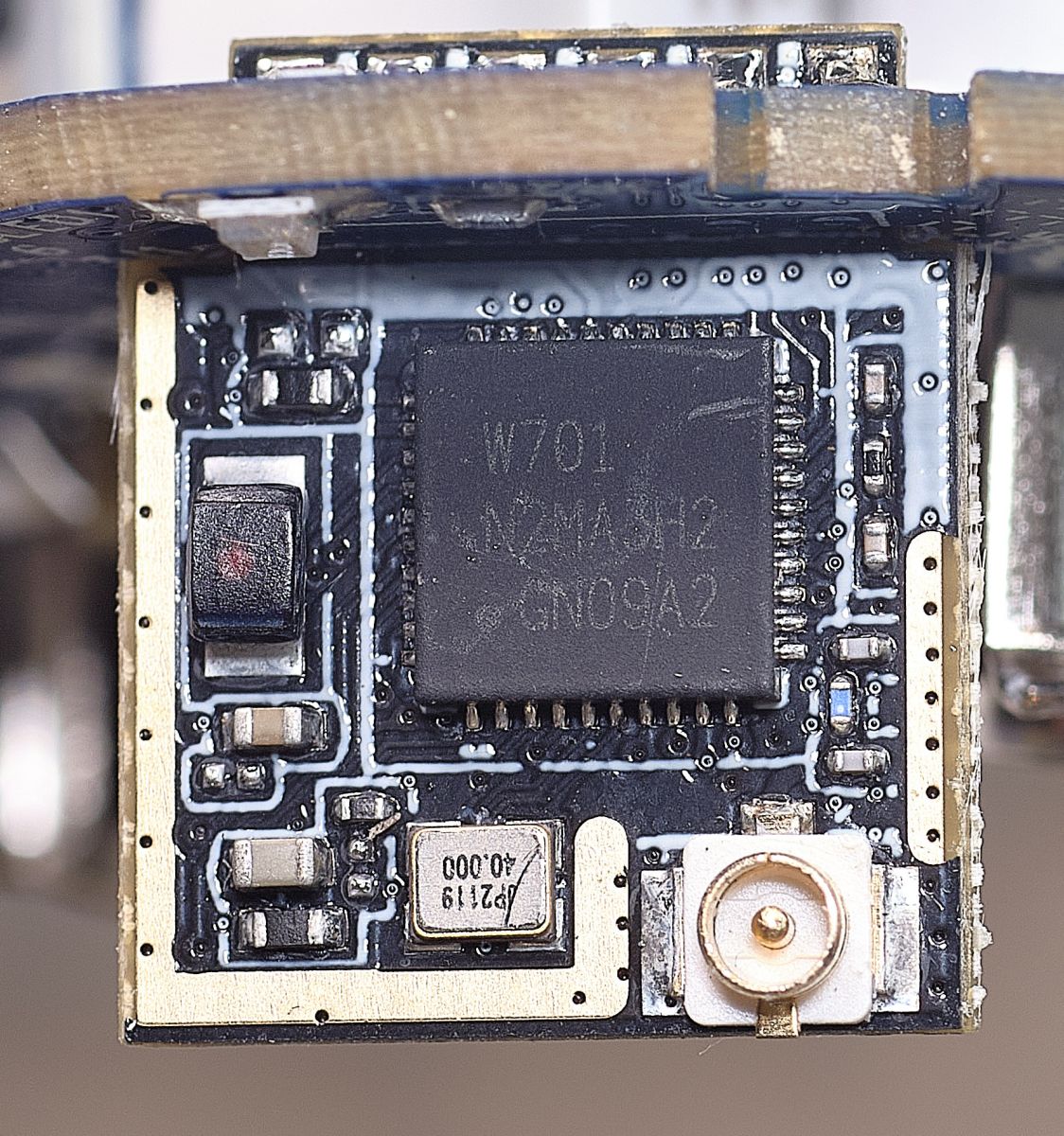

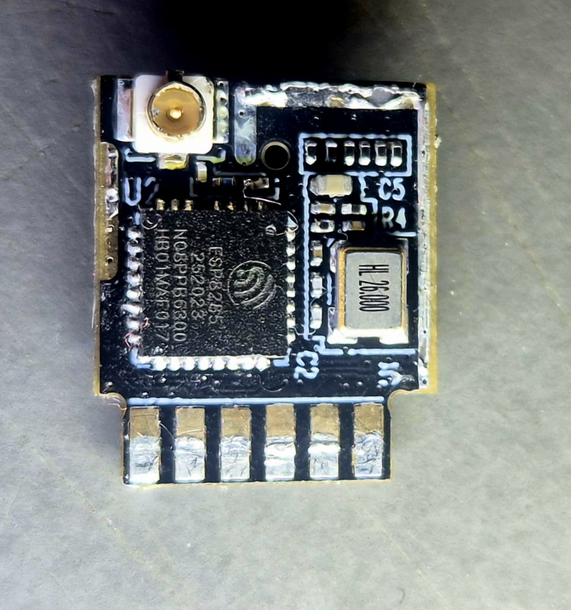

    Detail view on the communication PCB with W701 chip. Front and Back
    Close-up of a communication board with a W701 chip and U.FL connector. Close-up view of the smart plug communication board with chip W701.

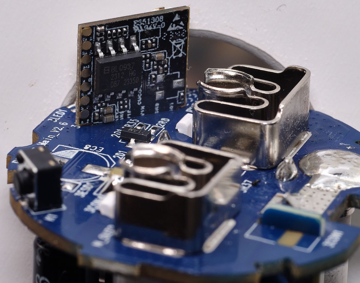

    And here is how the comm PCB is soldered to the main PCB.
    Close-up of the internal components of a disassembled Smart Plug with visible electronic elements.

    I haven't seen that kind of W701 module before. Can you desolder it and show the high quality photos of the pad markings, where is VDD, GND, etc?

    Mmmhhh I am trying to desolder at the moment. It is difficult to reach the back side of the solder spots. The front side is pretty clean. Already tried hot air and soldering iron with desolder wire...

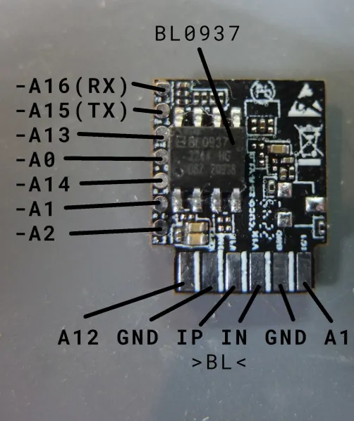

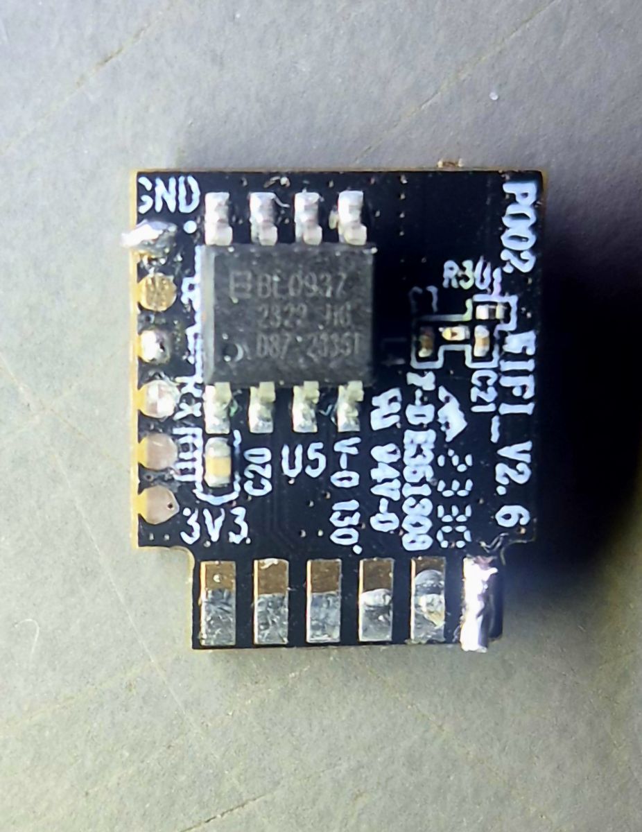

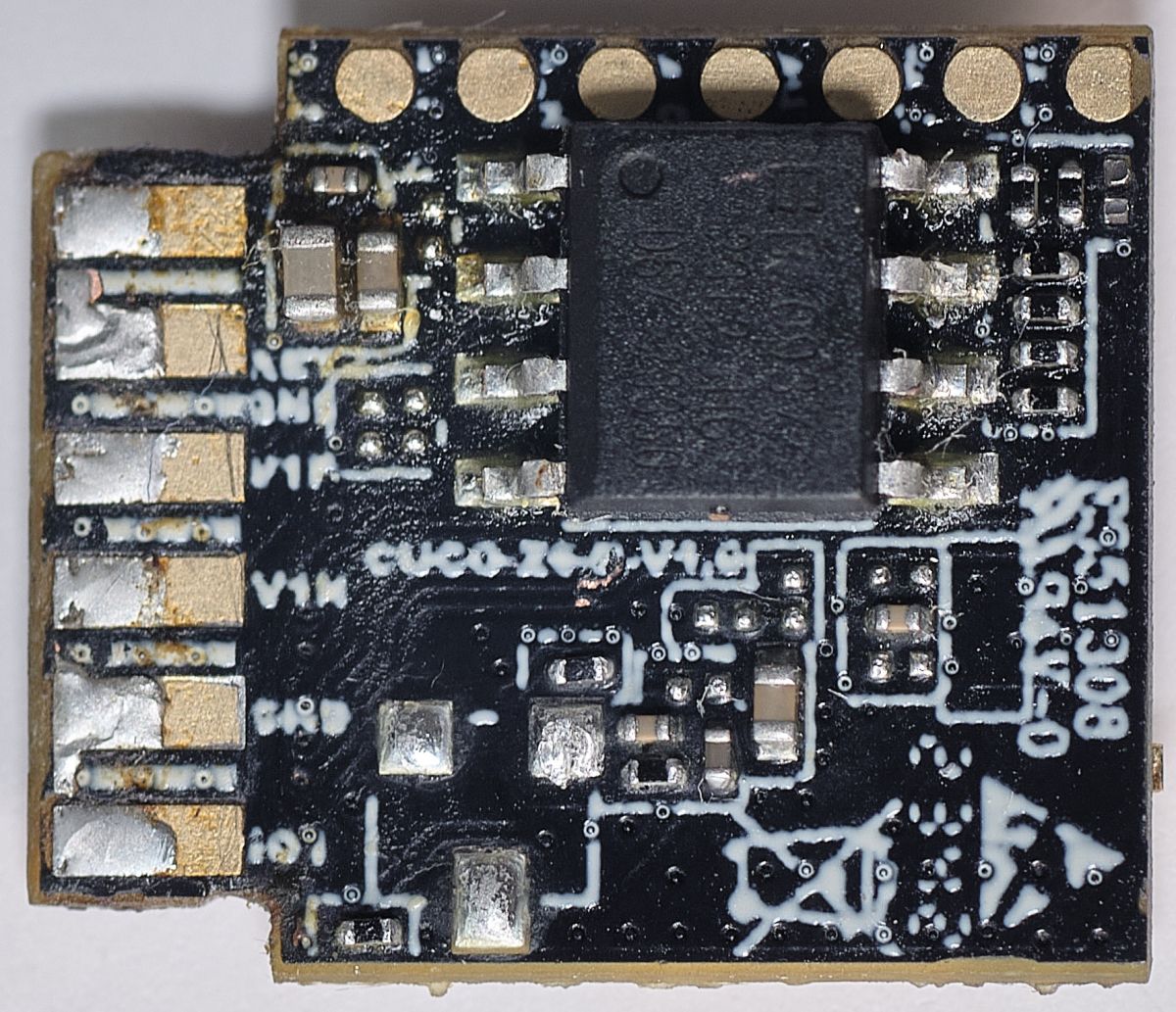

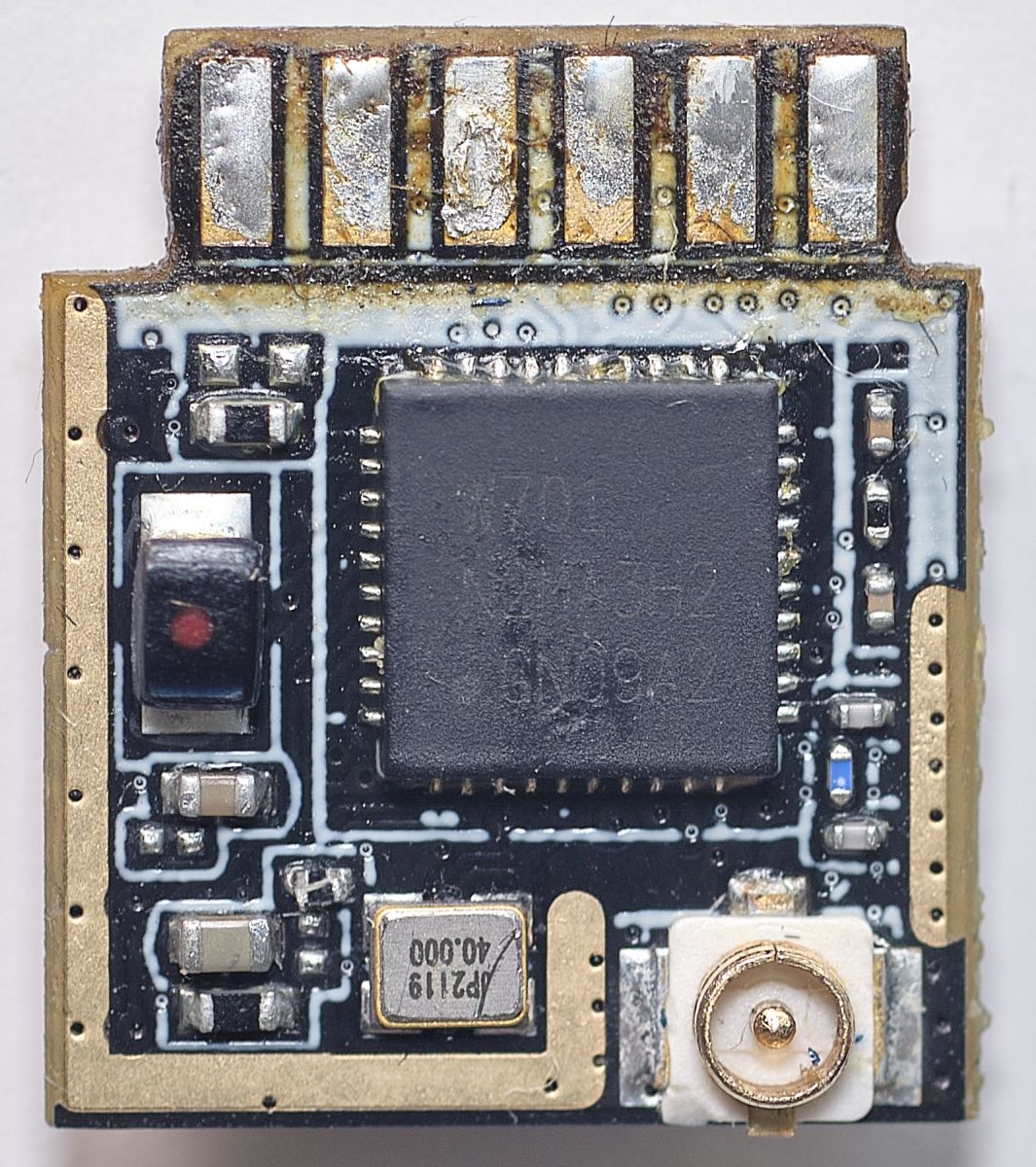

    I managed to get this nasty little fella out.
    First the side with the W701
    Close-up of a PCB with various electronic components.
    And now the other side with the BL0937 and some labels. The PCB labeling machine seems to be a one from Wish ;) Hard to decipher.
    Close-up of a PCB with various electronic components and labels.

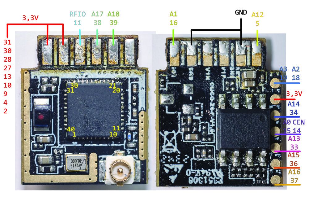

    My guesses:
    Pins Top to Bottom:
    1. ? (maybe it is the one under the 2 caps) AET (?)
    2. ? (maybe it is the one under my guess in number 1) ON (?)
    3. V1r
    4. V1N
    5. GND
    6. IO1
    And the main label on the board:
    CUCO-Z??-V4.0
    Now my eyes need a break :) What do you say, what are your guesses?

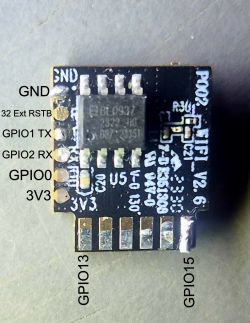

  • #6 21005807
    Posts: 5236
    Help: 450
    Rate: 920

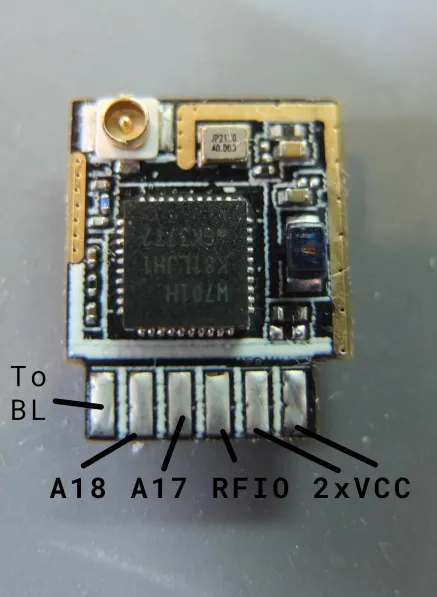

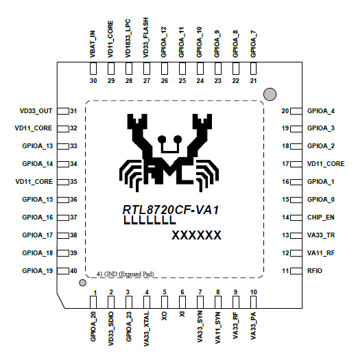

    found elsewhere but looks to be a W701H, so maybe pins are diff
    Electronic module with pin labels and BL0937 chip. Electronic module labeled as W701H with marked pins A18, A17, RFIO, and 2xVCC.
    from a Gosund EP2 [RTL8720CF]

    Nice find. Thanks a lot.
    What means 2x VCC ? 6,6V?
    Edit: I got it. Both pins are VCC. Sorry.
    I mean i could solder some wires and see if the thing draws current ...
    I found this github discussion where a plug from Blitzwolf seems to be the same plug.
    Added after 1 [hours] 7 [minutes]:
    I got something from the board.
    I hooked it up like that:
    Two electronic boards with labels 3.3 V, GND, TX, and RX.
    Listened to the COM-Port and got this:

    So i inspected the PCB a little further and traced the outer pads to the W701.
    That is what i got:
    Close-up of two printed circuit boards with pin markings.
    So it seems to have the same pin out as this little fella:
    Pin diagram of RTL8720CF-VA1 chip
    I read some tutorials on how to flash Realtek AmebaZ2 chips and decided to pull A0 and CEN (both on the same outer pin) to 3.3V.
    Et voila. Now i get this via UART:
    == Rtl8710c IoT Platform ==
    Chip VID: 5, Ver: 3
    ROM Version: v3.0
    Test Mode: boot_cfg1=0x20
    Download Image over UART2[tx=16,rx=15] baud=115200
    Since i am already hooked up to pin 16 and 15 i guess i just need something to download ...
    I discovered something called LibreTiny. Looks promising...
    Added after 5 [minutes]:
    >>21006660
    I have 2
    Do you want the link to the amazon item?

  • EP2-A uses ESP8285 on reverse side of PCB
    #14 21277836
    Hilgude
    Got some EP2-A recently in a pack of 4 explictly advertised as runnning an ESP8285.
    The full teardown will be exactly the same.
    The internal and external is the same device, except the module, is yes, based on ESP8285 and is soldered on the other side of the PCB...
    (Didnt find any similar one anywhere on Google).
    Managed to convert the 3 other one of the pack easily with Tuya-Convert (running Tasmota now).
    (One theses 3, recently died unexpectedly and is waiting a Forensic).
    ESP8285 module with visible electronic components on a PCB. ESP8285 module on a PCB with labels and connectors.
  • #16 21279586
    Posts: 14797
    Rate: 12954
    Interesting, so you've got a different or older batch? When are they using W701, and when ESP?
    Do you have Tasmota template?
  • Bad wall socket likely killed BP2525 regulator
    #17 21280776
    Hilgude
    >>21279586
    Hard to say why there is two versions of these plugs ...
    The Amazon vendor explicitly advertised it as it can be Tasmota converted with Tuya-Convert.
    See this : https://amzn.eu/d/4jDsu5C
    Here is the template i made for it :
    {"NAME":"EP2-A","GPIO":[576,1,320,1,2656,2720,1,1,2624,32,1,224,1,1],"FLAG":0,"BASE":18}

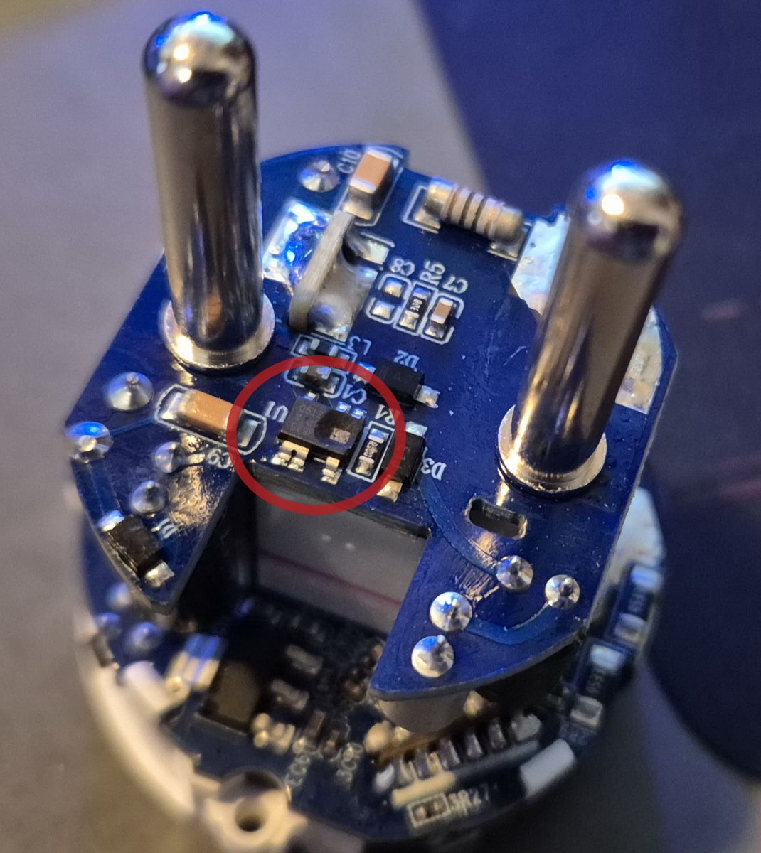

    Some news about the "dead plug", my problem occured with a wall socket where there was a bad contact.
    Thus the power was going quickly up and down randomly as you touch it...
    It appear that the BP2525 regulator inside the EP2, didnt like it very much...
    I'am waiting some replacement part to check if the plug will be back alive after a replacement
    Close-up of a circuit board with a marked component.
