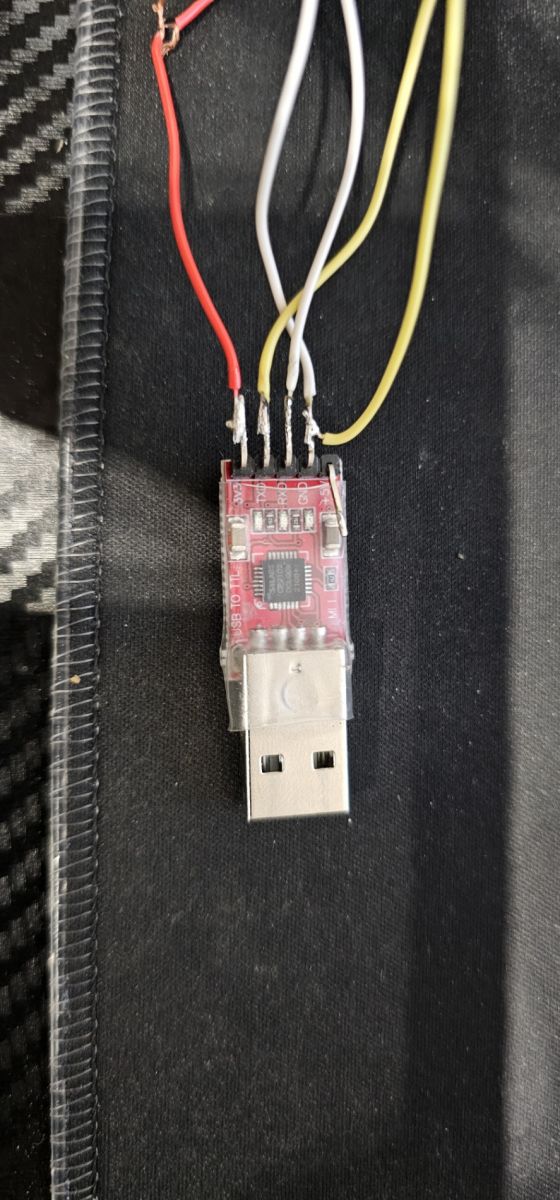

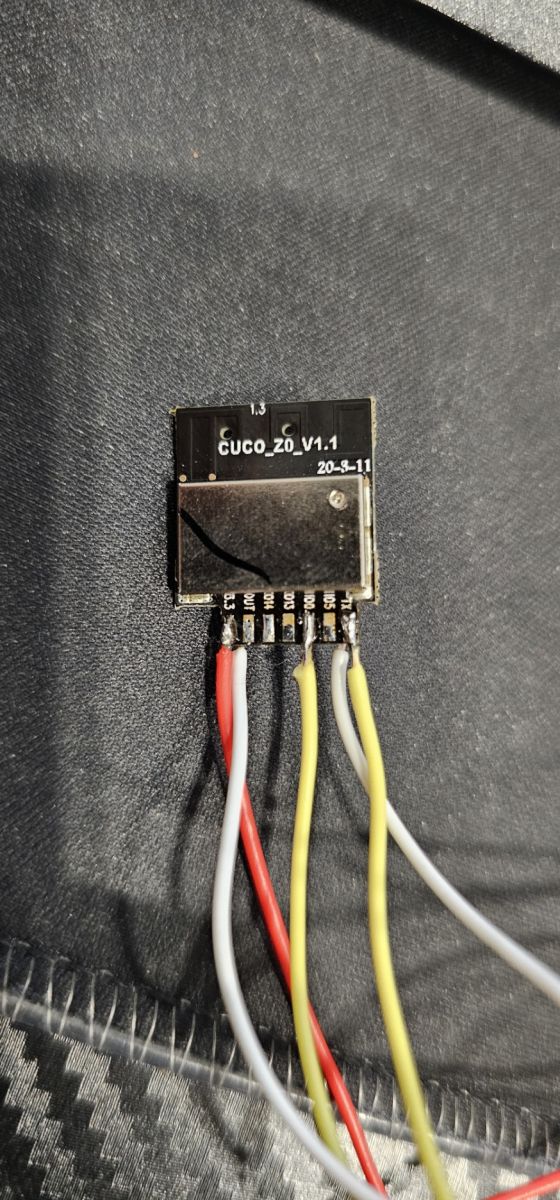

    Hi, I have a wifi chip CUCO_Z0_V1.1 and would like to modify it, install openbeken or something else that works after mqtt.
    It is from a gosund power strip. I have a usb converter for the rx and tx pins. I connect the 3.3v power supply, ground and the rx and tx cables (also tried the other way around) but I can't communicate with it with any program. I know that the IO0 pin is used to reset it but something is not working. Maybe someone could help?
  • ESP8266 bootloader mode requires IO0 grounded before reboot

    Ok, give me 5 minutes to test what you write. I will try to upload it using the installer. The programmer I have on it already installed openbk so probably no problem USB to TTL CP2102 adapter with connected wires .

    Are you programming in or out of the circuit?
    In my opinion, powering directly with 3.3V from a USB to UART converter is not reliable, you may miss the current, but try. Read my topics, I always either plug in 5V before the AMS1117-3.3V (LDO 3.3V) on the board or take 3.3V from my LDO 3.3V with high current capability.
    How does this Gosund strip with this module look like? Potentially there could also be a problem with how the module is in the circuit you may need to solder it out.

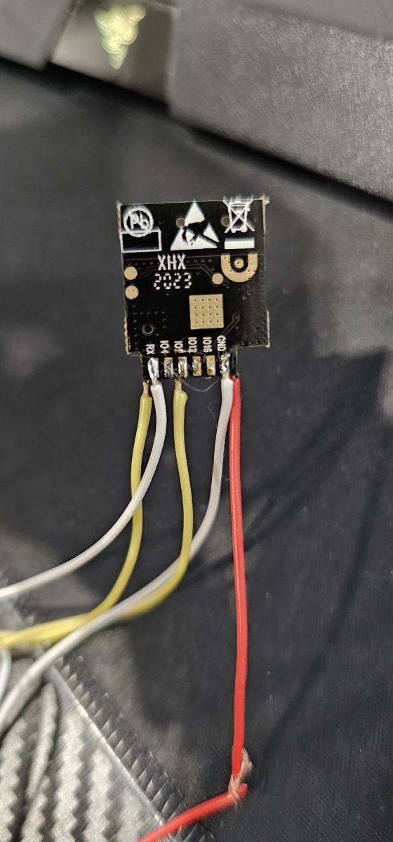

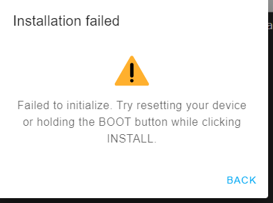

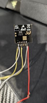

    Something is wrong, I keep getting something like this popping up Installation error message stating Failed to initialize. Try resetting your device or holding the BOOT button while clicking INSTALL.
    Added after 4 [minutes]:
    I have the chip soldered, I have the cables stripped to possibly change something, do you think there could be a problem with the power supply? I can connect a separate 3.3v power supply Close-up of a USB module with attached wires in various colors. Chip labeled XHX 2023 with connected wires, one of which is red. Circuit board with visible wires and CUCO_Z0_V1.1 marking Circuit board with visible wires and CUCO_Z0_V1.1 marking
  • Try normal power, shorter wires, and RX/TX swap

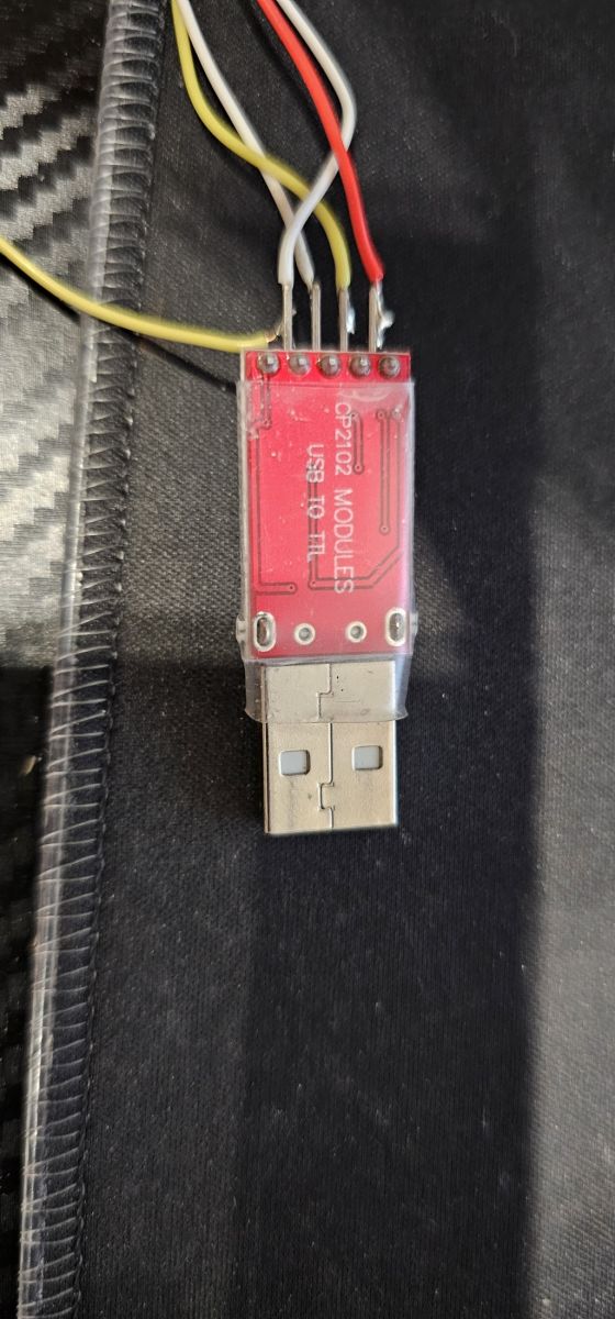

    There is no option that it does not work. To try you have:
    1. power it normally, more than once there was a situation on the forum, that it turned out that 3.3V from USB to UART does not work
    2. shorten the wires (the shorter the better, there were also situations that this helped)
    3. swap RX with TX
    Additionally you may want to do as here:
    https://www.elektroda.pl/rtvforum/topic3990951.html

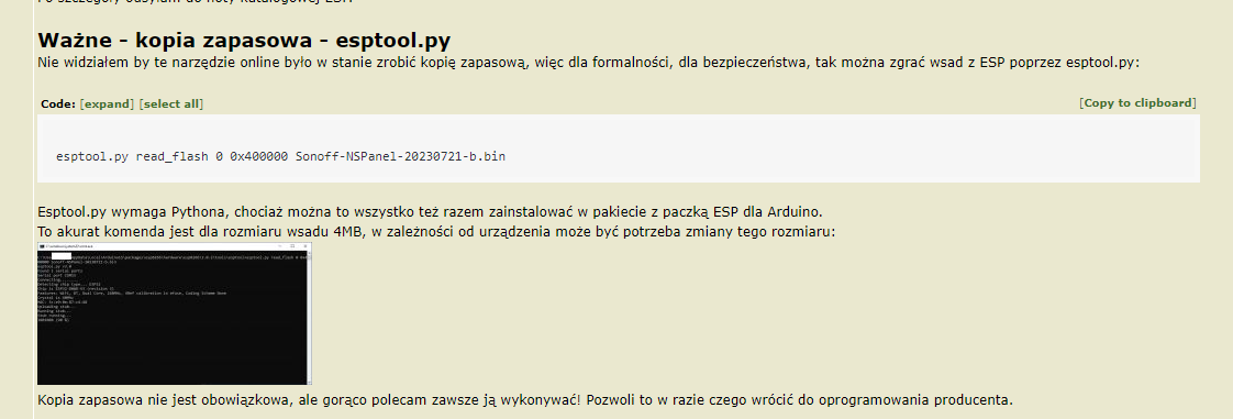

    that is, use esptool.py , at least to make a copy:
    Fragment of a guide on using esptool.py for backing up ESP software.
    if you use esptool.py then we will at least see in the console what goes wrong, whether the COM port is seen, etc
    Added after 53 [seconds]:

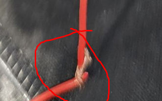

    PS: this also looks bad:
    Damaged red wire with visible break I would check with a multimeter if this is not a broken wire.

    Indeed, in that topic I downloaded esptool.py together with the package for Arduino. This is because I thought it would be simpler for beginners. Instead, you can install esptool via pip:
    pip install esptool
    be
    pip3 install esptool
    Then you can verify its presence via:
    esptool.py --version
    https://pypi.org/project/esptool/

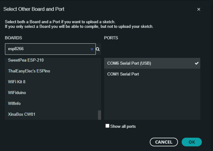

    For this reason my suggestion initially was to install together with the Arduino IDE.
    What about the error you gave, I don't associate it, can you specify when it appears and how what you install? Is there a Python already in place?
  • Esptool installation options for Arduino ESP uploads
    #14 20993419
    Posts: 14701
    Help: 656
    Rate: 12748
    This is installed together with the ESP package for Arduino, I gave the path in the linked topic. Without esptool, the Arduino would have no way to upload the batch to the ESP.
    If you don't like either the method with the Python package manager, or with the Arduino, then you can directly from their Github download the zip and extract:
    https://github.com/espressif/esptool
    Documentation:
    https://docs.espressif.com/projects/esptool/en/latest/esp8266/index.html
    By the way, here is also their how to install:
    https://docs.espressif.com/projects/esptool/en/latest/esp8266/installation.html#installation

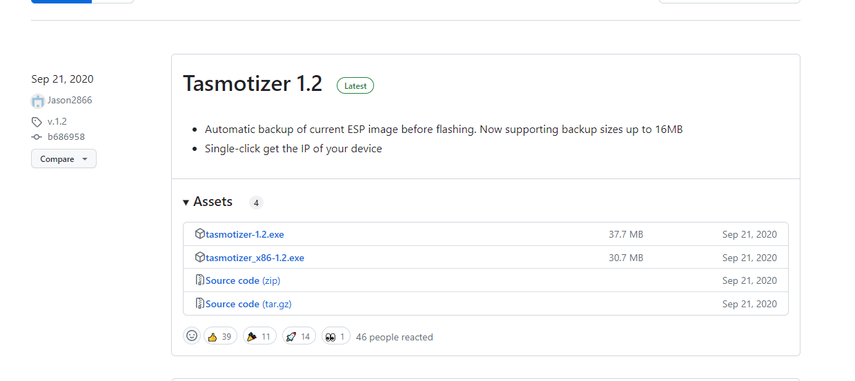

    And if you don't want esptool then there is also Tasmotizer:
    Screenshot of the GitHub release page for Tasmotizer 1.2, showing download options for executable files and source code.
    https://github.com/tasmota/tasmotizer/releases

    I don't think the chip is to blame. More likely you are doing something wrong. Maybe the USB to UART converter is not catching something, or you need to set a lower baud, etc. I have already flashing literally hundreds of devices and there were no such problems.
    To be sure, I would possibly:
    - or remove the chip. I would recommend:
    - either take the hot air off the screen from this module and check if it's ESP
    - or just turn on Realterm, select the baud, I don't remember what it was, 115 200 maybe and with IO0 disconnected from ground (i.e. in normal mode, not programming) collect the log from TX1 to see how this chip reports, then we'll know if it's ESP
    I'm afraid ESP-02S will not fit in place of this module, CUCO_Z0_V1.1 even has power and ground in other places, and on top of that I think the problem is with the flashing so ESP-02S you would not program either....
