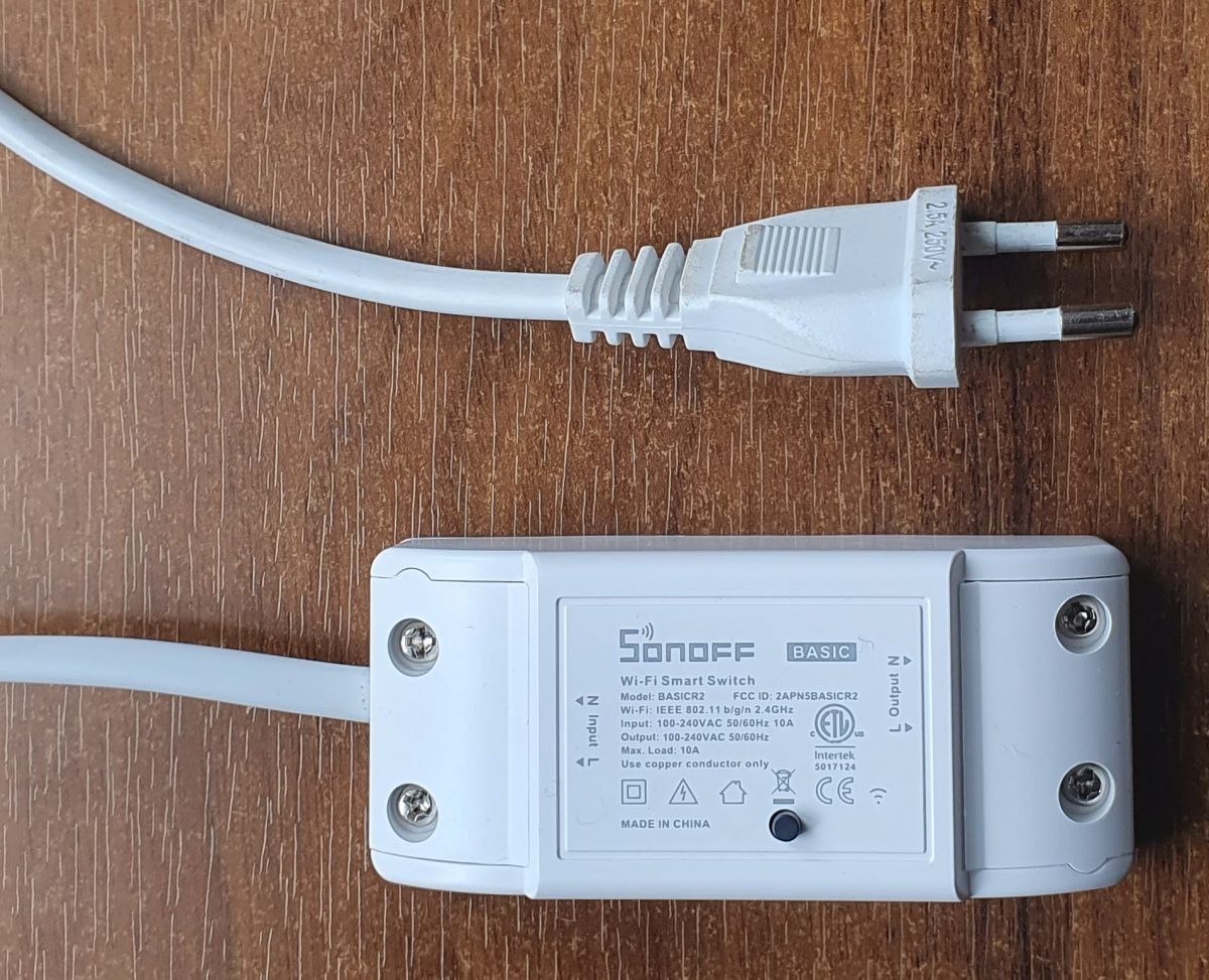

  • Sonoff Basic – Wi-Fi Smart Switch with attached power cord
    Recently it appeared in the DIY section "Supervisor Detector" by @szdom. The topic aroused great interest, including mine. However, I decided to approach the problem differently - ESP was to collect data and periodically send it to the server. The main task is to detect the presence of someone`s cell phone nearby. This is possible thanks to the RSSI information. Generally, weak RSSI (small RSSI value) means greater distance between the transmitter and receiver. It may also result from an unusual pattern of occlusions and reflections. Therefore, this is a poor indicator. A high RSSI value indicates the proximity of the transmitter and receiver. This is rather a certain fact - I ignore directional antennas, etc.
    I searched the Internet for code - how to acquire data and send it. I was thinking about constantly switching between listening and sending mode. The solution turned out to be much simpler - it is the WIFI_AP_STA mode, i.e. dual mode in which ESP works as both AP and STA.

    Hardware
    The hardware is so trivial that I did not dare to present this article as a DIY :) . For some time now I have been using SONOFFs as a base for projects based on ESP8266. Sonoff provides me with ESP, power and housing. The only thing left for me to do was add a power cable. In the presented system, the relay is not used.
