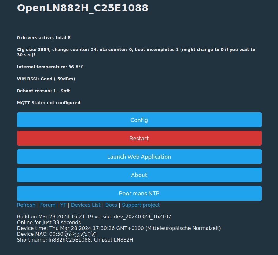

    I am thinking about adding watchdog and reboot reasons to OpenLN882H. It seems that the related header is reboot_trace.h.
    Code: C / C++
    For now, I am focusing only on reboot reason. Can anyone check out the new fork and tell me whether the device display reboot reason correctly and can tell between "power on" (via powering on) and "restart" reboot?
    @divadiow @max4elektroda
    PR link: https://github.com/openshwprojects/OpenBK7231T_App/pull/1154
    Next I will setup a watchdog ,so LN882H devices will reboot automatically in case of a problem.

    reboot status if using restart button
    Screenshot of a user interface with a Restart button and diagnostic information.

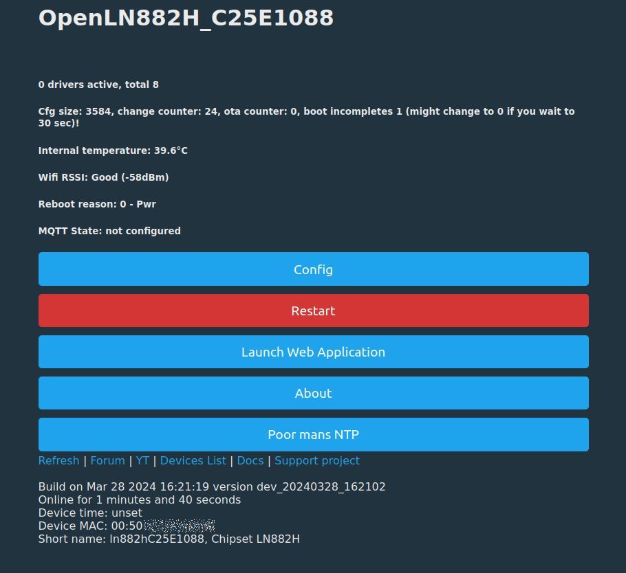

    and if killing the power abruptly
    Screenshot of a device control panel with Restart button and other configuration options.

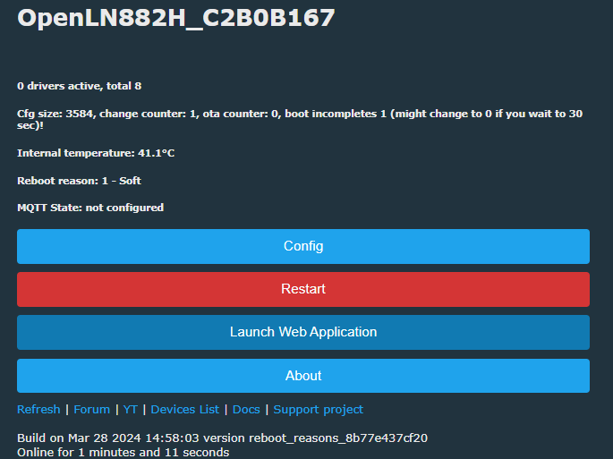

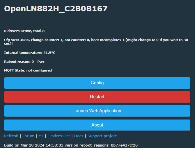

    Too late, since it's already included, but I can confirm it working here, too:
    OpenLN882H user interface showing system information and configuration options.
    Control panel of the OpenLN882H_C25E1088 device with network status information and configuration buttons.
