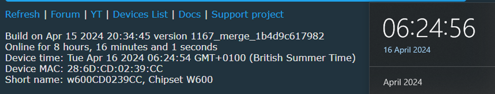

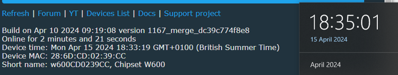

    fresh flash. nothing set. will set to powersave 0 to be sure. is powersave on by default on W600?
    Added after 5 [minutes]:
    no matter. powersave 0
    Screenshot displaying device information with the W600 chipset.

    @divadiow thanks for your "long term" tests and especially the new input on W600!
    divadiow wrote:
    I have a W600 now. Sadly, it's not happy very quickly
    Seems this platform is using another tick rate like Beken platforms.
    Hopefully I finally got it right now (factor "portTICK_RATE_MS" should be present on all platforms, equals to 2 on Beken and W600/W800 and 1 for LN882H and BL602).
    Now the code is:
    TickType_t actTick=portTICK_RATE_MS*xTaskGetTickCount();
    so I think I'm counting ms now on all platforms.

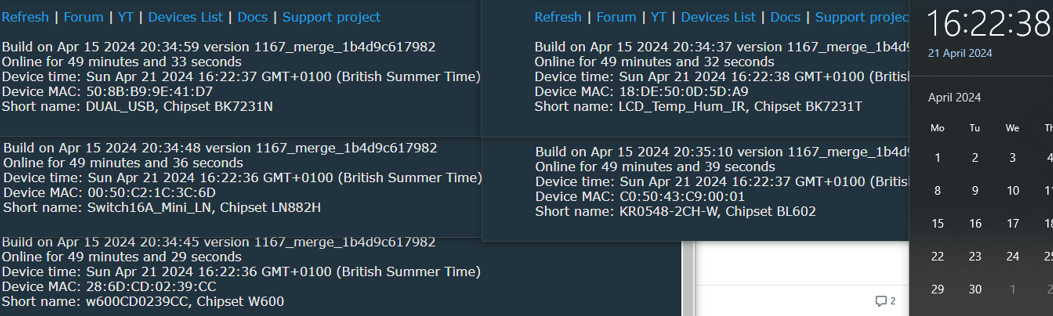

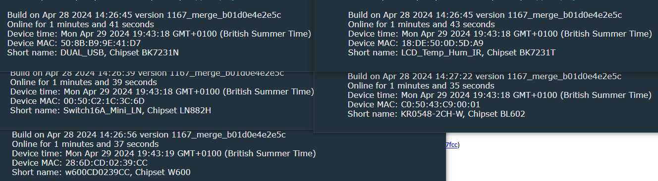

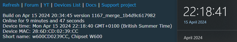

    #34 21046878
    Posts: 5220
    Help: 449
    Rate: 918
    Screenshot of a system interface displaying device information.
    Added after 8 [hours] 6 [minutes]:
    Screenshot with device information, showing date, time, and software version details.
    Added after 7 [hours] 45 [minutes]:
    @max4elektroda do all platforms need flashing again for a fresh round using latest changes?

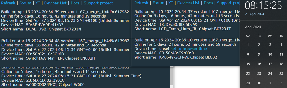

    Posts: 5220
    Help: 449
    Rate: 918
    Screenshot of a device management panel with information about time, software versions, and device MAC addresses.
  • #38 21055037

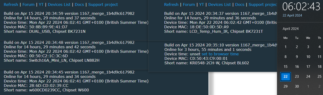

    Posts: 5220
    Help: 449
    Rate: 918
    damn. watchdog kicked the BL602
    Screenshot of a device monitoring interface showing details about various devices, including online duration, MAC address, and chipset type.
  • #39 21061947
    Posts: 5220
    Help: 449
    Rate: 918
    BL602 died again. the rest seem like a success though? LN jumped ahead slightly? Maybe not enough to care about.
    Screenshot showing information about various devices and a system clock.
  • Clock precision confirmed for daily scheduling
    #40 21062117
    max4elektroda
    Posts: 758
    Help: 49
    Rate: 189
    Thank you so much for your tests @divadiow, the clocks are all in the expected range of precision.
    That should work for all cases of calculating "daily values" and even work for most of the switching purposes, when it doesn't matter if the clock differs one minute after a month.
    Maybe in the future we can even add kind of a correction factor to add/subtract a second every xxx seconds ...
    From my side, these tests are successful and don't need to be continued.
    What's currently untested is the case of "overflow" of the tick counter, but it will happen only every 50 days...
    So thanks again for your support, it helped a lot!

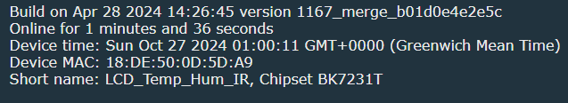

    BK7231T clock follows daylight saving change
    #44 21064882
    Posts: 5220
    Help: 449
    Rate: 918
    well, they all flash and set timer from browser OK as before
    Screenshot with information about multiple devices, their online status, and system time.
    I also set PC time to next daylight savings change and saw it go back an hour and switch to GMT from BST. Only watched it on BK7231T though. Do you want all? Is that part of the test required?
    Screenshot showing software version and device time information.

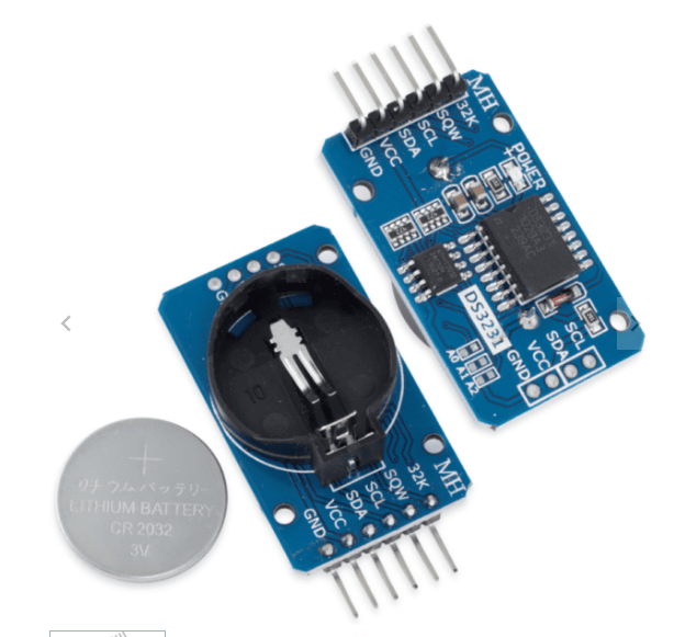

  • DS3231 RTC boards suggested for offline timing
    #54 21633540
    omniron
    Posts: 114
    Thank you @max4elektroda
    I use the ones you pictured and the smaller one from my mod.
    The smaller fits barely in existing smart units, but meanwhile there are even smaller RTC boards with the DS3231.
    Would be great to have an RTC working since some of smart things are in a remote location with no internet.
    Except when I'm there and I make a hotspot
    Power outages are fequent, messing up the timing etc.
    Hope you can get it going and maybe @p.kaczmarek2 can help with OBK integration?
    Thanks!!

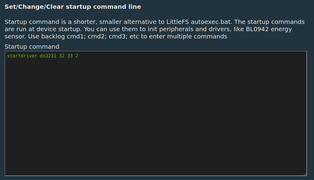

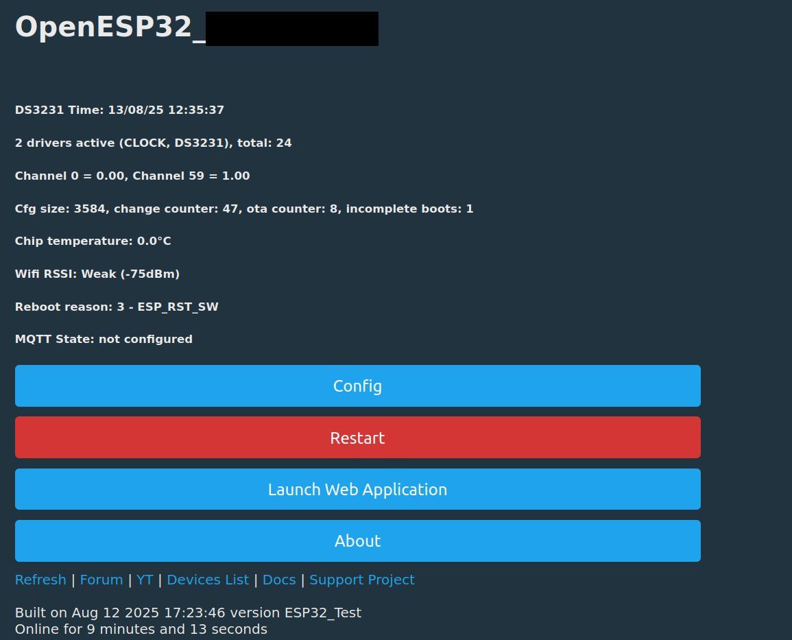

    If you like, you can test my first try here:
    https://github.com/MaxineMuster/OpenBK7231T_App/actions/runs/16915983611
    For now it will only display the time on main screen:
    OpenESP32 interface screen showing DS3231 time and system status
    startdriver DS3231 <CLK-Pin> <DATA-Pin>
       e.g. startdriver DS3231 32 33

    sync values: 0: do nothing 1: set devicetime to RTC on startup 2: set devicetime to RTC regulary (making RTC clock source)
    to set RTC you can e.g. use on a Linux device
    wget "http://<ip.of.your.plug>/cmd_tool?cmd=DS3231_SetEpoch $(date +%s)"

    Startup command run for driver ds3231 with parameters 32 33 2

  • DS3231 RTC support for offline Tasmota clocks
    #60 21634884
    omniron
    Posts: 114
    max4elektroda wrote:
    Ah, I forgot you mentioned tasmota, so I expect some ESP32 variant or ESP8266?
    I used the RTC in a ESP8266 Tasmota plug
    https://templates.blakadder.com/kmc_4.html
    Best quality plugs I ever got, Tasmota and power monitoring and work to this day.
    Unfortunately later KMC 4s came with tuya chips and were really cheaply built, bad capacitors and bad design in general like most tuya stuff.
    I don't have that particular RTC unit in reach, but can mod another unit for testing.
    Trying to locate it's schematic to see which pins I used for SDA and SCL.
    GPS boards are much larger and won't fit in most existing smart units.
    So excited for your integration of RTC module into Tasmota or tuya.
    Here is a newer RTC implementaion for Tasmota, never used it, had an older trial from years ago.
    https://tasmota.github.io/docs/DS3231/#tasmota-settings_1
    That plus the option to query the RTC unit by other smart devices as a replacement for NTP will make it possible to be truly disconnected from the internet.
    Thanks again!
