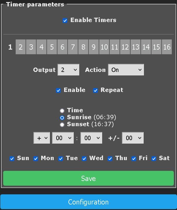

    Settings panel with options to enable timers and choose sunrise or sunset, along with save options.
