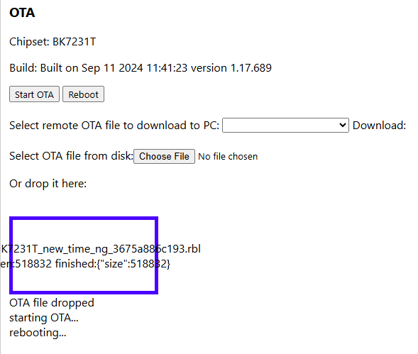

    Offline timekeeping branch with browser clock sync
    #7 21302513
    max4elektroda
    Posts: 758
    Help: 49
    Rate: 189
    If you have some spare device and/or spare time feel free to play with the version here:
    https://github.com/MaxineMuster/OpenBK7231T_App/tree/new_time_ng
    You need to have a git account, then you can download the "artifacts" file at the end of the page which contains all firmwares for this branch:
    https://github.com/MaxineMuster/OpenBK7231T_App/actions/runs/11825574490
    The basic idea was to enable time keeping without network connection (without NTP), so this is the focus of the branch.
    This made it necessary to move a lot of functions to a "neutral" code, for most time related functions were flagged as "ntp_XY" for this was the only time source....
    You can e.g. set the clock simply to the browsers clock by clicking a link in the GUI.
    Timezone settings are done with a new (and kind of complex) command clock_setConfig (at least I tried to explain it in the source code, I can also give the needed code for a region).

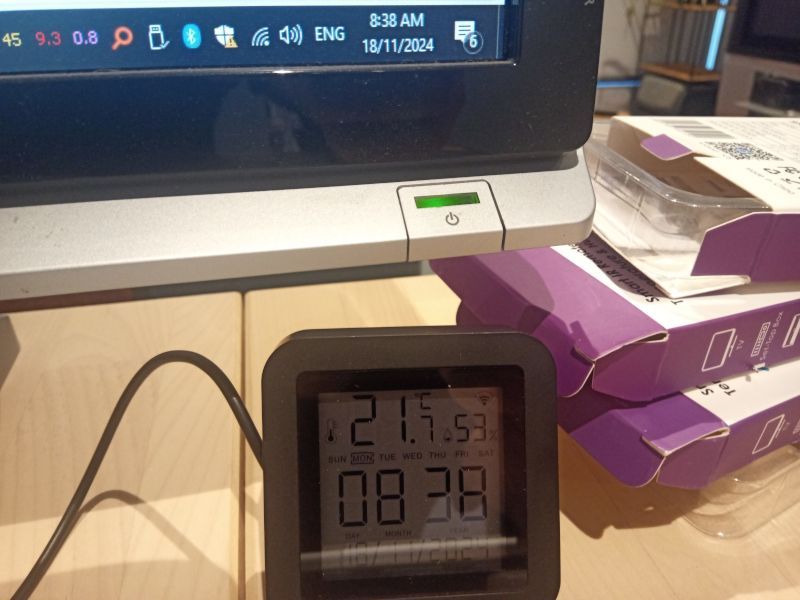

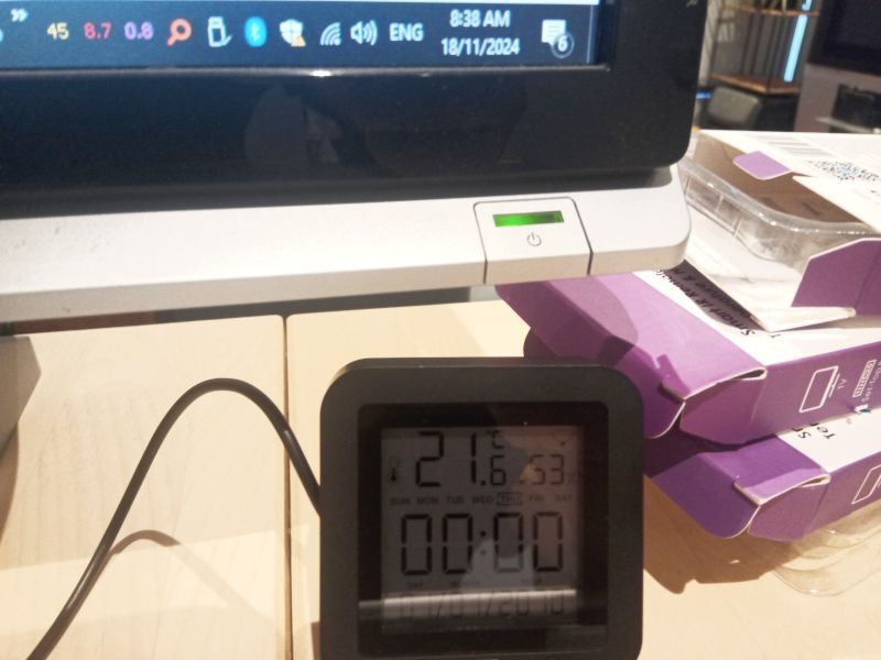

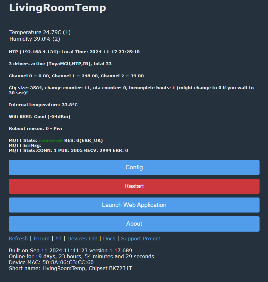

  • Need autoexec.bat setup for TuyaMCU and NTP

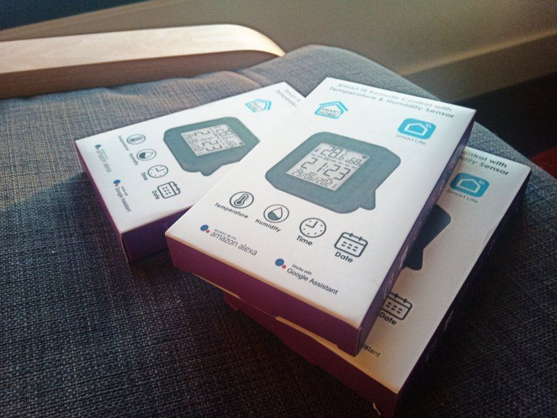

    #8 21302691
    randomalias324
    Posts: 46
    >>21302513
    Yep, I bought a few as a gift for my dad, so I do have spares
    Boxes of smart temperature and humidity sensors lying on a couch.
    I got the artefacts/binaries.
    You might need to help me with what to put in my autoexec.bat etc to get it going
    Currently it's this: Pretty basic.
    startDriver TuyaMCU
    startDriver NTP
    ntp_setServer 192.168.4.45
    ntp_timeZoneOfs 10:00
    setChannelType 1 temperature_div10
    linkTuyaMCUOutputToChannel 101 val 1
    setChannelType 2 Humidity
    linkTuyaMCUOutputToChannel 102 val 2
    Tasmota timezone table and HTTP time test setup

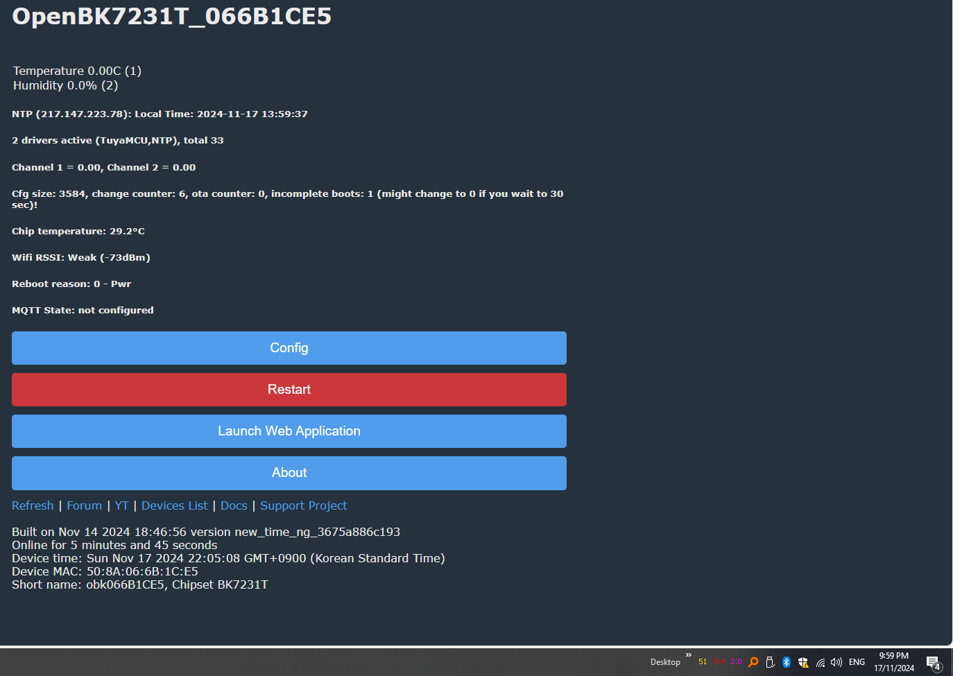

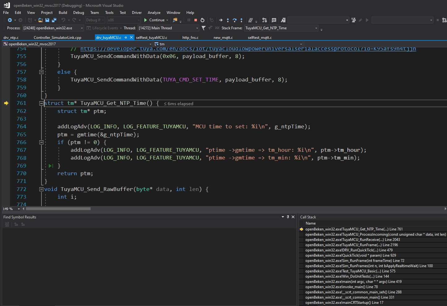

    #9 21302925
    max4elektroda
    Posts: 758
    Help: 49
    Rate: 189
    O.k.. let's start, but I'm afraid it will not directly be shown on the display, I'll need to do some adjustments (if I got it right, tuya clock is "set" by ntp time, which actually is not set by my DST code.)
    But this can be changed ...

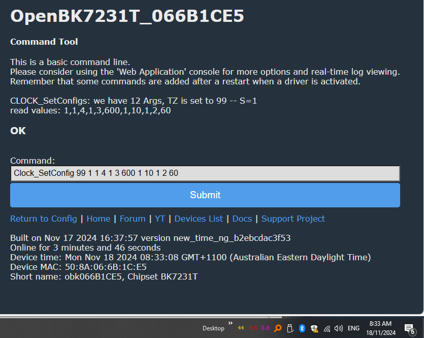

    To set timezone, you could use the tasmota table for that and adjust the values to match "my" command:
    https://tasmota.github.io/docs/Timezone-Table/
    You will find e.g. for "ATC" (I just picked one entry with +10 h)
    Australia/ACT    Backlog0 Timezone 99; TimeStd 1,1,4,1,3,600; TimeDst 1,1,10,1,2,660
    We use an all in one setting command:
    Clock_SetConfig TZ,H,We,Me,De,he,Tstd,Ws,Ms,Ds,hs,Tdst
    TZ:   Timezone (+/-HH or +/-HH:MM or 99 for DST)
    To "match" the two Tasmota commands to our
    TimeStd H,W,M,D,h,T --> He=H; We=W; Me=M; De=D; he=h; Tstd=T
    TimeDST H,W,M,D,h,T --> Hs=H; Ws=W; Ms=M; Ds=D; hs=h; Tdst=T-Tstd
    If I did the transfer correct, this would be the setting:
    Clock_SetConfig 99,1,1,4,1,3,600,1,10,1,2,60
    Meaning:
    99:      Use DST
    1:      Southern Hemisphere
    1,4,1,3:   DST ends / standard/winter time starts at first Aprils sunday at 3 (local summer time)
          (yes, sounds a bit strange, but the words should match the numbers ;-))
    600:      during "standard" time you are 600 Minutes = 10 hours ahead of UTC
    1,10,1,2:   DST starts at first Octobers sunday at 2 local time
    60:      DST is 60 minutes ahead of standard time
    That looks o.k. for me
    The settings of "Clock_SetConfig ..." are kept in flash, so you only need to set them once, unless you need a change.
    Actually DST is not used with NTP (to keep NTP exactly working as before).
    To test the Clock without NTP you can "fake" any time you whant by setting the time with an HTTP-Request:

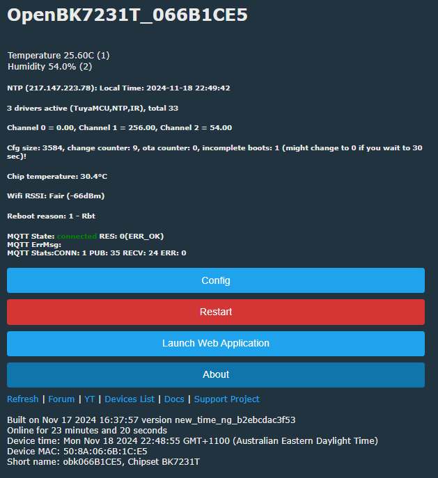

    http://<your IP>/pmntp?EPOCH=<UTC epoch>&OFFSET=<local clock offset seconds (including DST-offset during DST time)>
    Since usually this is done with javascript, the OFFSET will always be the "complete" offset versus UTC.
    In the log (and the time displayed in GUI) you should see DST working if you set the time shortly before a DST change.

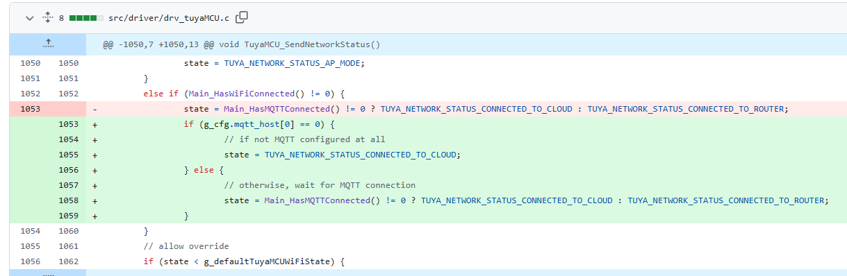

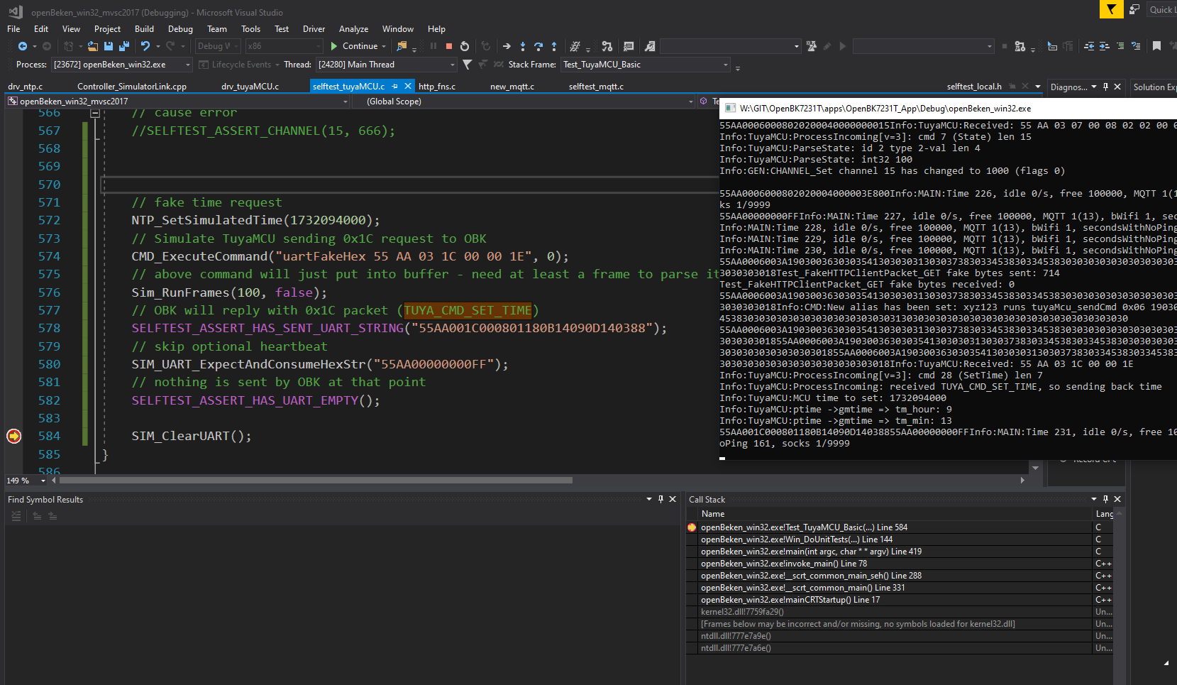

    I'll take a look into the tuya and NTP code to see, how I can set NTP offset following DST settings.
    Added after 1 [hours] 57 [minutes]:
    You may try this new firmwares, they should set NTP offset, too when DST changes:
    https://github.com/MaxineMuster/OpenBK7231T_App/actions/runs/11838463085
    Caution, this is not foolproof. E.g. when DST is set, it will ignore whatever you set for "ntp_timeZoneOfs" but only use the "Clock_SetConfig" values.
    I didn't test it yet, but it looks like it's working (since it breaks the windows simulation by changing the time to DST ;-)):
    2024-11-14T13:22:35.3741400Z Info:NTP:NTP driver initialized with server=217.147.223.78, offset=0
    2024-11-14T13:22:35.3741827Z
    2024-11-14T13:22:35.3741932Z Info:MAIN:Started NTP.
    [...snipp...]
    2024-11-14T13:22:35.3745214Z Info:MAIN: Date: 2022-06-10T09:27:35, idle 0/s, free 100000, MQTT 0(57), bWifi 1, secondsWithNoPing 596, socks 1/9999
    2024-11-14T13:22:35.3745866Z
    2024-11-14T13:22:35.3746199Z Info: epoch 1654853255 in year 2022 -- b=1648342800 -- e=1667091600
    2024-11-14T13:22:35.3746596Z
    2024-11-14T13:22:35.3746600Z
    2024-11-14T13:22:35.3746604Z
    2024-11-14T13:22:35.3746608Z
    2024-11-14T13:22:35.3746948Z In DST of 2022. Next switch at 1667091600 (Sun, 2022-10-30 01:00:00 UTC)
    2024-11-14T13:22:35.3747367Z
    2024-11-14T13:22:35.3747847Z Info:MAIN:DST switch from normal time to DST at epoch 1654853255 -- next switch at 1667091600!!
    2024-11-14T13:22:35.3748420Z
    2024-11-14T13:22:35.3748590Z Info:GEN:CHANNEL_Add channel 1 has changed to 54
    2024-11-14T13:22:35.3749124Z
    2024-11-14T13:22:35.3749130Z
    2024-11-14T13:22:35.3749341Z Info:GEN:CHANNEL_Set channel 1 has changed to 54 (flags 0)
    2024-11-14T13:22:35.3749707Z
    2024-11-14T13:22:35.3749711Z
    2024-11-14T13:22:35.3749881Z Info:GEN:CHANNEL_Add channel 3 has changed to 312
    2024-11-14T13:22:35.3750202Z
    2024-11-14T13:22:35.3750206Z
    2024-11-14T13:22:35.3750416Z Info:GEN:CHANNEL_Set channel 3 has changed to 312 (flags 0)

    Added after 5 [hours] 8 [minutes]:
    Did some tests and adjustments. latest version is here:
    https://github.com/MaxineMuster/OpenBK7231T_App/actions/runs/11843479155
    I tested with a python "fakeNTP" from here:
    https://github.com/CuckooEXE/FakeNTP
    So here is the DST change in 2029 in EU (using "sudo python3 FakeNTP.py --static-time --time 1869094795"):
    Info:NTP:Seconds since Jan 1 1900 = 4078083595
    Info:NTP:Unix time  : 1869101995
    Info:NTP:Local Time : 2029-03-25 02:59:55
    Info:MAIN: Date: 2029-03-25T02:59:55, idle 0/s, free 35272, MQTT 0(17), bWifi 1, secondsWithNoPing 1, socks 0/0
    Info: epoch 1869094795 in year 2029 -- b=1869094800 -- e=1887843600
    Before first DST switch in 2029. Next switch at 1869094800 (Sun, 2029-03-25 01:00:00 UTC)
    Info:MAIN:DST switch back from DST at epoch 1869094795 -- next switch at 1869094800!!
    Info:MAIN: Date: 2029-03-25T01:59:56, idle 0/s, free 34036, MQTT 0(17), bWifi 1, secondsWithNoPing 1, socks 0/0
    Info:MAIN: Date: 2029-03-25T01:59:57, idle 0/s, free 34204, MQTT 0(17), bWifi 1, secondsWithNoPing 1, socks 0/0
    Info:MAIN: Date: 2029-03-25T01:59:58, idle 0/s, free 36480, MQTT 0(18), bWifi 1, secondsWithNoPing 1, socks 0/0
    Info:MAIN: Date: 2029-03-25T01:59:59, idle 0/s, free 34368, MQTT 0(18), bWifi 1, secondsWithNoPing 1, socks 0/0
    Info:MAIN: Date: 2029-03-25T02:00:00, idle 0/s, free 36800, MQTT 0(18), bWifi 1, secondsWithNoPing 1, socks 0/0
    Info:MAIN: Date: 2029-03-25T02:00:01, idle 0/s, free 33288, MQTT 0(18), bWifi 1, secondsWithNoPing 1, socks 0/0
    Info: epoch 1869094801 in year 2029 -- b=1869094800 -- e=1887843600
    In DST of 2029. Next switch at 1887843600 (Sun, 2029-10-28 01:00:00 UTC)
    Info:MAIN:DST switch from normal time to DST at epoch 1869094801 -- next switch at 1887843600!!
    Info:MAIN: Date: 2029-03-25T03:00:02, idle 0/s, free 37036, MQTT 0(18), bWifi 1, secondsWithNoPing 1, socks 0/0
    Info:MAIN: Date: 2029-03-25T03:00:03, idle 0/s, free 38060, MQTT 0(18), bWifi 1, secondsWithNoPing 1, socks 0/0
    Info:MAIN: Date: 2029-03-25T03:00:04, idle 0/s, free 36260, MQTT 0(18), bWifi 1, secondsWithNoPing 1, socks 0/0
    And the switch back ("sudo python3 FakeNTP.py --static-time --time 1887843595"):
    Info:NTP:Seconds since Jan 1 1900 = 4096832395
    Info:NTP:Unix time  : 1887850795
    Info:NTP:Local Time : 2029-10-28 02:59:55
    Info:MAIN: Date: 2029-10-28T02:59:55, idle 0/s, free 35096, MQTT 0(38), bWifi 1, secondsWithNoPing 1, socks 0/0
    Info: epoch 1887843595 in year 2029 -- b=1869094800 -- e=1887843600
    Info:MAIN:DST switch from normal time to DST at epoch 1887843595 -- next switch at 1887843600!!
    Info:MAIN: Date: 2029-10-28T02:59:56, idle 0/s, free 35304, MQTT 0(38), bWifi 1, secondsWithNoPing 1, socks 0/0
    Info:MAIN: Date: 2029-10-28T02:59:57, idle 0/s, free 35096, MQTT 0(38), bWifi 1, secondsWithNoPing 1, socks 0/0
    Info:MAIN: Date: 2029-10-28T02:59:58, idle 0/s, free 35096, MQTT 0(38), bWifi 1, secondsWithNoPing 1, socks 0/0
    Info:MAIN: Date: 2029-10-28T02:59:59, idle 0/s, free 35132, MQTT 0(38), bWifi 1, secondsWithNoPing 1, socks 0/0
    Info:MAIN: Date: 2029-10-28T03:00:00, idle 0/s, free 35132, MQTT 0(38), bWifi 1, secondsWithNoPing 1, socks 0/0
    Info:MAIN: Date: 2029-10-28T03:00:01, idle 0/s, free 34652, MQTT 0(38), bWifi 1, secondsWithNoPing 1, socks 0/0
    Info: epoch 1887843601 in year 2029 -- b=1869094800 -- e=1887843600
    After DST in 2029. Next switch at 1901149200 (Sun, 2030-03-31 01:00:00 UTC - thats next year)
    Info:MAIN:DST switch back from DST at epoch 1887843601 -- next switch at 1901149200!!
    Info:MAIN: Date: 2029-10-28T02:00:02, idle 0/s, free 35132, MQTT 0(38), bWifi 1, secondsWithNoPing 1, socks 0/0
    Info:MAIN: Date: 2029-10-28T02:00:03, idle 0/s, free 34924, MQTT 0(38), bWifi 1, secondsWithNoPing 1, socks 0/0
    Info:MAIN: Date: 2029-10-28T02:00:04, idle 0/s, free 34960, MQTT 0(38), bWifi 1, secondsWithNoPing 1, socks 0/0
    [Edit on 20241116: corrected wrong (swapped) description of summer/winter time in code block for Australia]

  • Browser time not passed to TuyaMCU LCD display
    #16 21306671
    randomalias324
    Posts: 46
    >>21302925
    Hey mate I couldn't get your build to work properly.
    Got it flashed (like this)
    Screenshot of an OTA (Over-The-Air) interface showing information about the BK7231T chipset and file details.
    This is what one of my existing sensors looks like
    Screenshot of a user interface showing information on temperature, humidity, and device status.
    This is what the one with the new firmware is doing.
    I note that on the bottom of the page, near the build version, there is an extra field called device time.
    When no time has been set, there is a hyperlink to set it to browser time.
    User interface for the OpenBK7231T device displaying temperature, humidity, and network status information.
    Note that I have set my PC to Korean time (randomly selected) to test whether the page was getting the time from the device (in which case it would have needed to know the timezone string, which I doubted it did) or from the browser. It seems to get it from the browser.
    Note that the time is a couple of minutes fast compared to the NTP supplied time and the local PC time.
    Having the Clock_SetConfig in autoexec does not seem to alter the time displayed on the page.
    With NTP turned off in autoexec I can set the time displayed on the page using the browser command /pmntp?EPOCH=1731205706&OFFSET=0 (as an example)
    In neither case is the time correct on the LCD screen of the physical device. So the time is not getting passed through TuyaMCU. It just shows UTC time.
    Also the device appears to crash regularly.

  • LCD resets every minute after NTP time updates
    #18 21307605
    randomalias324
    Posts: 46
    Alright. Looks like it works!
    Flashed .rbl OTA
    Set the following autoexec.bat
    startDriver TuyaMCU
    startDriver NTP
    //ntp_setServer 192.168.4.45
    //ntp_timeZoneOfs 10:00
    Ran the command as a 'Custom Command'
    OpenBK7231T tool screen displaying control commands for a device.
    And we've got time displayed
    Monitor display with system information and a timer next to it.
    Still have LCD issues. Now, it doesn't seem to actually crash, can still load the landing page. But, the LCD looks like it resets. Including the wifi level indicator.
    This happens every minute to every few minutes
    Computer screen with visible clock and LCD display showing temperature.
    Could it be setting the clock often? Is it sending junk via TuyaMCU that upsets the LCD driver?

    #23 21308069
    randomalias324
    Posts: 46
    Hmm, this is strange. I just set up the WiFi connection on one with release firmware to capture a baseline log and I'm getting the same behavior with it... v1.17.689, same as all the others in my house that operate with no issue
    I can see MQTT is changing channels before some of the crashes, and I haven't enabled MQTT...
    I might try setting the one with the modified firmware with a connection to the MQTT broker and see if that alters the behavior
    Also grabbed a log from one of my working sensors which has 20 days up time
    • WorkingUnit_20daysUpTime.txt (31.09 KB) You must be logged in to download this attachment.
    • ReleaseSnap.txt (26.46 KB) You must be logged in to download this attachment.
  • MQTT connection required for new build to work
    #24 21308108
    randomalias324
    Posts: 46
    Well there you bloody go. When connected to the MQTT broker, the new build works fine.
    Before that I also added in the IR pins to spin up the IR driver, but that did not appear to do much.
    OpenBK7231T software interface showing network and system status information.
    Attached is a log for good measure
    So I think I'll flash this to the ones I'm giving to my father, that way we can reconfigure everything through the native webpage and avoid the javascript app (which, unless I'm wrong, needs connectivity to the internet and the IoT wifi, if they're separate)
    For mine, I might now play around with miegapele's script which will let me avoid flashing them. And it will test another approach that some others might like to use.
    Great firmware max4elektroda, it's an excellent feature to support clock-like devices.
    I wonder if the MQTT thing is a bug in release? Surely being off MQTT shouldn't cause resets
    • Working_WithNewFirmware.txt (27.93 KB) You must be logged in to download this attachment.

    #27 21310759
    Posts: 14755
    Rate: 12881
    I've seen this thread a bit late, but can you check what is the cause of the reboot, more specifically, is it really a crash in the WiFi module firmware, or maybe it's just that WiFi module CEN pin is connected to the MCU (TuyaMCU) and TuyaMCU forces WiFi module reboot when there is no WiFi state 0x04?
    Can you check if the "crash" occurs if you do:
    tuyaMcu_defWiFiState 4
    in autoexec.bat? tuyaMcu_defWiFiState 4 means that OBK sends to TuyaMCU wifi state "connected to cloud", it's only send either if forced with command or if there is MQTT connected...
    So, I suspect, that there may be no "crash", it's just the MCU resetting WiFI module... but I will investigate.
    Added after 27 [minutes]:
    EDIT: There is nothing related to MQTT in the send time function:
    View of Visual Studio debugging window with program code for TuyaMCU.
    For now, I need one thing to progress. Please check if it also crashes if you add mentioned "default wifi state" setting to autoexec.bat.
    Added after 49 [minutes]:
    I've also added a self test so you can debug it yourself on Windows:
    Screenshot of software debugging in Visual Studio 2017 development environment.
  • tuyaMcu_defWiFiState 4 stops LCD dropout resets

    #29 21312619
    Posts: 14755
    Rate: 12881
    Thank you for testing and your activity (I mean, all users in this topic), I really appreciate it.
    randomalias324 wrote:
    I wonder if it is a good idea to send the 'connected to cloud' signal regardless of MQTT when MQTT is not configured
    Well, now it brings another issue - there are TuyaMCU door sensors (or water sensors, or humidity sensors) that are using this MQTT mechanism to know when they can report state to HA and then go back to sleep ...
    But from what I can see, you want to specifically add an exception to when MQTT is not configured, not just "not connected"?

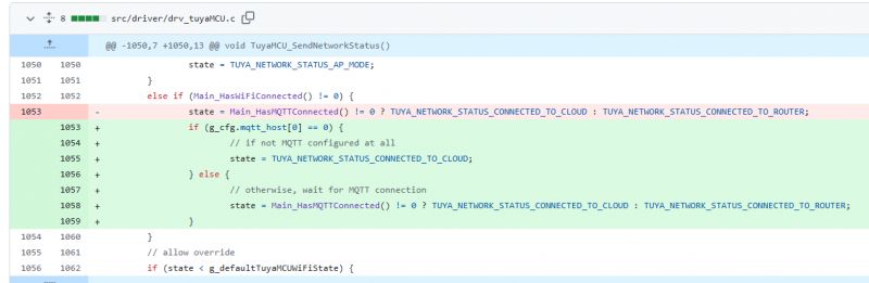

    Very well, I can agree to that. Here's the first draft:
    Screenshot of a code snippet with added lines regarding MQTT configuration.
    https://github.com/openshwprojects/OpenBK7231T_App/pull/1434/files
    Can you check it that's what works for you? Shall I merge it?
    Futhermore, I also need opinion on that:
    https://github.com/openshwprojects/OpenBK7231T_App/pull/1429
    maybe also from @divadiow, is it ready to merge?
  • MQTT sleep behavior before configuration discussed
