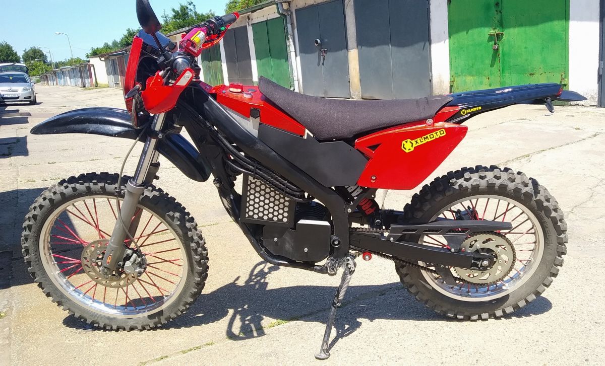

  • Handmade lightweight e-cross built completely from scratch with a MIDDRIVE motor and geometry similar to a Sur-Ron.
  • The frame was drawn in Corel and milled from 7075 aerospace aluminium on a CNC router, with a 10mm body and 20mm swingarm.
  • A Fardriver ND72360 controller is used, rated at 190A/360A and 13kW max, currently set to 120A/240A.
  • The drivetrain uses a QS165 motor with 47Nm, a Sur-Ron gear, and a 58T rear sprocket.
  • Lightweight CNC e-cross QS165, ND72360.
    Welcome, I present my construction made completely from scratch. It is an electric cross with MIDDRIVE motor. The geometry is similar to the surron. Frame drawn in Corel and milled from 7075 aerospace aluminium on CNC router (10mm body, 20mm swingarm).
    Fardriver ND72360 controller (190A/360A-13kWmax) currently set to 120A/240A
    Motor QS165 47Nm + gear from surron + rear sprocket 58T.

    Why is it not possible to enlarge the photos?
    What diameter is the control arm axle because it looks very delicate in the pictures?

    @E8600 corrected. Control arm axle 10mm. Standard dimension on this type of factory motorbike. (Surron, talaria, e-ride etc).

    hetm4n wrote:
    second battery under construction on NMC LG Chem E61v 60Ah cells.
    Will power be increased on new battery? The motor will withstand the max of this controller?

    @E8600 this instantaneous motor will take 18kW, it is protected by a temperature sensor. With 8kW in the field the maximum temperature it has reached is 60°C. The second battery is being set up for quiet longer trips in the larger woodland and mountain trails in the Silesian Beskid. I have no intention of drawing more than 120A. For me, this power is sufficient.

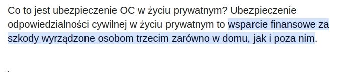

    szymon122 wrote:
    I have an e-bike with a power output of about 2200W and taking out insurance on my bike then in the event of an accident the first thing the insurer will do is verify that my vehicle is a bike.
    By law it is not. I was not referring to motor insurance.

    Great and congratulations, you're the guy! My only concern would be the sharp edges, especially at the top.... Is it not possible to soften it somehow? Maybe an overlay?

    The edges are gently chamfered, no harm done. It is possible to combine them with some protective casings etc, but I like them as they are. In general, the idea was to make them very round during machining, but my amateur CNC milling skills and lack of knowledge of cad programs, I opted for simplicity and ease of execution.

    What diameter are the wheels? What is the total weight ?

    @ziboalle 19" wheels 70/100-19R tyres , weight 65kg
