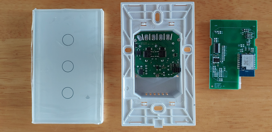

    Disassembled AUBEES 3-gang smart switch with visible CB3S chip.
    I purchased from eBay thinking it had an ESP chip, but flashing openbeken was fairly easy.

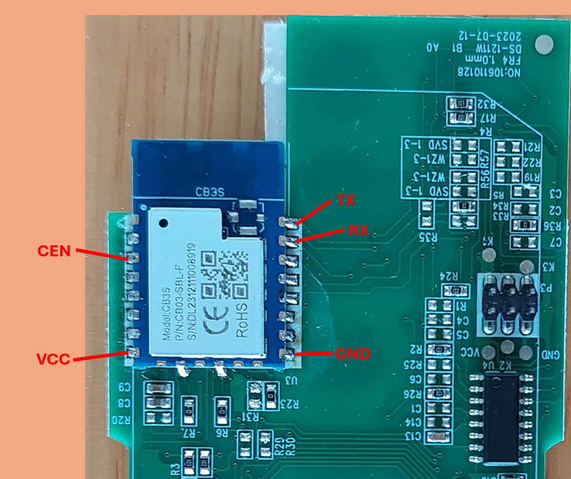

    Close-up of the AUBEES smart switch circuit board with CB3S chip.
    I used bk7231flasher_1.1.6, a Windows portable GUI flasher, to flash the CB3S chip via my Arduino UNO board as a com link to USB.
    Wiring the UNO to the chip is as follows (UNO > CB3S):
    GND > GND
    3V3 > VCC
    TX > TX
    RX > RX (I know most flashing devices are Tx > Rx, Rx > Tx, but on my Arduino, this won't work)
    On the Arduino board, short the RST pin to GND to bypass the UNO's chip.
    I had to set the baud rate to 115200 for the comms to work.
    When the flasher begins searching for the com device, short the CEN pin on CB3S chip for a split second.

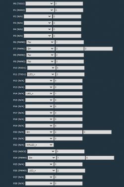

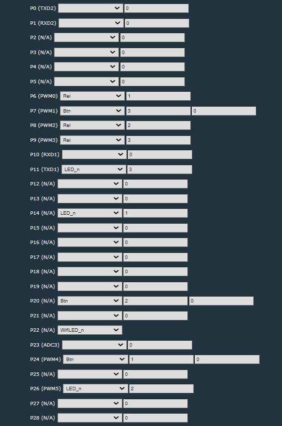

    In Config > Configure module, set the pin inputs and outputs as follows:
    P22 - WiFi Led_n
    P24 - Button 1
    P6 - Relay 1
    P14 - Led_n 1
    P20 - Button 2
    P8 - Relay 2
    P26 - Led_n 2
    P7 - Button 3
    P9 - Relay 3
    P11 - Led_n 3
    Screenshot of pin configuration in module interface.
