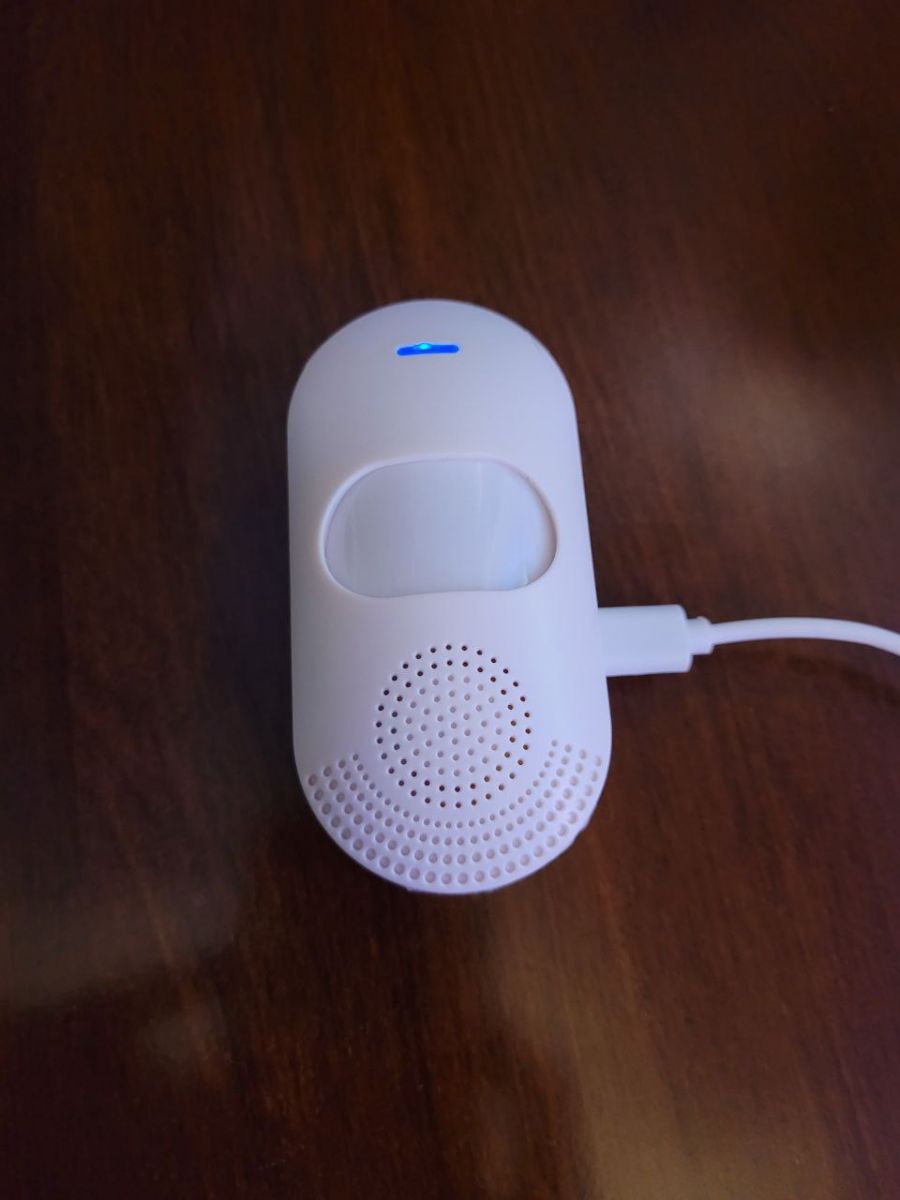

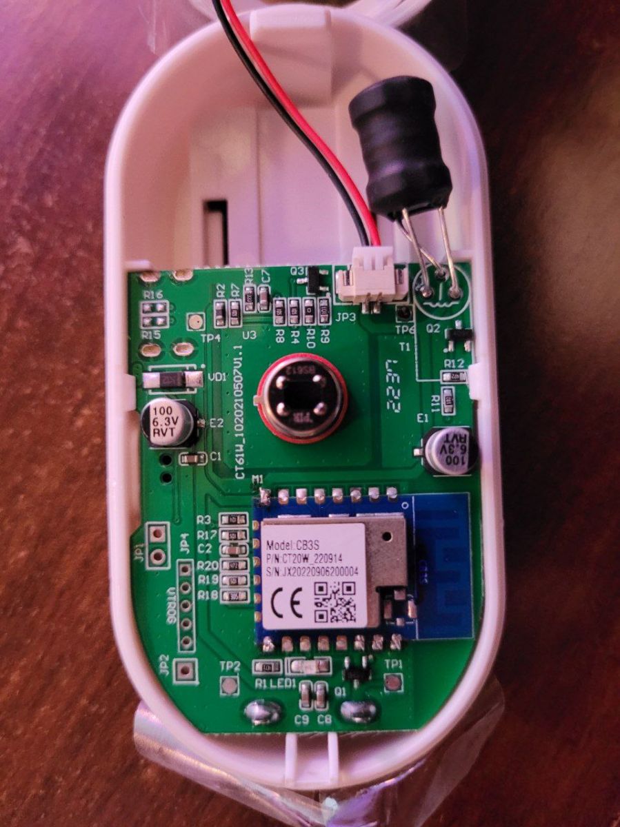

    Hi! I recently purchased this product and I have successfully installed the openbeken software after seeing that they changed the module from TYWE3S to CB3S (BK7231N). But now I'm stuck on how to configure it because there is no template for it... Can anyone give me a hand? :)

    Hello, it looks like a PIR sensor without TuyaMCU, altough you could confirm that by showing the other side of the PCB.
    In case of version without TuyaMCU, you'll have to use deep sleep feature of OpenBeken to preserve battery life, but we already got it working for door sensors and more:
    Door/window sensor without TuyaMCU - deep sleep and energy saving, OpenBeken
    [OpenBeken] SHT Sensor configuration, commands, and deep sleep usage with wake up on pin change
    but before invoking deep sleep, we need to know which GPIOs are used.
    Are you able to determine which GPIO is used for PIR sensor, which is used for button, for battery level, etc?
    @dheenhasty do you think your battery driver can run on that?

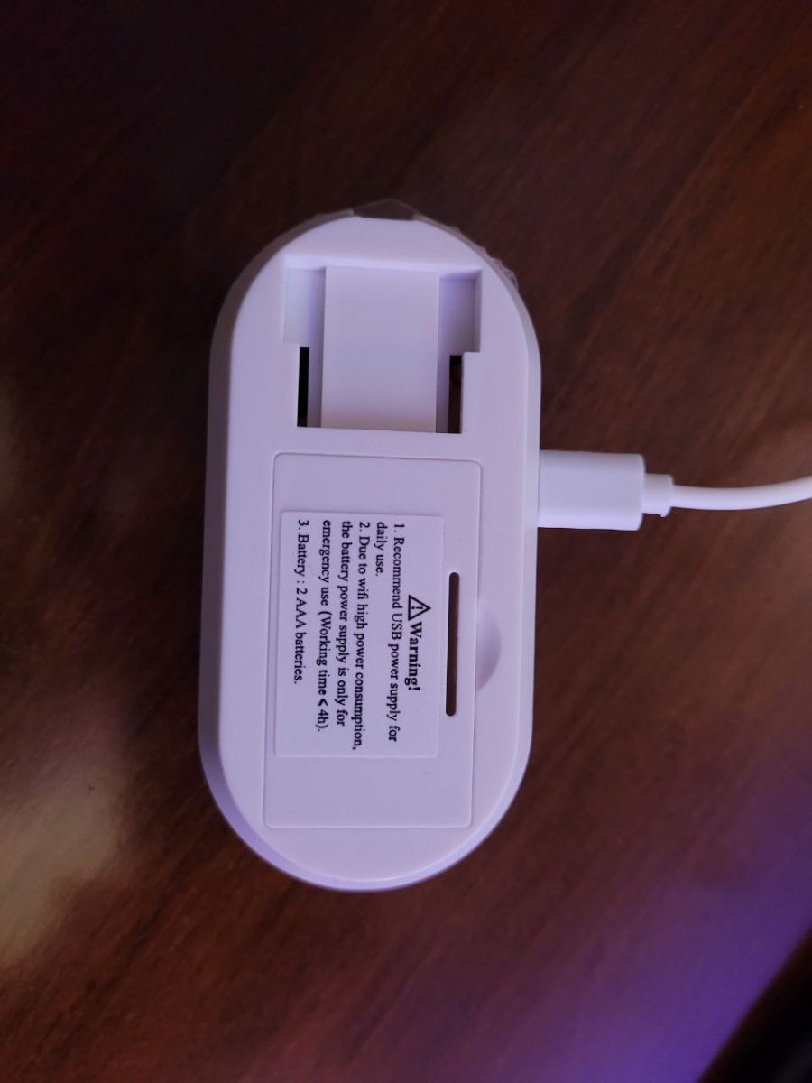

    Btw... huh, manufacturer says batteries will last for 6 hours only? I think with OBK they could last longer than that, of course.

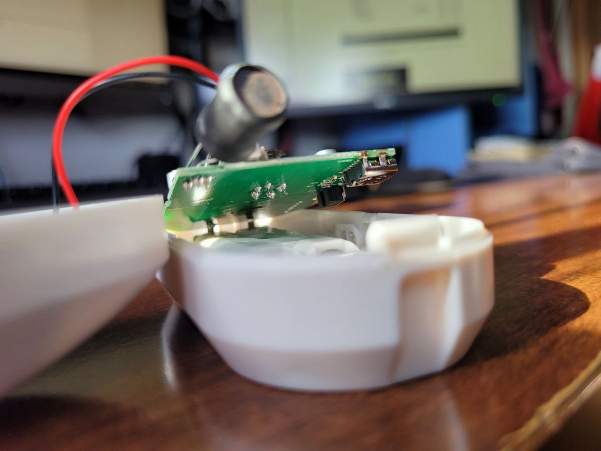

    I am a little bit scared to reopen it cause the battery pack is soldered underneath the PCB.. but it seems that there is nothing underneath (i've tried to take a picture tho).

    TuyaMCU is protocol used to communication between WiFi module and external MCU. Some Tuya devices are designed that way. It seems that your is without TuyaMCU.
    Hmm if you are going to power is constantly, then indeed Deep sleep is not required. I that case configuration would be very, very simple.
    You just need to find out which GPIO is used dinput sensor.

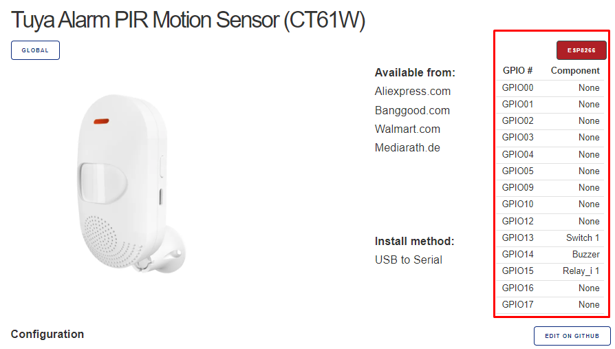

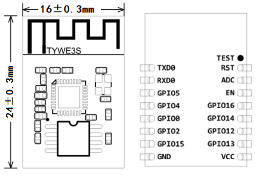

    So, the device was using TYWE3S in the past? Here is GPIO13:
    Configuring Tuya/SmartLife Alarm PIR Motion Sensor (CT61W) with CB3S (BK7231N) Module

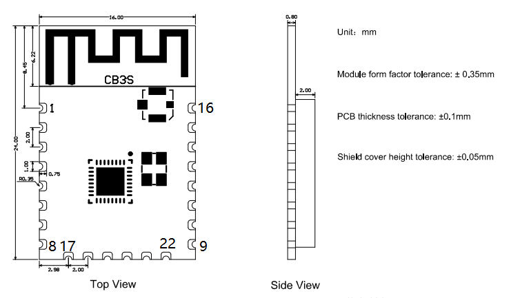

    And here are CB3S GPIOs:
    Pin numberSymbolI/O typeFunction
    1RSTILow-level reset, high level active (the pin has been pulled high internally), correspond to CEN of the IC
    2ADC3AIADC pin, which corresponds to P23 of the IC
    3CENIEnabling pin, which is pulled high internally to be compatible with other modules
    4P14I/OA common GPIO interface, which corresponds to P14 of the IC
    5P26I/OGPIOP_26, which corresponds to P26 of the IC, PWM 5
    6P24I/OGPIOP_24, which corresponds to P24 of the IC, PWM 4
    7P6I/OGPIOP_6, which corresponds to P6 of the IC, PWM 0
    8VCCPPower supply pin (3.3V)
    9GNDPPower supply reference ground
    10P9I/OGPIOP_9, which corresponds to P9 of the IC, PWM 3
    11TXD2I/OUART2_TXD (used to display the module internal information), which corresponds to P0 of the IC
    12CSNI/OProduction test control pin. If it is used as a common I/O pin, it must be connected to the VCC externally. Do not connect it to the ground before the module is powered on.
    13P8I/OGPIOP_8, which corresponds to P8 of the IC, PWM 2
    14P7I/OGPIOP_7, which corresponds to P7 of the IC, PWM 1
    15RXD1I/OUART1_RXD (user serial interface), which corresponds to P10 of the IC. Do not connect it to the VCC. By default, the MCU serial port should be in low-level or high-impedance state.
    16TXD1I/OUART1_TXD (user serial interface), which corresponds to P11 of the IC. Do not connect it to the VCC. By default, the MCU serial port should be in low-level or high-impedance state.
    17ADC3AI(Not recommended. If needed, please use Pin 2) ADC port, which corresponds to P23 of the IC. Programmed SPI
    18P22I/O(Not recommended ) GPIOP_22, which corresponds to P22 of the IC. Programmed SPI
    19CSNI/OThe pull-up resistor is needed during usage of customers. Do not connect it to the ground before the module is powered on. Correspond to P21 of the IC.
    20P20I/O(Not recommended. ) GPIOP_20, which corresponds to P20 of the IC. Programmed SPI
    I think we can already see which one is GPIO13 equivalent in CB3S. OpenBeken is using P* indexes.

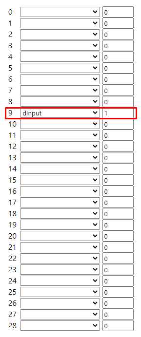

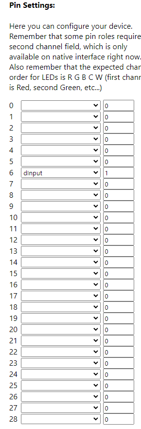

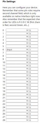

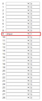

    Ok so if I understand correctly the GPIO13 on the TYWE3S is responsible for taking input from the PIR sensor.
    On the CB3S it corresponds to the pin number 10, so I have to set the P9 pin like this?

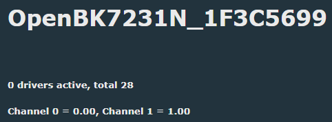

    EDIT: I notice that it remains always on 1 even if I wave my hand on it
    I have also noticed that if I set this pin
    The speaker turns on and I see this
  • #6 20482293
    Posts: 14743
    Rate: 12839
    It seems that TYWE3S has shown a bottom view while the CB3S has a top view. Your GPIO13 would have CB3S index 7 then, which is P6.

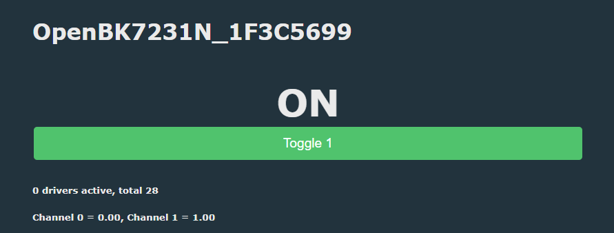

    Yay! It worked :)
    So now how can I access that value (I mean the 1 / 0 when the PIR is triggered).
    Cause I wanted to turn on / off a switch based on this value via python script.

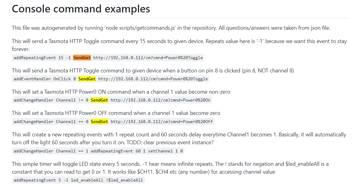

    You can do much more with scripts, for example, you could send a HTTP GET request to a target HTTP server when a channel value is changed.

    If you look into our console commands examples section here:
    https://github.com/openshwprojects/OpenBK7231T_App/blob/main/docs/commandExamples.md
    you can find:

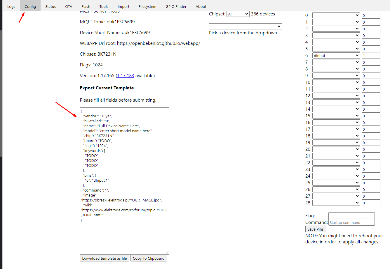

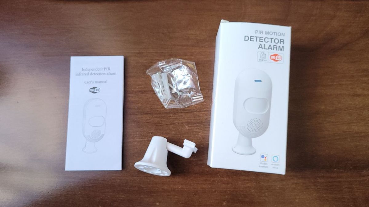

    Btw, please post full final device config from Web App and your scripts as well if you can, so I can add this topic to the supported devices list.
    Also, if you still have it, post some screenshots where device was bought and how the packaging looks like (model number? app name? etc)
    Thanks!
  • Request for full device config and purchase photos
    #13 20482598
    pincopallino1010
    Posts: 22

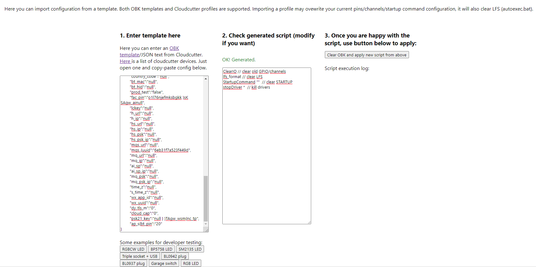

    This is my template (I have only changed the pin)
      "vendor": "Tuya",
      "bDetailed": "0",
      "chip": "BK7231N",
      "board": "TODO",
      "keywords": [
        "TODO",
        "TODO",
        "TODO"
      "pins": {
        "6": "dInput;1"
    Also, if you still have it, post some screenshots where the device was bought and how the packaging looks like (model number? app name? etc)
    I have bought it from here (Aliexpress)
    And this is the package
    Configuring Tuya/SmartLife Alarm PIR Motion Sensor (CT61W) with CB3S (BK7231N) Module Configuring Tuya/SmartLife Alarm PIR Motion Sensor (CT61W) with CB3S (BK7231N) Module Configuring Tuya/SmartLife Alarm PIR Motion Sensor (CT61W) with CB3S (BK7231N) Module Configuring Tuya/SmartLife Alarm PIR Motion Sensor (CT61W) with CB3S (BK7231N) Module Configuring Tuya/SmartLife Alarm PIR Motion Sensor (CT61W) with CB3S (BK7231N) Module

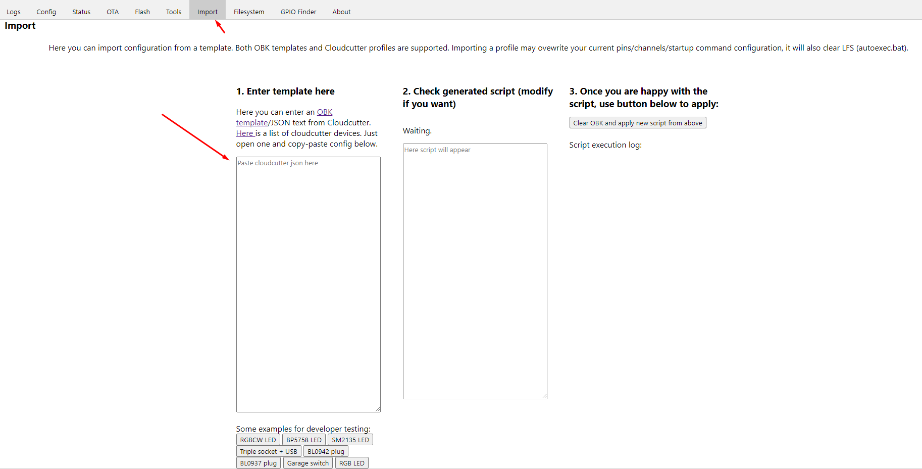

    @p.kaczmarek2, I have the same Tuya PIR device. Is there a template available for it? BR, MK
  • Tuya CT61W pinout and battery thresholds
    #21 20641851
    Posts: 14743
    Rate: 12839
    I haven't finished the teardown article about it yet, but here is the JSON:
    Here is text description:
    - Button (channel 0) on P20
    - Status LED on P26
    - PIR sensor on P16
    - Battery Relay on P17
    - Battery Max Voltage: 3000
    - Battery Min Voltage: 2200
    - Battery ADC on P23
    Device seems to use Battery Driver. See more details here: https://www.elektroda.com/rtvforum/topic3959103.html
    Device seems to be using CBU module, which is using BK7231N.
    This is not a final config, it will require some little work to finish it.

  • #24 20658761
    pincopallino1010
    Posts: 22
    Um, I see. In which of the two spaces should I enter the configuration?
    Regarding deep sleep, since I connected the sensor directly by cable to an UPS I shouldn't need it, right?
  • #25 20658778
    Posts: 14743
    Rate: 12839
    Hmm ok, you don't need deep sleep if you power device from cables.
    Configuration should be pasted in the first field, but as I said, the PIR data may need to be entered manually, not via importer.
  • #26 20658808
    pincopallino1010
    Posts: 22
    So I copied and pasted it here and it says this, does that mean it's okay?
    About the PIR data that may need to be entered manually, do you mean these?
  • #27 20661910
    Posts: 14743
    Rate: 12839
    The following screenshot shows that no config was imported from that JSON. It seems that we have to update our importer to cover PIR data. As I said, PIR most likely will have to be done manually, for now... . I will try to look into that in the following days.
