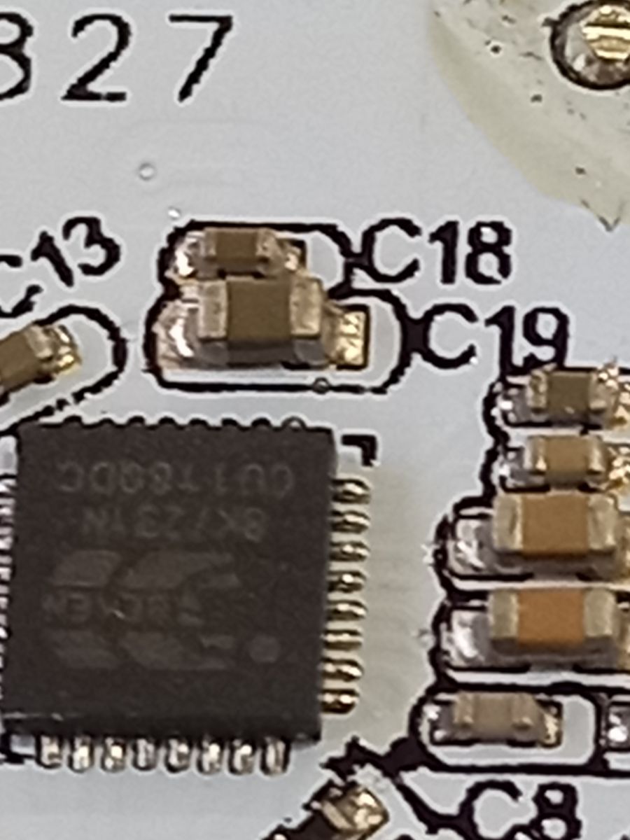

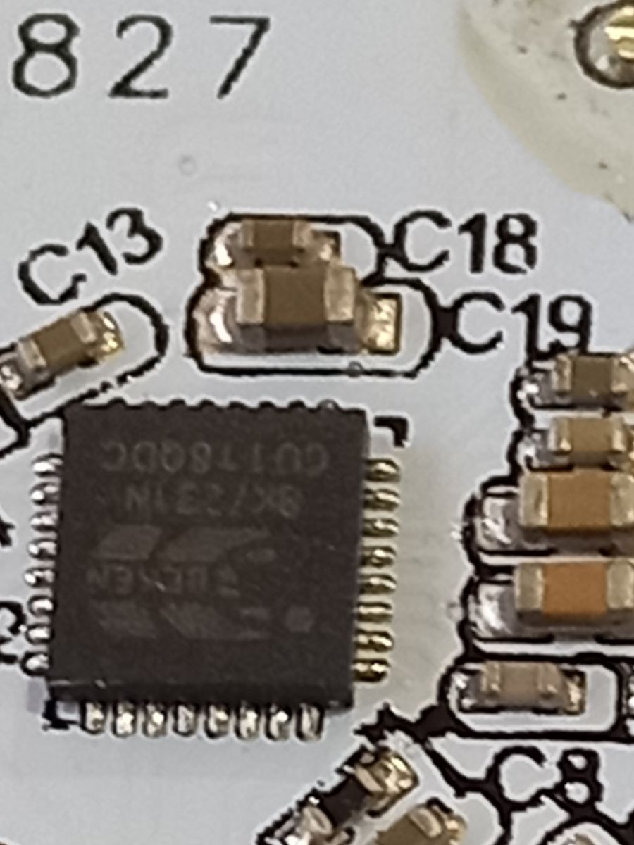

    Hello, good job with flashing, can you determine which BK7231 IO pin is used for PIN sensor by following the PCB copper tracks with a multimeter?
    Which BK7231 is there?

    Hi,
    The chip is the BK7231N

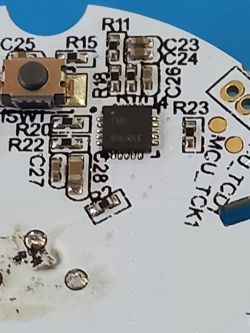

    Wait, there is a secondary MCU on the board. It must be a TuyaMCU device. So most likely we don't need to determine the pin used by BK, because it is using TuyaMCU to handle PIR sensor. We need to figure out the dpIDs of TuyaMCU packets.
    Can you open Realterm, set baud rate 9600 (for TuyaMCU), do not connect CEN, and try to trigger the sensor? Do you see any 55 AA 00 packets in hex mode?
    Would you be able to do a TuyaMCU packets dump to file in Realterm and show content of the packets here?

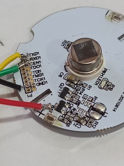

  • TuyaMCU powers off the WiFi module
    #9 20313969
    Posts: 14811
    Rate: 12977
    Do you have a multimeter?
    caubergjef57 wrote:
    Motion sensor with BK7231N and TuyaMCU battery powered devices protocol
    This means that TuyaMCU powers off the WiFi module. You can check the voltage between 3.3V and GND of the module. It will be 3.3V and then it will turn down to 0 when TuyaMCU turns off the module and saves the power.
    You could do a temporary short around that transistor if you are able to follow the tracks on the PCB...
    you should check logs in the Web App, is there anything related to TuyaMCU

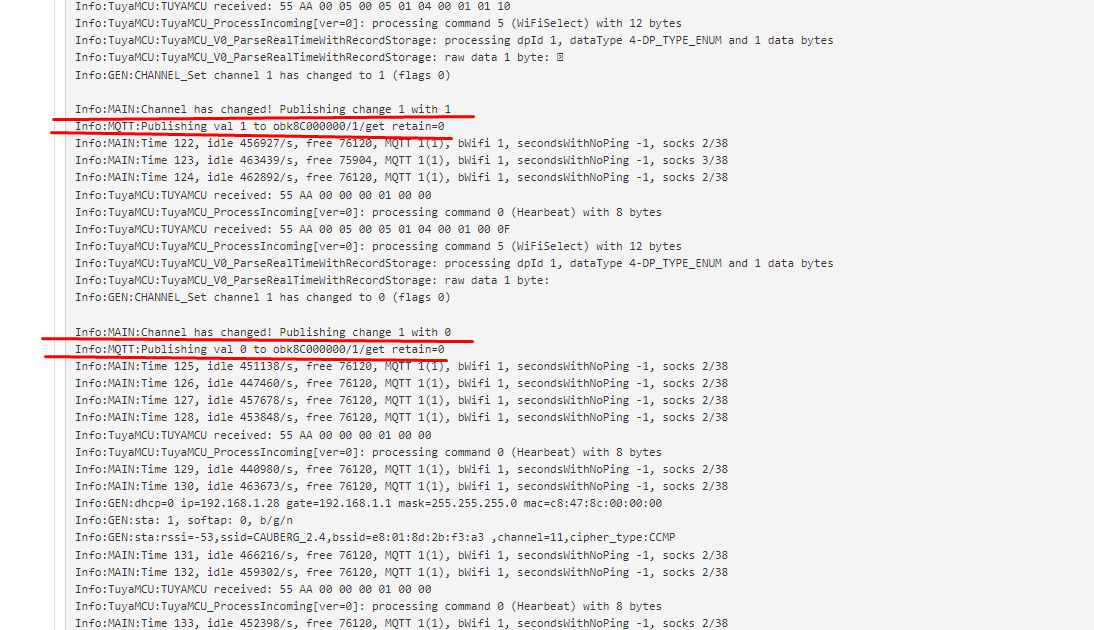

    So it receives something. That's good news! It proves that's a TuyaMCU. We're getting progress!
    Now please disconnect device from power, take out batteries, and power it again, then copy-paste me here (in the "code" tag) full log, from the boot to the device shutdown (WiFi module here will be turned off automatically by TuyaMCU after a 2 minutes or so)

    This is much better. Thanks.
    Okay, so now I can see that Tuya changed the Id of the command reporting the module state, or... or maybe it's just using different kind of command.
    I will update firmware to parse it as well.
    But let's first analyze it by hand.
    I am referring to those two packets:
     55AA 00 05 0005 01 04 0001 01 10
     55AA 00 05 0005 01 04 0001 00 0F
    You can check the format in documentation:
    https://developer.tuya.com/en/docs/iot/tuyacl...niversalserialaccessprotocol?id=K95afs9h4tjjh
    See the annotated version:
    HEAD - header
    VR - version (v0 is TuyaMCU for lower power serial protocol)
    CM - command type byte
    LENG - length of packet
    ID - dpID of a variable. This is variable 1
    TP - type of variable. Type 0x04 is Enum
    LEN - length of variable data
    VL - value , 0x01 or 0x00, it's a PIR sensor status?
    CH - checksum.
    I will now add parsing of that packet to OpenBeken. Please wait.
    In a meantime, are there any other variables reported in 0x05 packet? Maybe battery status?

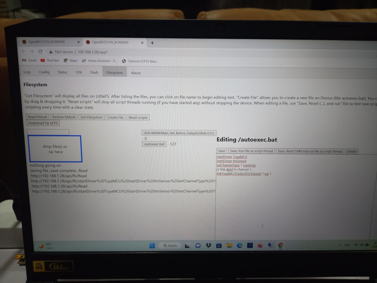

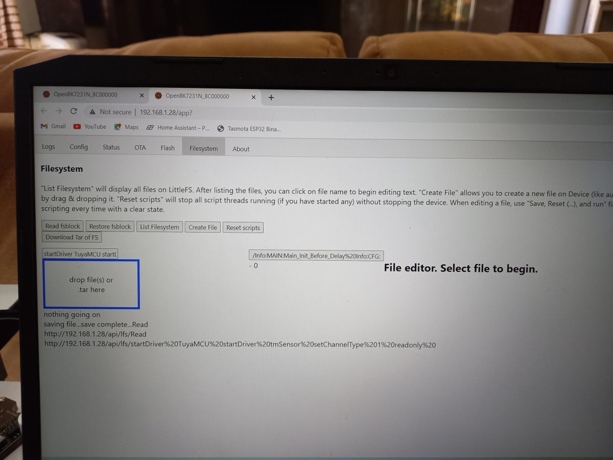

  • Firmware update needed for TuyaMCU 0x05 packet parsing
    #17 20320779
    Posts: 14811
    Rate: 12977
    I am not sure what happened because the post with log is missing, but from what I can gather from the part I quoted, you have a dpId 1 with something like a detection state.
    I had to add parsing of 0x05 packet, so you need firmware update.
    So now...
    1. update to latest version, by wire or by OTA, this is tricky because TuyaMCU will try to turn off wifi module after about 90 seconds,, I'd suggest you to make a jumper on the board from 3.3V to the VDD (3.3V) pin of WiFi module for the time of OTA.
    Having OTA interrupted by power off may brick your device (and you'd need SPI to recover).
    2. remove whole "short startup command"
    3. go to Web App, go to file system, create autoexec.bat
    Paste and save:
    startDriver TuyaMCU
    startDriver tmSensor
    setChannelType 1 readonly
    // link dpid to channel 1
    I am not sure if it's the full config, but in case of movement, it should MQTT publish something like:
    OBK_DEV_NAME/1/get
    with value 1 or 0 when movement happens.
    There may be further problems, if something goes wrong, I need full log.
    You should get something like that:

    Hi,
    I flashing the latest bin file and create the autoexec file. this is the log after.
  • Extra whitespace after driver name broke parsing
    #21 20320936
    Posts: 14811
    Rate: 12977
    Sorry, it seems I had a bug in the config - it had an extra whitespace after driver name and it didn't start driver.
    Parsing will be fixed in next update.
    Can you try again (remove whitespace after tmSensor):
    startDriver TuyaMCU
    also, while posting log, post screenshot from main HTTP page so I know which drivers are running

    Added after 3 [minutes]:
    Motion sensor with BK7231N and TuyaMCU battery powered devices protocol Motion sensor with BK7231N and TuyaMCU battery powered devices protocol
  • #24 20323340
    Posts: 14811
    Rate: 12977
    You must have done something incorrectly. This is not how it is supposed to look on LittleFS page.
    Please see my screenshot:
  • MQTT set commands ignored when channel already 0

    Info:CMD:LFS_ReadFile: openned file /autoexec.bat
    Info:CMD:LFS_ReadFile: Loaded 127 bytes
    Info:CMD:LFS_ReadFile: closed file /autoexec.bat
    Info:CMD:CMD_StartScript: started /autoexec.bat at the beginning
    Info:MAIN:Started TuyaMCU.
    Info:MAIN:Started tmSensor.

    Info:TuyaMCU:TUYAMCU received: 55 AA 00 00 00 01 00 00
    Info:TuyaMCU:TuyaMCU_ProcessIncoming[ver=0]: processing command 0 (Hearbeat) with 8 bytes
    Info:MAIN:Time 81, idle 441972/s, free 76120, MQTT 1(1), bWifi 1, secondsWithNoPing -1, socks 2/38
    Info:TuyaMCU:TUYAMCU received: 55 AA 00 01 00 24 7B 22 70 22 3A 22 6C 79 64 77 6F 62 77 79 71 78 69 79 6F 62 39 68 22 2C 22 76 22 3A 22 31 2E 30 2E 31 22 7D 5E
    Info:TuyaMCU:TuyaMCU_ProcessIncoming[ver=0]: processing command 1 (QueryProductInformation) with 43 bytes
    Info:TuyaMCU:TuyaMCU_ParseQueryProductInformation: received {"p":"lydwobwyqxiyob9h","v":"1.0.1"}
    Info:MAIN:Time 82, idle 463869/s, free 76120, MQTT 1(1), bWifi 1, secondsWithNoPing -1, socks 2/38
    Info:TuyaMCU:TUYAMCU received: 55 AA 00 02 00 00 01
    Info:TuyaMCU:TuyaMCU_ProcessIncoming[ver=0]: processing command 2 (MCUconf) with 7 bytes
    Info:TuyaMCU:TuyaMCU_ProcessIncoming: TUYA_CMD_MCU_CONF had wrong data lenght?
    Info:MAIN:Time 83, idle 458302/s, free 76120, MQTT 1(1), bWifi 1, secondsWithNoPing -1, socks 2/38
    Info:MAIN:Time 84, idle 467676/s, free 76120, MQTT 1(1), bWifi 1, secondsWithNoPing -1, socks 2/38
    Info:MAIN:Time 85, idle 455819/s, free 76120, MQTT 1(1), bWifi 1, secondsWithNoPing -1, socks 2/38
    Info:TuyaMCU:TUYAMCU received: 55 AA 00 05 00 08 04 02 00 04 00 00 00 64 7A
    Info:TuyaMCU:TuyaMCU_ProcessIncoming[ver=0]: processing command 5 (WiFiSelect) with 15 bytes
    Info:TuyaMCU:TuyaMCU_V0_ParseRealTimeWithRecordStorage: processing dpId 4, dataType 2-DP_TYPE_VALUE and 4 data bytes
    Info:TuyaMCU:TuyaMCU_V0_ParseRealTimeWithRecordStorage: raw data 4 int: 100

  • MQTT setup and empty MAC warning
    #26 20324440
    Posts: 14811
    Rate: 12977
    Very good job! It seems we're having a progress here.
    It looks like TuyaMCU is able to publish some values over MQTT. Here are the related log parts:
    It first publishes 1 value, then 0. This might be what we want. I am just not sure why it toggles between 1 and 0, we need more testing.
    Do you have MQTT connected? Now it's time to configure MQTT. You will be able to receive that publish value in Home Assistant.

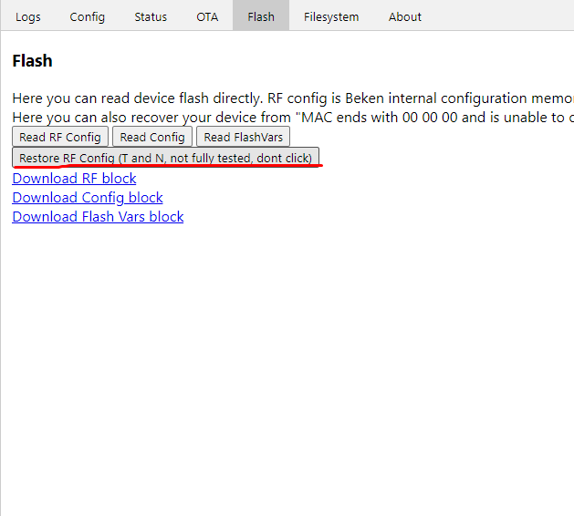

    PS: The name "obk8C000000" indicates that you have empty MAC address. Please go to Web App, Flash section, add use this button:
    Otherwise you might experience device disconnects when you get two devices with same empty MAC!!!
  • TuyaMCU heartbeat and MQTT connection log

    Info:TuyaMCU:TUYAMCU received: 55 AA 00 05 00 05 01 04 00 01 01 10
    Info:TuyaMCU:TuyaMCU_ProcessIncoming[ver=0]: processing command 5 (WiFiSelect) with 12 bytes
    Info:TuyaMCU:TuyaMCU_V0_ParseRealTimeWithRecordStorage: processing dpId 1, dataType 4-DP_TYPE_ENUM and 1 data bytes
    Info:TuyaMCU:TuyaMCU_V0_ParseRealTimeWithRecordStorage: raw data 1 byte:
    Info:GEN:CHANNEL_Set channel 1 has changed to 1 (flags 0)
    Info:MAIN:Channel has changed! Publishing change 1 with 1
    Info:MQTT:Publishing val 1 to obk8C000000/1/get retain=0

    Info:TuyaMCU:TUYAMCU received: 55 AA 00 05 00 05 01 04 00 01 00 0F
    Info:GEN:CHANNEL_Set channel 1 has changed to 0 (flags 0)
    Info:MAIN:Channel has changed! Publishing change 1 with 0
    Info:MQTT:Publishing val 0 to obk8C000000/1/get retain=0
    Info:MAIN:Drv TuyaMCU is already loaded.
    Info:MAIN:Drv tmSensor is already loaded.
    Info:GEN:Channel 1 type changed to readonly

    binary_sensor:
    - unique_id: "OpenBK7231N_8c000000"
    state_topic: "obk8c000000/1/get"
    qos: 1
    payload_on: 1
    payload_off: 0
    I write this in yaml and can see the motion sensor now in HA

Why does my PIR publish only ‘1’ (motion) and miss the ‘0’ (clear)?
Initialize the channel so changes are detected. Two options: SetStartValue 1 -1 (remember last state) or setChannel 1 2 once in autoexec, so both 0 and 1 cause a change. This prevents ignored first updates. [Elektroda, p.kaczmarek2, post #20578050]

My MAC shows 00:00:… or devices clash on the network. How do I fix it?
Open the WebApp Flash section and click Restore MAC/Restore RF button. It restores MAC to avoid conflicts. Quote: “Otherwise you might experience device disconnects when you get two devices with same empty MAC!!!” [Elektroda, p.kaczmarek2, post #20324440]
