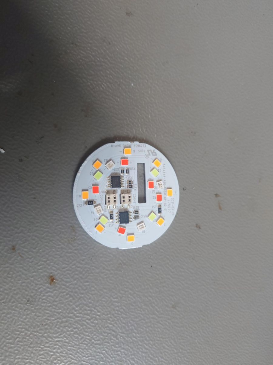

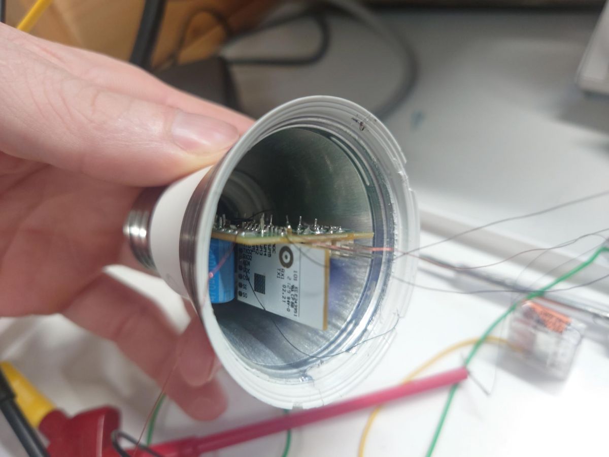

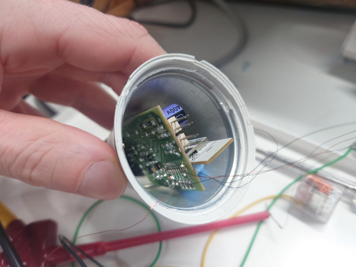

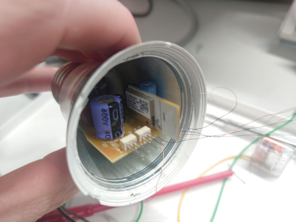

    agehwaida
    Inside of a light bulb showing a PCB and electronic components. Hand holding an opened electronic device with a visible circuit board and wires. Interior of a light bulb with visible electronic circuit and wires. Circular electronic board module with LEDs and components.
    BK7231T Firmware works.
    Info from backup, is attached.
    Wrote 2097152 to readResult_BK7231T_QIO_a_2024-19-4-15-18-16.bin
    Backup 2MB created, now will attempt to extract OBK config.
    It's not an OBK config, header is bad
    OBK config not found.
    Backup 2MB created, now will attempt to extract Tuya config.
    Tuya config extractor - magic is at 2023424
    Saving debug Tuya decryption data to lastRawDecryptedStrings.bin
    Failed to extract Tuya keys - no json start found
    Sorry, failed to extract keys from Tuya Config in backup binary.
    • readResult_LEDVANCE_SMART _9W_E27_RGBW_WB8P_BK7231T_QIO_a_2024-19-4-15-18-16.bin (2 MB) You must be logged in to download this attachment.
  • Tuya config dump reveals keys but no pin map
