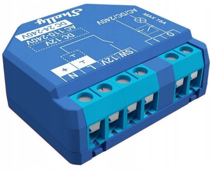

  • Shelly Plus 1 as potential-free restart relay
    #9 21075402
    tomaszewskiireneusz
    I found a Shelly relay with exactly the solution I needed. Shelly's potential-free Plus 1 WiFi relay, costing around PLN75-80 at the moment.
    Blue Shelly relay with several terminal connections for electrical wiring.
    It can control a DC or AC line, and the control itself is 12, 24 or 230v depending on how it is connected. There is also the possibility to connect a physical switch and control via wifi, which has overriding priority (you can disconnect or connect the contacts when given an "on" signal from a physical switch). Unfortunately, it does not work with the Tuya app, it only uses the factory app, which has quite a few configuration options, e.g. start-up or shut-down linked to sunrise and sunset with a set delay or advance. The only thing missing is the ability to set the unit to restart every given time interval, but this can be clicked on manually several times a day, in case the charging current from the PV panel drops below the charging level, which in my case caused the charging station to hang up. To automate the latter, I bought an in-line voltage meter from the PV, which will work with the Wi-Fi socket that powers the relay control, already under the Tuya app.
    Thank you all for your help.
