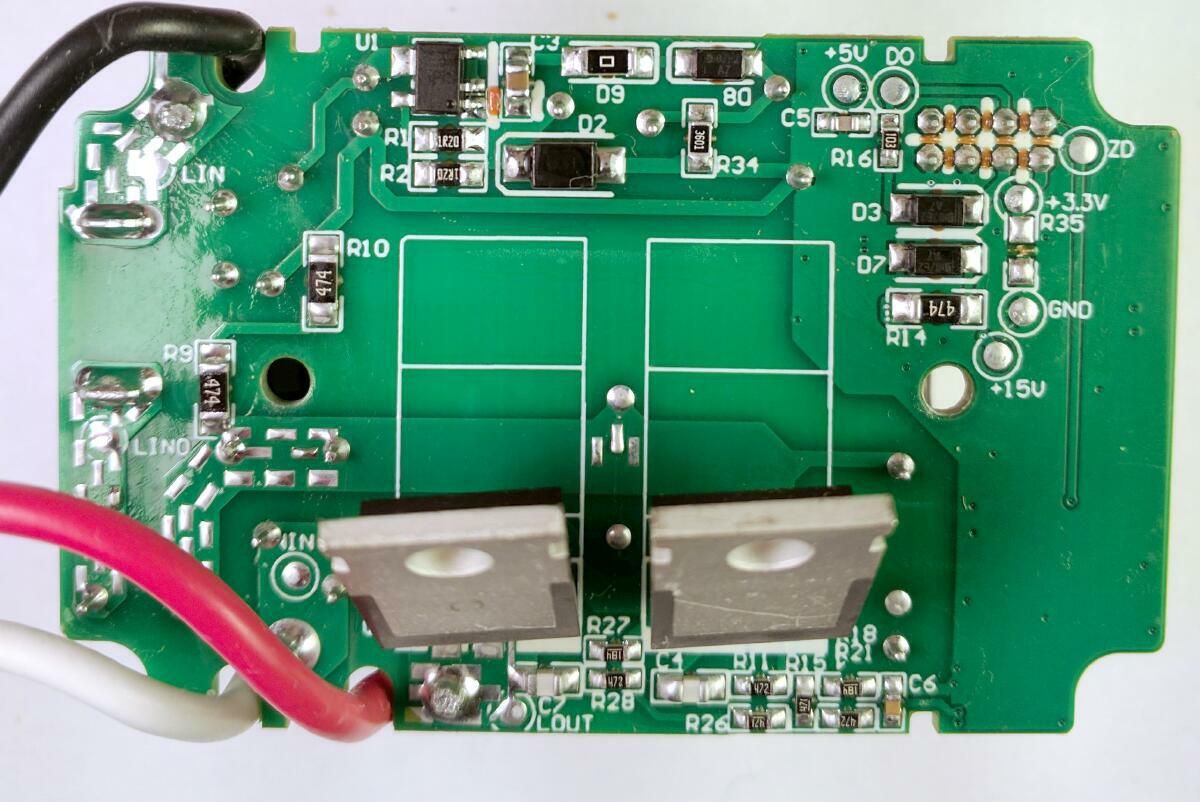

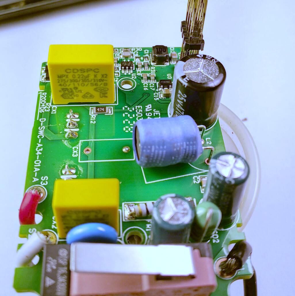

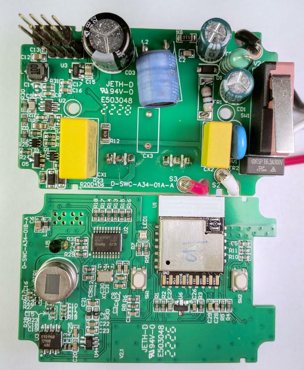

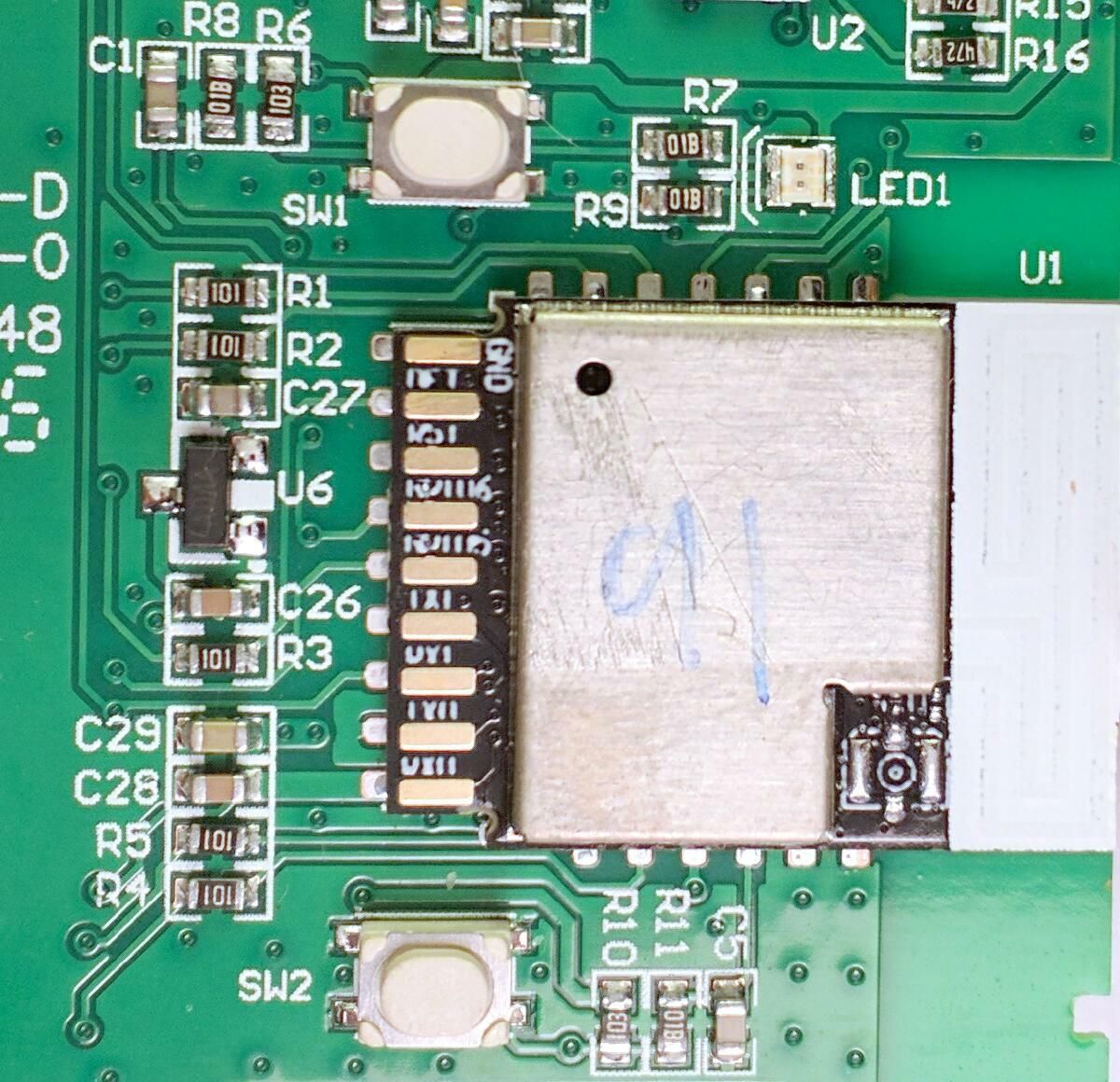

    Hi all,
    Added: Since these ESP32 units are very probably write-protected I'm changing my opinion to really really bad design on these.

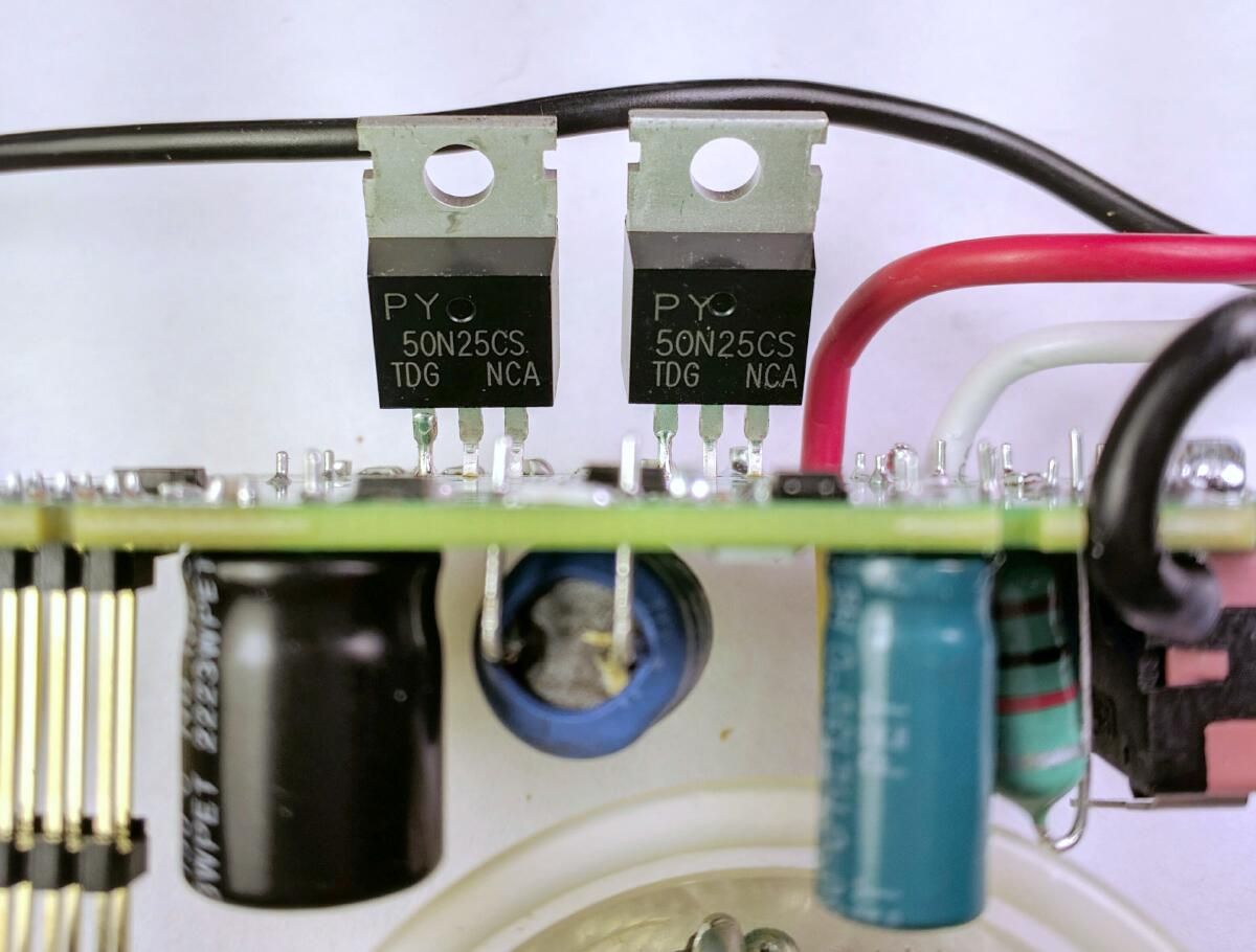

    got me these dimmers, impressed by the design, they use 2xN-FETs instead of a triac.
    Has power shutoff (via Micro Lever Switch) for safety.
    PIR sensor, seems badly implemented in software.
    Uses a 32-Bit ARM (Cortex) controller, just for dimming?
    Several DC up/down converters.
    Has many pins laid out as test points.
    Never seen this WiFi chip, is it ESP or tuya or??
    Printed circuit board with labels and test points. Printed circuit board with test points and traces. Close-up of a circuit board with an electronic module and micro switches. Web page showcasing a smart light dimmer switch with motion sensor. Commercial Electric smart dimmer with motion sensor in packaging. Compact wall dimmer with motion and light sensor, Wi-Fi indicator, and brightness adjustment buttons. Person holding an electrical device with exposed wires in front of an open electrical box. Printed circuit board with various electronic components, including an ESP module, capacitors, and resistors. Close-up of the electronic circuit inside a dimmer with visible PCB traces and components. Circuit board with various electronic components, including capacitors and a plug. Internal circuit board with electronic components and wire connectors. Close-up of a circuit board with two PYO 50N25CS transistors, capacitors, and wiring.
    Any hints on how to proceed liberating this unit from its bad software problem?
    Thanks

    ESP32 may be write-protected and you also will most likely need to capture the communication with the MCU first.
    What is Hubspace?

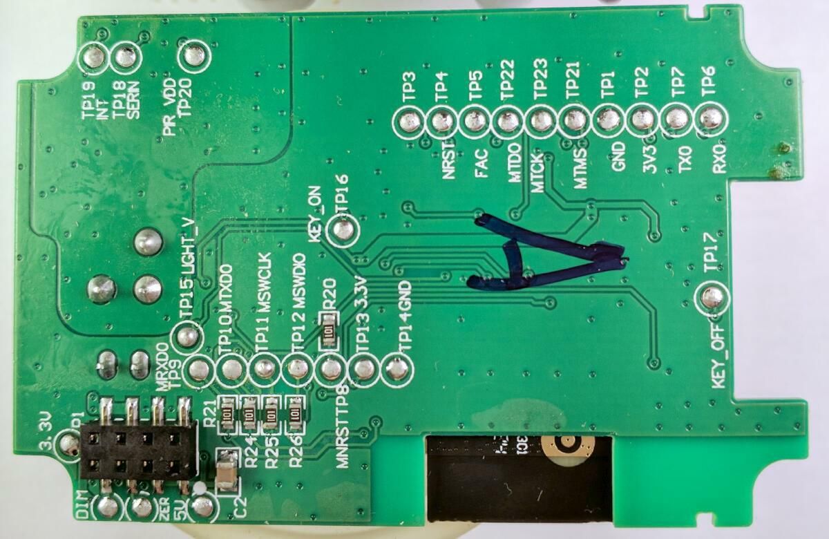

  • Asking whether to probe TX0 or TX1
    #4 21061851
    omniron
    Posts: 114
    Thanks for your replies,
    divadiow, excellent find, seems exactly the same
    should i check tx0 or tx1?
    Didn't know ESP32 can be write-protected.
    Thus far all esp stuff I came across was reflashable, bummer
    I won't be able to remove the esp, so if there is no re-flashing of the LA02301, then that's it unfortunately. what a waste, seems well built.
    Hubspace is a sub-company from home depot. seems specialized on electrical smart stuff
    home depot is a huge hardware store in the us

    @omniron might require replacing it another esp if it’s locked, seems likely from the homeassistant thread
    Not sure if you can find any LA02301 module for purchase
    So you might need to use any esp32 and just solder wires to the pads

  • #7 21062831
    dasen
    DC board like the use of 2 MCUs, one of which is the SSOP10 package, model 32F003F6P7, the other is a wireless module, the wireless module should be used as a coprocessor, dedicated to the wireless protocol stack related processing, 32F003F6P7 should be the host, I want to know that the wireless module is not used in the ESP32 need to remove the shielding, you can use the hot air gun
  • #8 21062893

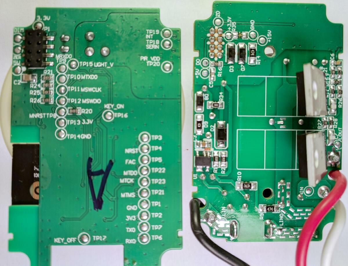

  • Access to tx0 and rx0 on WiFi module
    #10 21065886
    omniron
    Posts: 114
    So I opened the dimmer for you and it seems I have access to tx0 and rx0, really small everythig.
    Does your tool work for reading ESP, too?
    I tried to get the logic borad going with 5V and 3.3V (and GND of course), but that doesn't work.
    So it is hooked up to live AC.
    I am using an isolated ser/USB converter.

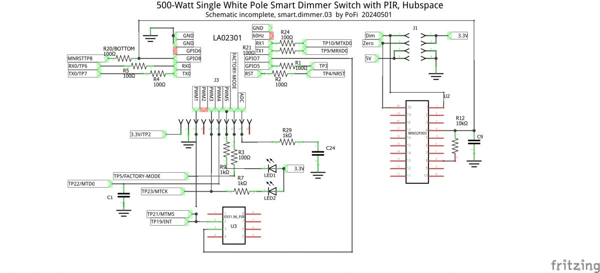

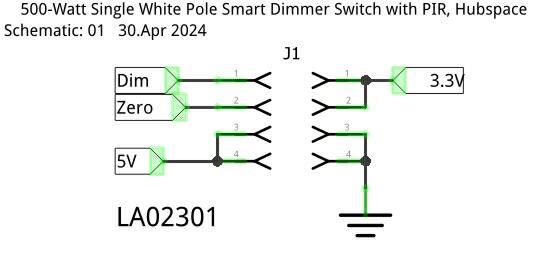

    Schematic of smart dimmer switch with PIR for 3.3V and 5V power.
    attached WiFi module
    • Smart.dimmer.LA02301.4959691.pdf (3.95 MB) You must be logged in to download this attachment.

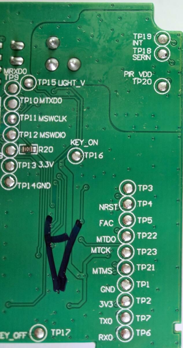

  • RX0 and TX0 appear to be testpoint-only connections
    #12 21065961
    omniron
    Posts: 114
    Don't think I ever read a Tasmota device before, the ones I have were cracked already.
    Have to see if there is a Raspberry Pi implementation of that esptool.py tool.
    No idea what is connected where, but it seems RX0 and TX0 are only connected to the testpoints.
    I found the factory mode pin mentioned here
    https://community.home-assistant.io/t/help-trying-to-flash-esp32-in-home-depot-bulb/326294/12
  • Partial schematic and pin access noted
    #13 21066350
    omniron
    Posts: 114
    Partial schematic.
    Interesting: the top facing 9 pins are made available on the bottom left and right sides.
    So even if you don't sandwich the board (standing 90 deg on the main PCB) you still have access to all pins when lying flat on the PCB
    I stopped with it all since I really think that it will be very difficult to extract anything from this unit, and it seems impossible to flash it.
    p.kaczmarek2, if you think I should proceed (where others have failed) you need to give me exact instructions please.
    Electronic schematic for a 500W dimmer with PIR sensor. .

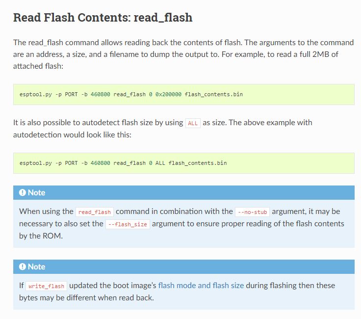

  • Backup ESP flash with esptool.py before flashing
    #14 21067366
    Posts: 14797
    Rate: 12954

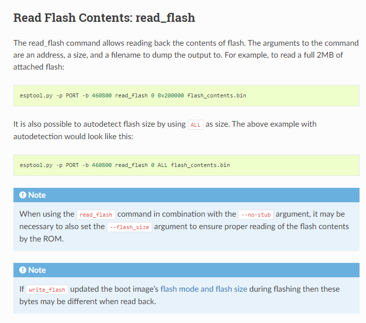

    I think the first step in case of ESP devices (both ESP8266 and 32) is to read the flash memory to make a backup.
    Here is a detailed guide for esptool.py which can be used for this purpose:
    https://docs.espressif.com/projects/esptool/en/latest/esp32/esptool/basic-commands.html
    So, please try doing:
    esptool.py -p PORT -b 460800 read_flash 0 0x200000 flash_contents.bin
    Of course change your PORT first.
    Screenshot of esptool.py instructions for reading flash memory contents.
    Once you have a backup, you can try flashing Tasmota, but it may not work if ESP32 is locked...
