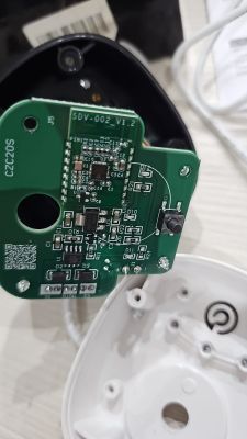

    There are no screws, we just pry up the base:
    WiFi SmartLife single-color LED strip dimmer - test, interior, diagram
    And we immediately see the interior:
    Unfortunately, this is not for any ESP8266 or ESP8285 (TYWE3S, TYWE2S). This is WB3S:
    WB3S, an energy-saving WiFi + Bluetooth module from Tuya, based on the BK7231T chip.
    Additionally, we have what looks like a converter and transistors:
    From the bottom, we have space for additional layouts. There are no programming pins. There are pins with roles:
    - IR-, IRIN - probably this board also supports remote control in another version ...
    - W, R, G, B - this PCB probably also supports separate control of 4 channels in a different version (separate PWM for R - red, separate for G - green, etc., red green blue white).
    Let's take a better look at the inverter:
    The converter is a xl1509-3.3e1 by XLSemi.
    It is more precisely a step down converter (buck) which works on input voltage from 4.5V to 40V, and gives 3.3V at the output (there are also versions giving 5V and 12V). So this circuit provides power to the WB3S.
    There are still transistors. The designation for R0 might point to a few different ones, but my searches show that these are probably CJ3400 or similar:
    So MOSFET transistors with an N channel in the SOT-23 housing, with a very low RdsON, just right for switching high currents.
    There is also a fuse on the board, which is always a plus in this type of product.
