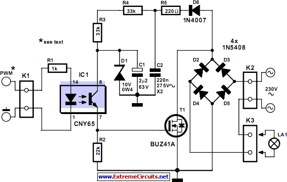

    20N60C3. MOSFET, not thyristor. Small surprise. So they ... are releasing an already rectified voltage onto the bulb? Is that why this rectifier bridge is so big?

    So they .... let the already rectified voltage go to the bulb?
    No. They only give the MOSFET transistor a comfortable condition where the current only flows one way. For the bulb, nothing changes as it continues to get its AC current while being outside the bridge.

    @ZbeeGin it looks like you're right, is this more or less the scheme in question?
    Electronic circuit diagram of a dimmer with a MOSFET.
    https://www.learningelectronics.net/circuits/dimmer-with-mosfet.html

    @ZbeeGin looks like you're right, is this more or less the scheme in question?
    Exactly.
