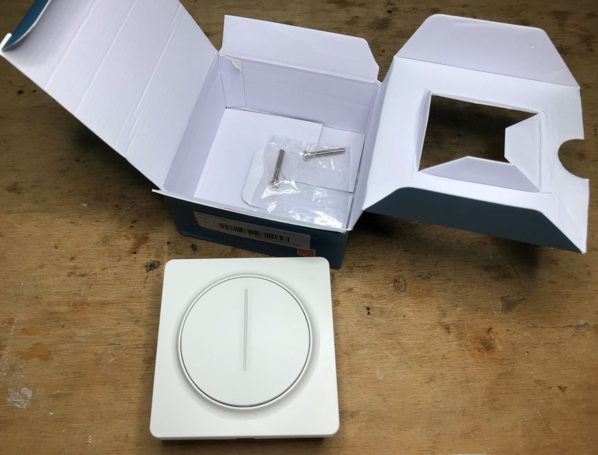

    Dimmer EDM-01AA-EU 300W for BK7231 and TuyaMCU - configuration Dimmer EDM-01AA-EU 300W for BK7231 and TuyaMCU - configuration Dimmer EDM-01AA-EU 300W for BK7231 and TuyaMCU - configuration
    Kit contents - screws for fixing:

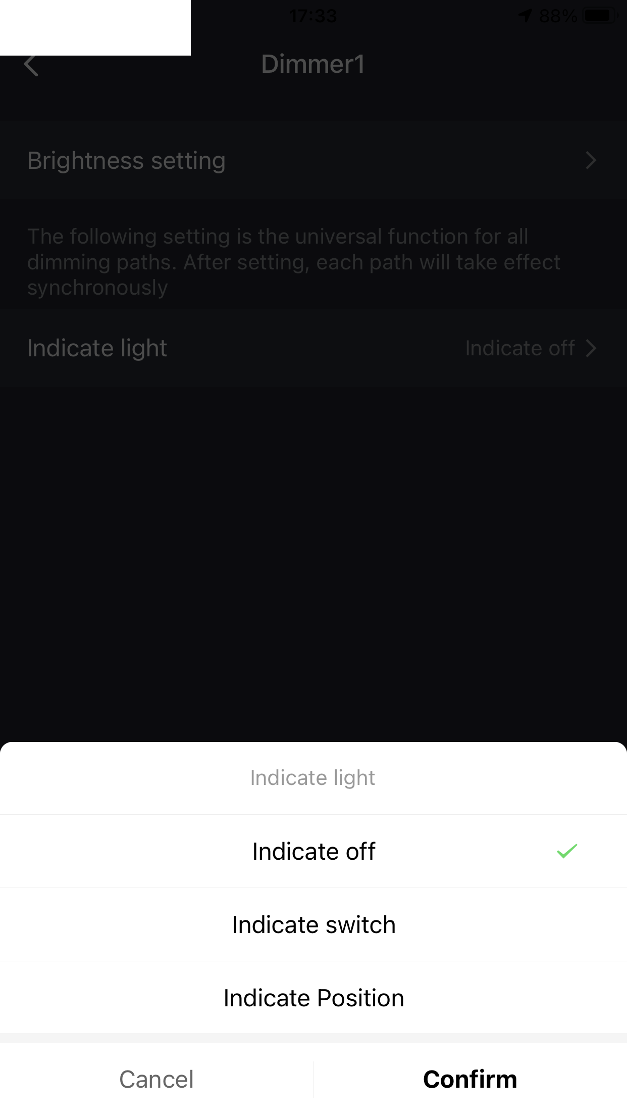

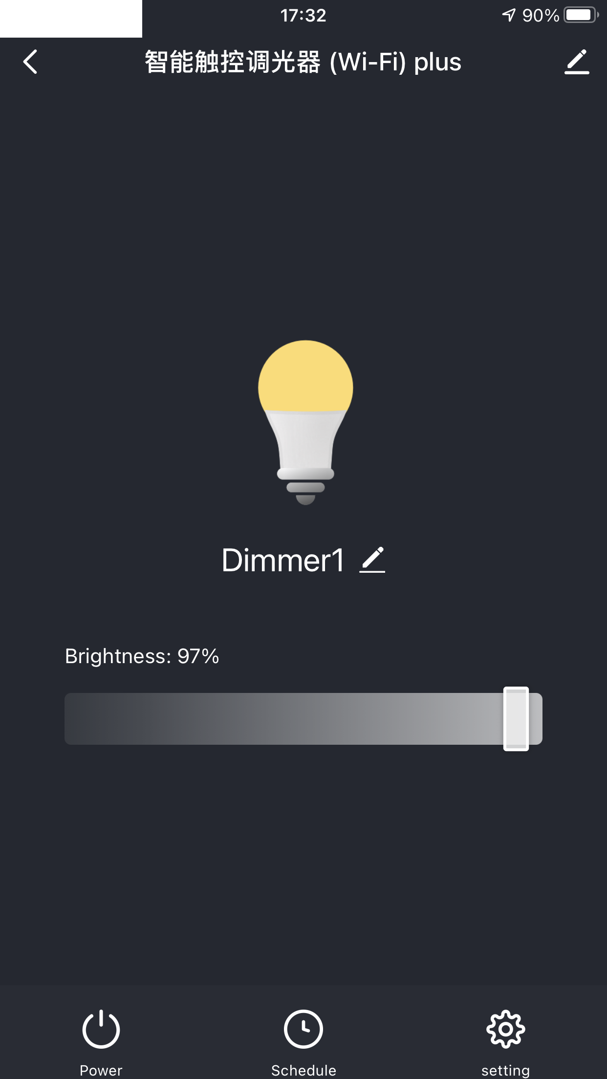

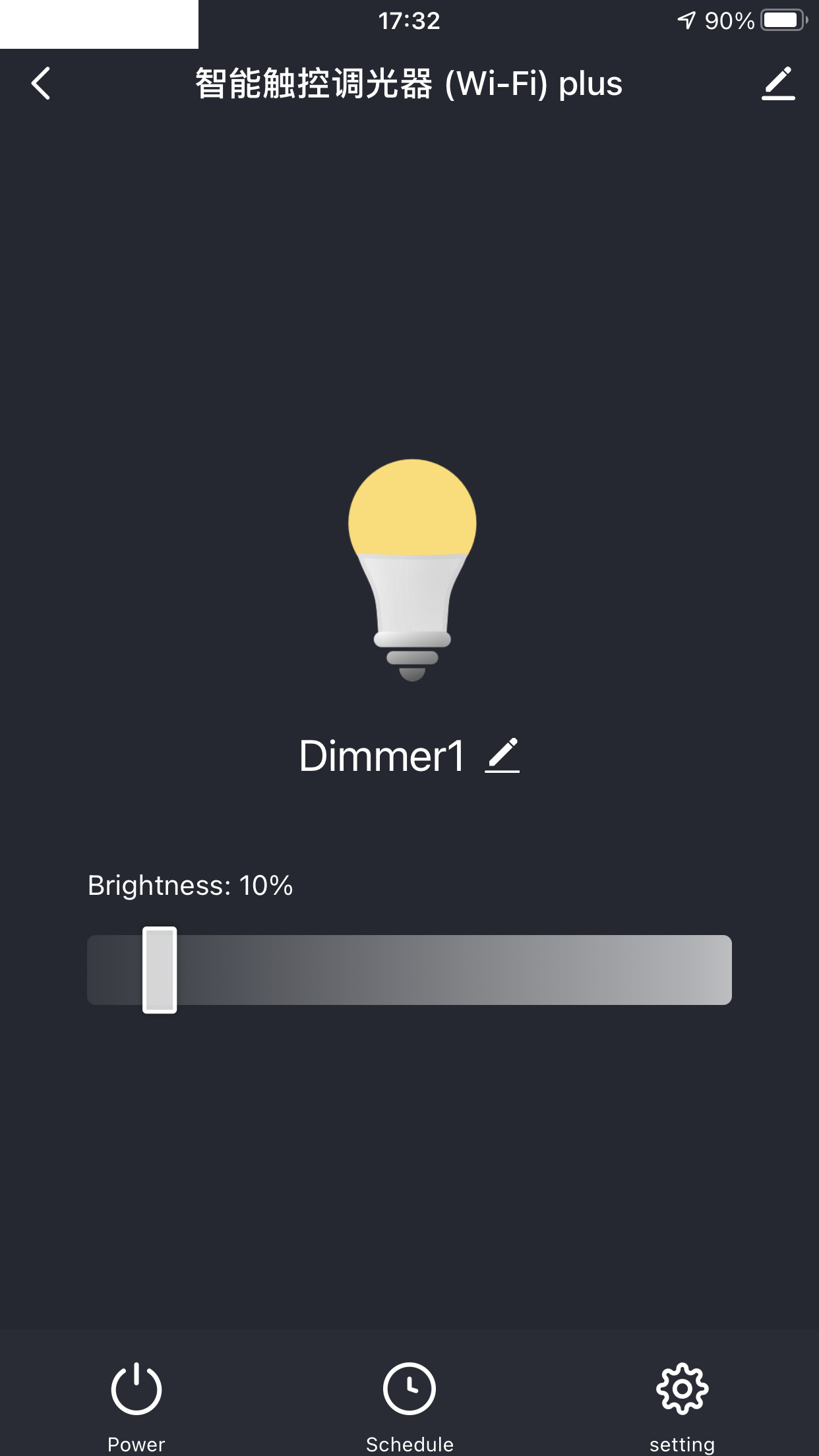

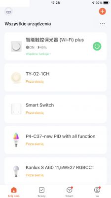

    A short test with the Tuya app
    The Tuya application has been discussed many times - here I will only show the screenshots of how this dimmer looks in it.
    Dimmer EDM-01AA-EU 300W for BK7231 and TuyaMCU - configuration Dimmer EDM-01AA-EU 300W for BK7231 and TuyaMCU - configuration Dimmer EDM-01AA-EU 300W for BK7231 and TuyaMCU - configuration Dimmer EDM-01AA-EU 300W for BK7231 and TuyaMCU - configuration Dimmer EDM-01AA-EU 300W for BK7231 and TuyaMCU - configuration Dimmer EDM-01AA-EU 300W for BK7231 and TuyaMCU - configuration Dimmer EDM-01AA-EU 300W for BK7231 and TuyaMCU - configuration
    The application also offers to change the available dimming range. It's convenient. You can "cut" too light or dark operating mode.

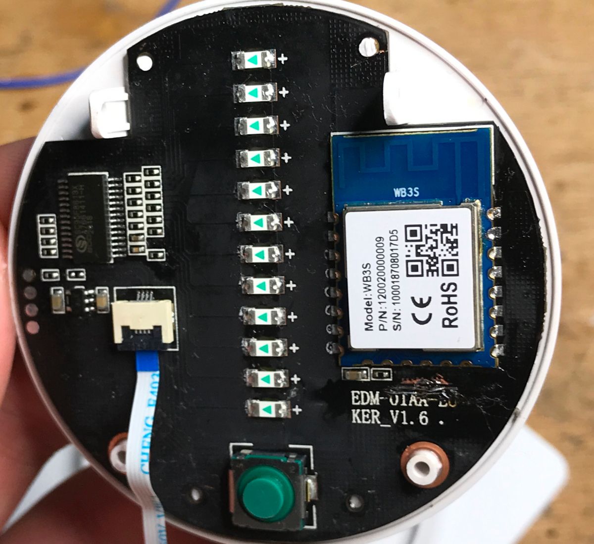

    PCB with WiFi module and TuyaMCU (TuyaMCU supports all button, and WiFi only communication). Here the WB3S - BK7231T is used.
    Image of the internal part of an electronic device with a visible circuit board and components.
    No further disassembly is needed to change the firmware. I am showing it for information only. Out of curiosity - what does the dimmer have inside?

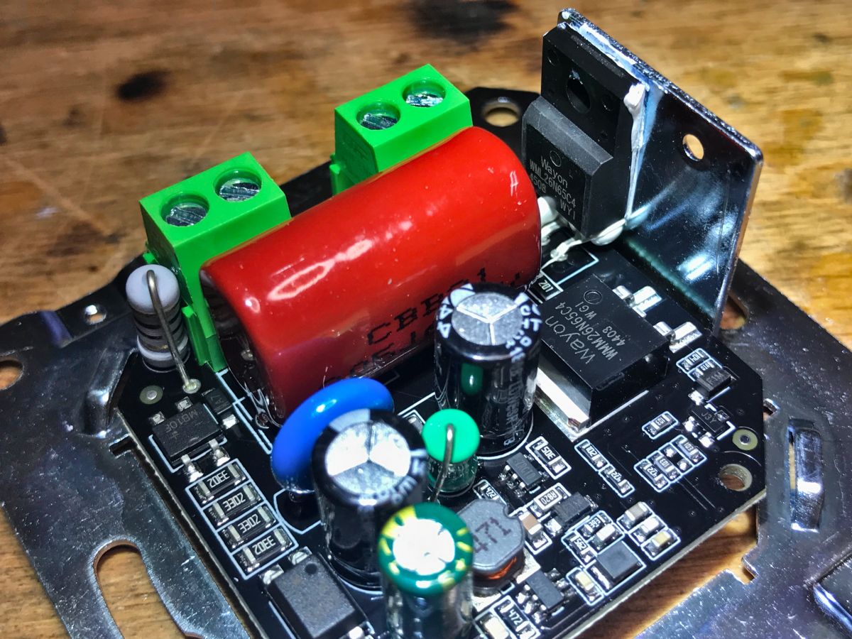

    I was expecting a triac here, but still not ...
    Semiconductors:
    - WML26N65C4 (TO-220) - N MOSFET
    - WMM26N65C4 (TO-263) - N MOSFET

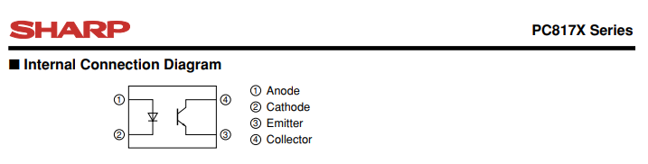

    - 817C - PC817
    - ZRCD
    - BDAG
    I did not decrypt the SMD codes of the last two elements. It's probably something from the power system. If anyone knows what these elements can be, please comment.
    I did not analyze the dimming mechanism on MOSFETs either. It's time to focus on changing the load.
