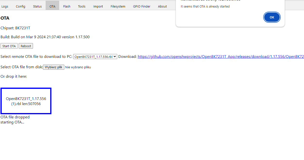

    Sorry I'm interfering your conversation, but it might be "nice to know" that double clicking OTA button while upgrading FW breaks it.
    My mouse once in a while does double click instead of one. That's how I found it out.

    @Tilator which platform? I will fix it right away.

    BK7231N was this device. Fortunately N-version. Needed just to flash by uart again.

    So, you clicked start OTA on Web App twice?

    I did click it once, but my mouse does sometimes make a double click out of it.
    "starting OTA..." appeared twice on two different lines and it never went to the end. Device became inaccessible.

    I see. Here is a fix for your issue:
    Screenshot of the OTA interface for BK7231T chipset showing an update file and a message about starting OTA.
    Please check if OTA works correctly for you now.
