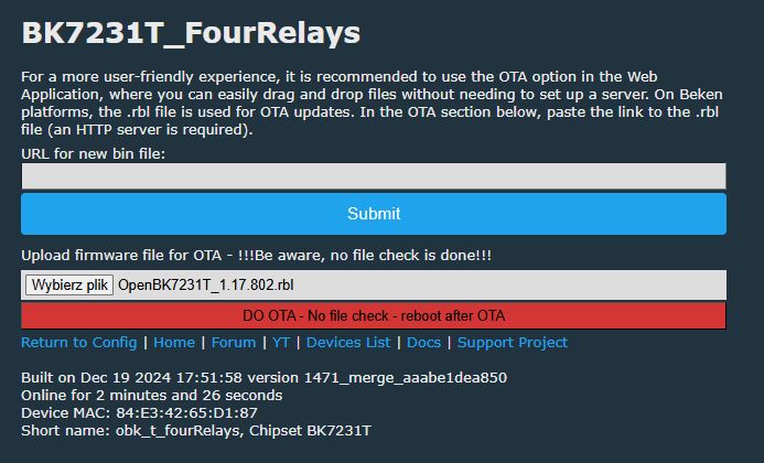

  • Some time ago I struggled over the unstable OTA with LN882H when using Firefox browser.
    If you are interested in the whole story, you can read most of it following this post:
    https://www.elektroda.com/rtvforum/topic4028087-240.html#21312889
    It turned out, there was an issue with the SDKs OTA code and, since OBK uses the OTA code slightly differently, the buffer could be filled with more data than the code expected. And accessing memory outside the allocated space is usually no good idea ;-)
    It took me several days to find the culprit and so I spent quite some time looking to the OTA code.
    Since I also made basic tests to verify the operation, I learned it's "only" sending an HTTP POST request to the according page of the device.
    And this led to the question, if you always need the (very useful) Web App, "only" to do an update?
    O.k, you may ask, why not? I often use a single connection to the device with no internet, so in order to use the App, you need to "host" it locally (e.g. with a docker installation).

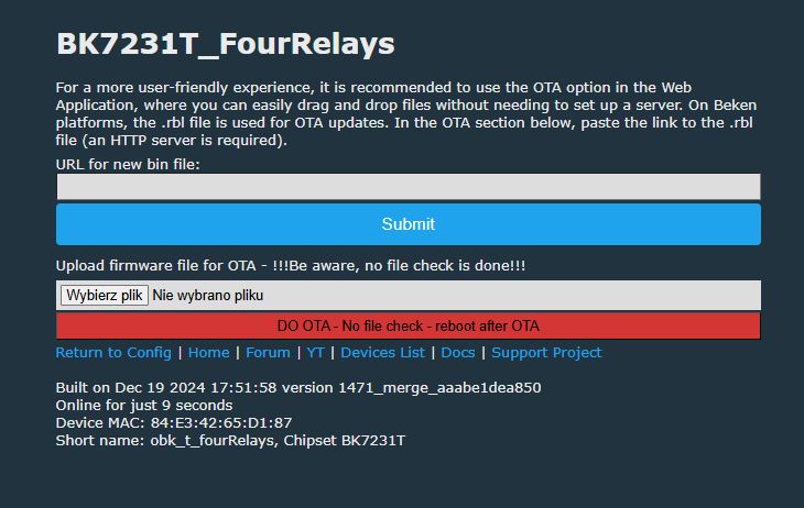

    Since newer Browsers all support "fetch()", I could do a simple addition to the OTA page to upload the firmware.
    <p>Upload firmware file for OTA - !!!Be aware, no file check is done!!!<p>
    <input id='otafile' type='file'> <input type='button' class='bred' onclick='doota();' value='DO OTA - No file check - reboot after OTA'>
    <script>
    function doota(){
       var input = document.getElementById('otafile');
       if (input.files[0]){
          fetch('/api/ota', {
             method: 'POST',
             body: input.files[0]}
          ).then((resp) => {
             if(resp.ok){
                console.log('ota successfull; rebooting');
                fetch('/index?restart=1');
             else console.log('ota not successfull');
       else alert('no file selected')
    </script>
    It's not so comfortable like using drag and drop in the App, there is no check for the file provided - but in the end it provides a very simple solution.
    For now I could only test on the devices I own: LN882H, BK7231N, ESP32 and W800 (I added OTA for W800 while at it ;-).
    Test for other platforms would be great.
    The actual pull request is here:
    https://github.com/openshwprojects/OpenBK7231T_App/pull/1471
    Seeing it in action on a W800
    PS: Since W800 code seems to have a simmilar problem like the LN882H code which needed some changes, I'm quite sure, this will be also an issue with W600. But since I don't own one, I didn't made changes here.

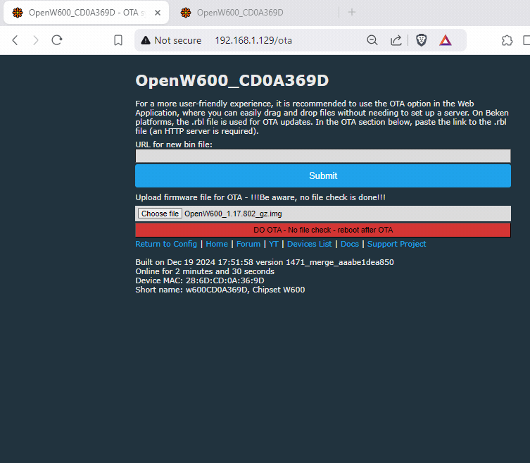

    W600
    OpenW600 user interface for OTA file updates.

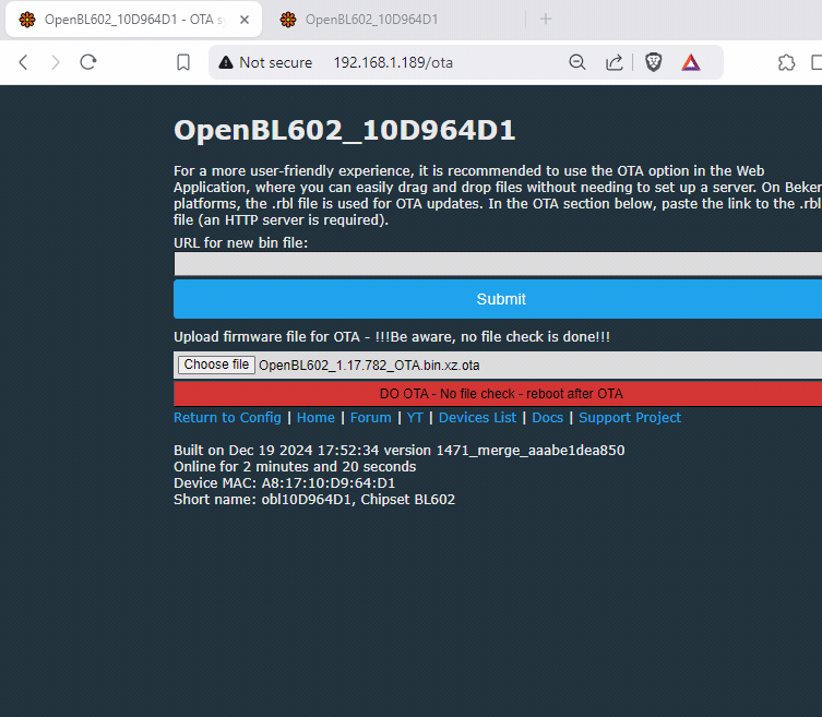

    Added after 10 [minutes]:
    OpenBL602 website for OTA firmware update.

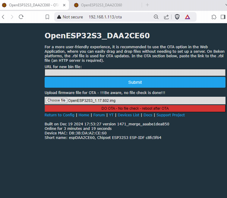

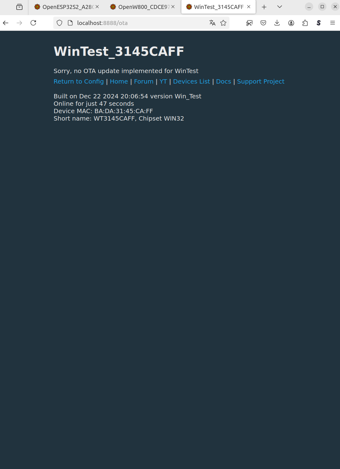

    Added after 15 [minutes]:
    Screenshot of the OpenESP32S3_DAA2CE60 webpage for OTA updates.

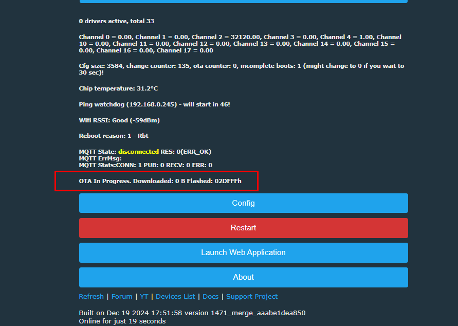

    I guess my main feedback is the obvious bits already mentioned, of course bearing in mind it is a WIP
    -ota file sanity check
    -ota file extension filter on open dialog box - eg *.rbl, *.bin.xz
    -no feedback about submission/start
    -no obvious progress (in the case of Beken flash address feedback)

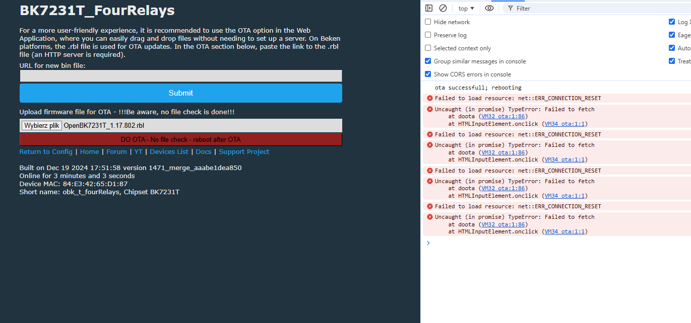

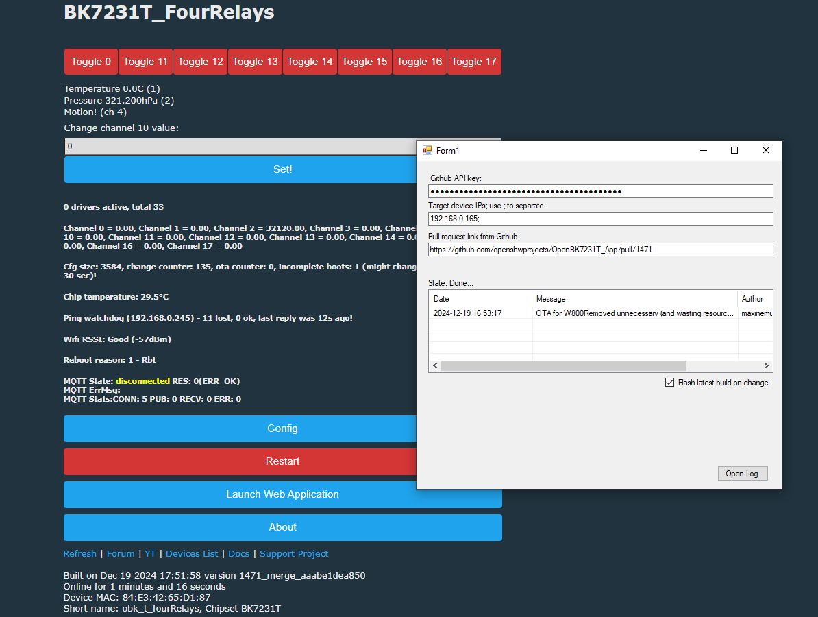

    Generally though, I did recently wonder about a small note in the web app OTA tab about OTA not being for XR809 and now TR6260. And now that would apply to this new feature.
    Added after 11 [minutes]:

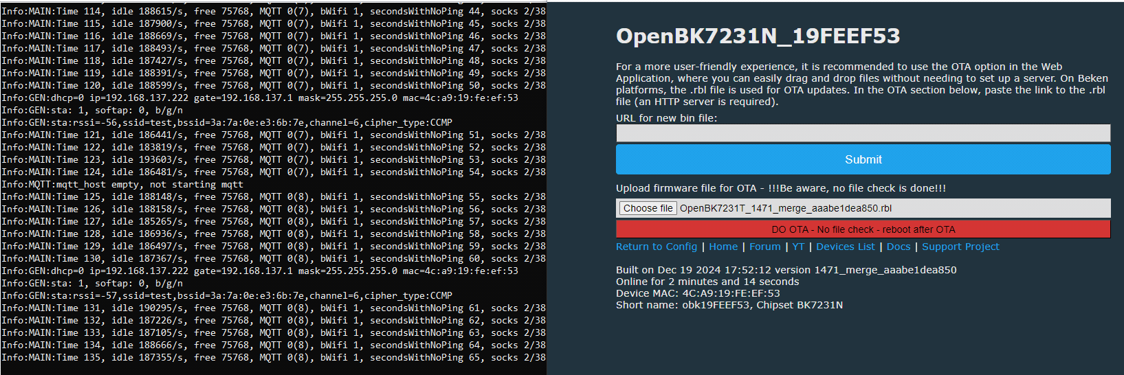

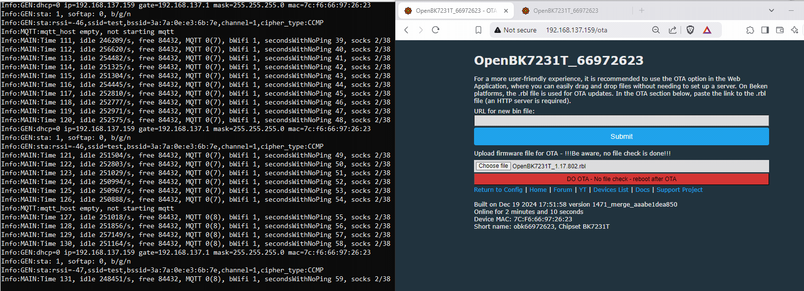

    here's BK-N ->T brick, just cos I wanted to see it.
    OTA update interface for OpenBK7231N device with connection logs and system information.

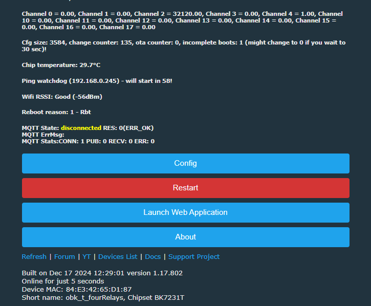

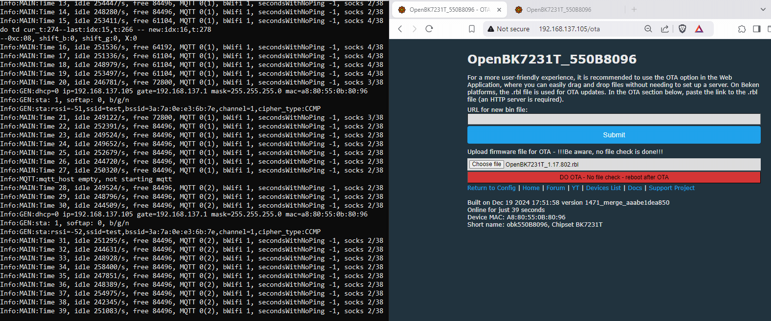

    Back to main testing. There's a problem with BK-T OTA
    Screenshot of the console logs and OpenBK7231T web interface.
    Flashed back to Tuya factory from 0x11000-200000 after that and started again. Same.

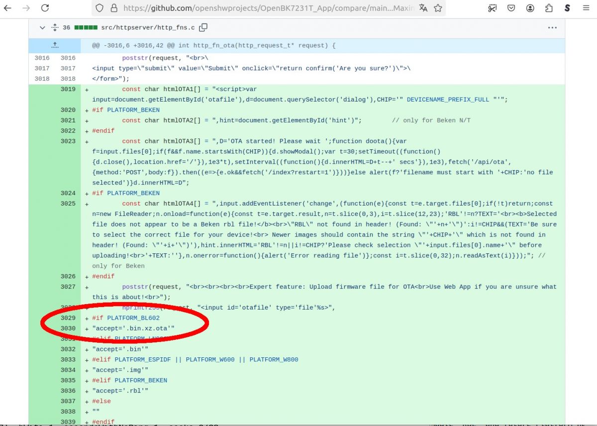

  • Suggests changing OTA header name to platform for testing
    #9 21355867
    max4elektroda
    Posts: 758
    Help: 49
    Rate: 189
    Sure, there is much room for improvement ;-)

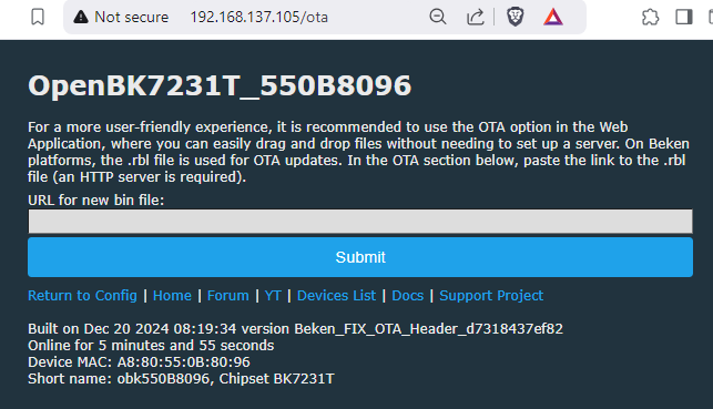

    First thing will be a simple accept=".<OTA extension>" based on the platform.
    Regarding N/T discussion @p.kaczmarek2 : Do you recall any reason for setting the "partname" in the OTA files to "app" instead of the platform?
    It seems this code is correct: https://github.com/tiancj/rtt_ota_tools/blob/...3a9877f3bef25a1df2a0de352857/ota_tools.c#L33:
    struct rt_ota_rbl_hdr {
       char     magic[4];      // 0x0
       uint32_t algo;      // 0x4
       uint32_t timestamp; // 0x8
       char     name[16];      // 0xc
       char     version[24];   // 0x1c
       char     sn[24];      // 0x34
       uint32_t crc32;      // 0x4c
       uint32_t hash;      // 0x50
       uint32_t size_raw;   // 0x54
       uint32_t size_package; // 0x58
       uint32_t info_crc32; // 0x5c
    If we changed at least "name" to the real platform, I think we could do a simlpe test for this case.

    Tried to change this in https://github.com/MaxineMuster/OpenBK7231T_App/tree/Beken_FIX_OTA_Header
    with the branch (Artifacts from here: https://github.com/MaxineMuster/OpenBK7231T_App/actions/runs/12427880330 ):

    Maybe my testing super hero @divadiow could test if the artifacts whith the "tuned" header work as OTA for Beken N and T as expected?
  • OTA works only after repeated attempts
    #12 21355884
    Posts: 14756
    Rate: 12881
    @max4elektroda It's Beken leftover, we can change it if it helps
    @divadiow
    Screenshot of the user interface for BK7231T device settings and Form1 application window.
    Screenshot of the firmware update interface for BK7231T_FourRelays.
    I click on button and nothing happens, is this the mentioned "lack of feedback"?
    Screenshot of OTA update interface for BK7231T_FourRelays with console errors.
    Uh, I did it several times, device rebooted on old firmware:
    Screenshot of BK7231T_FourRelays web interface with OTA options.
    Ah I see, it works, but without a feedback.
    We need to put that OTA message on EVERY page, not just index:
    Device user interface with restart button.
    Nice, it worked, but on like third attempt?
    Screenshot of an interface displaying device information and action buttons.
    So it breaks T for you @divadiow but works for me?
    yes
    did you just need to wait longer and first attempt would have flashed OK?
    oh! interesting. I could try with another T real device I guess, I only have one T module loose. Or maybe I blow the T flash away with an SPI restore in case there's something odd about my BL.
    bitbang erased and reflashed a Tuya T factory. Now OTAs fine, so false alarm.
    Screenshot showing console logs and OpenBK7231T web interface with OTA options.
    That app partition error is interesting, I've never seen it before. And it happens with the web gui OTA.

    should PR Beken_FIX_OTA_Header_d7318437ef82 have the new OTA feature?
    Web page showing OTA update option for OpenBK7231T.
  • #19 21356373
    max4elektroda
    Posts: 758
    Help: 49
    Rate: 189
    Nope, this was just to alter the variables in the rbl header of Beken N/T devices.
    This way it's easy to distinguish between the images.
    Thanks for testing, looks like this doesn't break the images, that are good news!

    @divadiow can you please tell me, which OTA file is used for BL602? There are several files with "ota" in filename.
    (I didn't get my own devices, the first time for me ali insisting they delivered an item I never received :-()
    #21 21357691
    Posts: 5213
    Help: 446
    Rate: 914
    Yes. .bin.xz.ota
  • #22 21357701
    max4elektroda
    Posts: 758
    Help: 49
    Rate: 189
    So my guess was o.k.:
    Screenshot of a code fragment from GitHub regarding the #if PLATFORM_BL602 condition, highlighted with a red ellipse.

    I changed the file checks. Now you will
    1. get a hint, if selected file doesn't match the given "template"
    2. can't upload a file not matching.
    Two examples with W800 and ESP32S2:
    Added after 16 [minutes]:
    Screenshot of a webpage displaying information about WinTest_3145CAFF.
