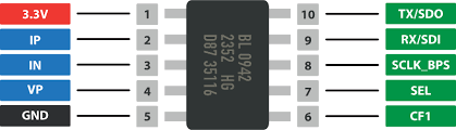

    Posts: 14770
    Rate: 12913
    I don't think that AI can help here much. The device described in topic is TuyaMCU. If you want faster readings, then remove MCU and connect to BL0942 directly.
    Pinout diagram of BL0942 IC showing pins such as 3.3V, GND, TX/RX, SEL, and CF1
    You will need to route UART, probably you will need to use BPS to select baud, and you will need to disconnect SEL. SEL is:
     UART/SPI mode selection (0: UART 1: SPI), internal pull-down resistance,
    connected to GND is 0 level (UART), connected directly to VDD is high level (SPI
    SEL has internall pull-down, so it's 0 (UART) by default unless connected externally.
