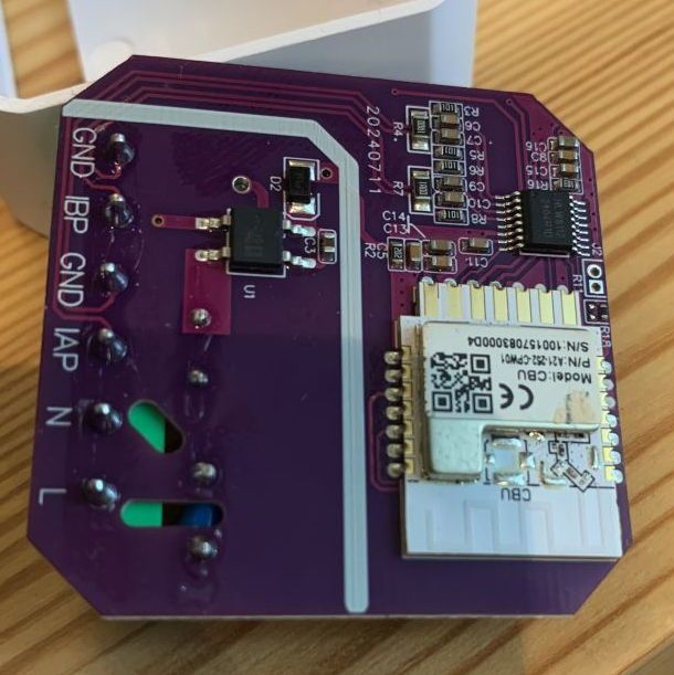

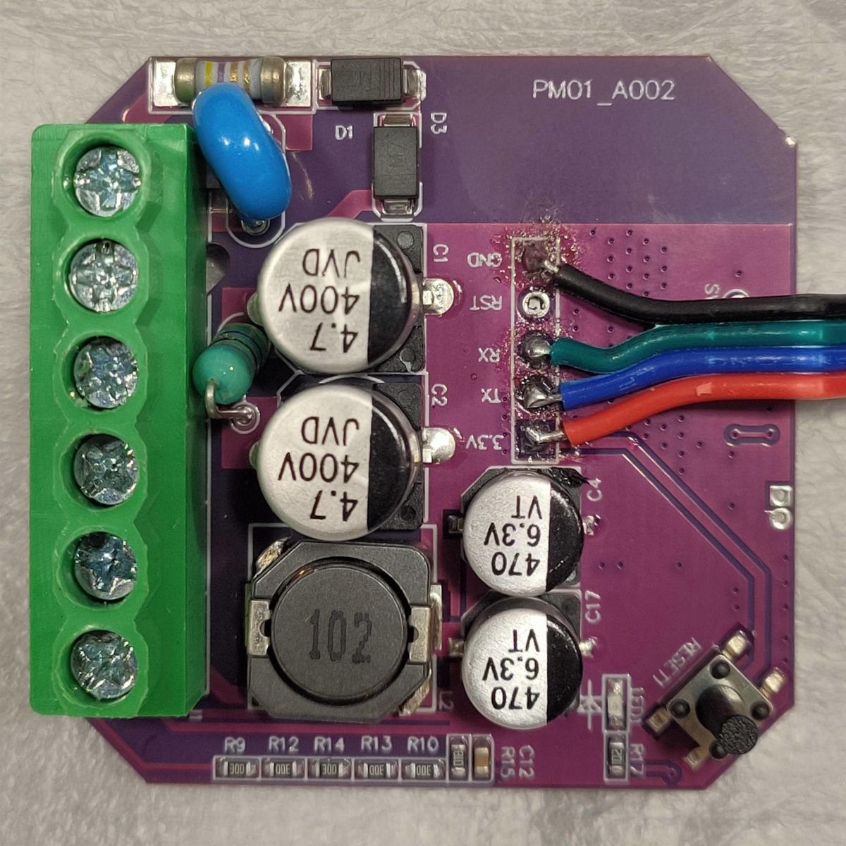

    The device I'll cover in this thread is the following:
    Tuya WiFi Energy Meter PM01_A002 [CBU][BK7231N] HLW8112 SPI Power Reading Ratio 1:5?   Tuya WiFi Energy Meter PM01_A002 [CBU][BK7231N] HLW8112 SPI Power Reading Ratio 1:5?    Tuya WiFi Energy Meter PM01_A002 [CBU][BK7231N] HLW8112 SPI Power Reading Ratio 1:5?
    Bough from Aliexpress: https://it.aliexpress.com/item/1005007292927857.html
    What are my findings:
    - HLW8112 (https://redmine.laas.fr/attachments/download/3444/DS_HLW8110_HLW8112_EN_Rev1.01%20.pdf)
    - Unstable firmware (at least in my device)
    - Power MeterIC connected directly to CBU module via SPI (NO TuyaMCU)
    - Backup and restore firmware causes wrong measurement, but subsequently I discovered that all power values are reported in a ratio 1:5
    By reading the posts from the other thread I concluded that there is no way to use TuyaMCU driver because the Power Meter IC
    is directly connected to the Tuya module via SPI.
    In fact @dicamarques made an attempt to write a driver for it (21221637#21221637), but, at least with my device,
    by compiling the code he wrote from his GitHub repo, I was unable to get SPI working.
    Furthermore Dicamarques and other guys posted a lot of useful informations:
    - a schematc where you can see that P9 is used for "SCSN"  instead of the standard P15.
    - links where very complete and presumably working drivers can be found
    Subsequently I wanted to try to write my own driver...
    Spoiler :( I wrote a lot of code, half of it, copy/pasted from the full driver source from the link above, but with no luck... the SPI still not send or receive data.
    This i the link to my repo, in case someone more experienced can tell me what I'm doing wrong :) https://github.com/kaleidoscopeit/OpenBK7231T_App_HLW8112
    (--> To start the driver, issue "startDriver HLW8112SPI" in the command field of the log console in the Web Application)
    It could be that I'm doing something crazy, like buying a logic analyzer and connect it to the SPI in order to understand what goin on when
    the original Tuya firmware speaks with the Power Meter IC.

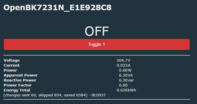

    1810_merge_183015c253a3
    driver starts and readings are showing as before
    OpenBK7231N interface screen with electrical energy measurement data

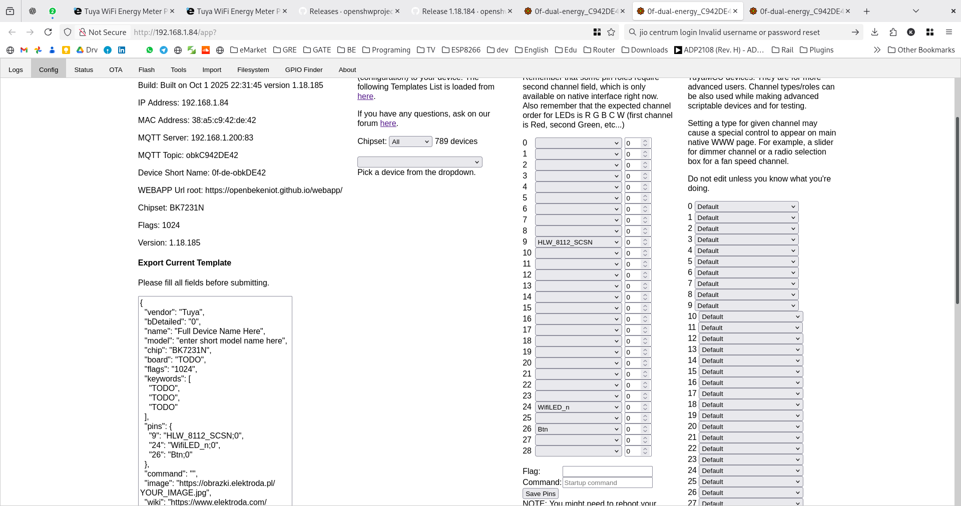

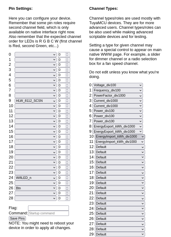

    trying https://www.elektroda.com/rtvforum/topic4130528.html#21694008
    Script execution log:
    Send started... send 0/9... send 1/9... send 2/9... send 3/9... send 4/9... send 5/9... send 6/9... send 7/9... send 8/9... Send done! Please restart device if needed.
      "pins": {
        "9": "HLW_8112_SCSN;0",
        "24": "WifiLED_n;0",
        "26": "Btn;0"0
    still not working ....

    I don't think this driver is enabled by default on the public build. You need to enable it in obk_config.h. If you do startDriver for it, does it even start? I don't think so - it's not in the build.

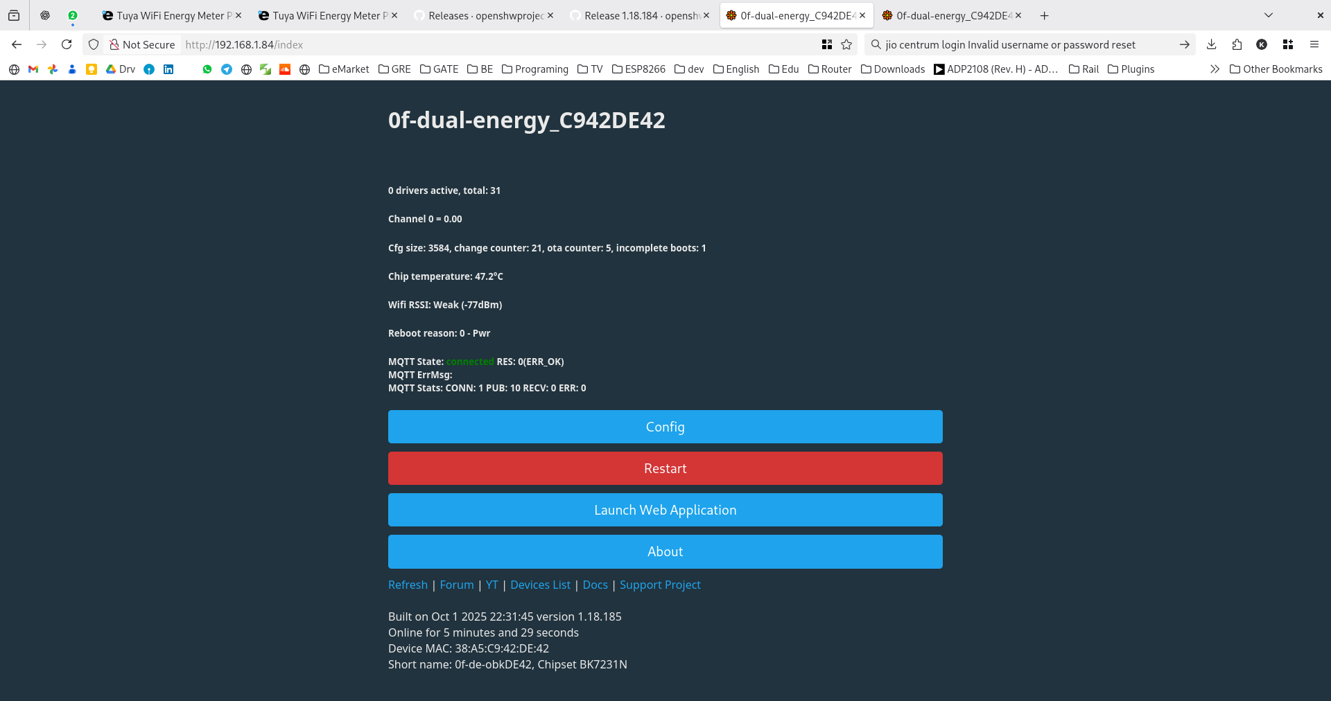

    Level 4  
    Posts: 7
    Built on Oct 1 2025 22:32:02 version 1.18.185_powerMetering
    Online for just 25 seconds
    Device MAC: 38:A5:C9:42:DE:42
    Short name: 0f-de-obkDE42, Chipset BK7231N
    this one also not worked
    ref:
    https://github.com/openshwprojects/OpenBK7231T_App/releases

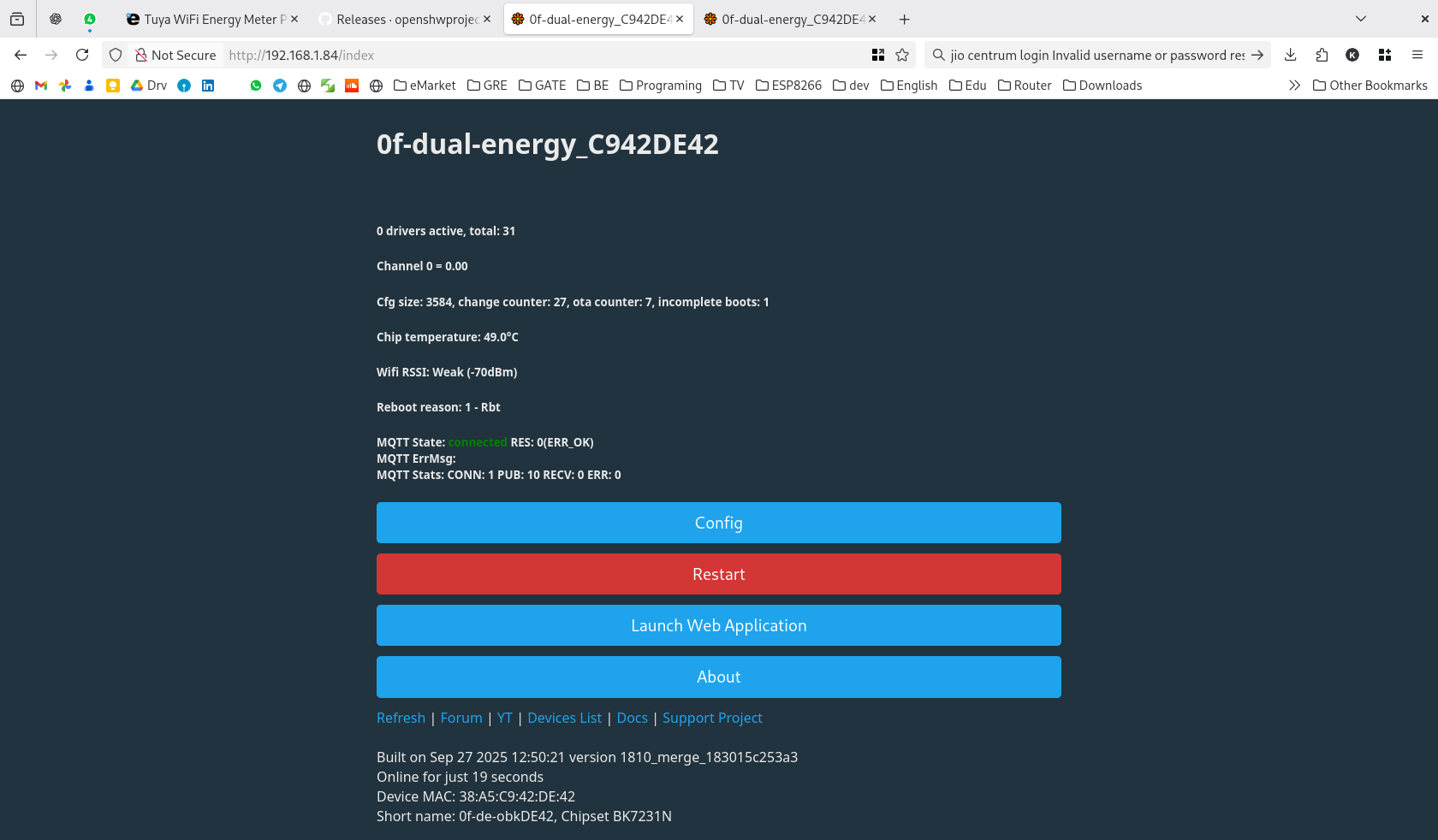

    >>21707699 let me check it has rbl
    Added after 3 [minutes]:
    Control panel for device 0f-dual-energy showing system info and configuration options
    Built on Sep 27 2025 12:50:21 version 1810_merge_183015c253a3
    Online for 1 minutes and 9 seconds
    no power output? why?

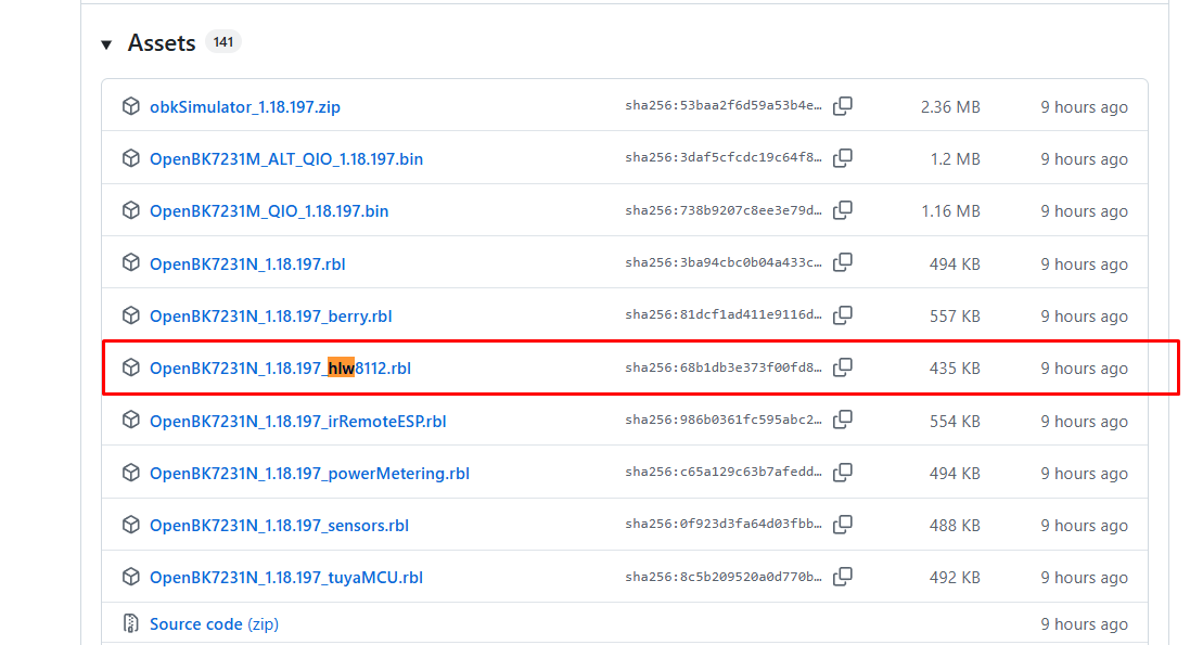

    • OpenBK7231T_App_1819_merge_d995f6df842d_OpenBK7231N_hlw8112.zip (2.74 MB) You must be logged in to download this attachment.
  • Use firmware with built-in HLW8112 driver
    #21 21707751
    feiltom
    you need to take a firmware with the driver built-in, it is not the case by default
    this build has the driver enabled : https://github.com/netmaxt3r/OpenBK7231T_App/actions/runs/18059811136/job/51394535502
    the firmware build is this one : https://github.com/netmaxt3r/OpenBK7231T_App/actions/runs/18059811136/artifacts/4121996251
    which way you use to flash ?
    with serial way it's OpenBK7231N_UA_hlw8112_6ae422624810.bin ( in zip )

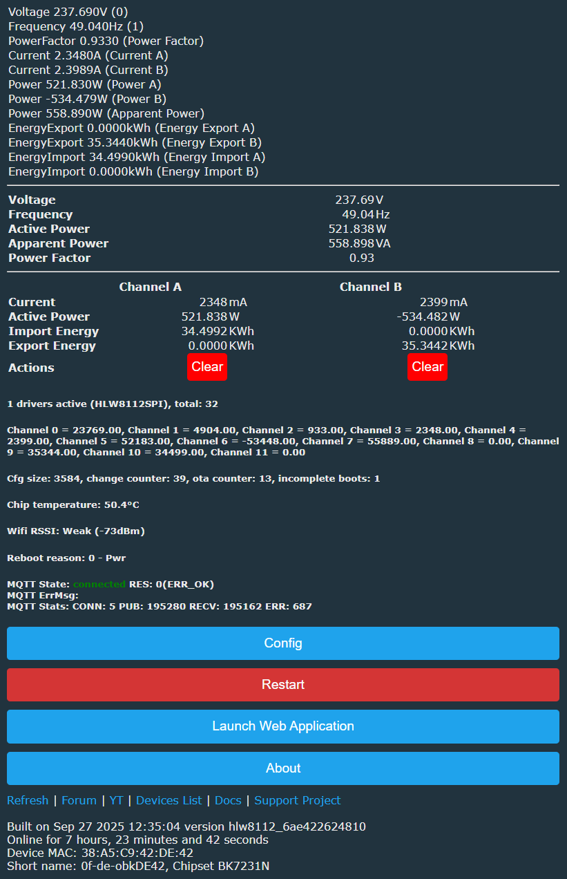

    Added after 7 [minutes]:
    >>21707751
    This one worked
    Built on Sep 27 2025 12:35:04 version hlw8112_6ae422624810
    Online for 1 minute and 3 seconds
  • #23 21707776

    here's how it looks (both sensors are clipped to the same wire):
    Interface showing measurement data from two energy sensor channels

    Is there a fully working OpenBeken firmware for the Tuya power meter with HLW8112 (BK7231N)? I have been reading but I’m still not completely sure if there is already a fully working OpenBeken firmware that supports it. If there is a working firmware already, where can I download it?
    Thanks a lot for your help
  • #27 21723280
    Posts: 14770
    Rate: 12913
  • #28 21723285
    1977ferrer
    Thank you. I use a bk7231guiflashtool-v130 but the .rbl file is not accepted. How I have flash this firmware?
  • #29 21723306
    Posts: 14770
    Rate: 12913
    BK7231 Easy GUI Flasher requires QIO, however, you can just flash stock OBK qio as well and then do OTA to RBL. Maybe it's easier.
  • #30 21725924
    1977ferrer
    >>21723306
    Ok. thank you very much. it work fine.

Is there a working OpenBeken firmware for Tuya PM01_A002 (HLW8112, BK7231N)?
Yes. Users report success with HLW8112-enabled OpenBK builds (e.g., OpenBK7231N_1.18.206_hlw8112.rbl) on PM01_A002‑like devices. [Elektroda, dweimena, post #21736669]
Why do I get “Driver HLW8112SPI is not known in this build”?
Because public builds don’t ship the HLW8112 driver enabled. Rebuild with ENABLE_DRIVER_HLW8112SPI in obk_config.h or flash a driver‑enabled image. “You need to enable it in obk_config.h.” [Elektroda, p.kaczmarek2, post #21707538]
Which pins do I set for HLW8112 on this Tuya board?
Set chip‑select SCSN to P9. Example template used: P9=HLW_8112_SCSN; P24=WifiLED_n; P26=Btn. Then start the driver. [Elektroda, maxters007, post #21694008]
How do I flash an .rbl if my GUI flasher rejects it?
Flash a stock OpenBK QIO image first with your GUI tool, then perform OTA to the .rbl from the OpenBeken Web UI. [Elektroda, p.kaczmarek2, post #21723306]
How can I test quickly with a driver‑enabled build?
Flash a community HLW8112-enabled artifact (e.g., hlw8112_6ae422624810). Users confirmed it starts and shows data. [Elektroda, kdm6389, post #21707769]
HLW8112 roles or commands fail as “Invalid command.” What does that mean?
Your firmware lacks the HLW8112 role/driver, so role or startDriver calls fail. Flash a build with the driver enabled. [Elektroda, p.kaczmarek2, post #21707538]
How do I set up HLW8112 on OpenBeken (quick 3‑step)?
  1. Flash an HLW8112-enabled build (or rebuild with ENABLE_DRIVER_HLW8112SPI).
  2. Set P9 to HLW_8112_SCSN; add LED/Button pins if needed.
  3. Run: startDriver HLW8112SPI, then verify voltage/current/power A/B. [Elektroda, maxters007, post #21694008]
