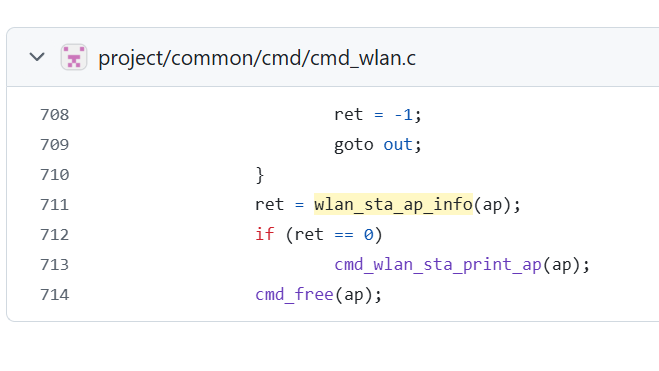

    Well, but no problems on other platforms?
    I guess I will merge it as is.
    wait a sec, wlan_sta_ap_info should return 0
    Added after 16 [seconds]:
    Enhancing OBK Status Page with WiFi Details for OpenBeken Devices
    Added after 13 [minutes]:
    added fixes

    XR809 1689_merge_444d39530925
    this is the expected mac for bssid

    I see.,... so, are you saying it's ready and safe to be merged?
    #64 21603311
    Posts: 5188
    Help: 445
    Rate: 912
    not sure if I'm the one to make that call. I've done:
    BL602
    LN882H
    BK7231N
    ESP32
    W600
    W800
    BK7238
    ECR6600
    BK7231T
    RTL8720CF
    XR809
    #65 21603333
    Posts: 14728
    Rate: 12814
    Well, considering the fact that I added BSSID cache within safeMode == 0 block, then I would say that this testing was enough to merge it. In worst case, users can still recover their devices...
    Merged.
