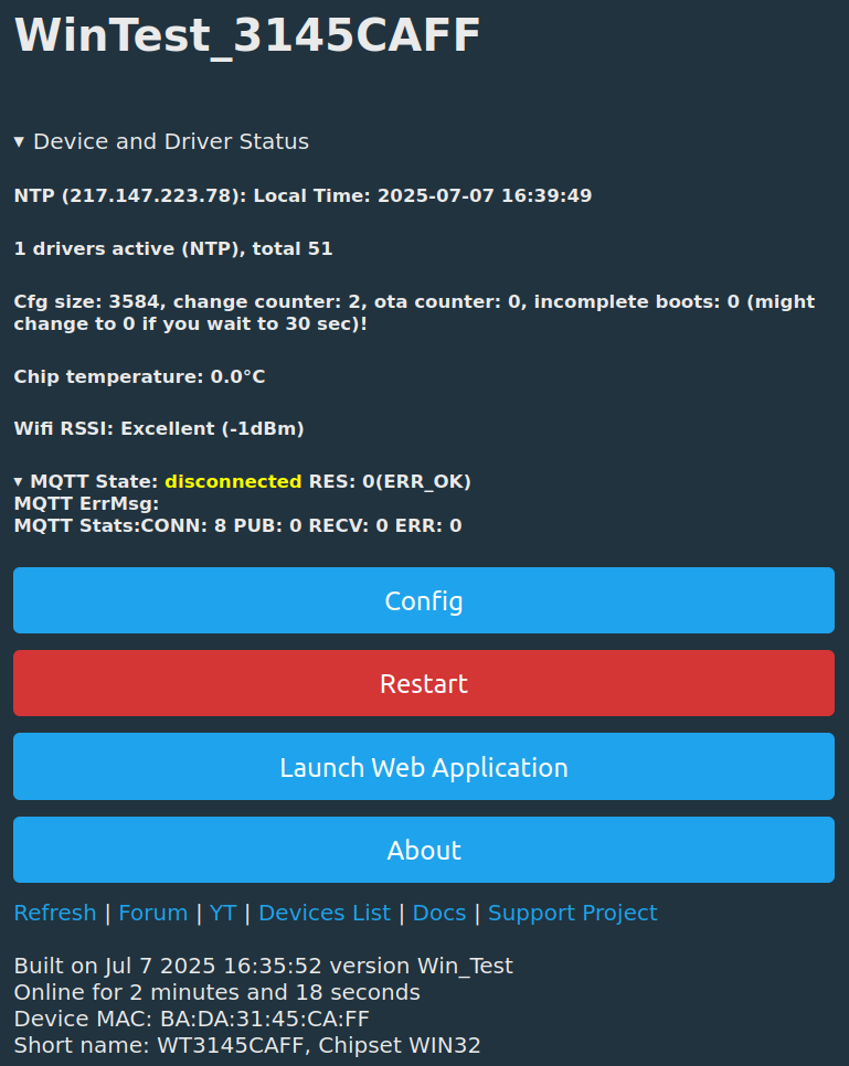

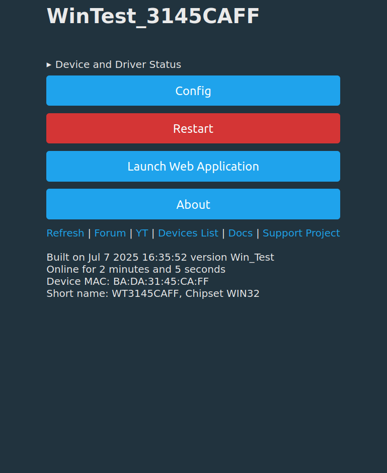

  • Using details elements to collapse status output
    #38 21600019
    max4elektroda
    Posts: 758
    Help: 49
    Rate: 189
    Just as a discussion point on what I think we could use to possibly simplify main page.
    No PR, yet, just a first simple branch to check possibilities https://github.com/MaxineMuster/OpenBK7231T_App/tree/GUIstatus01 .
    Basic idea is to use <details>/<summary> elements.
    So you can collapse output if you don't actually need it.
    Main challenge was to keep track of which parts are opened and keep the state over the updates every second.
    Just to illustrate the possibilities:
    Main Page, MQTT only one line:

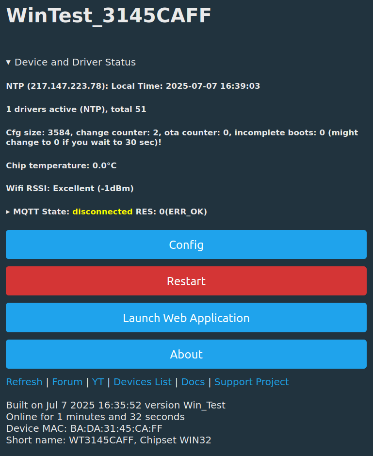

    Enhancing OBK Status Page with WiFi Details for OpenBeken Devices
    Main Page, MQTT with full output:
    Main Page, no stats at all:
    We can also group output, to "hide" multiple lines.
    The solution to keep track of the state of the <details> element might come useful for other cases:
    The state is not loaded to "state"-div directly, but into a hidden div "t_state". Then we scan all details of the actual "state" and "copy" the open-state to the corresponding elements in "t_state". Only after this we assign the content to "state" to avoid flickering.
    Not totally sure, but we maybe can also use this to remove the special handling for "charts"-driver (we a "flickering issue" from the regular updates here, too, and it was solved by moving the canvas below the "state" div).

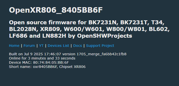

    The About page is a bit sad

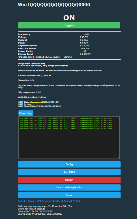

  • HTTP override keeps hardcoded status div intact
    #43 21602377
    Posts: 14728
    Rate: 12814

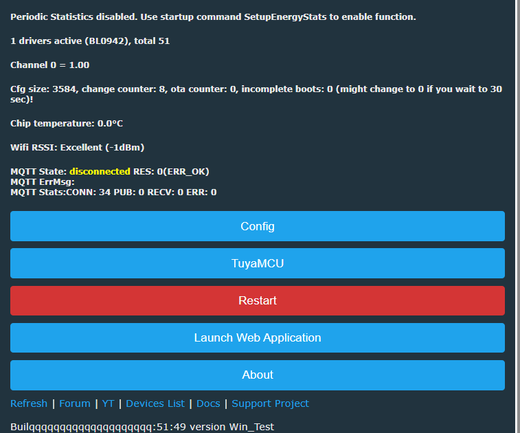

    With current ENABLE_HTTP_OVERRIDE, this code in index.html in LFS can replace main page but keep hardcoded state div:
    Code: HTML, XML
    I think I could make this more dynamic with REST interface...
    This way I can easily add buttons:
    Added after 6 [minutes]:
    Look, I can even integrate logs into main page now:
    Code: HTML, XML
    Added after 14 [minutes]:
    This will try to fetch from Tasmota API:
    Code: HTML, XML

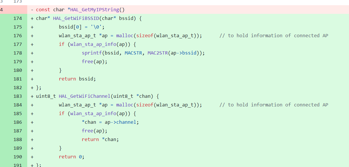

  • RTL8720D supports WiFi status fields, XR872 does not
    #52 21602660
    insmod
    Posts: 1430
    Help: 168
    Rate: 453
    Works on RTL8720D
    {"Time":"1970-01-01T00:00:00","Uptime":"0T00:01:56","UptimeSec":116,"Heap":120,"SleepMode":"None","Sleep":0,"LoadAvg":99,"MqttCount":23,"POWER":"ON","Wifi":{"AP":1,"SSId":"xxxx","BSSId":"xx:d1:27:xx:xx:xx","Channel":13,"Mode":"11n","RSSI":58,"Signal":-71,"LinkCount":21,"Downtime":"0T06:13:34"}}
    Added after 4 [minutes]:
    Doesn't on XR872
    {"Time":"1970-01-01T00:00:00","Uptime":"0T00:00:34","UptimeSec":34,"Heap":237,"SleepMode":"None","Sleep":0,"LoadAvg":99,"MqttCount":23,"POWER":"ON","Wifi":{"AP":1,"SSId":"xxxx","BSSId":"","Channel":12,"Mode":"11n","RSSI":64,"Signal":-68,"LinkCount":21,"Downtime":"0T06:13:34"}}
  • #53 21602667
    Posts: 5188
    Help: 445
    Rate: 912
    XR809 - 1689_merge_20588744531c

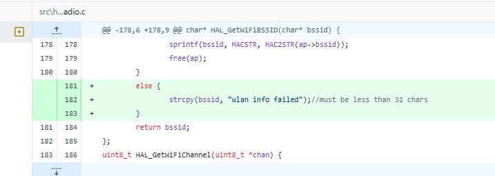

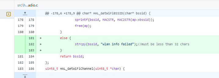

  • #55 21602758
    Posts: 14728
    Rate: 12814
    Not on XR? Interesting, I assumed hal_wifi_xradio.c is for that purpose?
    Unless... that would mean that wlan_sta_ap_info fails, maybe we can debug that.

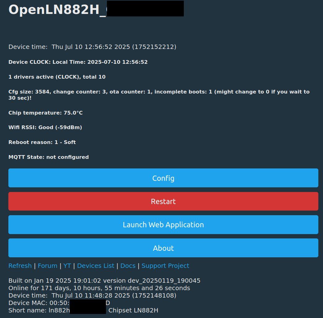

    JSON output is also missing some correct time statements.
    Maybe this is my chance to ask for a review of PR#1623?
    Its out of sync, but since @p.kaczmarek2 and @insmod are adding new platforms and features so often, I can't keep track of this in all PRs ;-)
    I think it's mainly the new make system causing conflicts, but if you are willing to take a look, I will update it.
    Maybe a short summary of the ideas:
    Separate NTP and other time related functions, in order to allow other time sources.
    Switch from g_ntptime as "master" of the time to g_epochOnStartup to store, as the name suggests, the time at device startup.
    So actual time is (g_epochOnStartup + g_secondsElapsed). And since the latter is handled by the system anyway, we have a "clock" by only setting the startup time once.
    When using as a clock, g_secondsElapsed is not very accurate, it's some time I did the first tests, but it was about 2 minutes off - I'm not sure, but I think this was per week.
    On the other hand: It's (almost) "for free", the clock can be easily set e.g. by small JS-code or with a command and g_secondsElapsed is inceased every second.
    And we can enhance g_secondsElapsed if we sync it to systems xticks from time to time. I have a LN882H system running now for half a year (171 days, 10 hours ...) without adjusting the clock, the time is off approximately 7 minutes (I didn't set summertime, so it's running in UTC+1 while my PC uses DST):
    wget -q -O - "http://192.168.0.24" | grep -o  "Device CLOCK[^<]*" && date
    Device CLOCK: Local Time: 2025-07-10 12:33:19
    Do 10. Jul 13:27:42 CEST 2025
    Not suitable to drive a nuclear plant, but o.k. for basic functions, especially if synced from time to time.
    If you would give it a look, I think we should "revive" the old thread here to discuss this "feature":

    Added after 12 [minutes]:
    I think we could also set this "error message" in advance (instead of bssid[0] = '\0 ; )

    Ok, can anyone check XR BSSID now? Does it indicate that wlan_sta_ap_info is falling?
  • XR BSSID appears incorrect in 1.18.134
    #58 21603163
    Posts: 5188
    Help: 445
    Rate: 912
    with 1.18.134?
    bssid is not ccorrect

    missed the new build. k
    1689_merge_820b2000dbac
