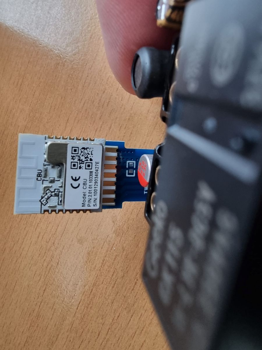

    Chip Model: CBU

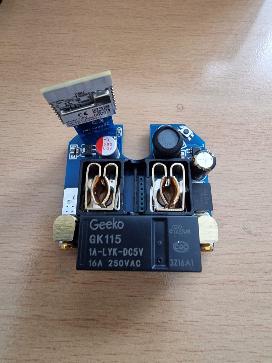

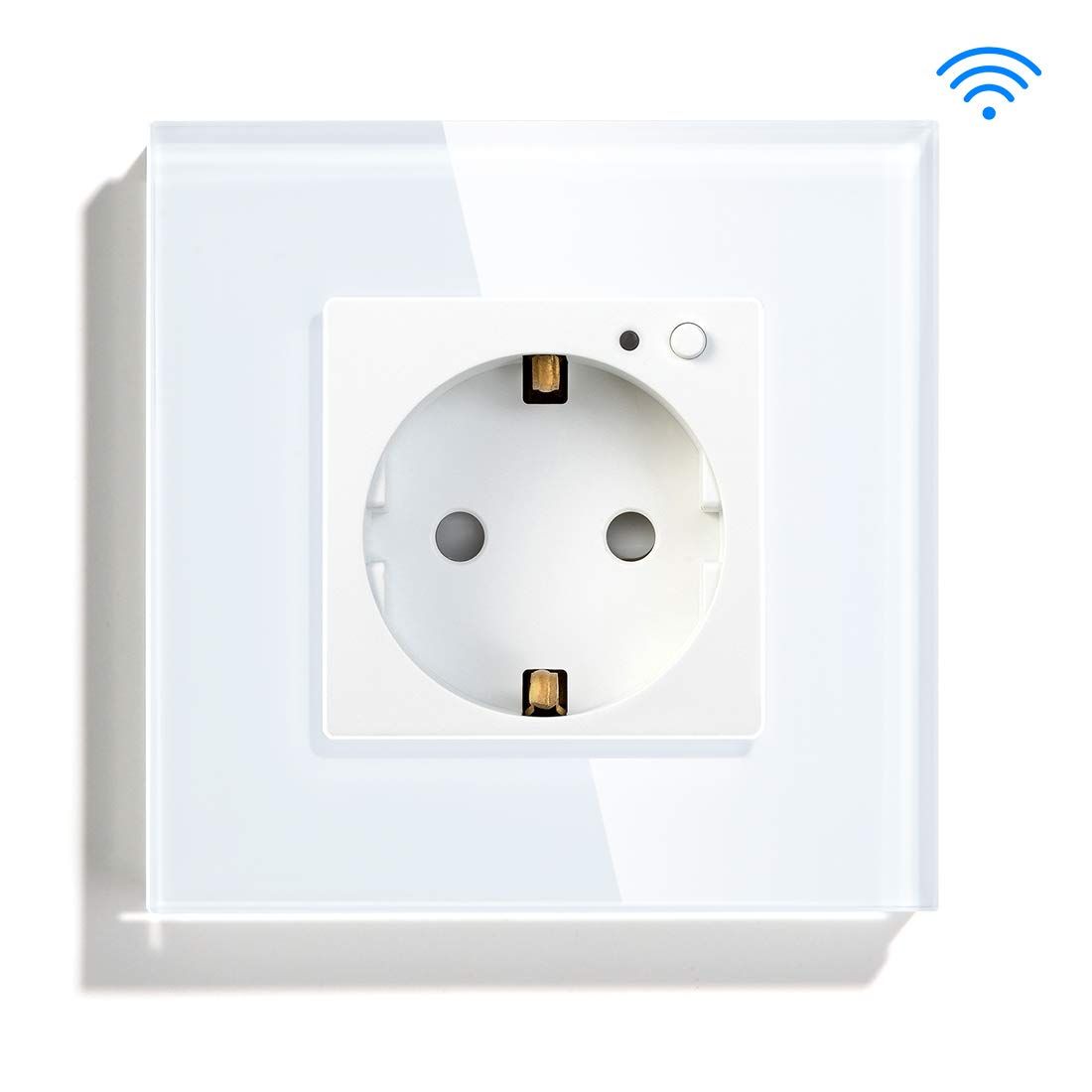

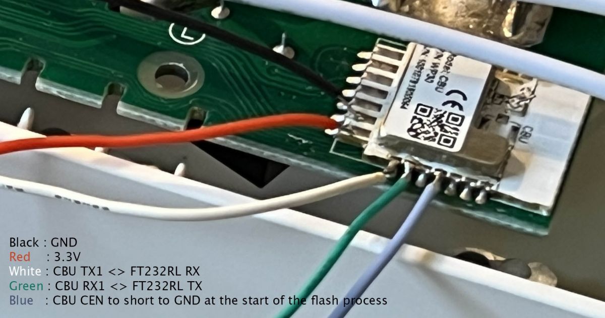

    BSEED smart wall socket with WiFi and BK7231N chip.BSEED Smart Socket circuit board with wire connections to the CBU processor.

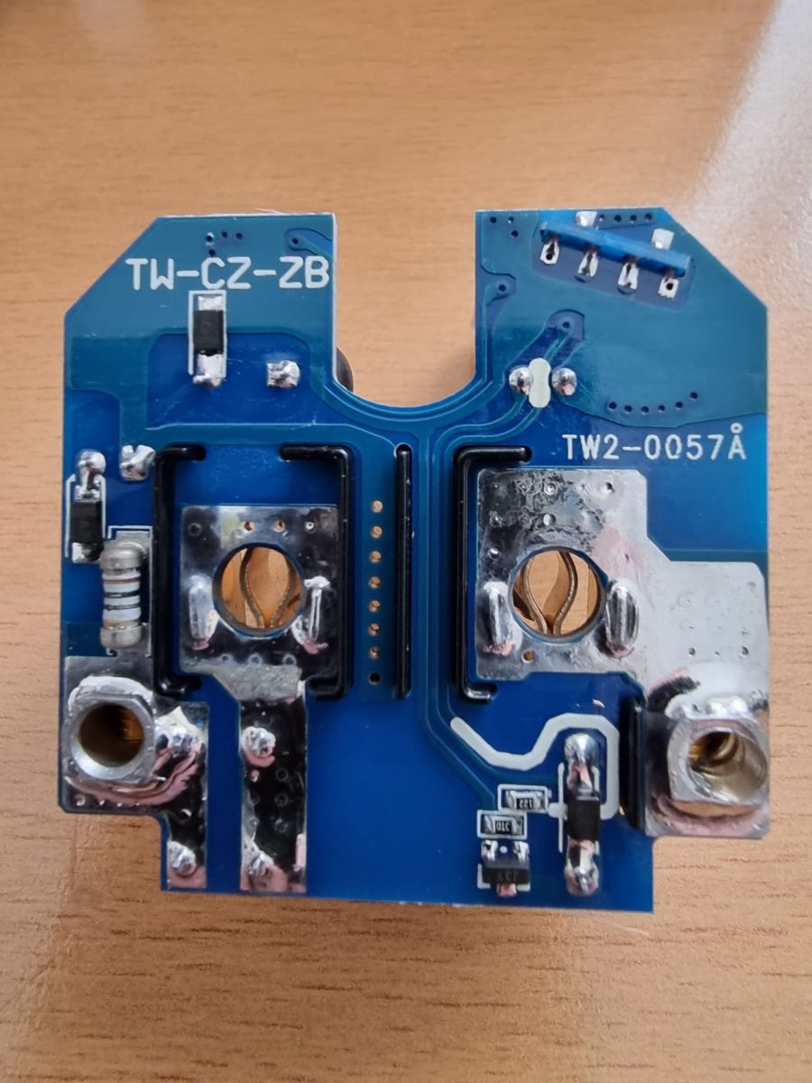

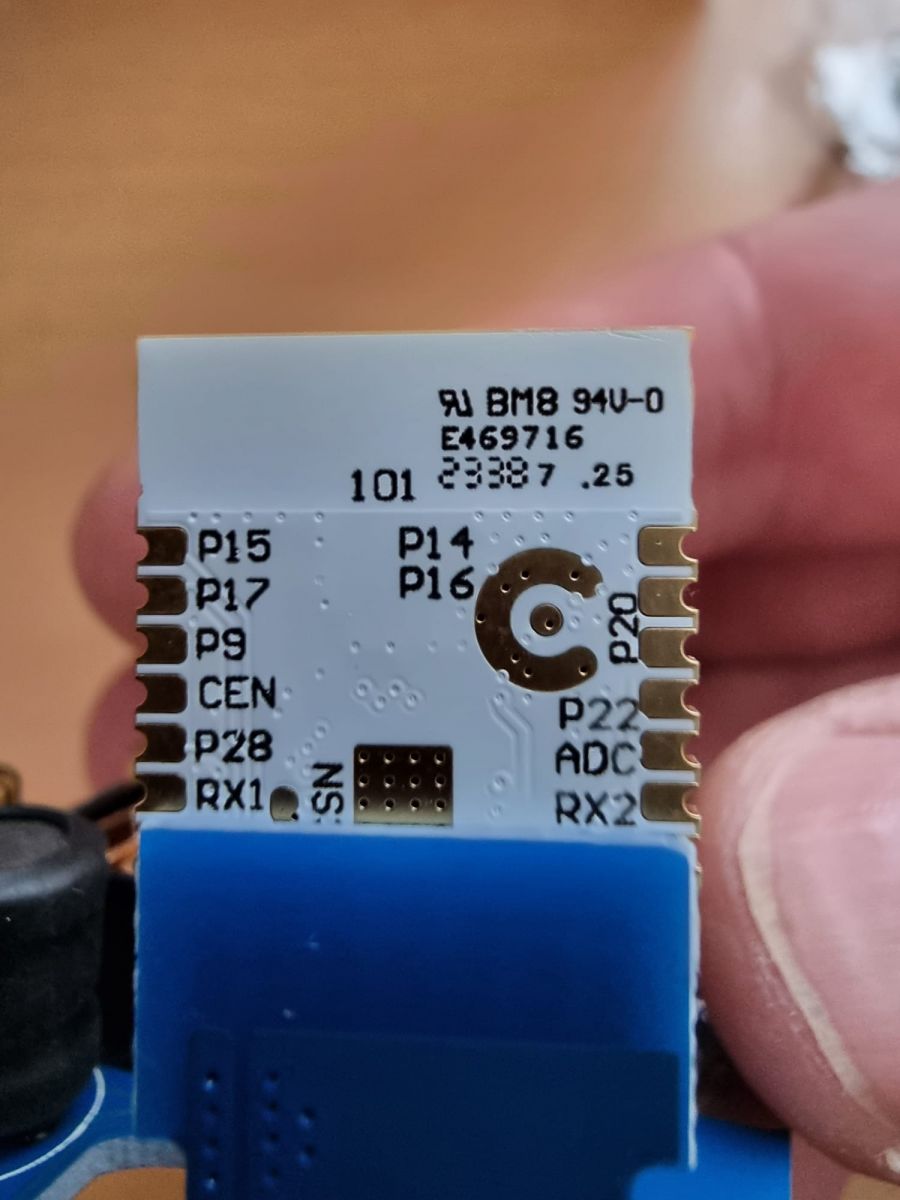

    Electronic module with BK7231N chip on a wooden background.PCB with markings TW-CZ-ZB and TW2-0057A lying on a wooden surface.Close-up of an electronic module with port labels and codes. Electronic module with BK7231N chip in hand, visible markings CBU.
