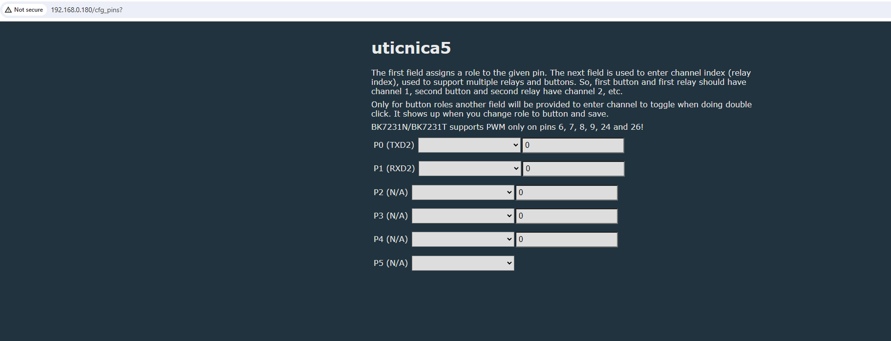

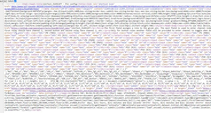

    Here I will show you how I reduced my IoT device pins configuration HTML page from about 90kB down to only 8kB. I will use my OpenBeken project as an example, but the generic idea shown here can easily apply to any other environment creating HTML pages from C (or similiar) code. This topic will assume that user knows the basic of C, HTML and Javascript...
    So, in this topic I am referring to OBK configuration page that allows you to set GPIO roles in dropdown lists:
    IoT device pin configuration in OpenBK7231
    Screenshot of the GPIO configuration page in the OpenBeken project

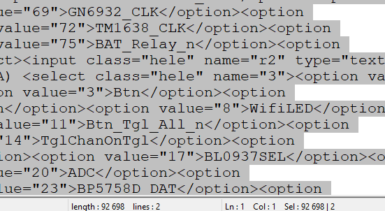

    Before, size of this page was above 90 000 bytes:
    Screenshot of a text editor displaying a fragment of HTML code, indicating a file length of 92,698 bytes and 2 lines of code.
    It was causing slow loading on multiple platforms.

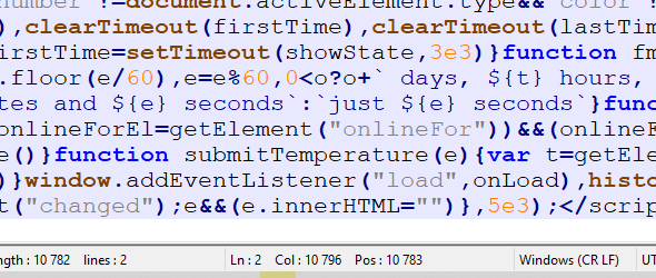

    After the change, size is now:
    Screenshot displaying a code snippet in a text editor.

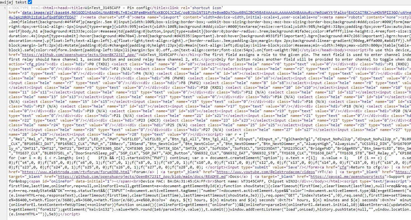

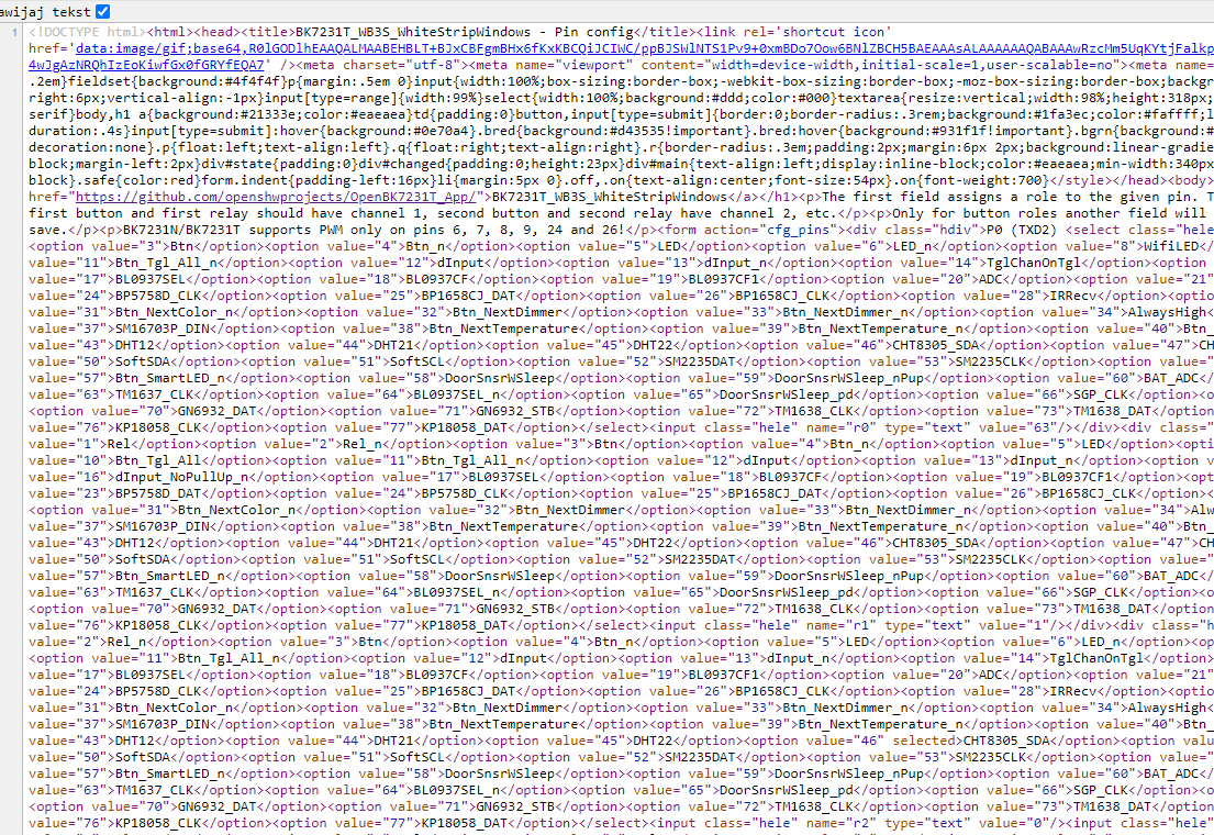

    Let's start by checking why the page size is so big in case of this config. We can just view the source of the page in the browser:
    HTML code snippet for IoT device pin configuration
    Now you can clearly see, that for each of the dropdowns, the list of options is repeated. This is very simple, but also not optimal. This repeats for every GPIO, so if there is 30 available IO pins on a sample platform, then it's repeated 30 times!

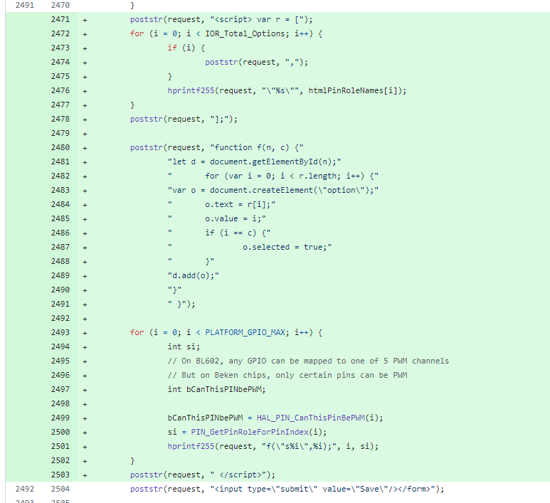

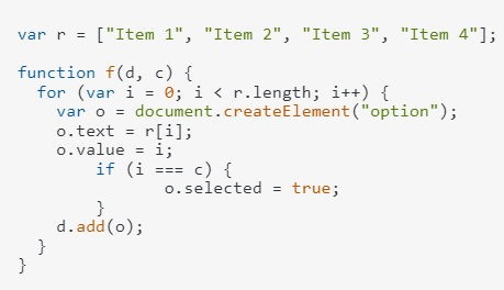

    In order to optimize it, we will use Javascript. In JS, we will create a single, global pin roles array and then for each dropdown we will insert the items into it with a script. There are, however, two issues to solve:
    - we need to also set the active selected element, so people don't lose their settings with each refresh and save
    - we need to exclude PWM roles for non-PWM pins.
    Let's ignore the PWM issue for now. Let's start with the following draft:
    Code: Javascript
    Array r is a list of item role names. In my function f, I iterate the pin role names and add them to the dropdown d. There I also check for the selected role, which index must be given when calling f function.
    The selected role index can be easily taken from OBK code, but for the reference to the select DOM object I had to modify the code futher. I settled with retrieving it by ID:
    Code: Javascript
    Now that we have basics done, let's also consider how we can skip PWM roles for non-PWM pins. OBK already knows which pins support PWM, so we can just pass extra argument and then check whether pin role starts with PWM, altough in the future I may just hardcode the index of role (it will be few characters shorter). Note that the 'b' variable is the extra argument I added to the function:
    Code: Javascript
    So finally I have modified my C code to just print the following Javascript when generating OBK page, of course also replacing the dummy data with the real OBK pin roles:
    Screenshot of C code generating a Javascript script for GPIO configuration in the OpenBeken project.

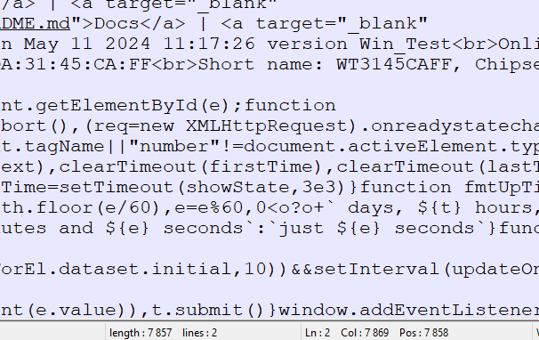

    So, now the page size is down to 8kB:
    Screenshot of a text editor showing a snippet of JavaScript code.
    So, to sum up - generating HTML code from C is very easy, but also not very optimal. In case of the repeating data, like the dropdowns with the same options, it's more efficient to generate a Javascript that will later generate HTML elements. For me, it gave me over one order of magnitude improvement in terms of space used. It also fixed OBK issues, hopefully...

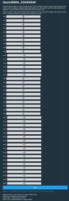

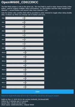

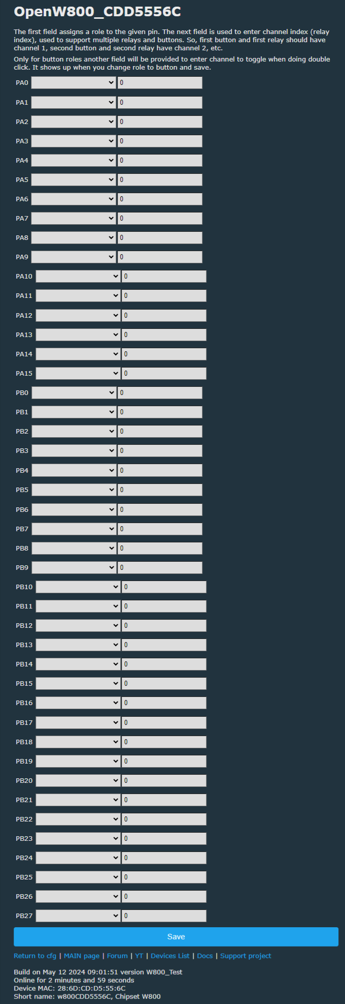

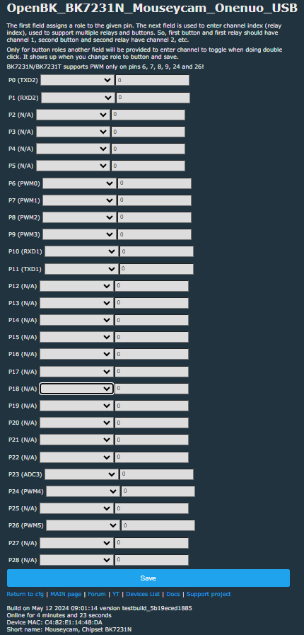

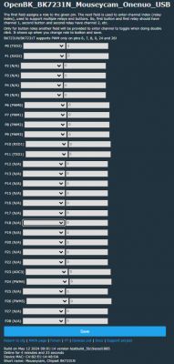

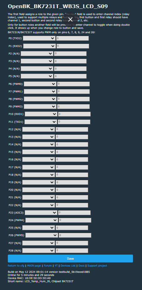

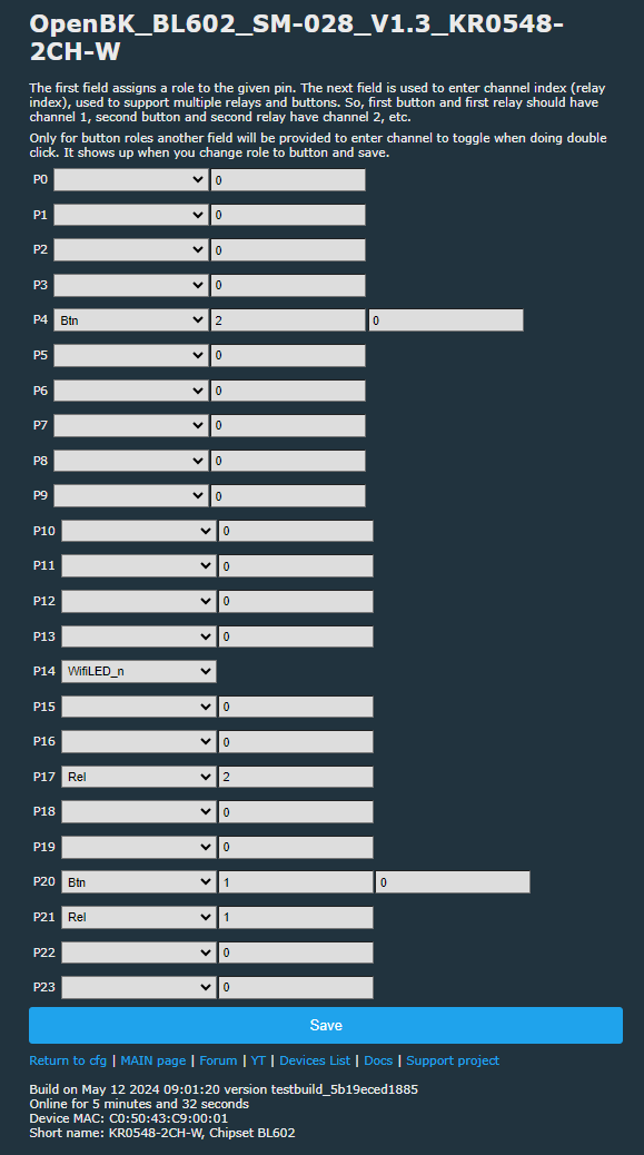

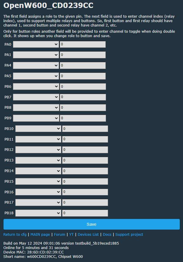

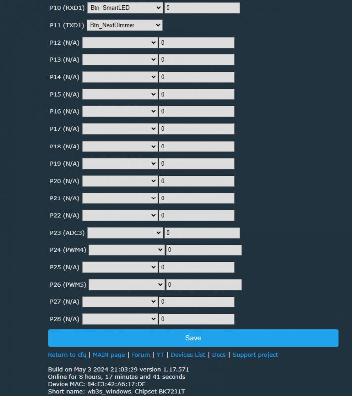

    I had one particular N module that will completely freeze if I went to config pins, this resolved that issue for me!
    BEFORE: Device pin configuration page with dropdown list and channel values.
    AFTER: Screenshot of a module configuration panel with various pin settings.

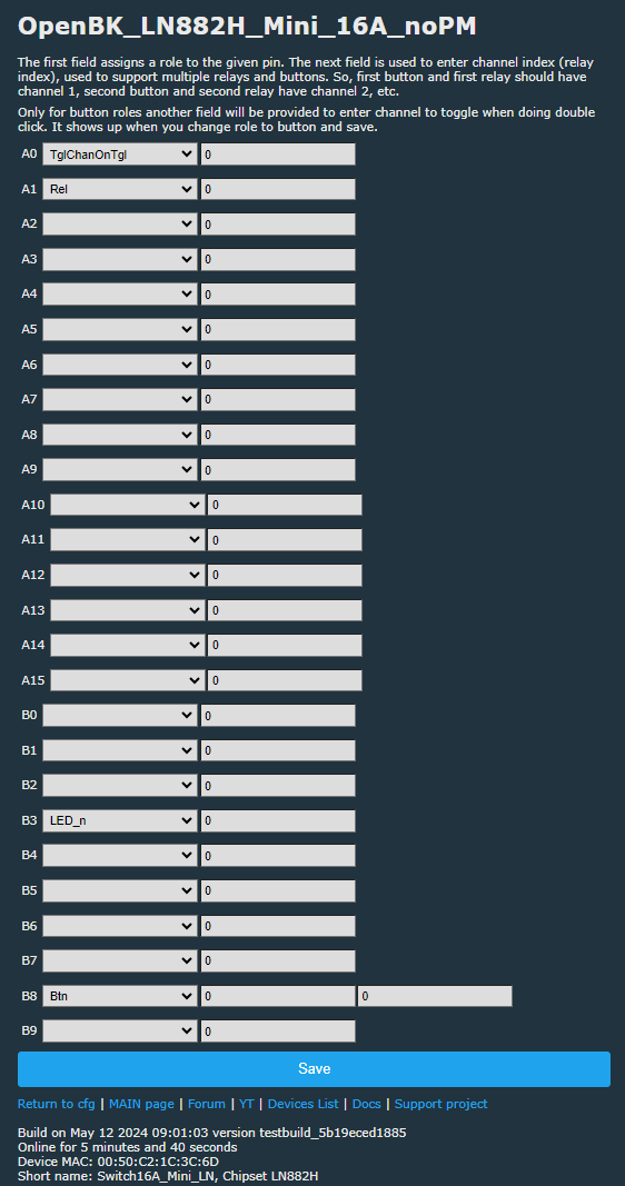

    Works here on my LN882H, page loads fast (but to be honest, I can't remember how it was before)

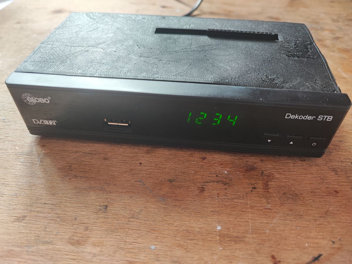

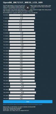

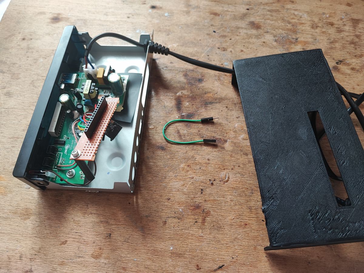

    Actually I have LN882H running at the moment with an older build. And for that it seems that old version runs very good as well. There is no noticeable slowdown in the older build. I've tested both Chrome and Firefox. Btw, here is my "LN882H dev board" I used for testing:
    LN882H development board on a wooden table with an open case lid and a cable. Dobo brand STB decoder displaying the time 12:34.
    Yes, LN882H is inside.
    Interestingly enough, I also had reports saying that OBK on BK7231 fails on pins, but only on Firefox...
    Anyway, this size reduction should fix it.

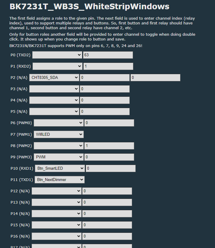

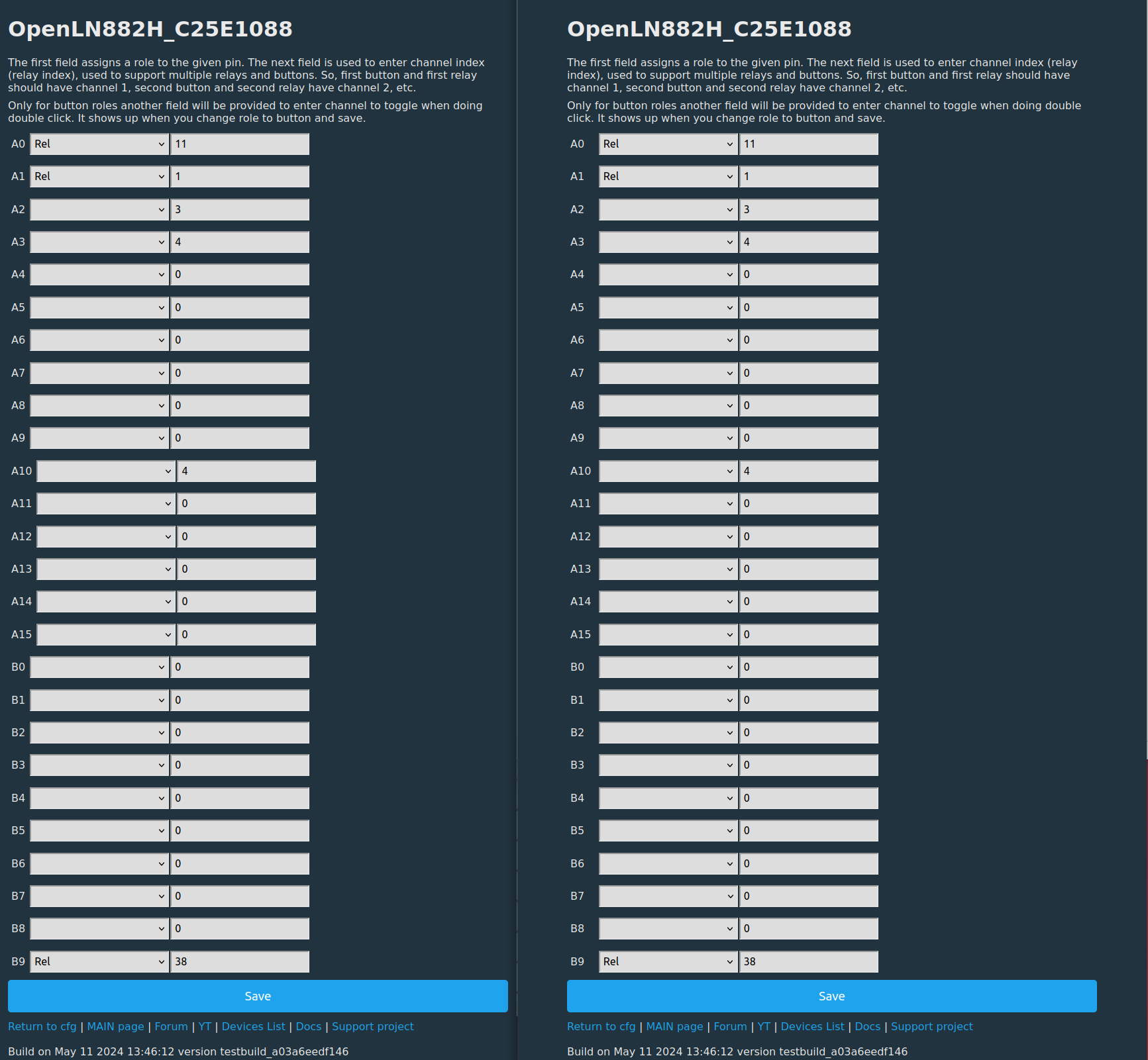

    May I suggest a small "improvement" (it's a question of "style" vs "size"):
    If you change
    function f(alias, id, c, b, ch1, ch2) {
        let f = document.getElementById("x");
        let d = document.createElement("div");
        d.className = "hdiv";
        d.innerText = alias;
        f.appendChild(d);
        let s = document.createElement("select");
        s.className = "hele";
    the part with the "alias", which has different sizes for the labels, to
        d.innerHTML = "<span style='display:inline-block; width: 4ch'>"+ alias+"</span>";
        f.appendChild(d);
    you will have a much "prettier" page:
    Comparison of two OpenLN882H_C25E1088 configuration interfaces
    (or you can add a css format in any other way, it's much leaner than a table here, which would need more JS code, too) .
    Added after 8 [minutes]:
    Sorry, I didn't realize, this code already made it to the release ...

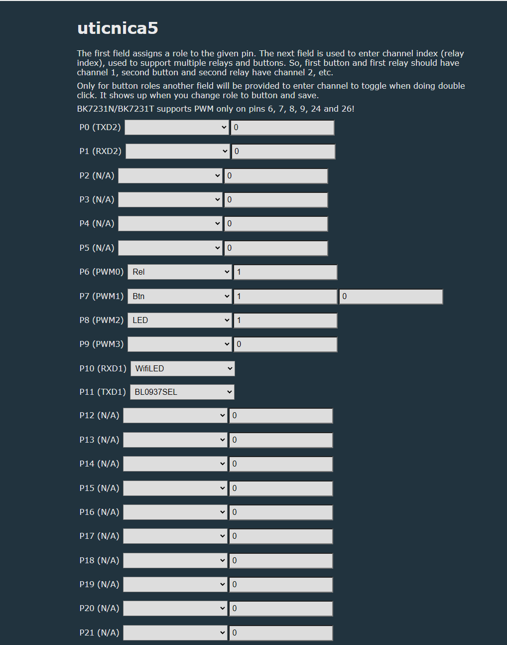

    Can you test it on multiple OBK platforms?
    NOTE: Obk also provides pins setting in the web app, so the following page is not crucial, but it's still good to have it running well.

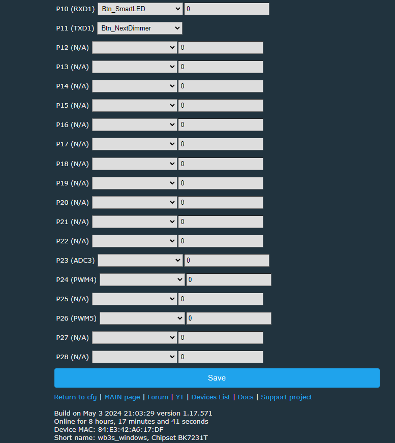

    can't say I really noticed a slowness but they're all fast and the page loads fine.
    chrome.
    User interface showing a dropdown list for assigning roles to pins in the OpenBK system. OpenBK configuration screen for assigning pin roles and channels. OpenW600 configuration interface with dropdown lists for assigning roles to GPIO pins. OpenBK_BL602 settings interface with GPIO pin configuration. OpenBK configuration interface for BK7231T device with a list of available pins. GPIO configuration interface for OpenW800_CDD5556C device.

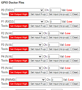

    Added after 7 [minutes]:
    would be cool if the GPIO doctor labels were relevant to the chip in use instead of being N/T (?) labels for all.
    Screenshot showing GPIO pin settings interface with various configuration options.

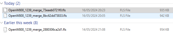

    @ElektrodaBot cool thanks. those changes shaved ~19k off a final binary so was curious about the trade-offs
    Screenshot showing a list of FLS files with dates and file sizes.
    https://obrazki.elektroda.pl/1946300900_1715891397.png
    Great to hear that you achieved a significant reduction in the binary size! Given the differences in the file sizes in your screenshot, it looks like your optimizations are already paying off.
