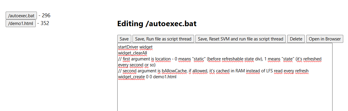

    Screenshot of a text editor with an open /autoexec.bat file containing a widget script.
    html file:
    Code: HTML, XML
    script:
    startDriver widget
    widget_clearAll
    // first argument is location - 0 means "static" (before refreshable state div), 1 means "state" (it's refreshed every second or so)
    // second argument is bAllowCache, if allowed, it's cached in RAM instead of LFS read every refresh
    widget_create 0 0 demo1.html

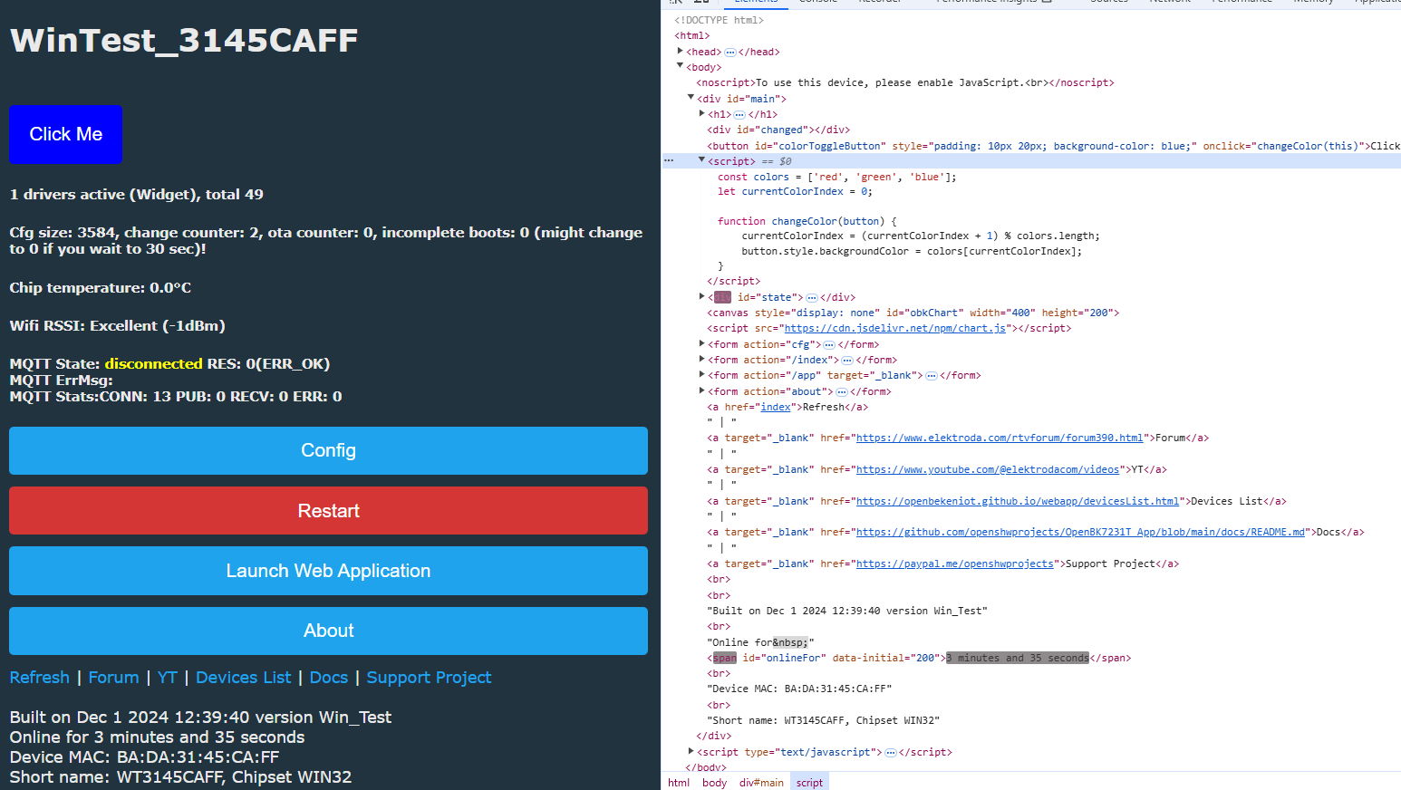

    Result:
    User interface with a button, HTML script, and system data
    I am thinking that maybe it could be used, along with REST interface, to display more custom data. See REST tutorial:

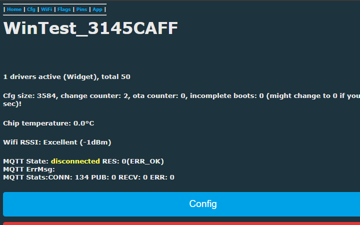

    So far I've only found time to test it in Win, it's great.
    What I would add for myself is a parameter for the option to display it on all pages. Of course, for my dev menu ;-)
    It's always at the top, even when you scroll down.
    User interface with menu and system information
    It's just simple html.
    <div style="font-size: 9px; font-weight: bold; float:left; position:fixed; top:0px; background-color: #21333e; padding:0px; border:0px; margin:0px">
    <hr/>
     | <a href="index">Home</a>
     | <a href="cfg">Cfg</a>
     | <a href="cfg_wifi">WiFi</a>
     | <a href="cfg_generic">Flags</a>
     | <a href="cfg_pins">Pins</a>
     | <a href="app">App</a>
     | <hr/>
    </div>
    I fight against animal suffering. So let's end the suffering of mouse wheels. ;-)
    Just to explain, it always bothered me a lot when I save a config, or anything else, and then I have to "crazy spin the mouse wheel" to scroll down to the menu to get back to somewhere.
