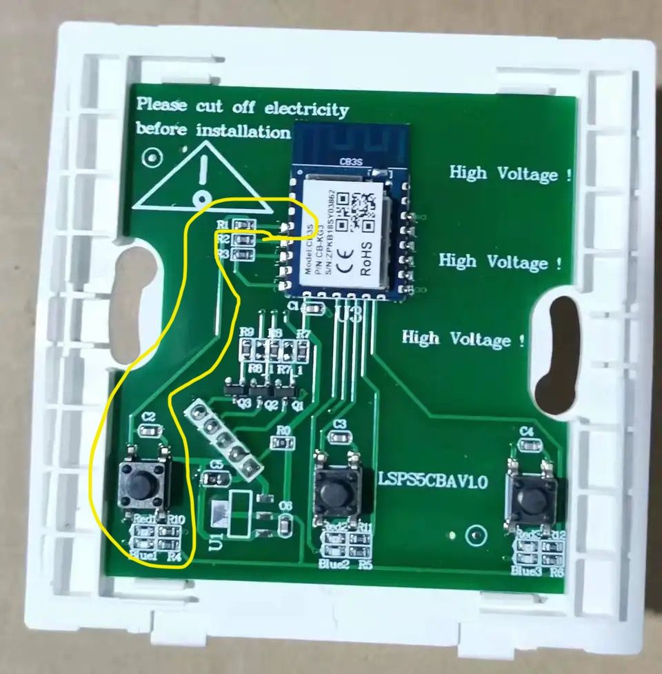

    Hi, I have this 2 gang LSPS5 switch (BK7231N)
    https://www.elektroda.com/rtvforum/topic3934363.html
    There’s an issue whenever I toggle button 1 to turn off the relay, it reboots the switch like this
    I have swapped the chip with esp and the same thing still happens. I suspect there’s something on the pcb that’s causing this.
    2-gang LSPS5 switch with visible circuit board and CB3S chip.
    Anyone have any thoughts on this?

    First I would try with better power saving, in OBK it's PowerSave 1 command. I had already report about similiar problem and PowerSave helped.

    @p.kaczmarek2 i’d like to add this just happened recently after using it for almost a year. No issue with other switches though.
    And only with button 1 (pin 14), no issues if toggled with button 2 (pin 24)

    So, did you use PowerSave 1 on this device or not?
    Added after 44 [seconds]:
    This is what happens if you don't use PowerSave on device with cheap power supply:
    https://www.elektroda.com/rtvforum/topic3898805.html
    Power supply low ESR capacitor degrades more quickly and device becomes unstable.

    @p.kaczmarek2 no i’ve never enabled power save on this switches
    I’ll try when i get home
    So those capacitor issue is somehow related to button 1 when it’s toggled?
  • #6 21081646
    Posts: 14744
    Rate: 12839
    PowerSave 1 should be always enabled. It would have been enabled for default, if not for those few strange reports saying that it breaks something (it was a year ago so I am not sure). It also breaks IR and BL0937, but apart from that, PS should be good.
    I think it may be capacitor related. I would need to see the power supply. Is the capacitor bulged there? Check out photos from my article.
