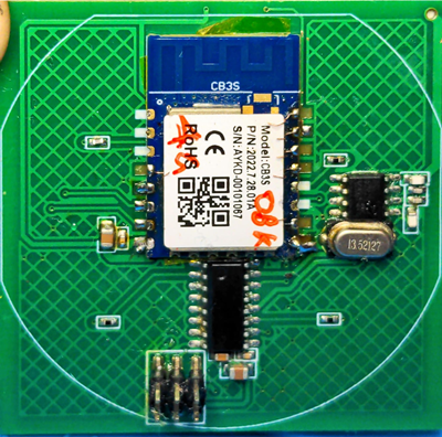

    I would like to document my experience, or rather inexperience, in getting in OpenBK on to it.

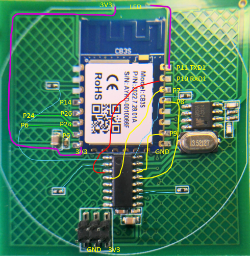

    I traced the connections of the PCB as follows:
    PCB with CB3S module showing labeled signal and power traces
    I made some serious mistakes in attempting to de-solder the CBS Module.
    I wanted to see whether I can lift the CBS module a little bit by ulsoldering only the pins on the top side of the module. Attempted to use the soldering iron only.
    Ended up in a disastrous situation where I accidentally removed most of the tracks and pads off the PCB.

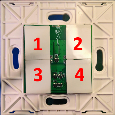

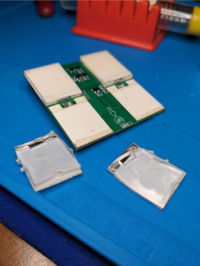

    This time I had a heat gun and tried to remove the module from the board again for reconstruction of the tracks again.
    Little did it come to my mind that the switch has plastic/acrylic parts on the other side on the touch switches.
    Four-button touch panel in a white mounting frame, buttons labeled 1–4
    Although I managed to remove the module, the caused two of the switch positions to have melted plastic pieces.
    Printed circuit board with four pads and two detached illuminated touch switches

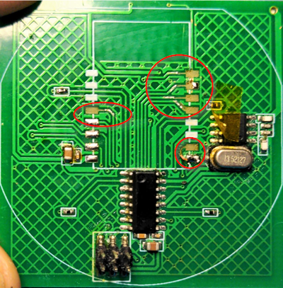

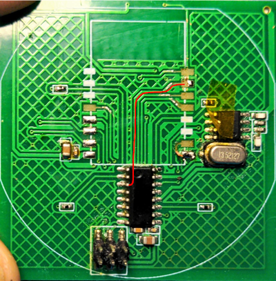

    So after the cleanup my PCB now looked like this:
    PCB with visible repairs and red-marked damaged trace areas

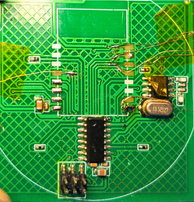

    I had scraped off the coatings to expose the tracks at broken points and applied solder for the last repair.

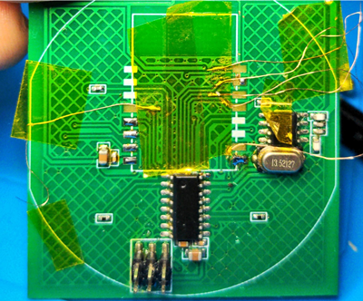

    This time I decided that I will use thin copper wire strands to repair the tracks.
    Green PCB with thin wires and repaired copper traces secured by kapton tape
    This time I was better equipped and has some kapton tape to help secure the wires in place after soldering.
    Repaired PCB with yellow Kapton tape and fine soldered wires

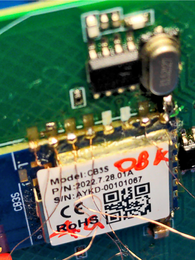

    After securing the module back using only the power and ground pins I pulled the wire strands against the solder pad slots on the module and soldered them.
    CB3S module soldered to PCB with thin wires manually connected
    All looked good
    CB3S module soldered onto repaired PCB with visible hand-done trace fixes

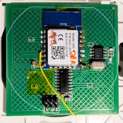

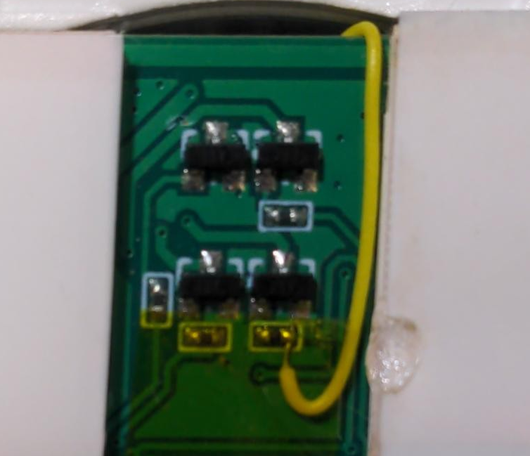

    except that Relay 1 was not operational. On further investigation found that pin P26 some how does not get connected to the transistor on the other side of the PCB.
    So I decided to use a wire externally as I did not want to remove the module again. The track did not appear to be broken but I wanted to do the short cut to complete the repair.
    Repaired PCB with CBS module and yellow wire for signal connection
    Close-up of a PCB with four transistors and a yellow jumper wire
    This required some precision soldering skills, to solder a tiny wire to the tiny resistor. I am glad that I got the hang of it also.
    So now the switch is functional except that switch 1 & 2 require plastic pieces from another source. I suppose 2mm acrylic sheet would do the job.

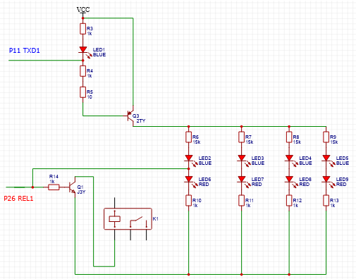

    I found the connections to be like this:
    Wiring diagram for GPIO P11 and P26 with LEDs and relay control
    So the relay driving GPIO functions are understood but I have trouble understanding the P11 connection. It has a direct connection towards the LED and also towards the 5th Transistor on the board.
    Need to recheck whether my tracing is correct.
    Also I am trying to think about how best to flash the other devices that I have of the same type without having to completely remove the CBS module.
    As you can see the RXD1 pin has been routed to the button controller without leaving any room for breaking the track. Otherwise that would have been the easiest way.

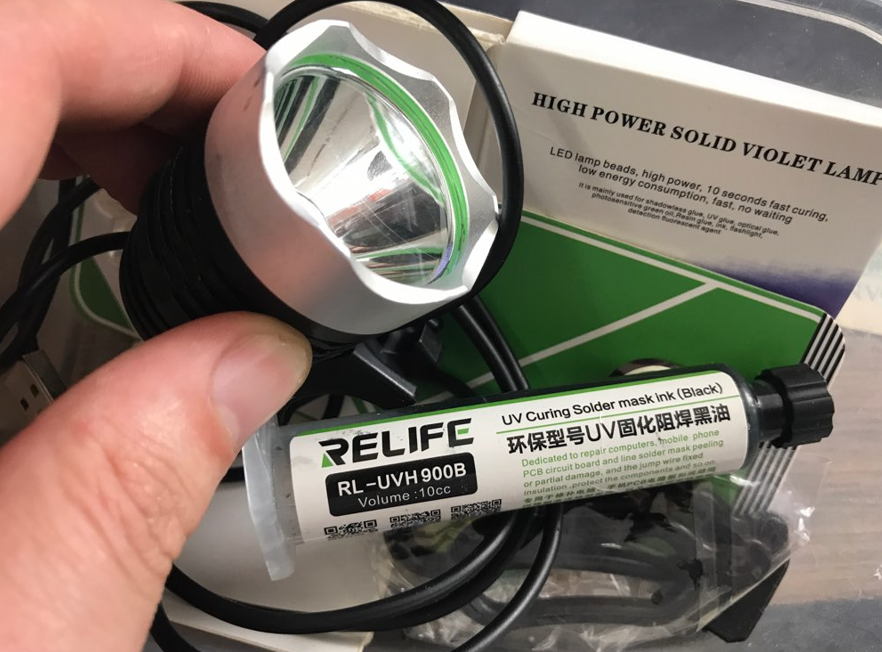

    Thank you for this interesting presentation. To be honest, I broke a light switch in the same manner as well - I overheated the button elements with hot air and they have curled just like on your photo...
    Regarding tracks recovery - look into UV-curable solder mask, this can help secure the new "traces". Of course, it may not be necessary in your case, and it depends on how much such repeairs you're doing...
    UV lamp and RELIFE RL-UVH900B black solder mask, 10cc, shown in repair kit

  • P11 controls blue LED indicators on all switches
    #5 21616915
    jkwim
    Posts: 186
    Rate: 25
    Regarding P11 connection - this is interesting, but it looks like a hardware feature where WiFi LED blinking also can control button lights? Did you test it with factory firmware, was there anything like that?
    I just tried configuring P11 as Relay 5.
    Normally this switch has the BLUE LEDs lit. When switch is on it changes to RED.
    I can toggle the P11 output to turn off the BLUE LEDs of all the switches.
    So It kind of works as per the bottom part of the schematic.
