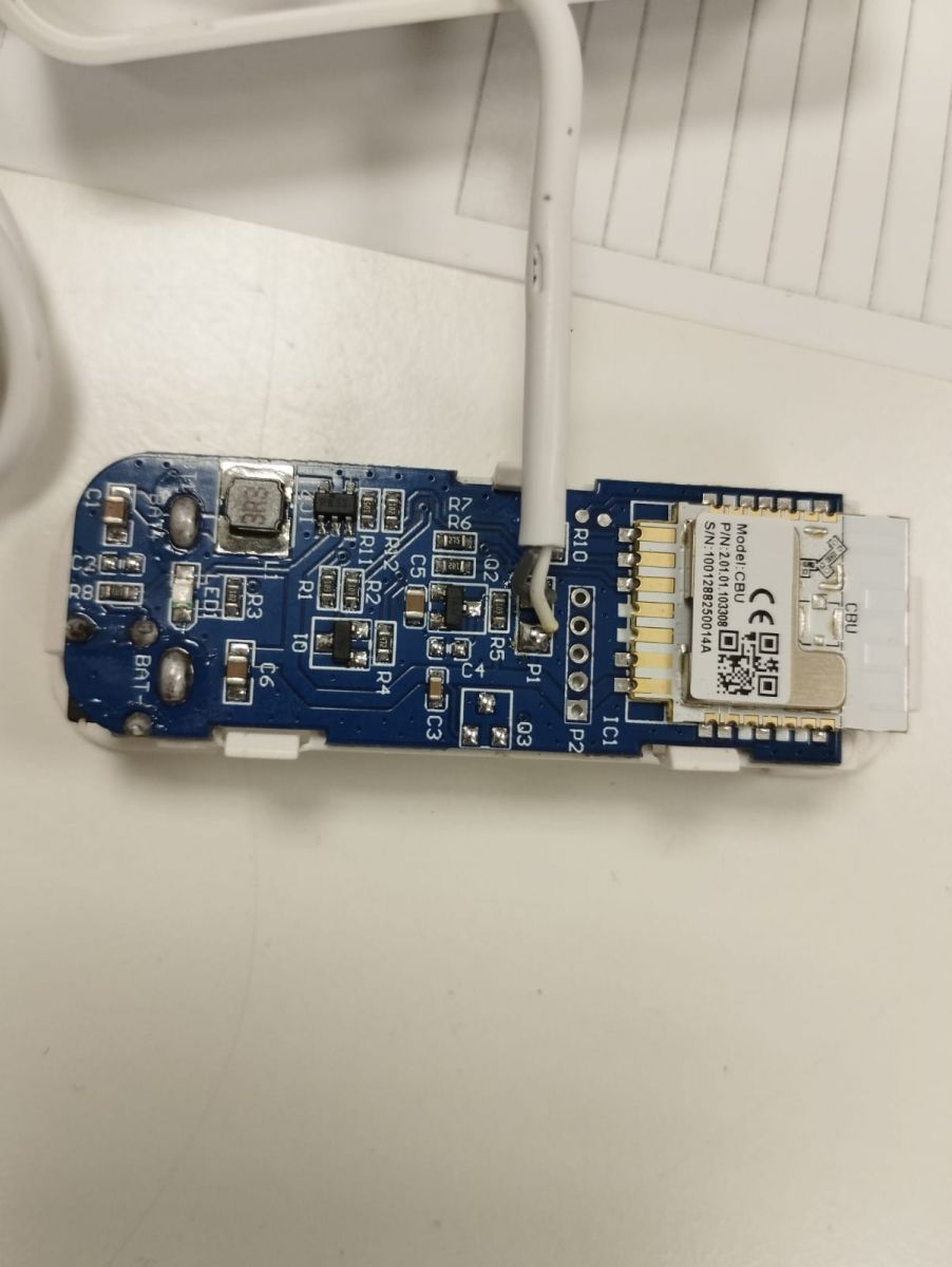

    I flashed the 898WT water sensor available on AliExpress with openbeken. This is the PCB which contains a CBU module:
    Printed circuit board with a CBU electronic module and connected cable.

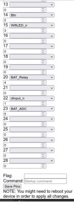

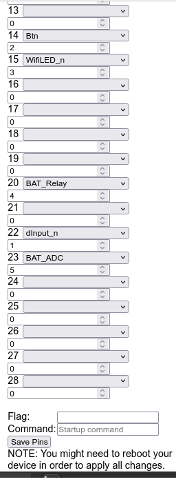

    I have everything almost ready with the following pin configuration:
    Screenshot of pin configuration settings for the 898WT water sensor.

    Everything seems to work, the device wakes from sleep to notify water leaks but the small problem I am facing is that, WiFi LED blinks while connecting to WiFi, it stays on once it is fully connected, but after Sleep command is executed the LED stays on. I think it won't draw much battery, but I think it will be better to keep it off while sleeping. Is it possible to do this?. Thank you

    That's a very interesting problem. I haven't seen that one yet. It's possible that somehow Beken does not set the pin in the required state when going to sleep.
    Well, the simplest way to fix it would be to just set the WiFi role to "WiFiLED" instead of "WiFiLED_n", can you try is that approach working?
    Alternatively, we could just set the LED pin on boot to WiFi role and then before sleep try setting it to something like AlwaysHigh or AlwaysLow, see roles list here:
    https://github.com/openshwprojects/OpenBK7231T_App/blob/main/docs/ioRoles.md
    That approach has however one downside - it will slowly wear out flash. Still, if you are expecting this device to boot every 5 days or when there is a water leak, then I don't think that flash wear will be ever noticeable...
    I could also try to add some command or a clause to PinDeepSleep to fix that, but that would require some more testing, would you like to help?
  • #3 21083839
    rubenlogon
    Level 4  
    Posts: 6
    Hi. Setting role to wifiled makes the led blink while connecting but it stays off while connected but also while sleeping which, from a battery point of view, is a better solution. How can I set pin roles (wifiled or alwayslow) in the bat file? Yeah, I would like to help in everything I can :). Thanks for your reply!

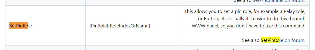

  • SetPinRole script command for LED control
    #4 21083844
    Posts: 14746
    Rate: 12842

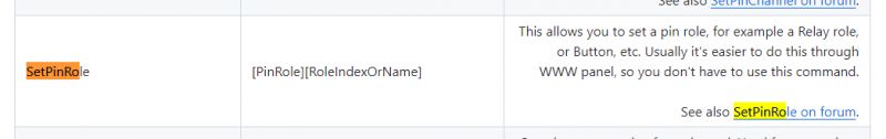

    There is a command for setting pin role from script, it can be found there:
    It seems to be called: SetPinRole.
    A documentation excerpt showing the SetPinRole command for setting pin roles.
    I can also consider adding a hardcoded solution to your problem, but I am not yet sure whether it's something common or specific to your device.
    By the way, it should be just also possible to write a script that does a "WIFI LED" effect on a simple digital pin with a LED or REL role on a separate channel, but I would need to look into it for a few moments more. Something like "myWiFiLED.bat".

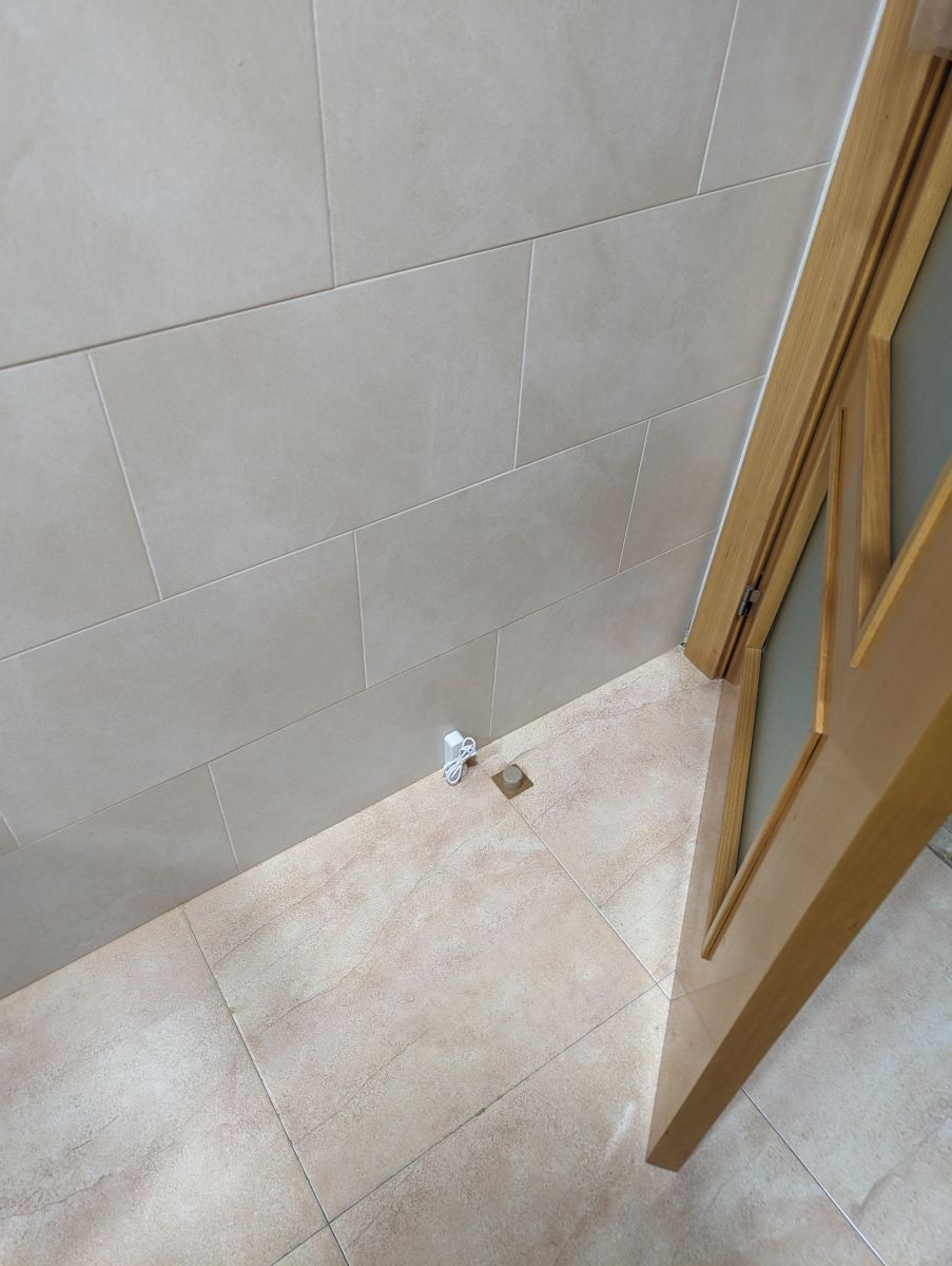

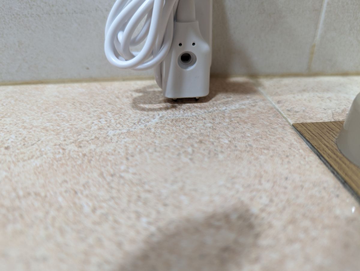

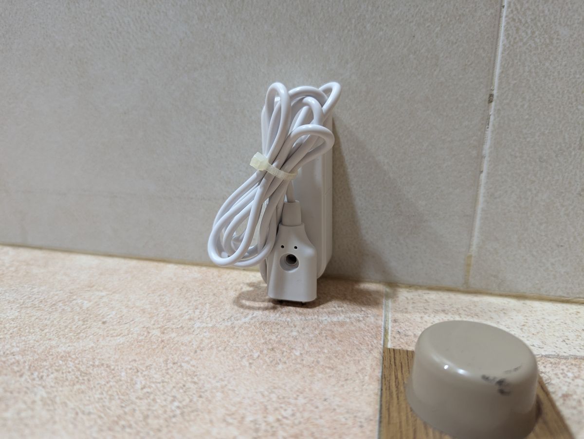

    For the moment, I add some pictures from the installation:
    Close-up of a sensor mounted by the wall with an attached cable and a visible opening for the LED. Image of sensor installation on a tiled wall with an open door. Close-up of a sensor with an attached cable secured with hot glue.
    I glued the tip of the cable with the electrodes to the body of the sensor using some hot melt glue to keep the electrodes always parallel to the ground. The hole present in the tip of the cable is aligned to make the led present on the body visible in it. I made it this way because the sensor has an adhesive back cover that you need to slide in order to access the batteries. If you glue the electrodes to the opposite part of the sensor's body, with the electrodes touching the ground, you would need to slide the body down in order to remove the body from the wall, which means that in fact you won't be able to do so.

    Here it goes:
      "vendor": "Tuya",
      "bDetailed": "0",
      "chip": "BK7231N",
      "board": "TODO",
      "flags": "1024",
      "keywords": [
        "TODO",
        "TODO",
        "TODO"
      "pins": {
        "14": "Btn;2",
        "15": "WifiLED;0",
        "20": "BAT_Relay;4",
        "22": "dInput_n;1",
        "23": "BAT_ADC;5"
      "command": "",
