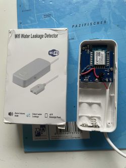

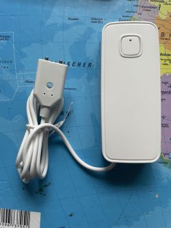

  • Just acquired another WiFi Water Leakage Detector from Aliexpress
    https://de.aliexpress.com/item/1005005754072819.html
    WiFi water leakage detector with a white sensor and cord on a map background.

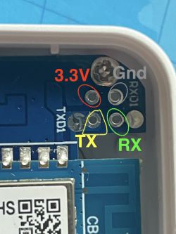

    which is a little different to this one here, but it essentially works the same way.
    WiFi water leakage detector with open casing and packaging. Close-up of the water leakage detector PCB with labeled connections 3.3V, TX, RX, and Gnd.
    It is powered with 2 AAA batteries, and as in the previous post, it simply goes to sleep, but does not wake up.

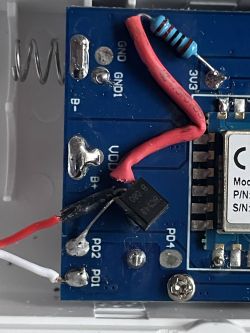

    In order to make this work, I followed the same procedure as in the upper post and used a BC548 NPN transistor between 3.3V (+10k resistor), one pin from the sensor to base and the other one to the connector on the board.
    Works as expected - goes to sleep, wakes up if you touch the sensor.
    Close-up of a water leakage detector circuit board showing electronic components and wires.
    The extraction from the flashing tool is incomplete and misses the relay, as the board has also a buzzer on the bottom. In order to use that one, you have to add it as a relay and configure it properly like this:

  • DSEdge setting may fix wake-up issue
    #2 20957109
    Posts: 14767
    Rate: 12907
    While I indeed think you did a good job on modification, I am not sure if it really was required. I think a correct pin setting (pull up, pull down or none) with a proper DSEdge setting (DSEdge 0, or DSEdge 1, or DSEdge 2) would work well enough in OpenBeken. I already had seen a door sensor which also at first seemed unable to wake up from a one certain state, but it turned out that I had to change just the DSEdge setting. You can search other topics for more details:
