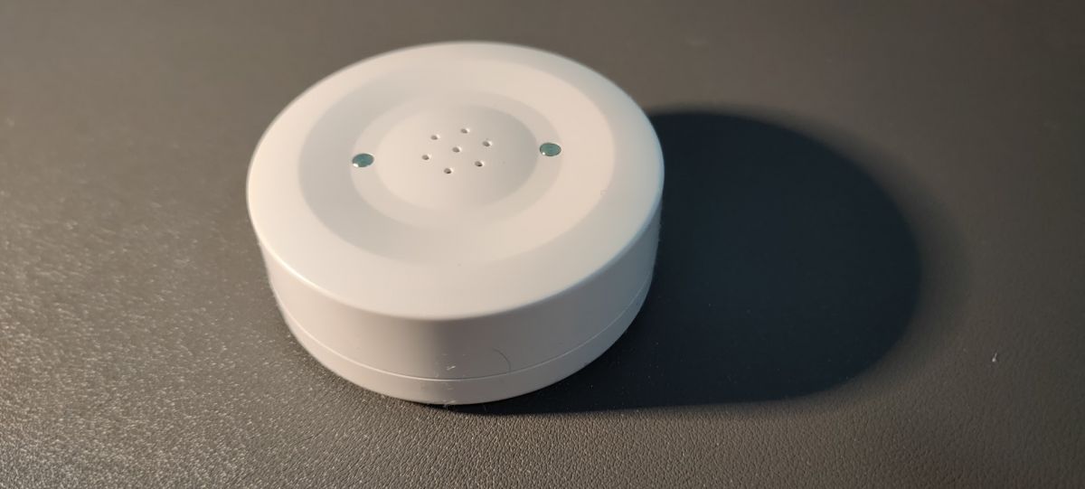

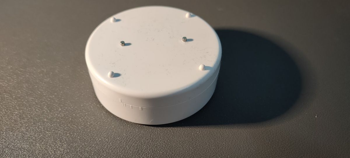

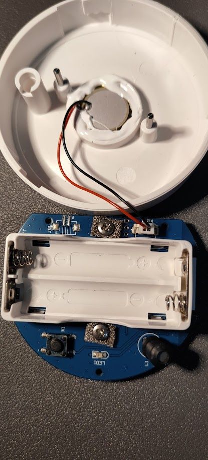

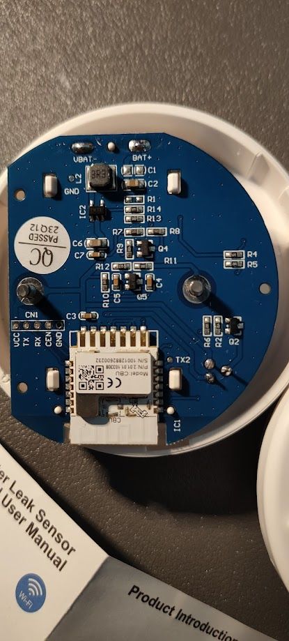

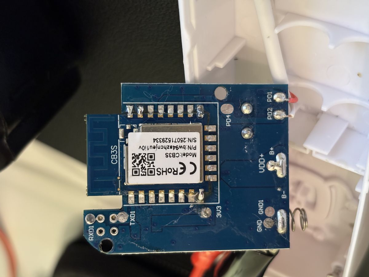

    I have bought this water leak, branded Tuya. Here are the pictures. Attached is the original firmware.
    I would like to make it free from the cloud and use it at home with my Wi-Fi.
    I'm not sure what to do next? I could not find a template for this device.
    Close-up of a Tuya water leak sensor circuit board showing electronic components. Image of the interior of a Tuya water leak sensor showing the circuit board and battery compartment. Photo of a Tuya brand Wi-Fi water leak sensor with its case removed and user manuals. White, round Tuya water leak sensor on a gray surface. Close-up of a white, circular Tuya water leak sensor on a dark surface.
    [Edit: added pictures of board after removing batteri case]

    Ok, I had a look at the "related link" to learn how to test the buzzer.
    Unfortunately I don't know which PIN drives the buzzer.
    There is no meaningful information in json config extracted from original firmware backup.
    Thinking about the options, a brute force approach would be to test each and every pin, right?
    Given that this is a CBS module, and having read datasheet I deduce there are possibly 5 PINs for PWM:
    8 P8 I/O Support hardware PWM (Correspond to Pin 24 of the IC)
    9 P7 I/O Support hardware PWM (Correspond to Pin 23 of the IC)
    10 P6 I/O Support hardware PWM (Correspond to Pin 22 of the IC)
    11 P26 I/O Support hardware PWM (Correspond to Pin 15 of the IC)
    12 P24 I/O Support hardware PWM (Correspond to Pin 16 of the IC)
    (source: https://developer.tuya.com/en/docs/iot/cbu-module-datasheet?id=Ka07pykl5dk4u)
    Then I have:
    1) Enabled the "show raw pwm controllers" flag and rebooted the device
    2) Set "PWM" for PINs 8 to 12 in the PIN configuration page and common channel 6 in WebApps > Config > PinSettings
    3) exec command "PWMFrequency 1000" in the WebApp > Logs > Command
    4) exec command "setChannel 6 50" in the WebApp > Logs > Command
    I could not ear any sound from the device.
    Am I doing the correct steps?

    >>21092652there are 6 PWMs I think, not 5. Did you check them all
    Buzzer on pin 6 with siren autoexec script
    #9 21096228
    carlig833
    Posts: 23
    Buzzer of my water sensor is controlled by pin number 6 in WebApp > Config > Pin Settings. Here is the obk json config template:

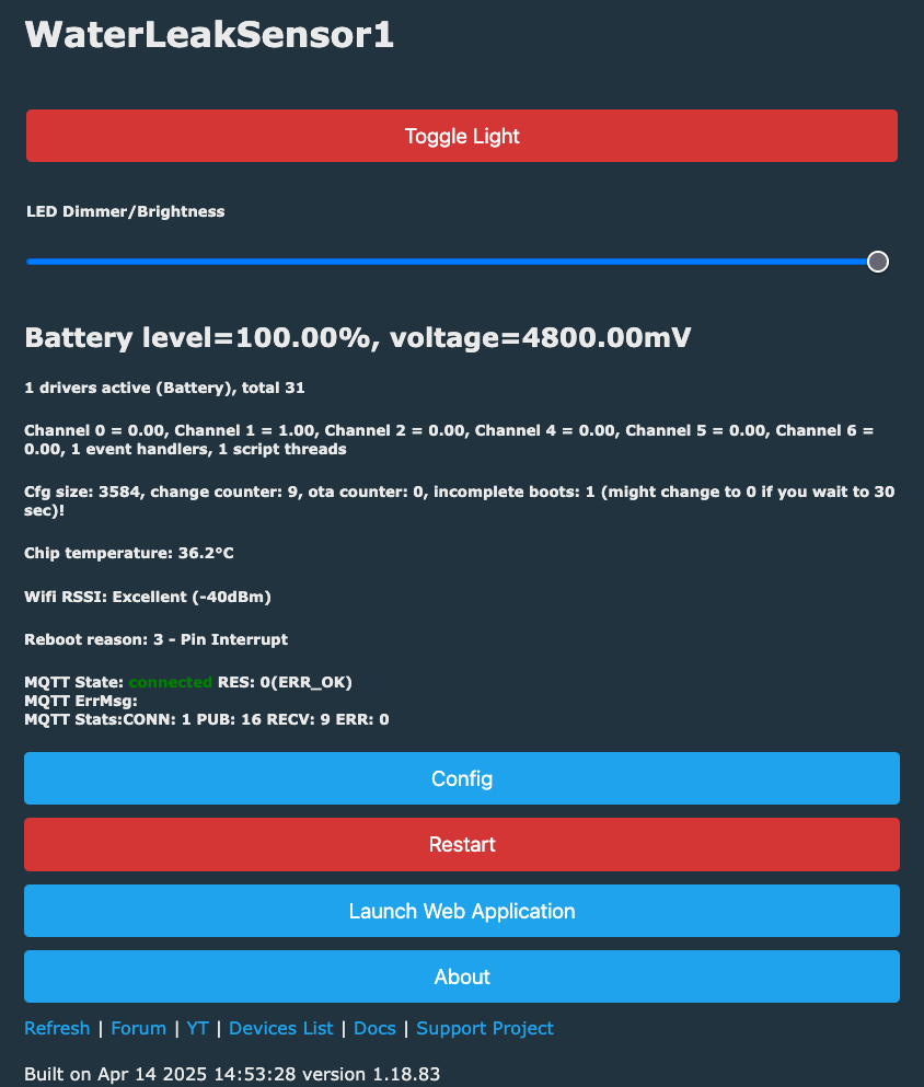

    #15 21522747
    mariuszkowa
    Posts: 6

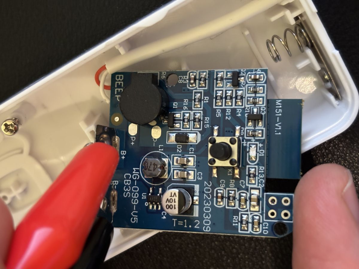

    I have exactly the same device. I've used the provided pin configuration and uploaded the autoexec.bat. Thank you guys for providing those!
    It works great (detects water and produces audio signal) except for the fact that the device shows 4800mV which seems invalid for 2xAAA battery.
    @carlig833 do you see proper voltage?
    Water leak sensor control panel interface showing battery, voltage, temperature, and WiFi status.
    I don't think the LED Dimmer actually works (I don't see any difference on the LED) and not sure what is the "Toggle Light" control doing, but I don't really need those.
    Battery level on the other hand is a useful information to know when the batteries should be changed, so this one I'd like to fix, not sure how though.
    EDIT: The best configuration I've found that is showing "somewhat reasonable" voltage and percentage is to set pins this way (note pin BAT_ADC on the pin 24):
    "pins": {
        "6": "PWM;6",
        "15": "WifiLED;0",
        "20": "BAT_Relay;0",
        "22": "dInput;1",
        "24": "BAT_ADC;0"
    And Battery Setup in the autoexec.bat like this:
    Battery_Setup 2200 2800 1.25 2400 4096
    Let me know if anyone got a better setup. This above shows low percentage when battery is getting low but I think there may be a better approach, just couldn't find it.

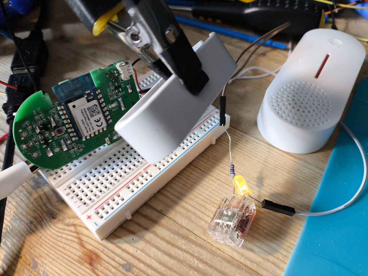

    #16 21840979
    afaik4711
    Hey,
    Sorry to hijack this thread, but I'm really lost.
    I tinker around with this water leak sensor with buzzer (see images below)
    My config is (never mind the missing buzzer):
      "vendor": "Tuya",
      "bDetailed": "0",
      "chip": "BK7231N",
      "board": "TODO",
      "flags": "0",
      "keywords": [
        "TODO",
        "TODO",
        "TODO"
      "pins": {
        "8": "DoorSnsrWSleep_pd;2",
        "14": "BAT_Relay;3",
        "23": "BAT_ADC;1",
        "24": "dInput;3",
        "26": "WifiLED_n;0"
      "command": "",
    My problem is that the device won't wake up when the sensor is in water. When it is awake and my sensor pin is "dinput_noPullup", I can see if it is dry or wet, but not on doorsensor. I have no autoexec.bat so far; I always test with the custom command "pindeepsleep 120" or the default countdown of "doorSnsWSleep_pd"
    The only time the sensor wakes is if it is set to "DoorSnsrWSleep_pd" and I short the pins on the sensor directly. The water obviously can't conduct enough energy for the sensor to wake up.
    Any thoughts on that?

    DSEdge setting. It has 3 options and you need to try them all to see which one works. Make sure to have also button configured first, so you can emergency- wakeup device.
    https://www.elektroda.com/rtvforum/find.php?q=DSEdge
